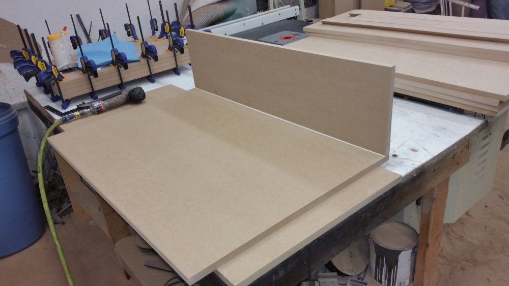

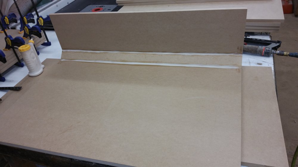

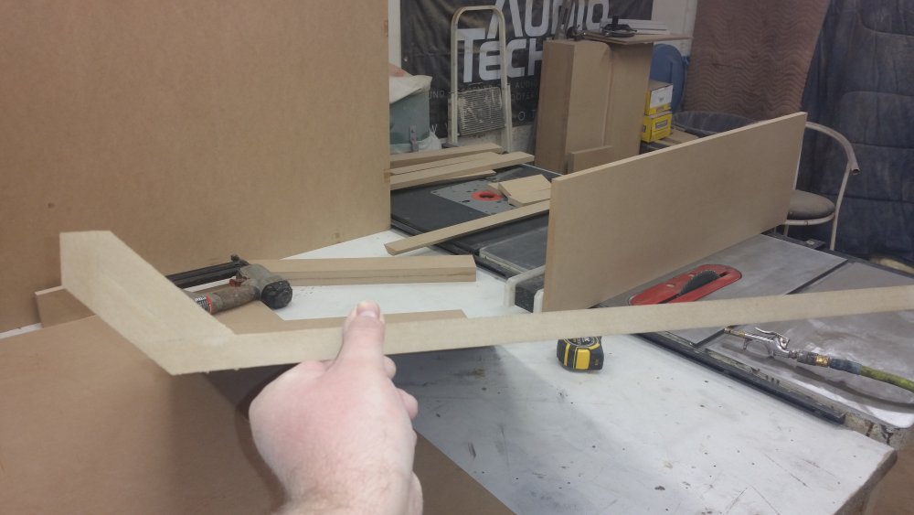

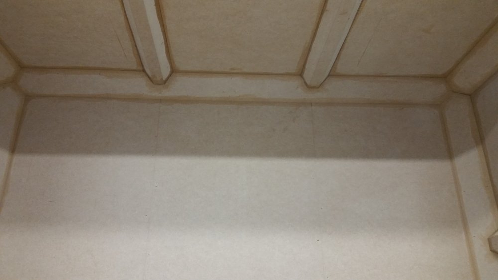

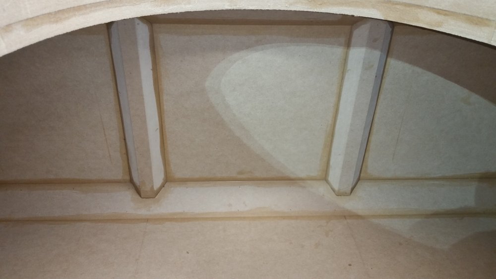

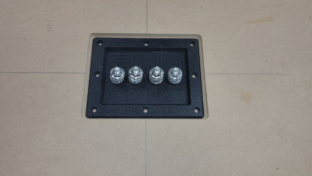

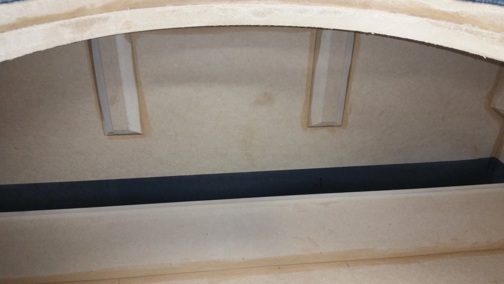

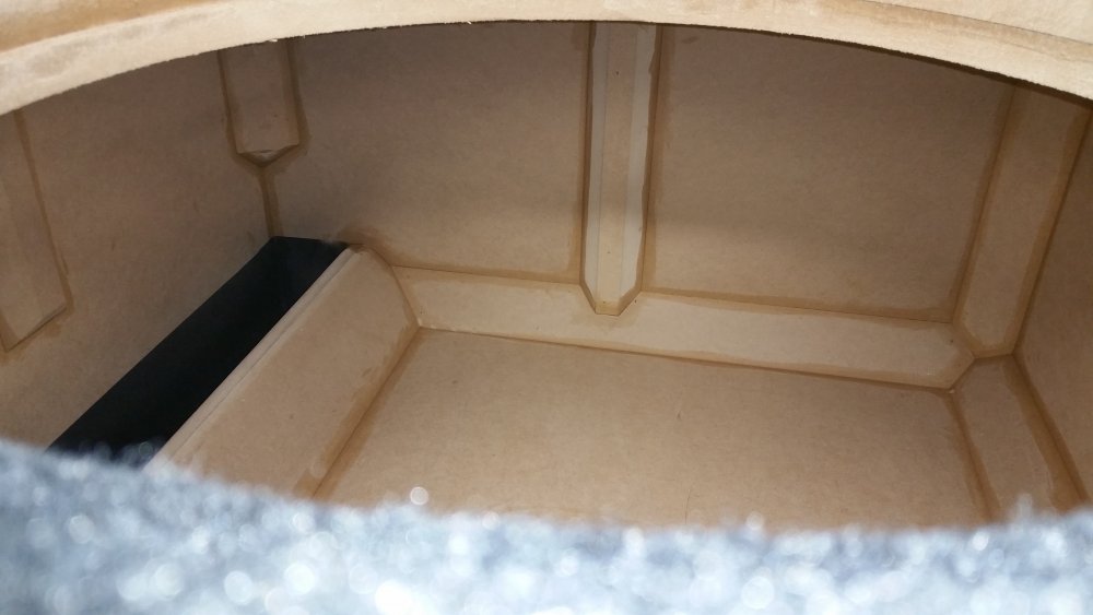

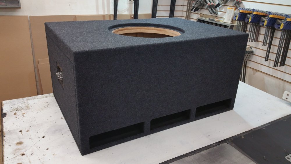

Triticum Agricolam Posted February 10, 2017 Report Posted February 10, 2017 Lets see some pics of the box! "Nothing prevents people from knowing the truth more than the belief they already know it.""Making bass is easy, making music is the hard part."Builds:
Wannabe Posted February 10, 2017 Author Report Posted February 10, 2017 i dont have any of the inside/ bracing but i have a couple of it not in my truck but i will take some when the snow dies down this is my first build, i have been waiting 4-5 years to have this done 95 chevy 2 door tahoe 5.7 Xs power d3400 Singer 275amp alternator Big 3 - all Knukonceptz Kolossus Fleks 0ga/ knu Fuses an holders Sundown SAE-1500d Mbquart onyx OA800.4 Stinger 4400 series RCAs and stinger volt meter Fi Q NEO 18, 7.5 cubes tuned 32hz Pioneer MVH-X690BS H/U Kicker CSS 6.5 comp sets in front doors Kicker KSC 4x10 coaxials in rear GTMAT and FAT MAT deadner Xenon 10k Blue HIDs

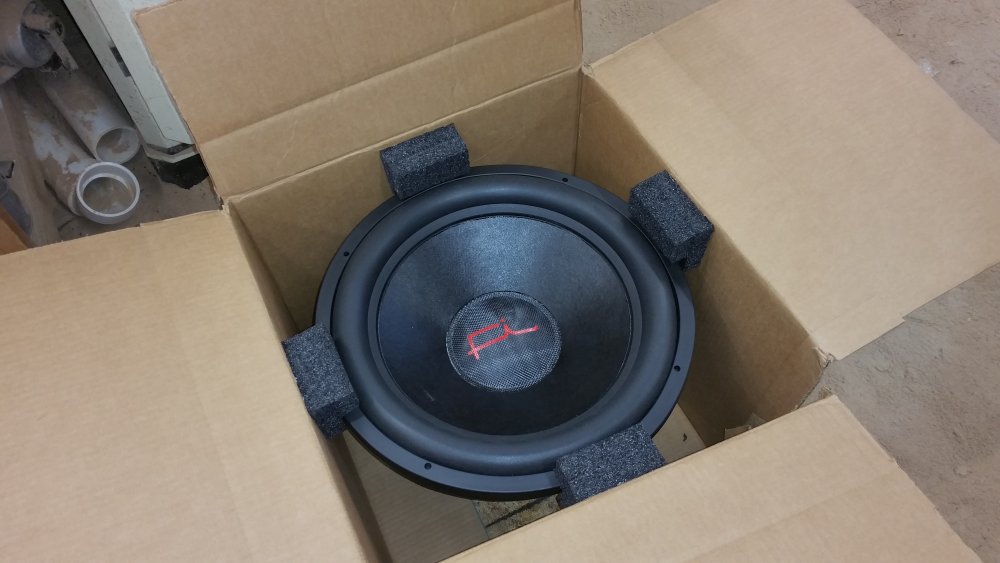

audiofanaticz Posted February 11, 2017 Report Posted February 11, 2017 3 hours ago, Wannabe said: i just want to let everyone know that i really appreciate all you guys help skullz, skippyj, moz vhe, and anyone else i am forgetting big shout out to brian ( audiofanaticz) for all the help and for an amazingly professional box and service all at an amazing price!!!! could not have been happier it took almost 2 months to finish but im finally done!! and im completely happy with it Glad you enjoy it. Like I said that woofer is stupid stiff, it will really come alive once she loosens up a bit so keep hammering her! 3 hours ago, SnowDrifter said: Meh @audiofanaticz just repurposes PWK designs PWK wishes ?

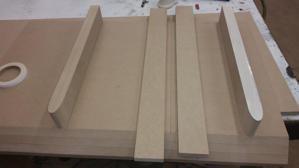

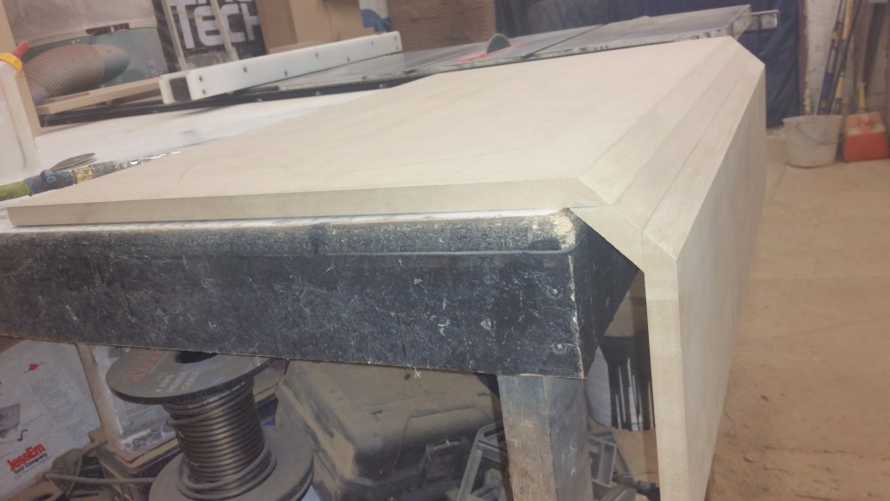

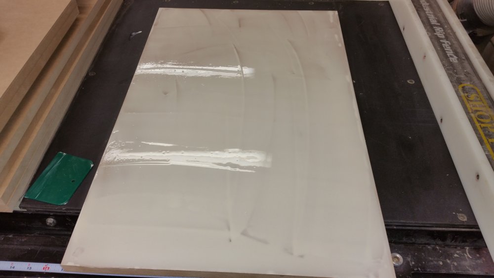

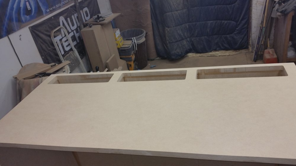

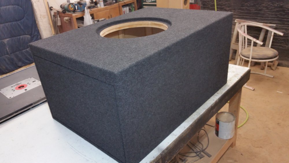

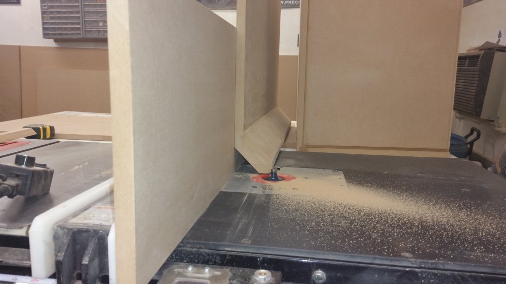

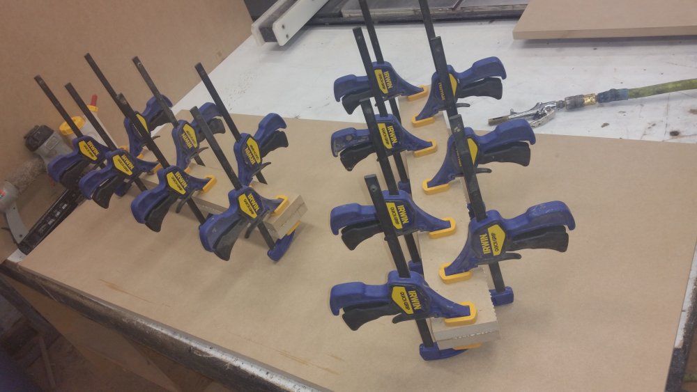

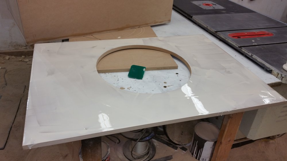

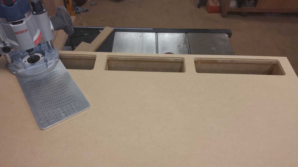

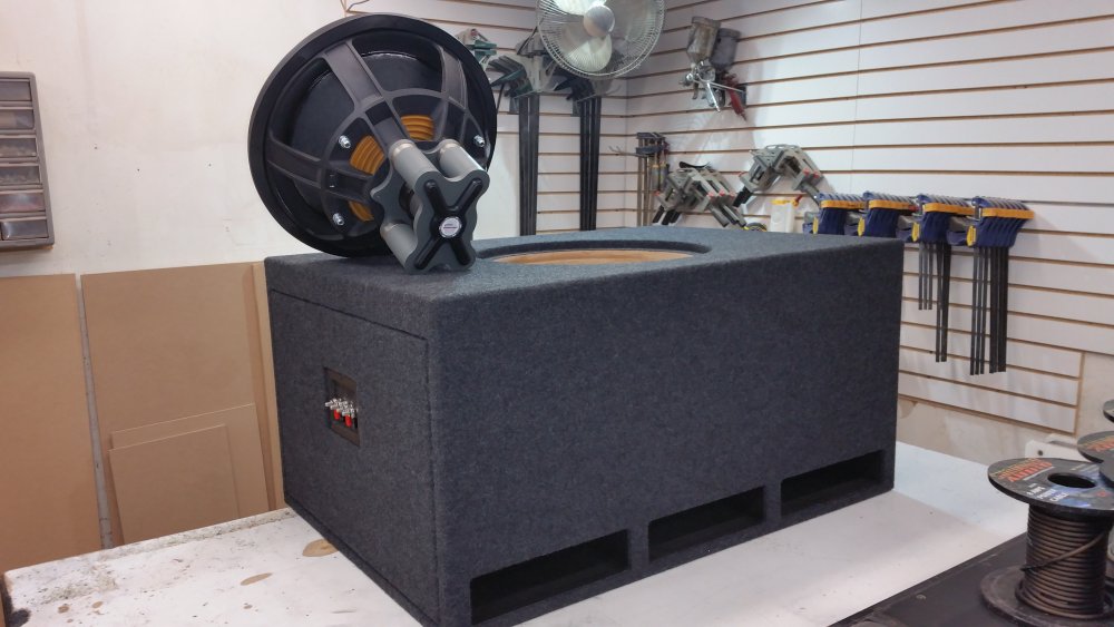

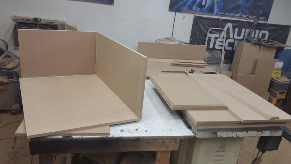

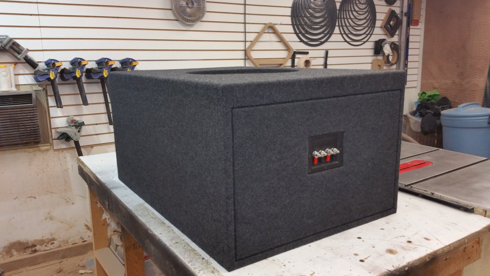

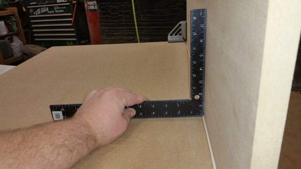

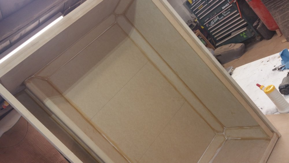

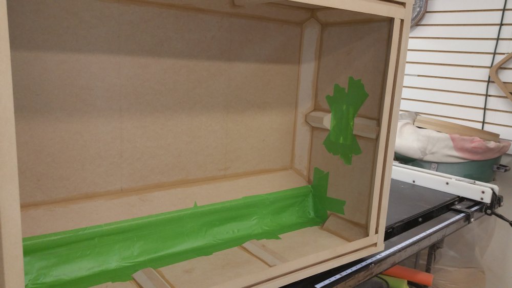

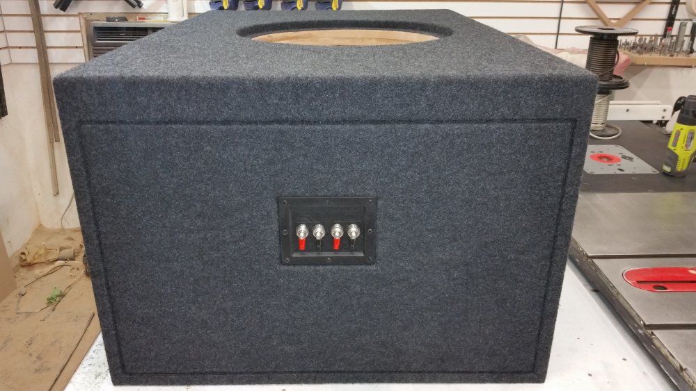

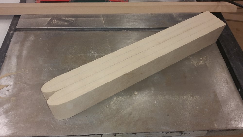

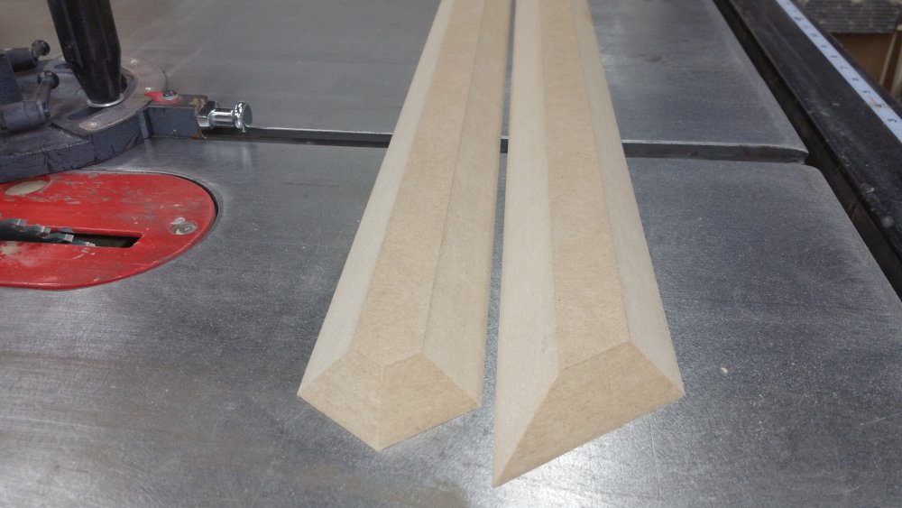

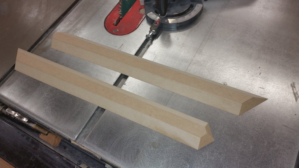

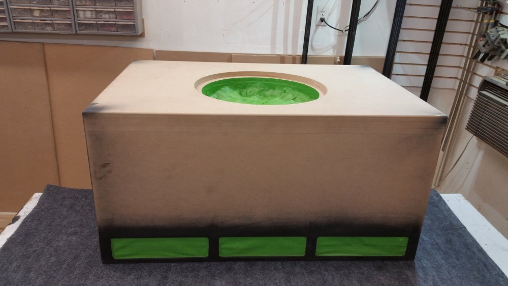

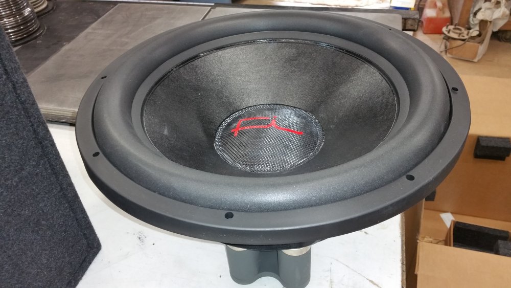

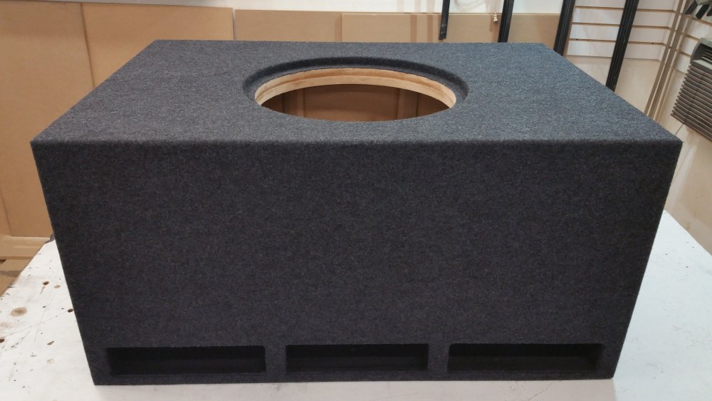

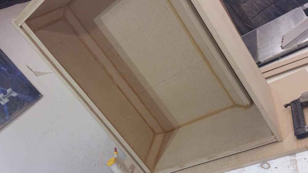

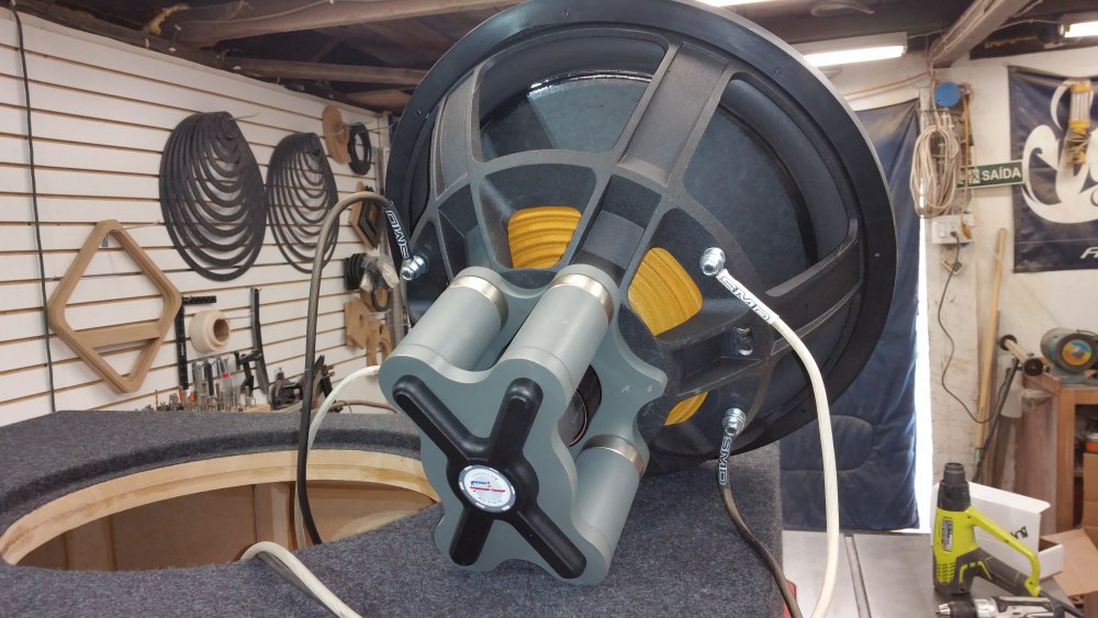

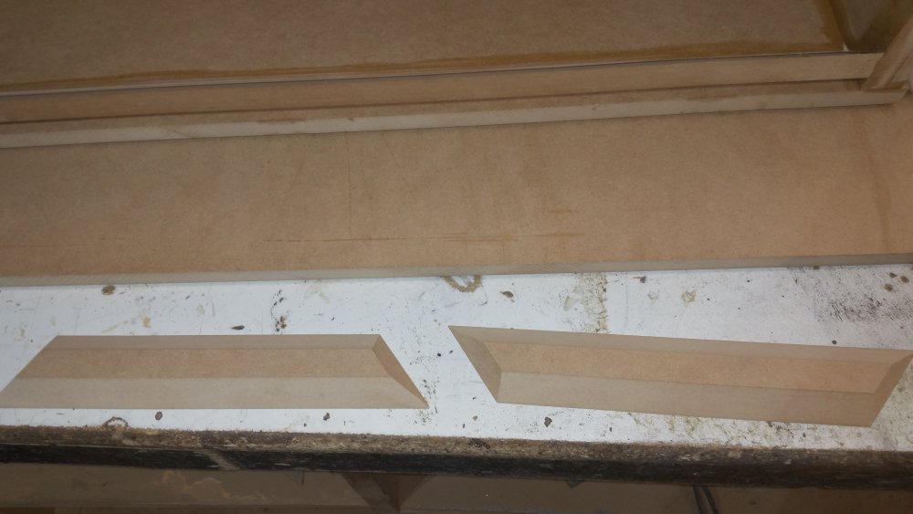

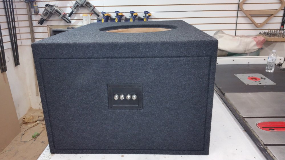

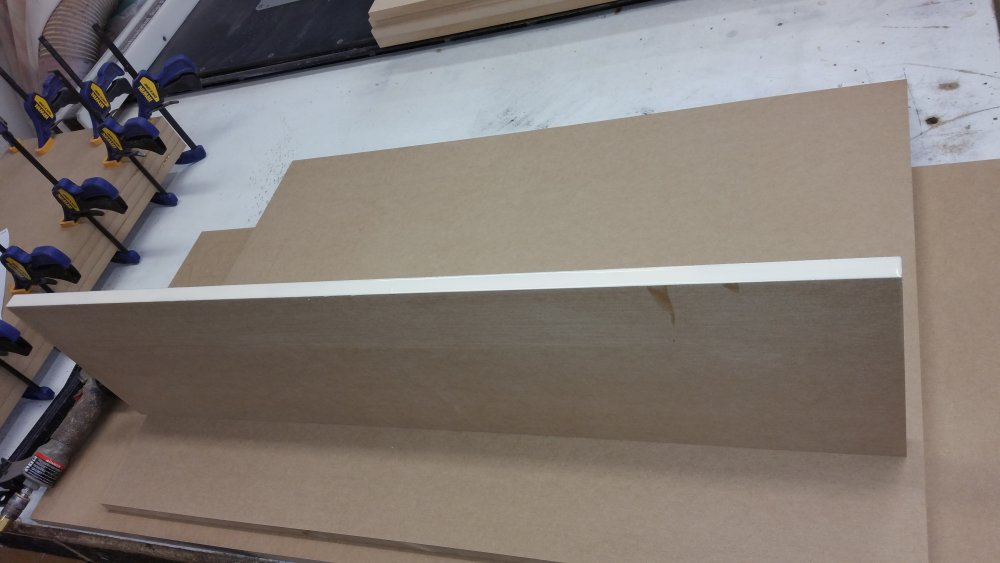

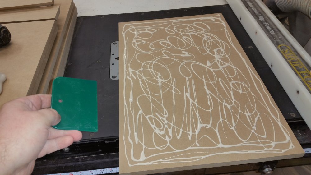

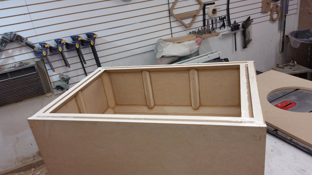

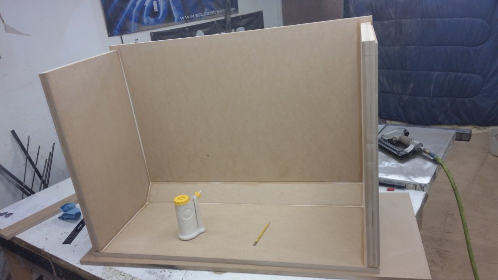

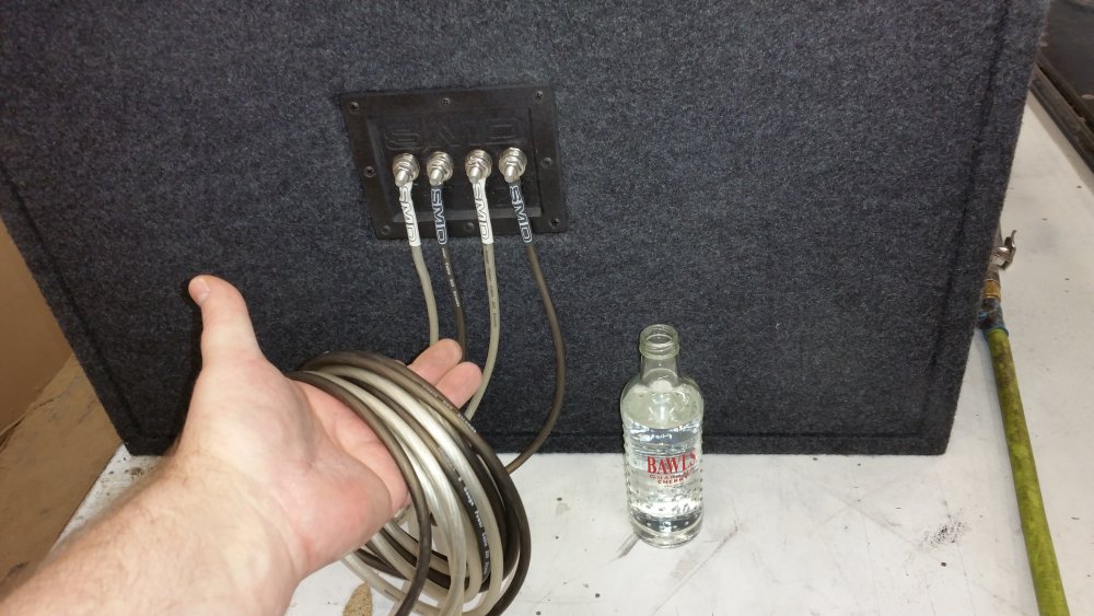

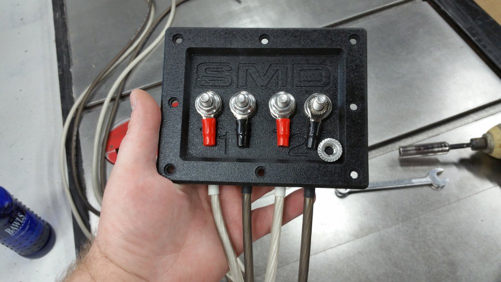

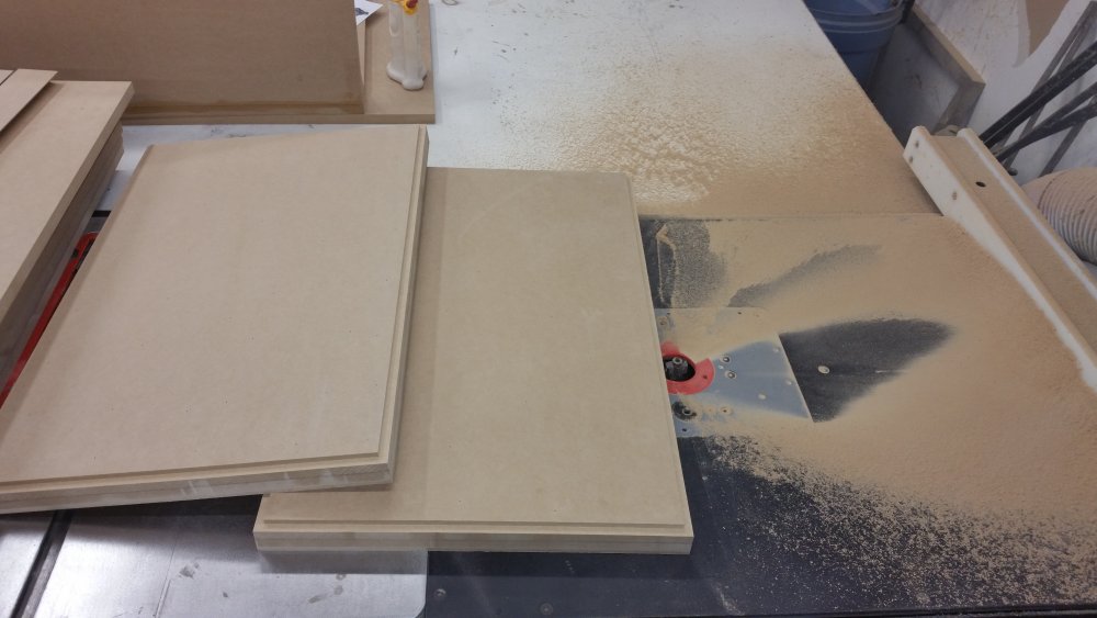

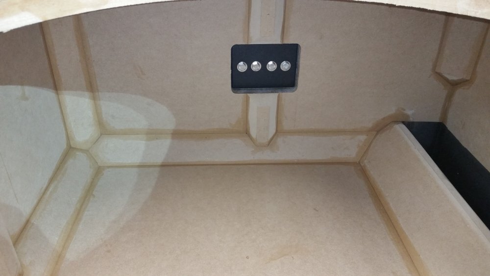

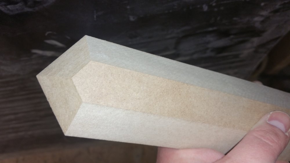

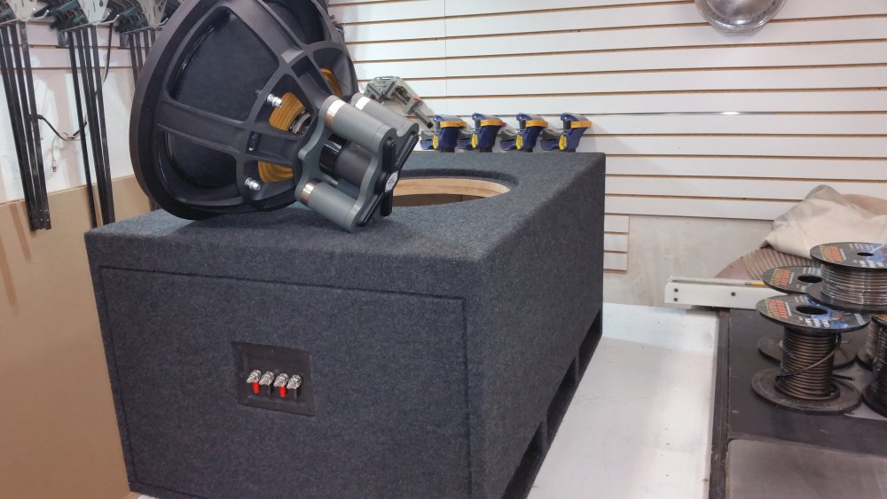

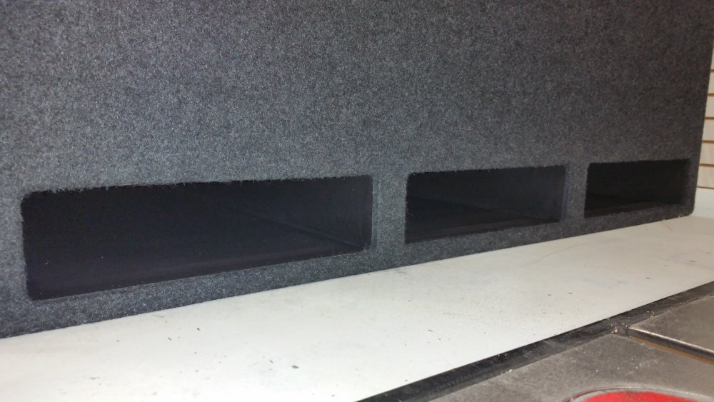

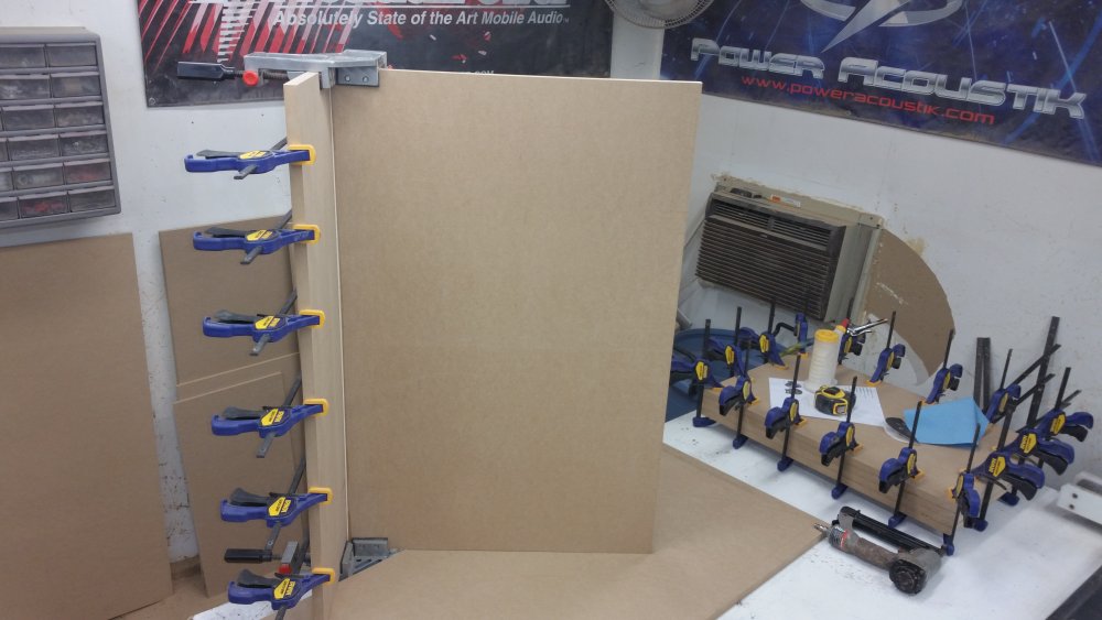

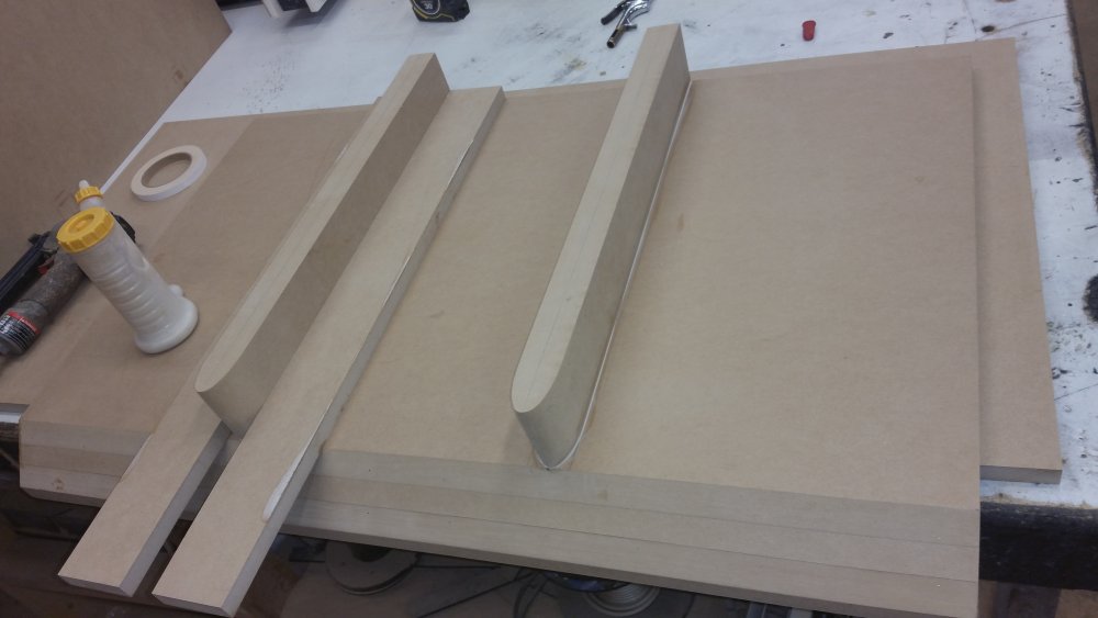

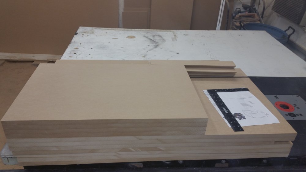

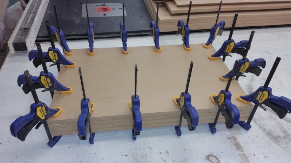

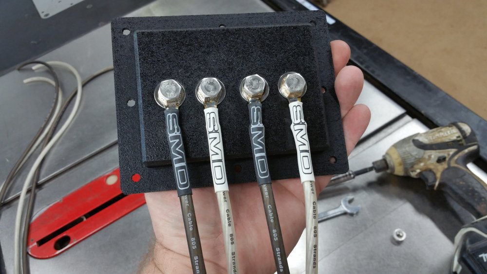

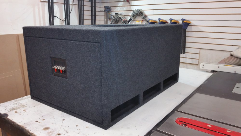

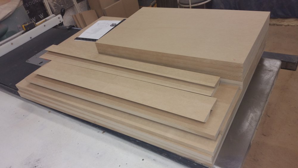

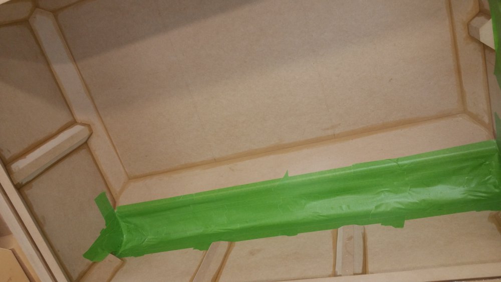

audiofanaticz Posted February 11, 2017 Report Posted February 11, 2017 3 hours ago, Triticum Agricolam said: Lets see some pics of the box!
