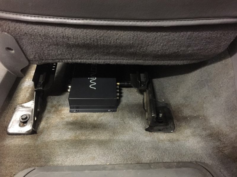

The plan is to use the MiniDSP to control the crossover points between my tweeters, mids, and subwoofer.  Then I can do time alignment and all that cool stuff.  This means I need to remove the passive crossovers from the mids/tweets and power each thing individually.  That's where the Kenwood 4-channel amp comes in.  The MiniDSP is hopefully going to go under the drivers seat and the 4-channel amp under the passengers seat.
Looks like the MiniDSP should fit.  My carpet is totally gross, thanks to some previous owner, I've tried to clean it but it just didn't make a difference.  I'm OK with it, it would end up looking that way where I live anyway.

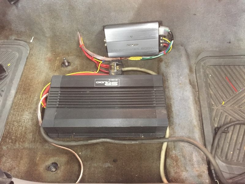

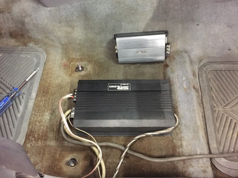

And here is the sub amp and mids/tweets amp.
Here it is after I got all the wire ran:

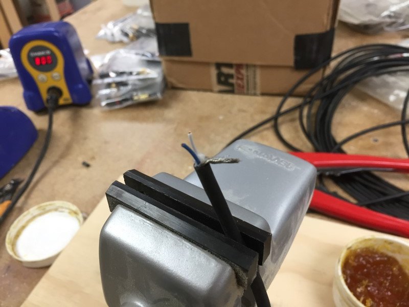

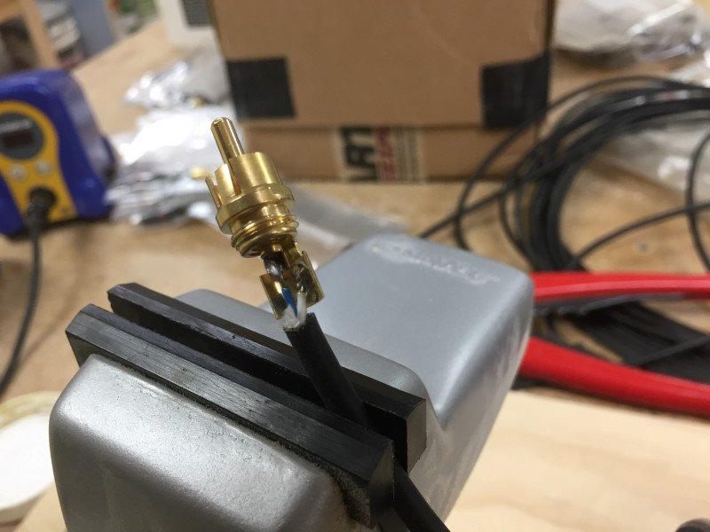

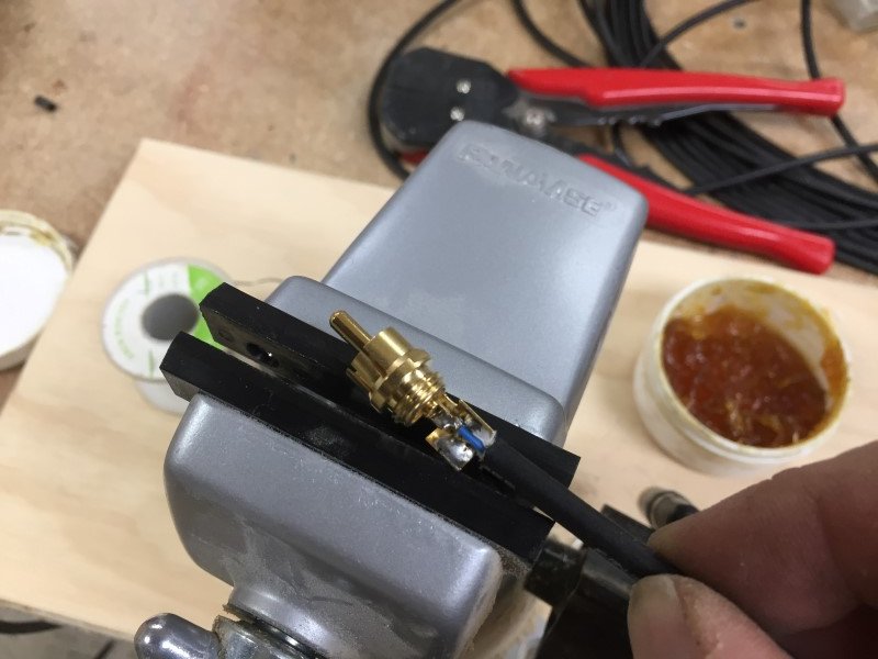

I'm making my own RCA interconnect cables.  Its way cheaper and I can get exactly the lengths I need.  These really aren't hard to make if you know how to solder.
I'm using Canare L-2E5 cable and Rean NYS373 connectors.  The cable has two conductors and is shielded.  High quality cable doesn't have to be large in diameter.  I ground the shield only on the upstream end to hopefully prevent any unwanted noise for ending up down stream.
Here you can see the conductors and the shield:
Soldering on the end, this was on the downstream side:
5a33f8352f028_2017-12-1113_57_32.jpg.98959d542d2d39a7933d0d4346816725.jpg5a33f837bcd5d_2017-12-1114_02_45.jpg.cbdecedcd68a1058f0111f8fc4b45ca6.jpg

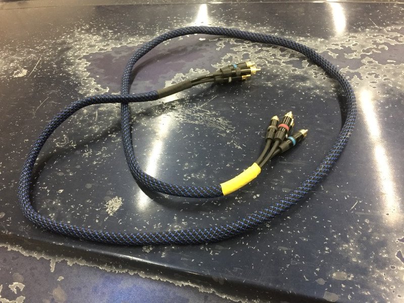

Here is the finished cable after I put some techflex on it:
