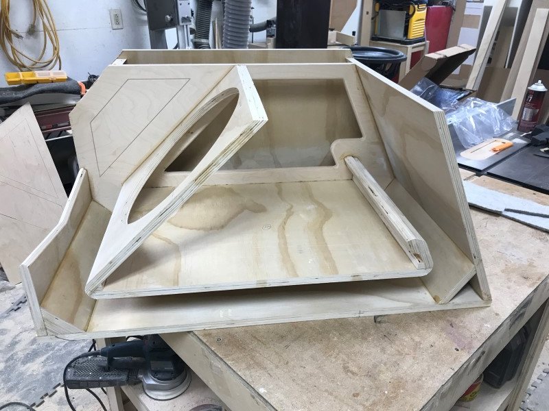

That bracing...and the solid 45. Shoot that's nice Triticum. Trying to imagine that ear goodness! Tuned

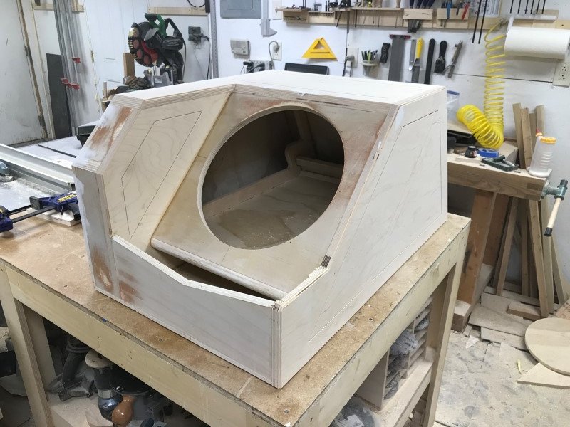

Thanks!  The solid 45 is there so I can trim back the front edge quite a bit to fit around my tailgate latch.

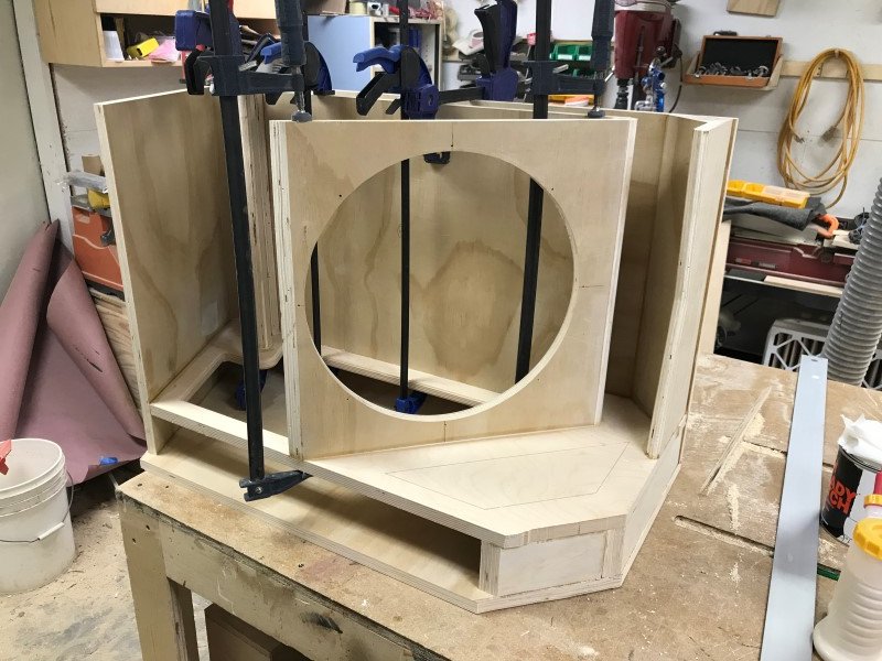

Here are some more pics, the glue up is finished.
1100196903_2018-06-1121_41_27.jpg.434224ccda3ea083670f2729f0c5cab4.jpg1217557765_2018-06-1208_27_38.jpg.8fb0cbfb81ab52b8739142372c5d7b17.jpg1306305473_2018-06-1208_51_51.jpg.3b820fb300c9e3e877646ad81ac20a7a.jpg
Builds:

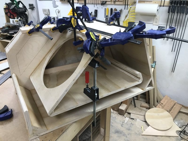

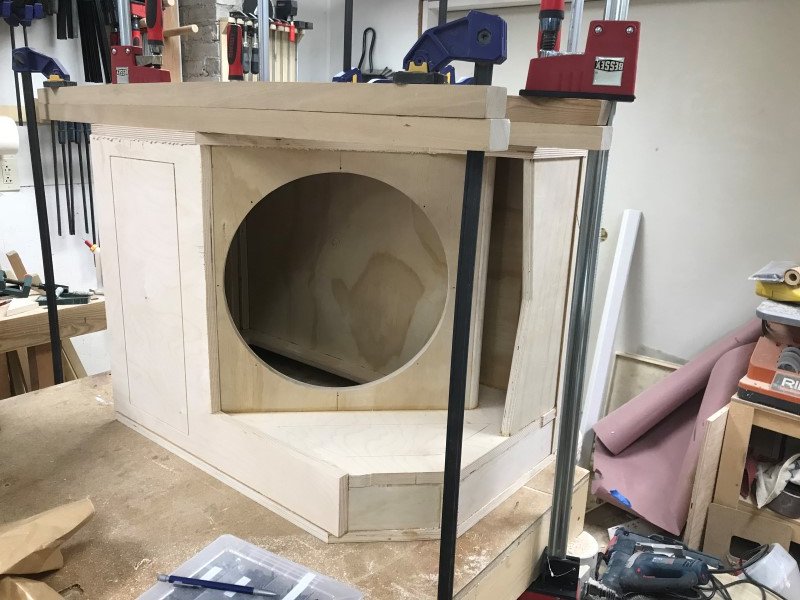

More progress, glue up is all done:
Time to clean up the edges some:

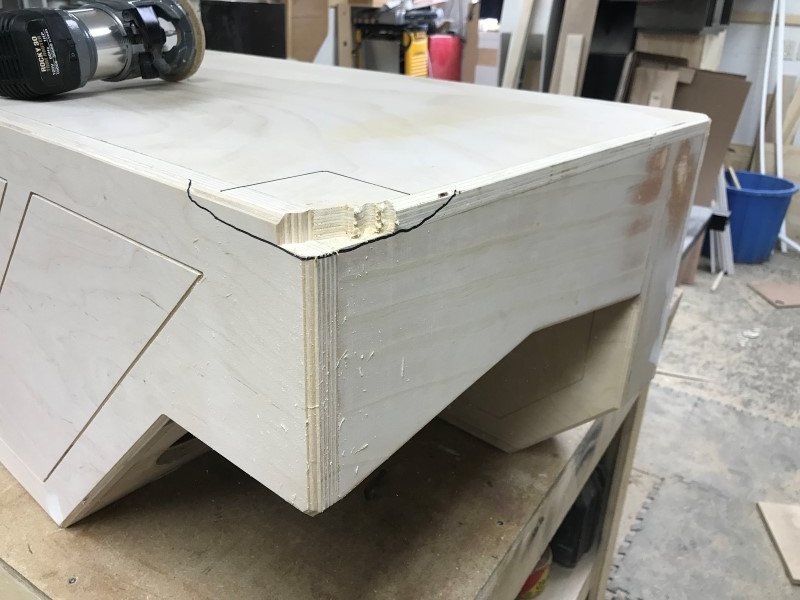

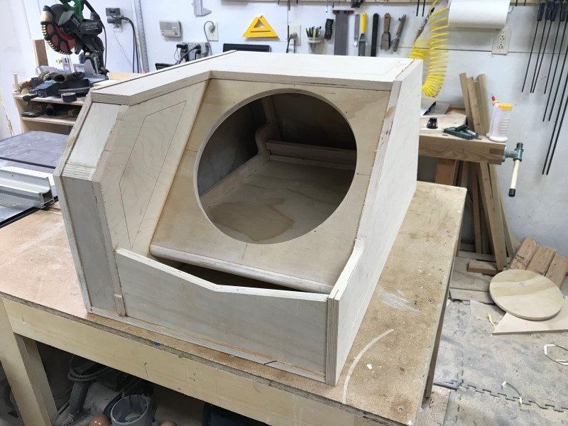

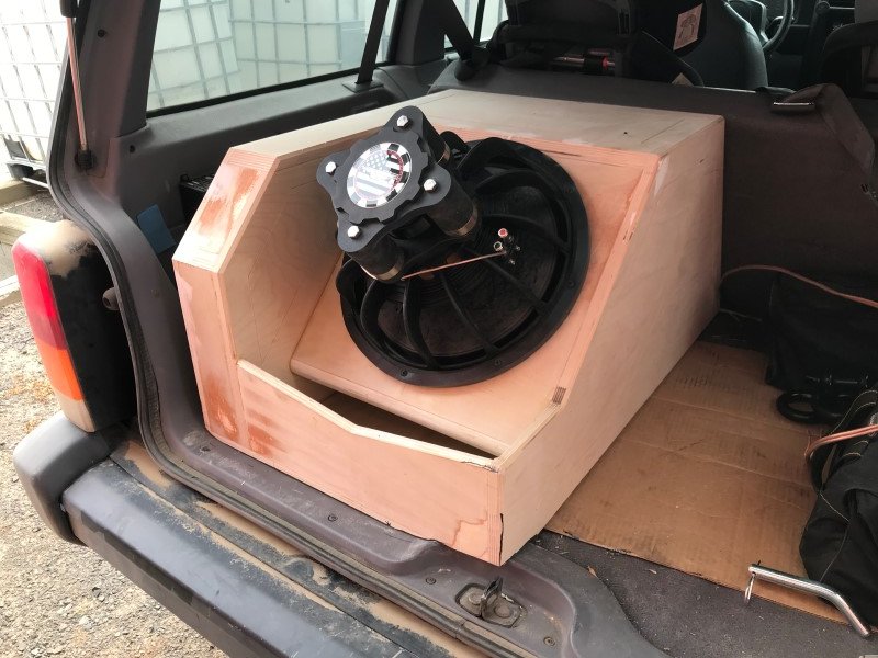

I need to cut a relief to clear my tailgate latch:
Time for a test fit:
Now I just need to make it pretty.
Builds:
WOW !!! That enclosure is insane !!! Nice work !!!

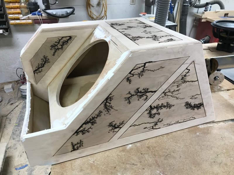

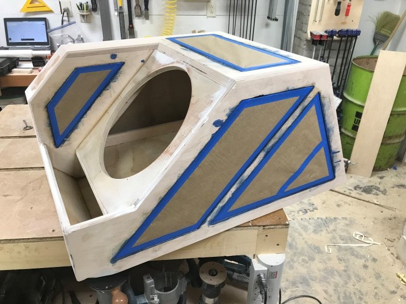

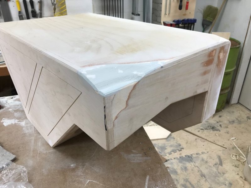

Put some more time in on the box.  I cleaned up where I had to cut a recess for the latch and filled everything in with body filler:

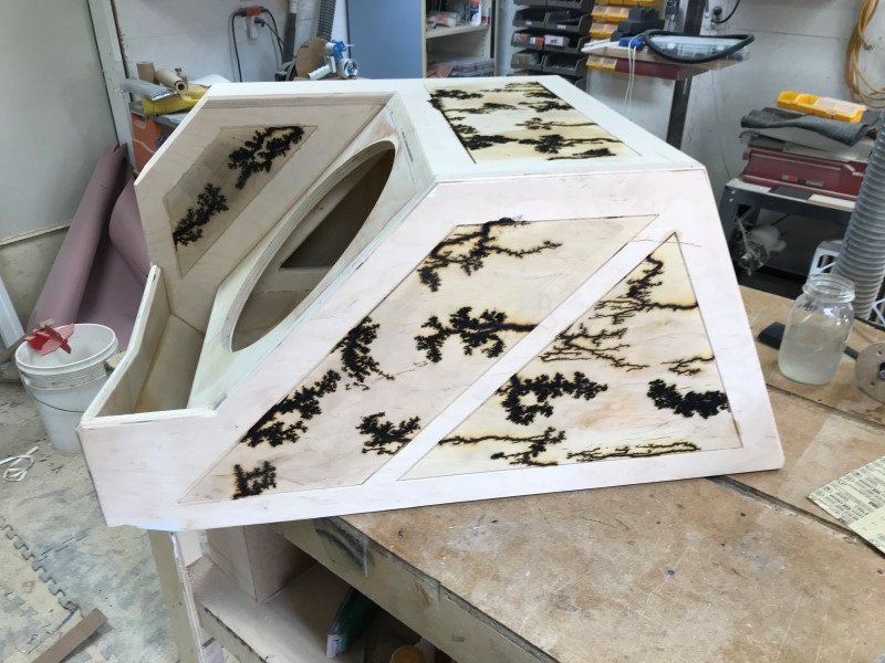

Did a lot of general surface prep, filling, sanding, etc.  Now its time for the fun stuff, some Lichtenberg pyrography:

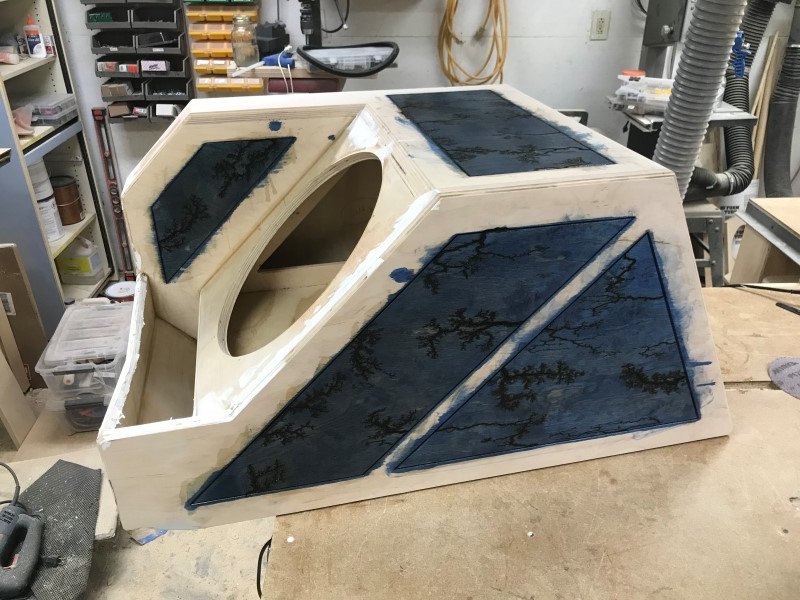

Its a multistep process, here it is after being cleaned up:

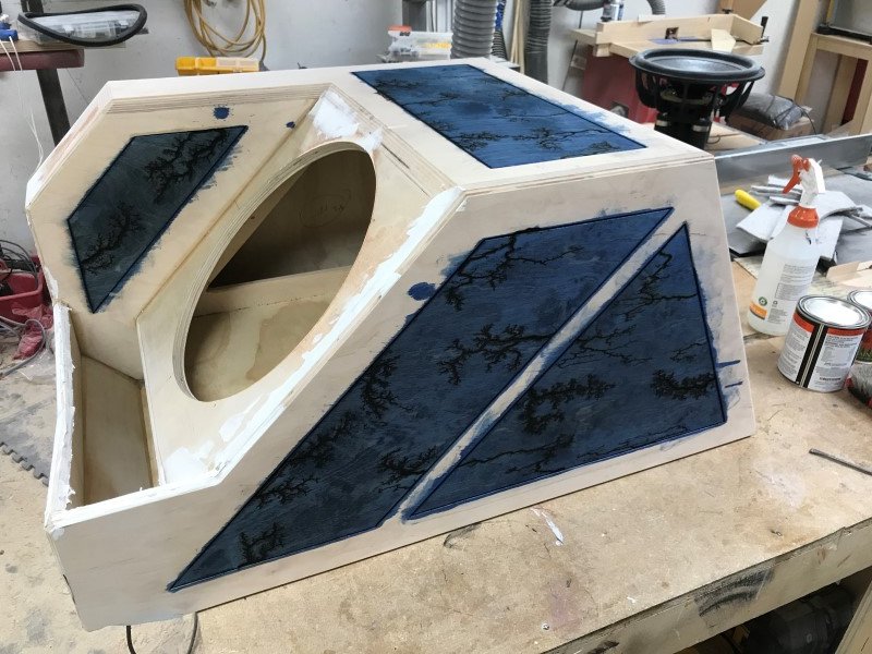

And after some stain, the stain makes the wood look dull, but it will brighten up after some clear coat:

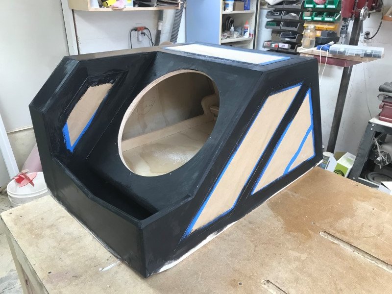

Put some clear on it and go it taped off for paint.
Got the first coat of primer black down:

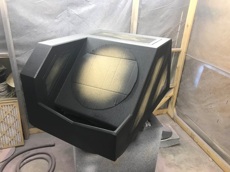

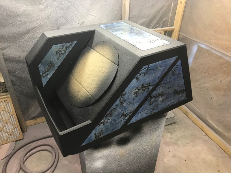

I'm going to spray it in black Duratex, which should look a million times better than the black paint does, but it helps me see where I need to do some more filling and sanding.
Builds:
Here it is after spraying on the black Duratex:
And after removing the masking:
So far I'm pretty happy with it.  I have some more cleanup to do and then I plan on carpeting the bottom and left side of the box.
