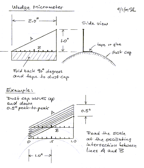

Triticum Agricolam Posted June 23, 2017 Report Posted June 23, 2017 That's weird. The first thing you might try is making a could wedge micrometers (all you need is some note cards and some tape), then you can check and see if you are getting different amount of excursion. "Nothing prevents people from knowing the truth more than the belief they already know it.""Making bass is easy, making music is the hard part."Builds:
