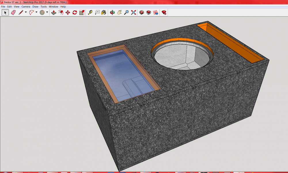

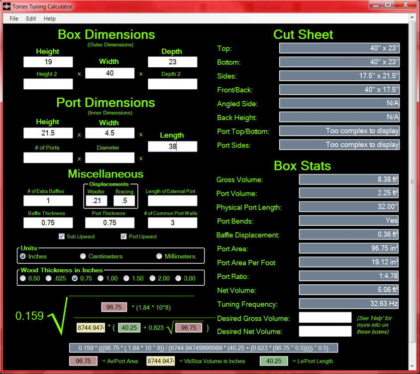

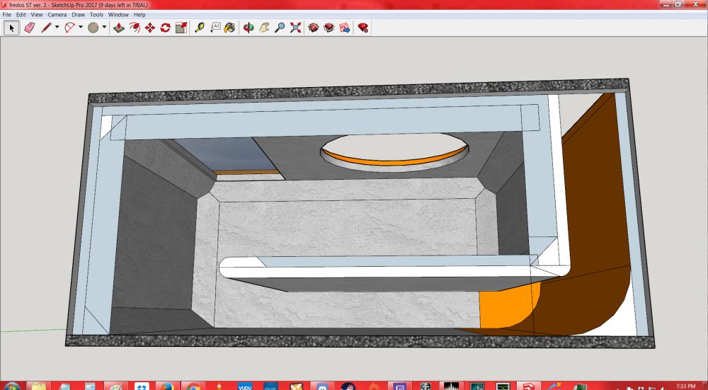

I am Poncho Posted July 10, 2017 Author Report Posted July 10, 2017 I meant to post pictures last night, but i didnt realize how late it was and went to bed instead. But now for a small pic dump... This is the current prospect of the enclosure... OLD BUILD LOG: http://www.stevemeadedesigns.com/board/topic/166273-poncho-designs-trailblazer/ New car, new build coming soon...

I am Poncho Posted July 10, 2017 Author Report Posted July 10, 2017 It will be finished with some kind of bedliner, were up to suggestions on that, probably raptor liner or possibly monstaliner. I would like to line the interior in a white liner but that may be excessive and might just end up spraying it white instead.. 3/4 acrylic window, will probably and some bracing dowels. OLD BUILD LOG: http://www.stevemeadedesigns.com/board/topic/166273-poncho-designs-trailblazer/ New car, new build coming soon...
