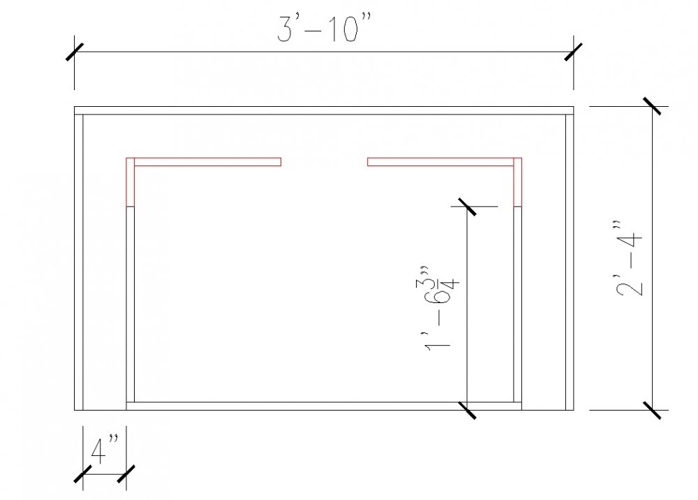

Triticum Agricolam Posted September 1, 2017 Report Posted September 1, 2017 What are the specs on your box? I'm looking for net volume, port dimensions, & tuning frequency. Efficiency measurements on subwoofers are nearly meaningless. There is no standard way to measure them. Based on what you have described I think upgrading to the 15" s will be a worthwhile thing to do, but I'd like to hear what your box specs are. "Nothing prevents people from knowing the truth more than the belief they already know it.""Making bass is easy, making music is the hard part."Builds:
Daniel644 Posted September 1, 2017 Author Report Posted September 1, 2017 2 hours ago, Triticum Agricolam said: What are the specs on your box? I'm looking for net volume, port dimensions, & tuning frequency. Efficiency measurements on subwoofers are nearly meaningless. There is no standard way to measure them. Based on what you have described I think upgrading to the 15" s will be a worthwhile thing to do, but I'd like to hear what your box specs are. attached are shots of the original design which never got the center section divider shown in the wireframe model (so it has shared airspace and the later revision to the box (which involved removing the existing port sections and install new longer ones to the length depicted in the drawings) to tweak the tuning frequency where I significantly lengthened the ports, calculations put the raw interior (factoring out board thicknesses) volume (not counting ports or speaker displacement at 6.828342013888889 Cubic Feet port openings are 4 inch wide by 15.5 inches tall for a total between the 2 of 124 square inches of port, should calculate out to like 35Hz if I did my math right. would be like 3.204 CuFt per sub after accounting for sub displacement of the level 4's.
