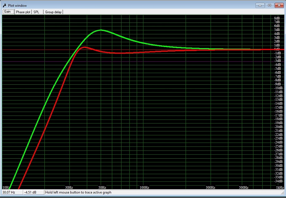

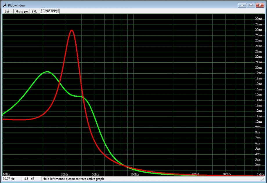

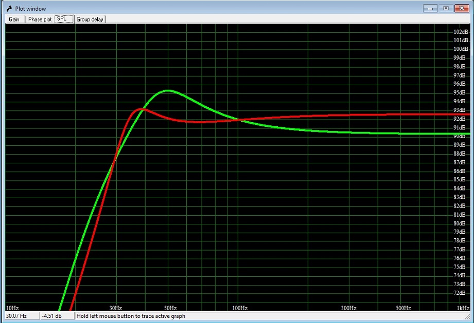

Daniel644 Posted September 20, 2017 Author Report Posted September 20, 2017 1 hour ago, CstrokerV said: oh didnt know they kept the older ssds i thought the neos replaced them that amp is 2000rms at 1ohm and doing less so under rms for the ssds at 1250 a piece and probably about right for the lvl3s 900 a piece undistorted that amp is probably only doing 1800 if it follows f the othe hifonics that been dynoed yeah, it looks like they ditched the regular Q's but give either magnet/motor choice for the SSD's. I tried messing with WinISD punching in the T/S parameters and details of my box best I could convert them over to metric and if I did it right these are the curves: GAIN: Group Delay: SPL: I know enough to know the green is a faster response time (but I don't know if it matters on this small a scale) and that for most of the subwoofer frequency range the green is a higher output, but does that equate to just being louder? does it effect the sound quality, like would the red give better sound quality since it's an overall flatter curve?

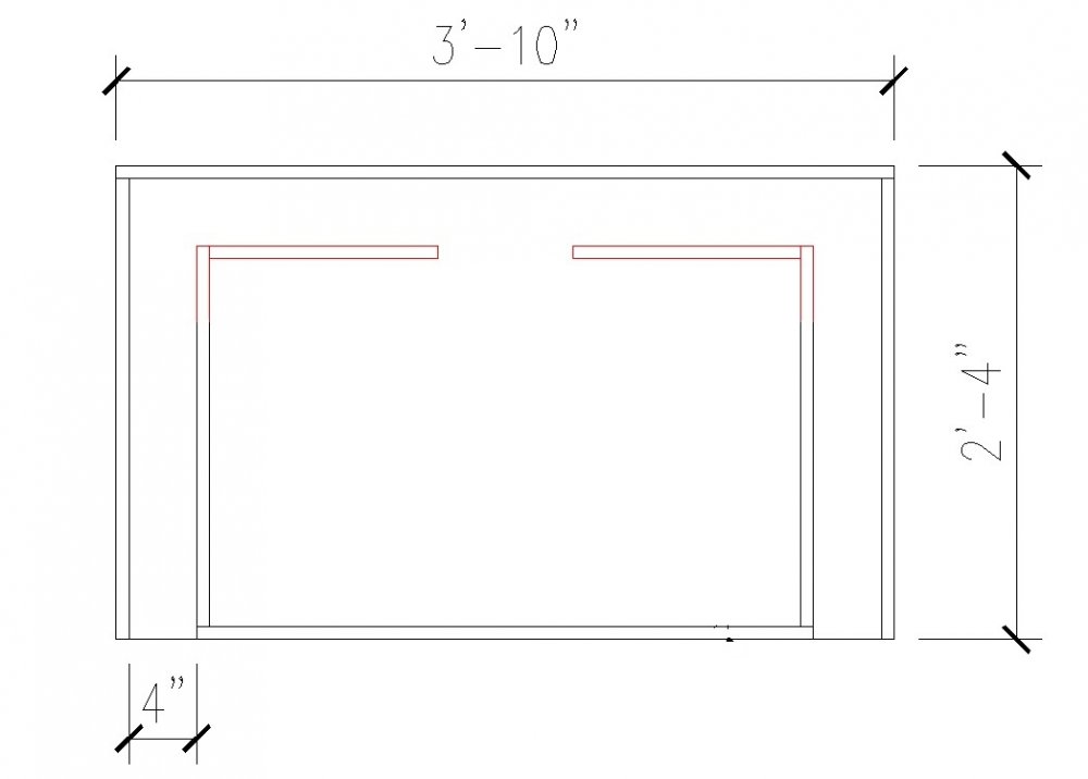

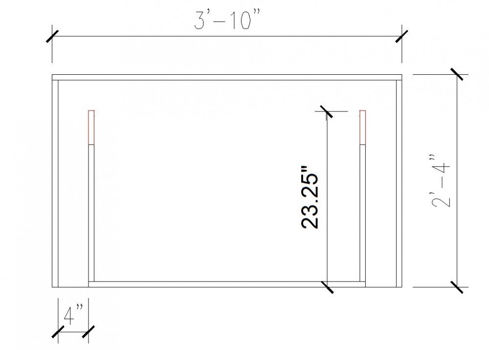

Daniel644 Posted October 15, 2017 Author Report Posted October 15, 2017 OK guys need a little more advise, I ended up getting a pair of DC Audio Level 3 15's (dual 1 ohm, wired in series/parralel to run at 1 ohm total), I was running the numbers and realized I could increase box volume (getting closer to my original design before I lengthened the port, which honestly I liked the sound of better when I had my planet audio subs in there) and only raise the tuning frequency like maybe 1 hertz by simply eliminating the second port piece (which would be fairly easy to do), my concern is this would put the box volume at 3.98 cubes PER SUB (after sub displacement), the level 3's are spec'd for a 3 cube box when ported, can they be safely run at 4 cubes?
MotorCityFats13 Posted October 15, 2017 Report Posted October 15, 2017 rusty told me on one of my posts that as long as I dont seriously over power my level 3 12" I can go 1.75 vs the 1.25 factory recomended so the 15" should follow suit..... start a new thread on the dc section and ask him since he knows what his subs can handle..... but I opted for the AR cone and surround so apples to apples might not compare the same
