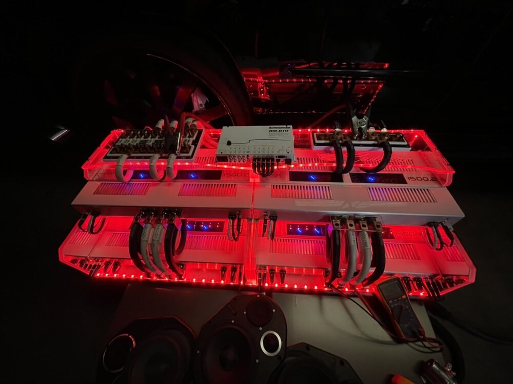

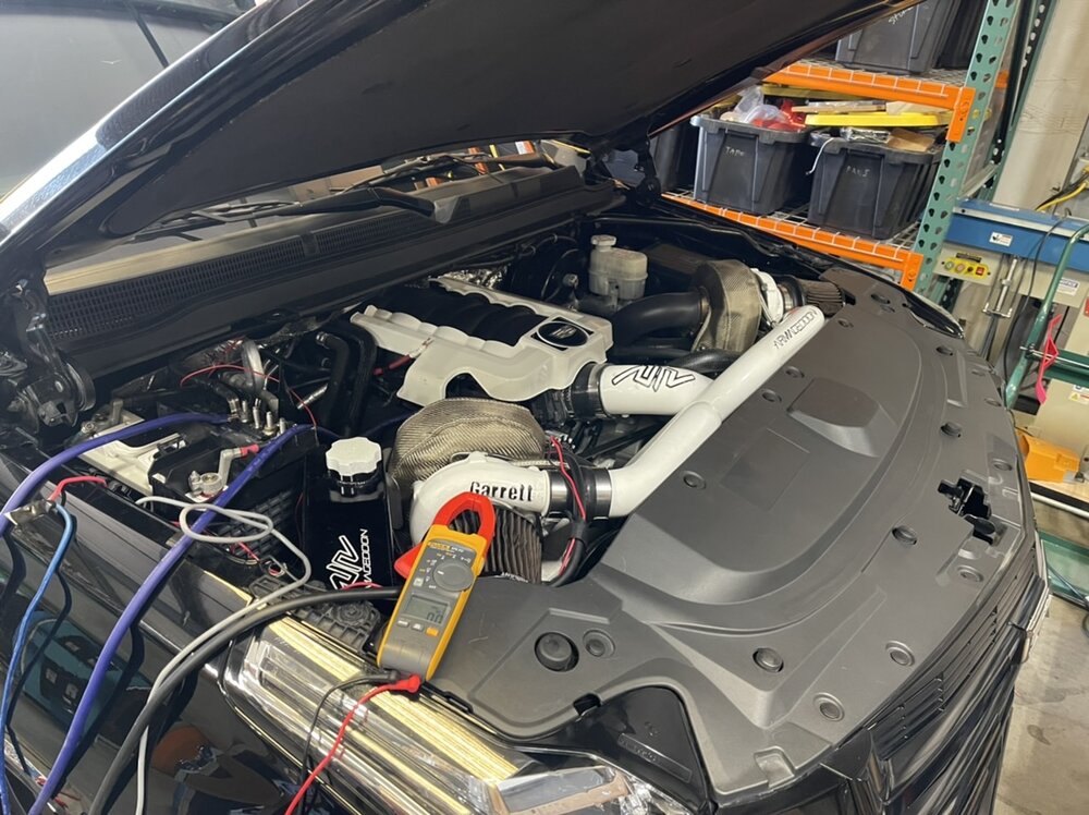

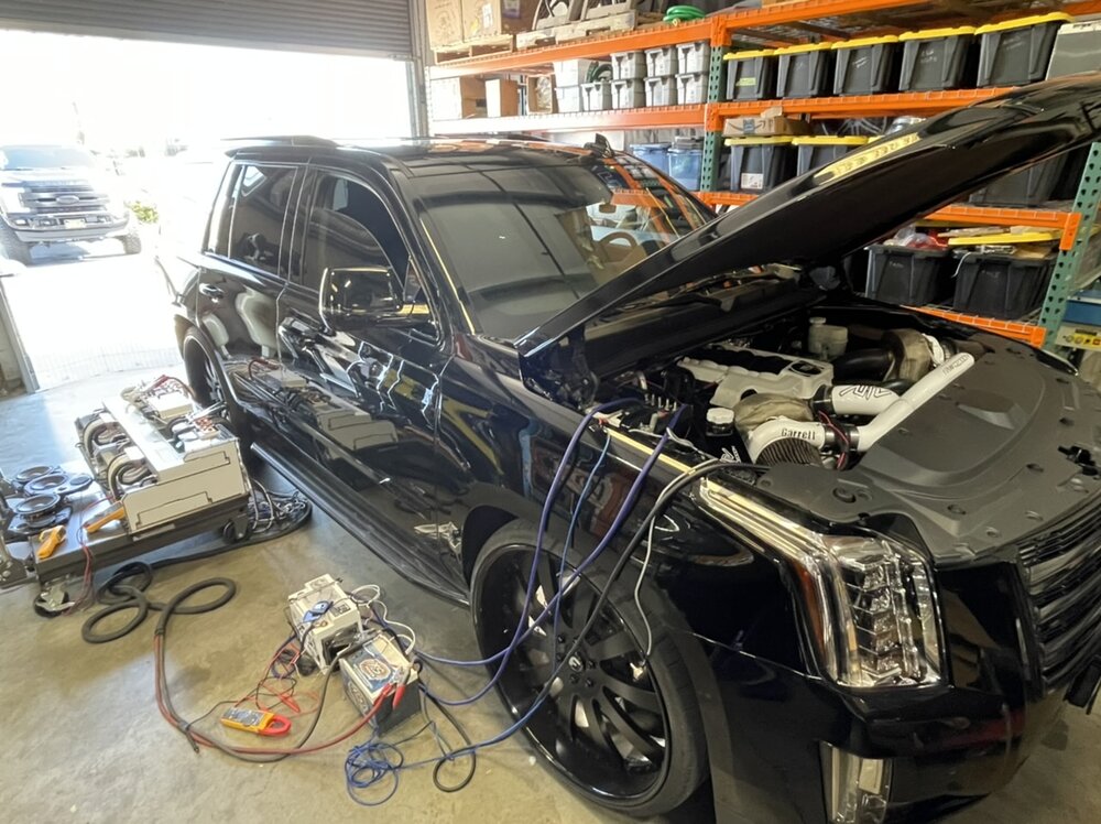

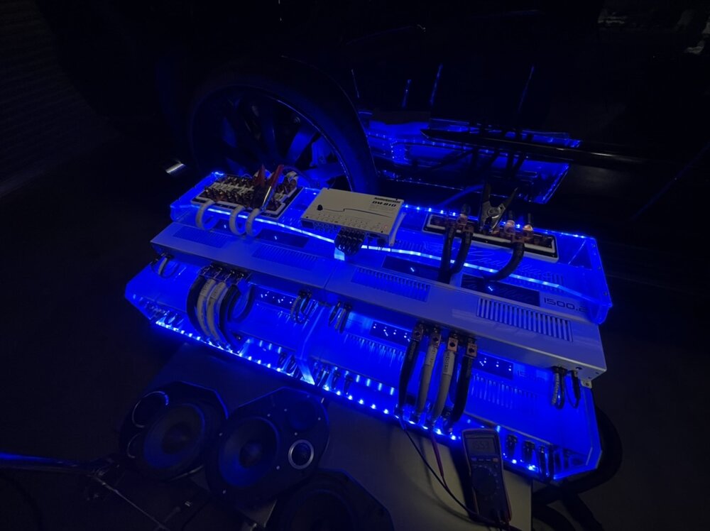

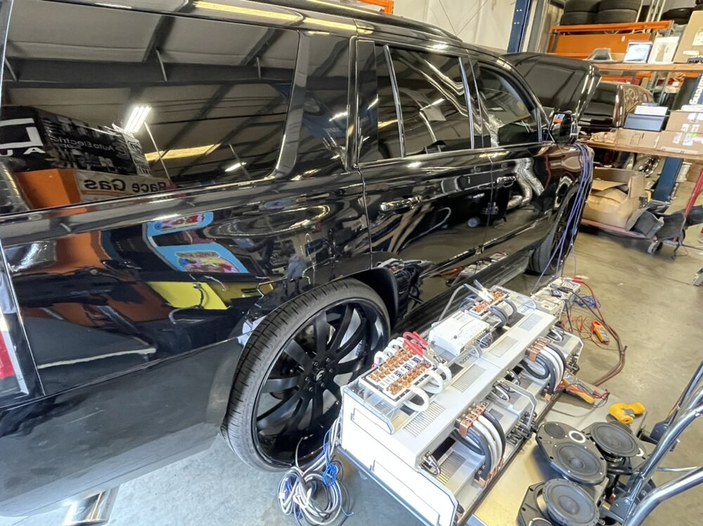

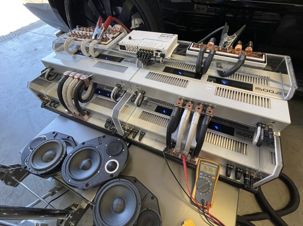

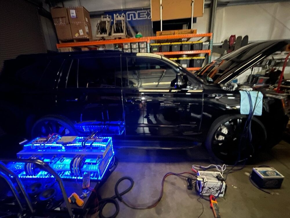

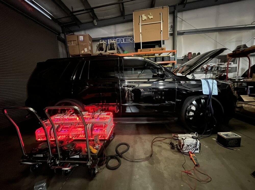

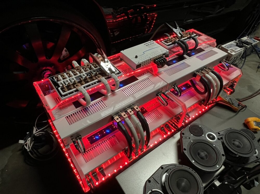

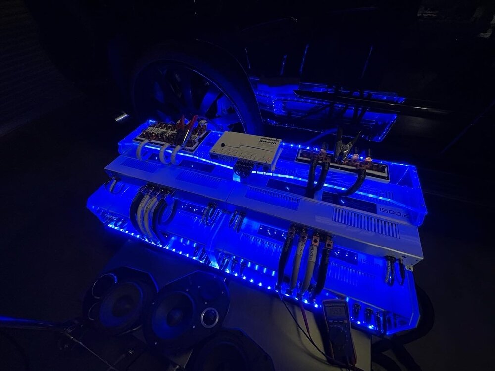

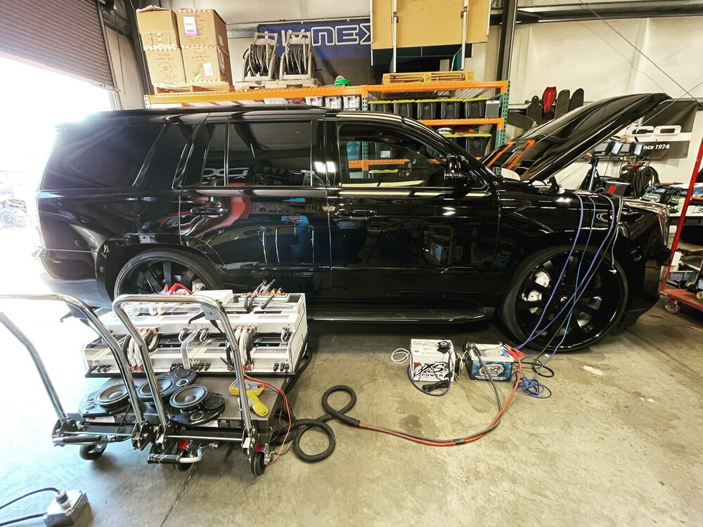

my “test bench” today. 16.3 volts for the system stepped down to 13.5-14v for the vehicle and accessories. Gotta make triple sure everything is good before i put anything in the Caddy. I ran all the stock accessories at the same time at about 100a for 4-5 hours. Watched the temps...the fan cooled the step downs nice!

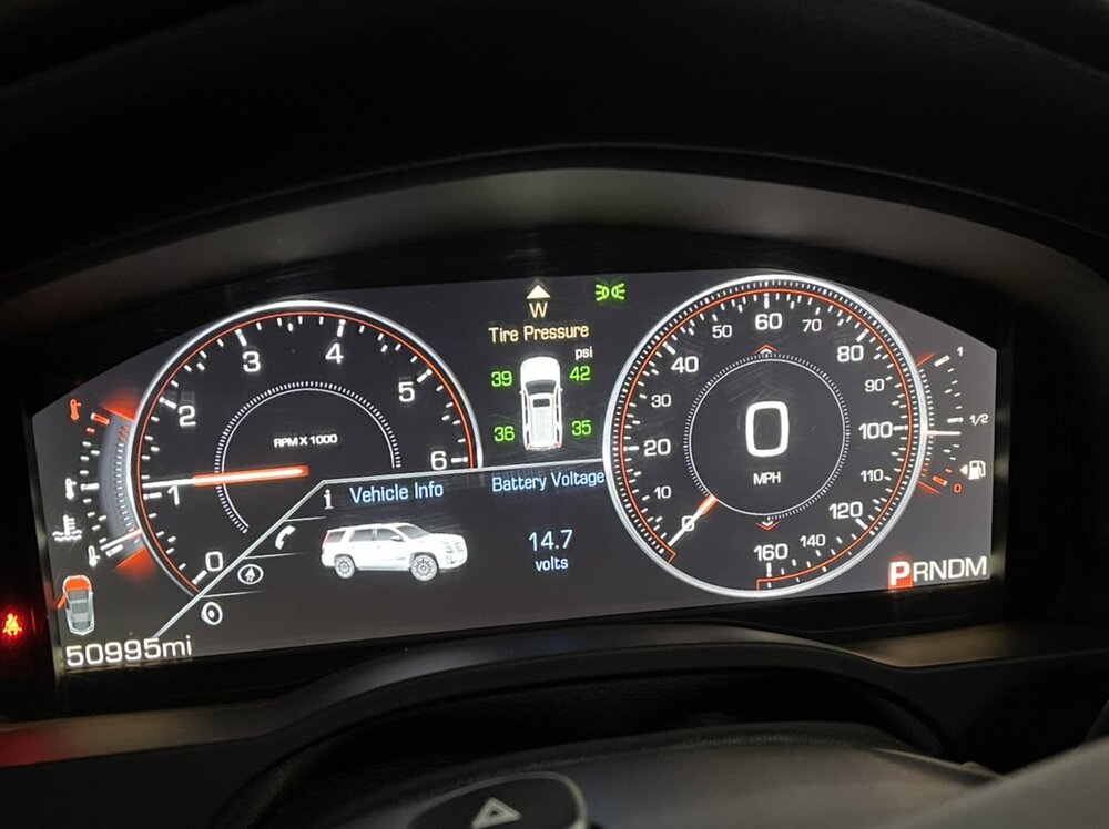

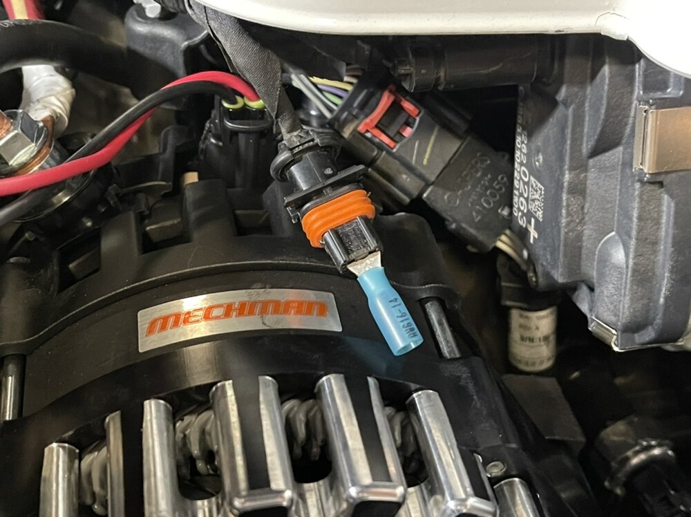

no more pesky battery light! What the fork? haha

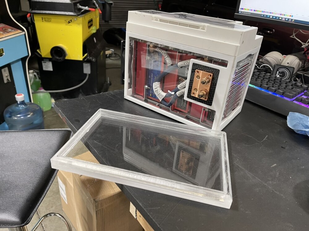

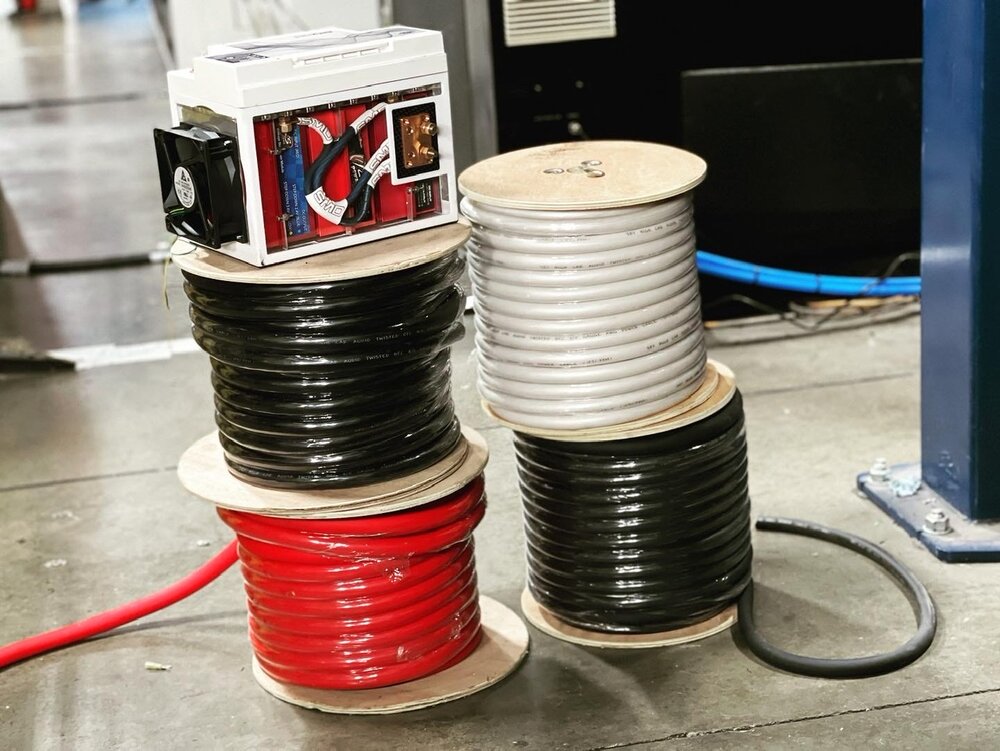

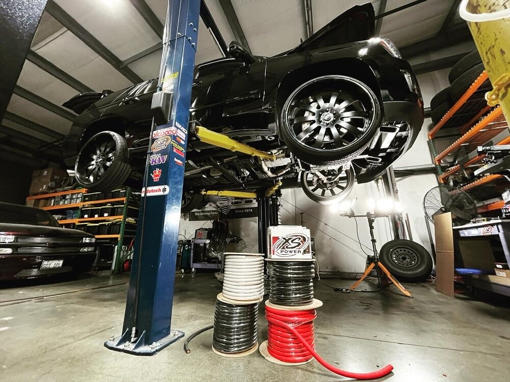

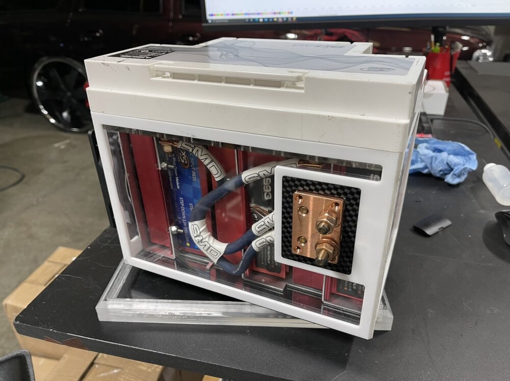

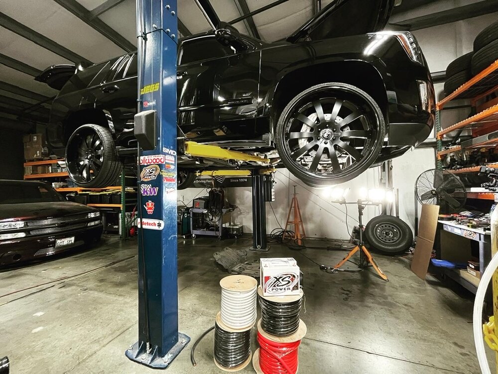

time to run some wiring..but before i do that i need to put this step-down box some place.
Skyhigh Car Audio 2/0 and 4/0 cable ready to go.
Follow my Tweet (Twitter)

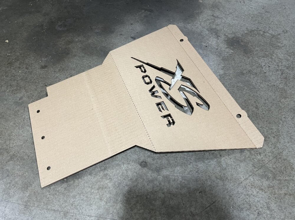

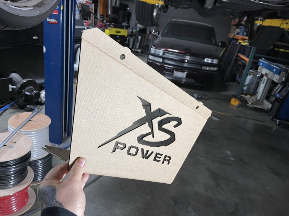

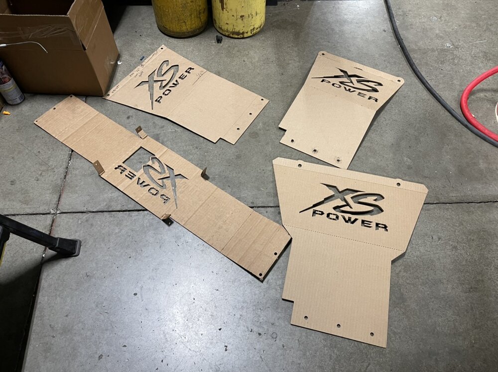

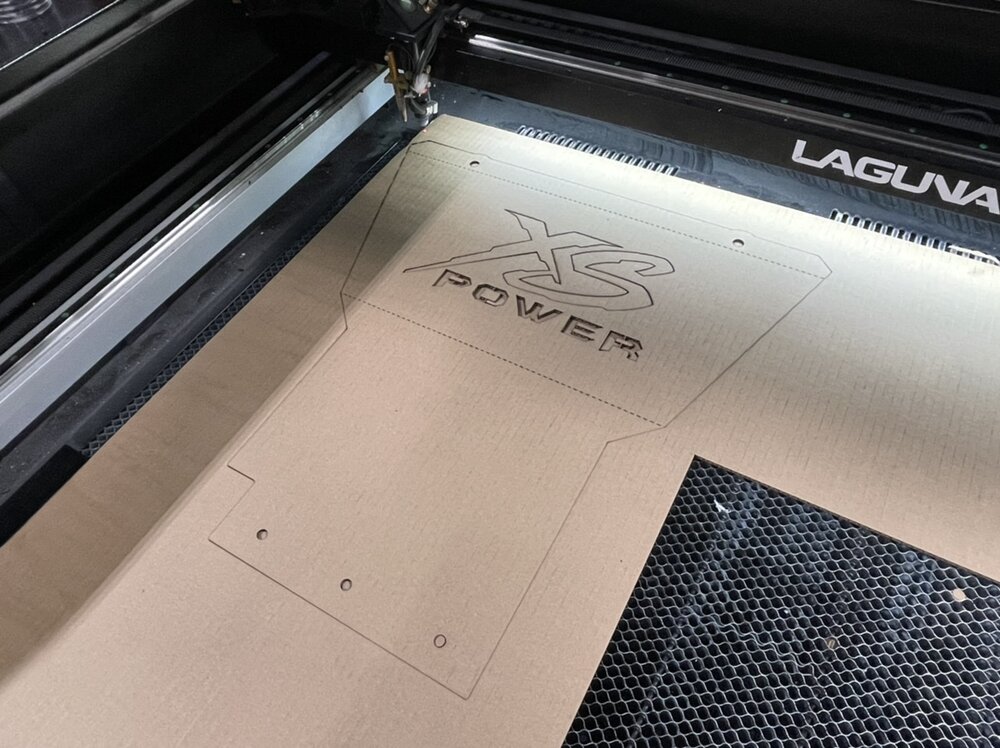

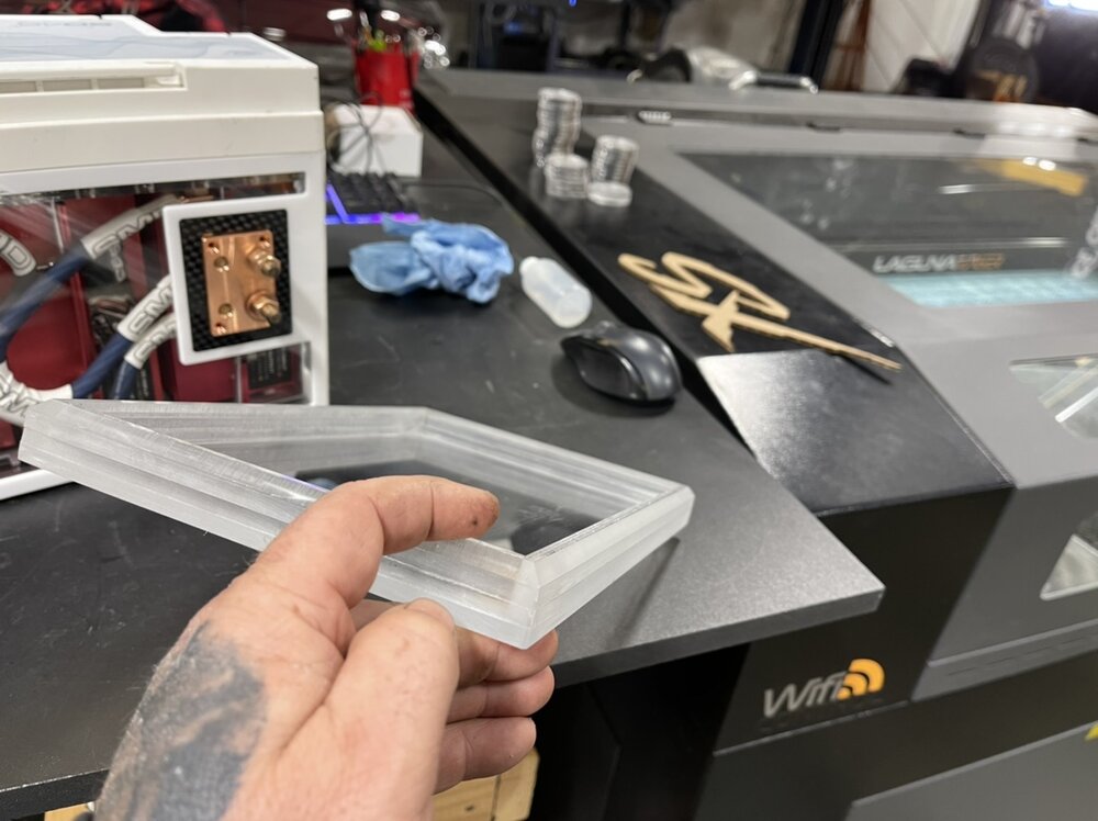

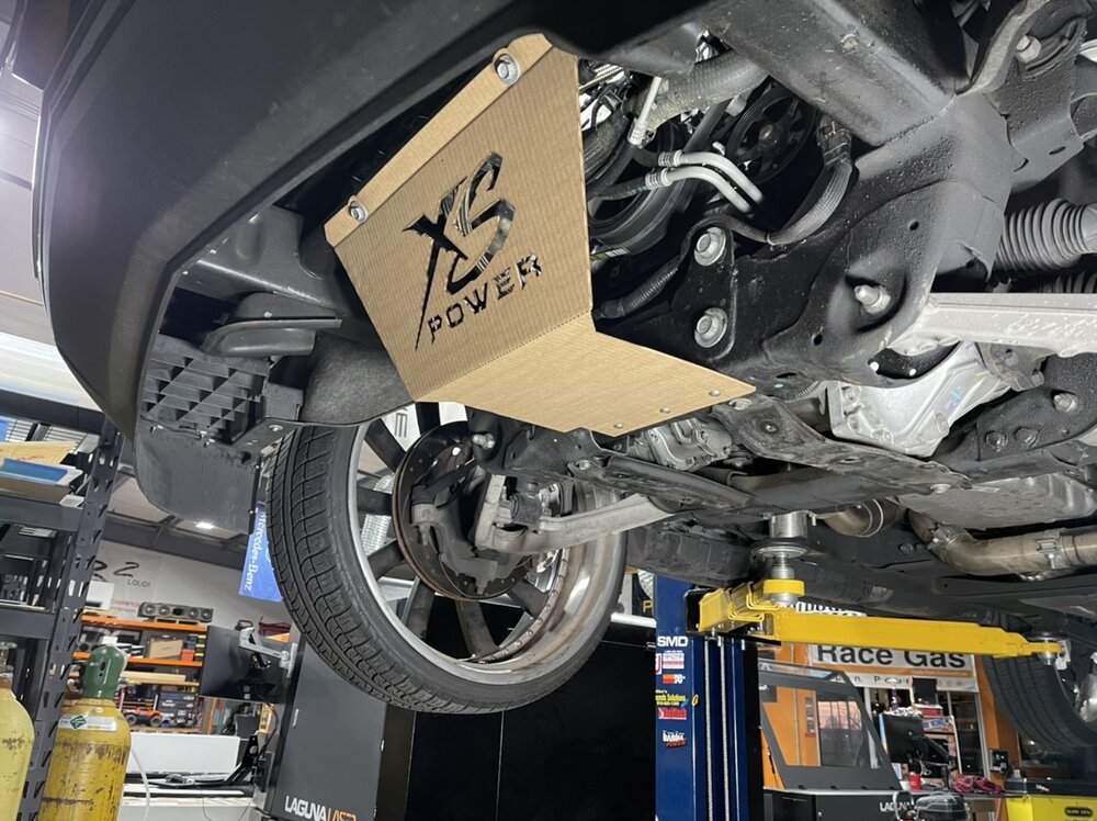

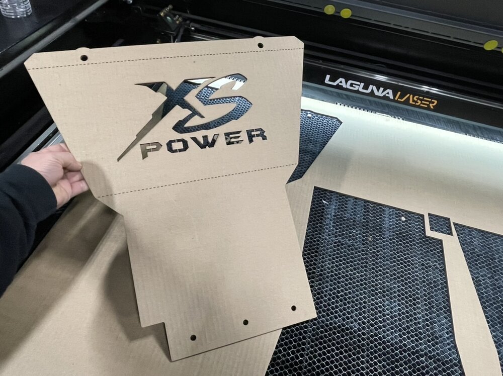

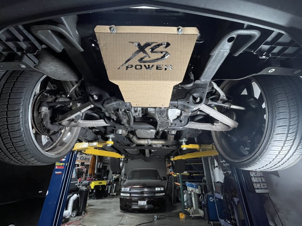

believe it or not, this thing was strong even made of cardboard.  It has perforated lines so i know where to bend it and it still didn't rip.  This seems like a good spot. Just need to turn this into metal now.

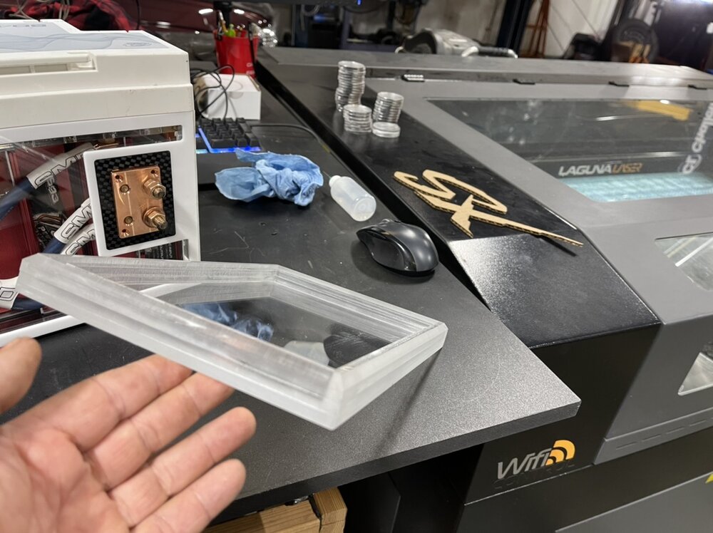

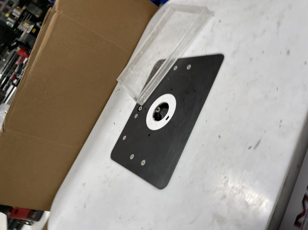

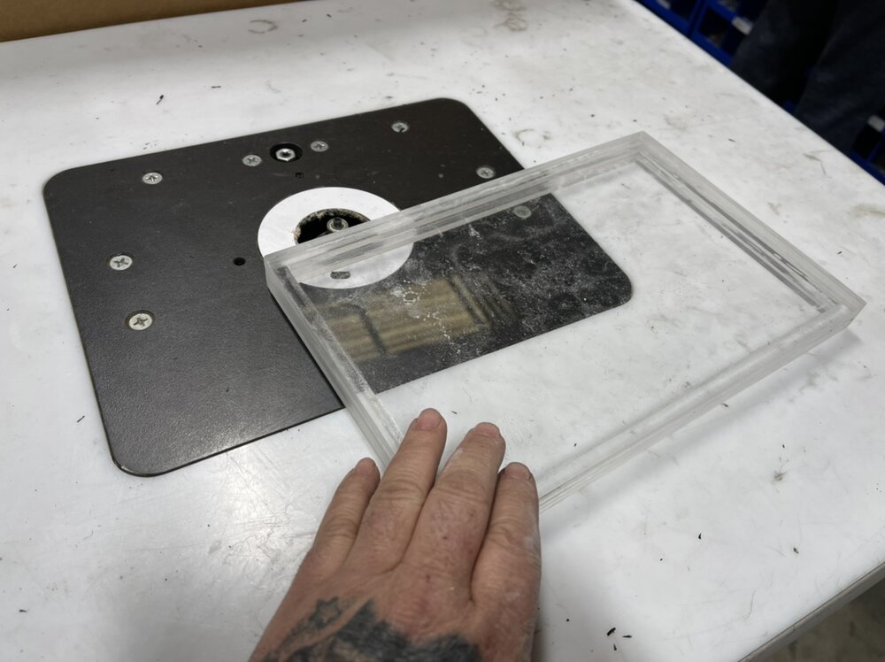

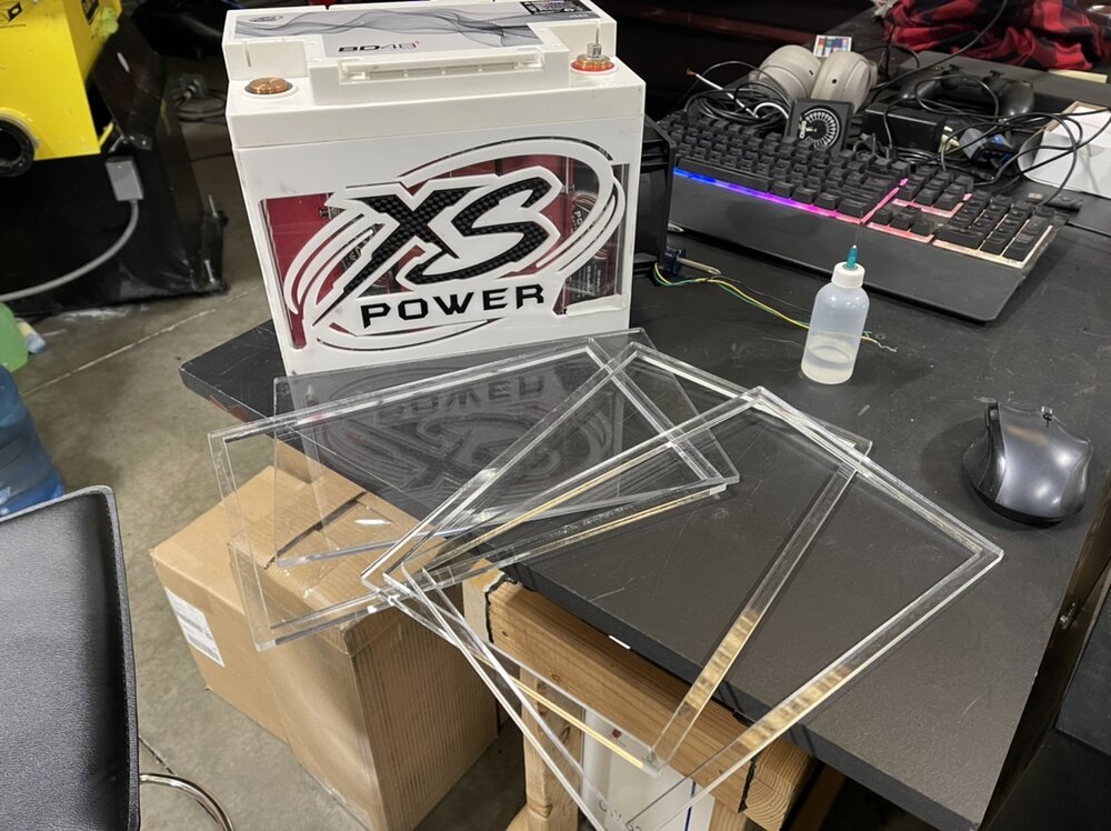

I will need a way to mount this to the metal bracket.  I made this baseplate and bonded it to the bottom of the step down box.  After that i drilled and tapped the bottom so i can fasten it in place once i get it in it's spot.
