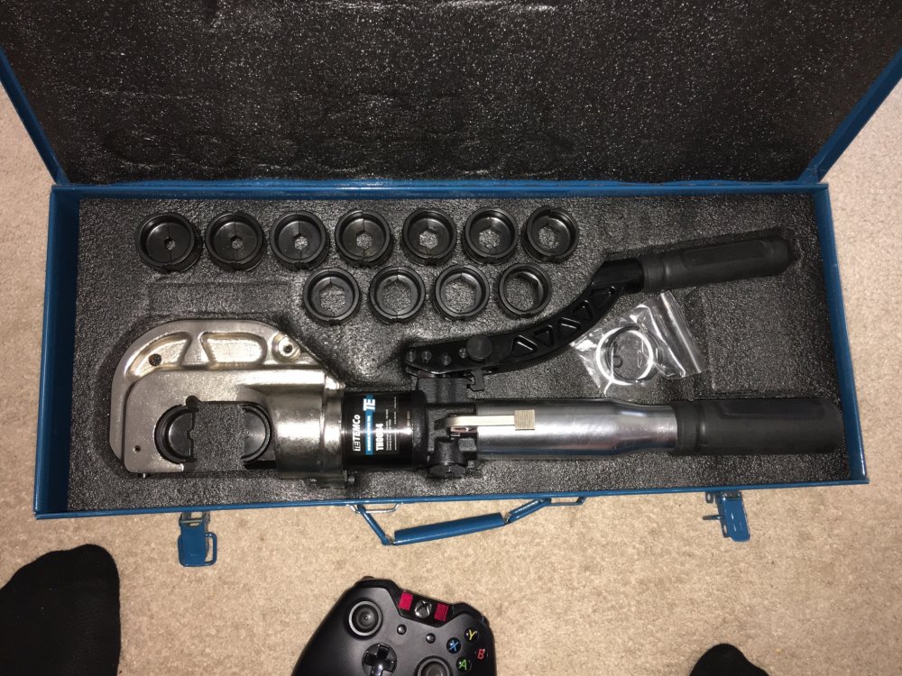

I know u said cheap, i consider this cheap for the quality it is. Temco TH0034, less than $400. Unless theyre short stocked, then they bump it up to $1500 lol smh. All the other 12ton professional name brand hydros with the C-Head are well over $1000, some even 3k if i remember correctly. So this was a steal to me.

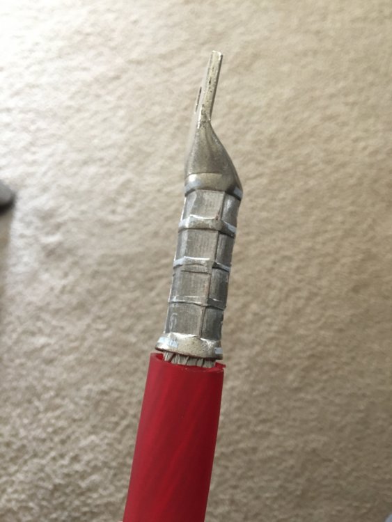

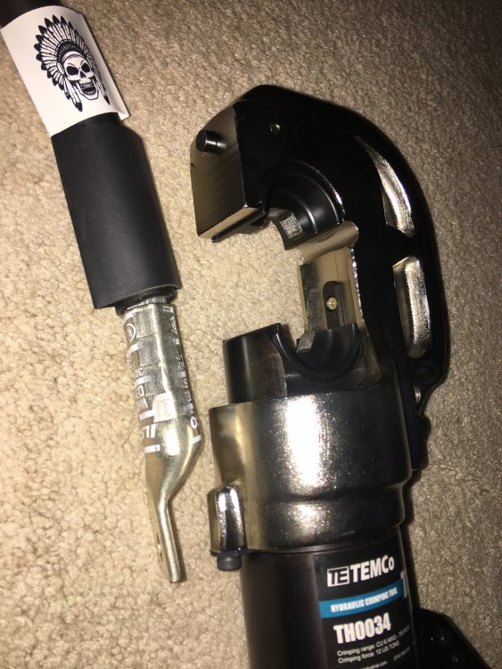

On some 4/0 Knukonceptz with 250mcm dies
Knu 4/0 with 4/0 dies. It wings just a lil so i just turn the lug and crimp over it again to flatten the wings. This shit is not coming loose lol.
