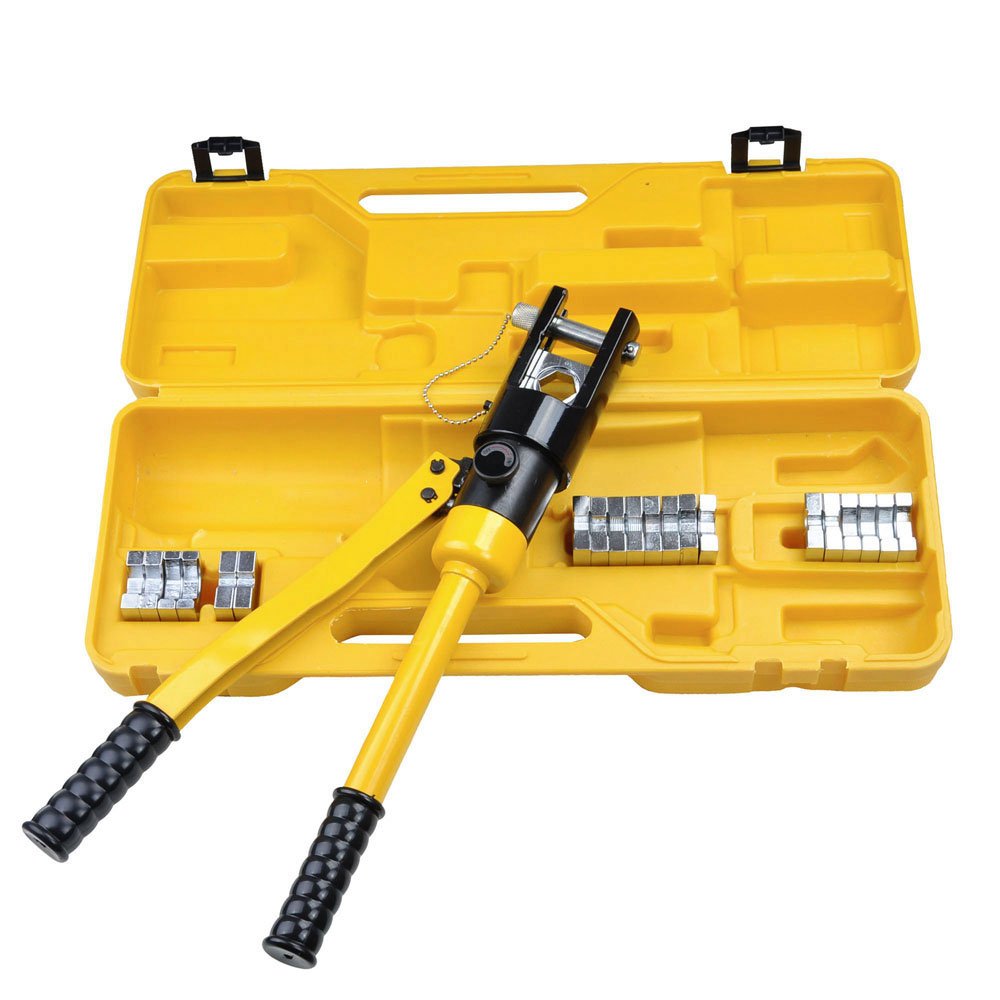

I am using a hydraulic crimper for the lugs like this one
Have you tried a different type of lug with a different sized eyelet? I’ve used RF and Stinger lug style fuse holders before without issue.
BTW, I have the same exact crimper too ?
