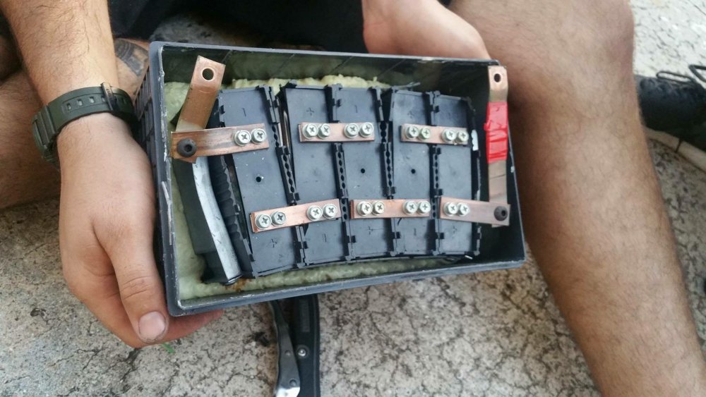

alex912005 Posted June 2, 2018 Report Posted June 2, 2018 There was a controversial gut pic of the XS Power lithium on the internet but it seems to have disappeared. I wonder why... My Build Log

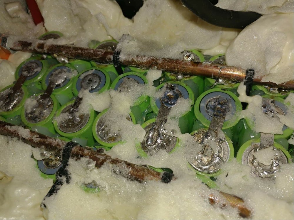

audiofanaticz Posted June 2, 2018 Report Posted June 2, 2018 It looks bad because the cells are expanded due to over charging, the same thing will happen to an agm battery if you charge it with a high voltage charge as well. Unlike another brand that used Great Stuff foam, XS Power is actually using a fire retardant foam that wont catch fire in case of battery failure. Foam is used for vibration dampening as well which is used a lot in lithium batteries, but the correct product needs to be used. People also where taking shots at the copper bus bars as well, but I see nothing wrong with that, those little pieces of copper can handle insane amounts of current (just like a 17 foot piece of OFC 1/0 can handle 300amps, but a 3 foot piece of that same wire can handle over 900 amps due to the shorter length and lesser resistance). Again something most people have no clue about. So lets see a scammers lithium battery that is held together by cold solder joints, flimsy poorly connected metal tabs, and zipties first... and here is the XS Power 15K

kalilac619 Posted June 2, 2018 Report Posted June 2, 2018 It was Xtreme lithium or something like that.... the other company's like Juicebox and limitless use buss bars Another shot of the Xtreme lithium guts 2000 Suburban 6 runs of 2/0 12 JBL Pro audo mids ,6 timpano audio tweets and 1 Prv compression horn per door 475ah of yin long LTOs Triple 370 Amp Autotech Alts mids amps 2 Crescendo Skyway 3ks compreesion horn amp crossfire 800.4 Tweet amp Crossfire 2000.4 sub amp: 4 Crossfire XT 8ks Subs: 8 18 in Crossfires in a 4th order Best Scores at events… 163.5@38hz DBdrag sealed on the dash… 164.3 outlaw…162.9 Meca headrest
