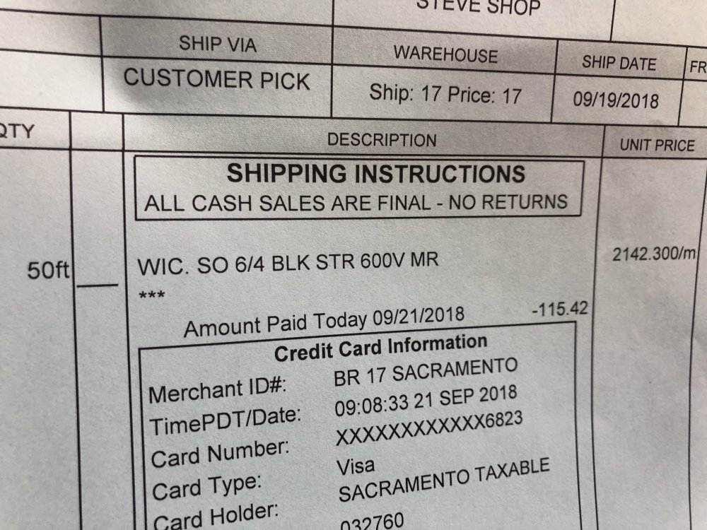

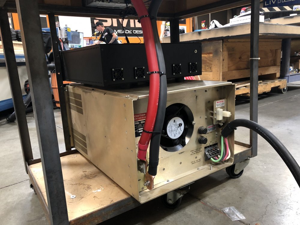

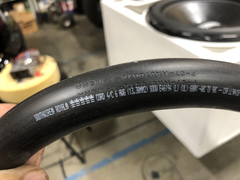

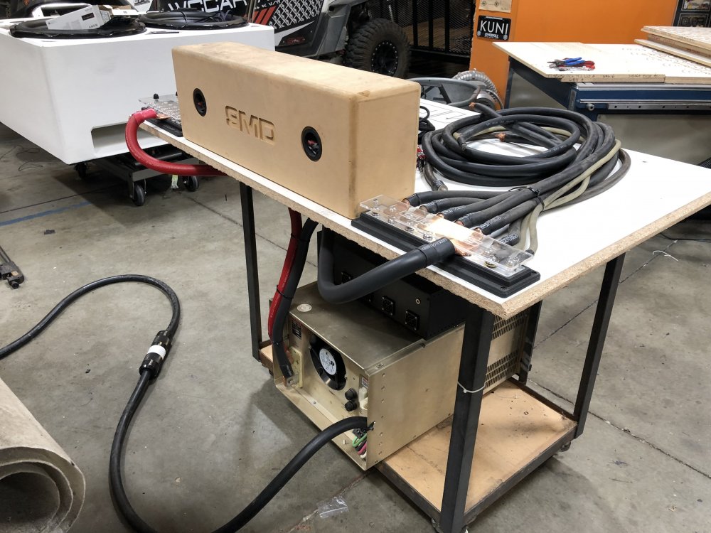

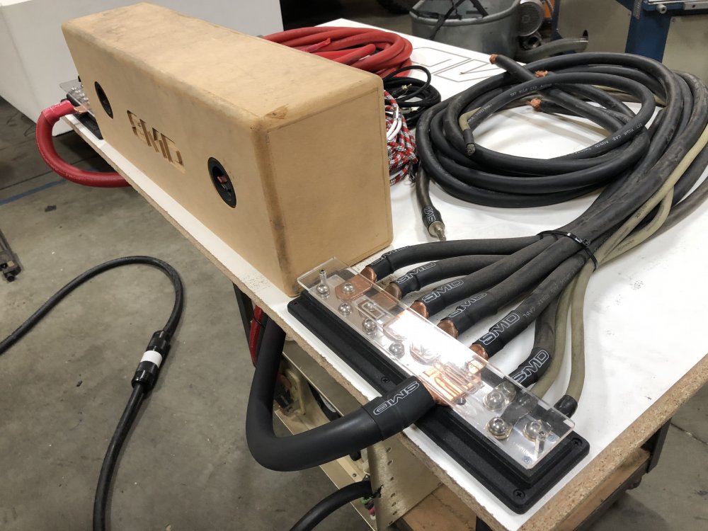

these 2 pics show what kind of  wire we used. Some dumb shit on youtube tried to call it 6-3 SJO when in fact it is exactly what i said it was 6-4 SOOW. SMH everyone is an expert. Shit never ends.

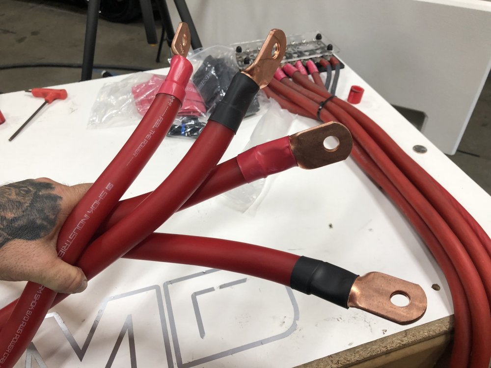

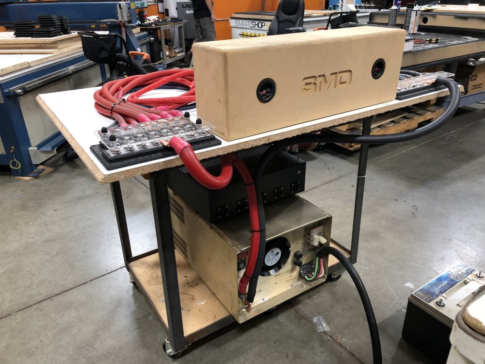

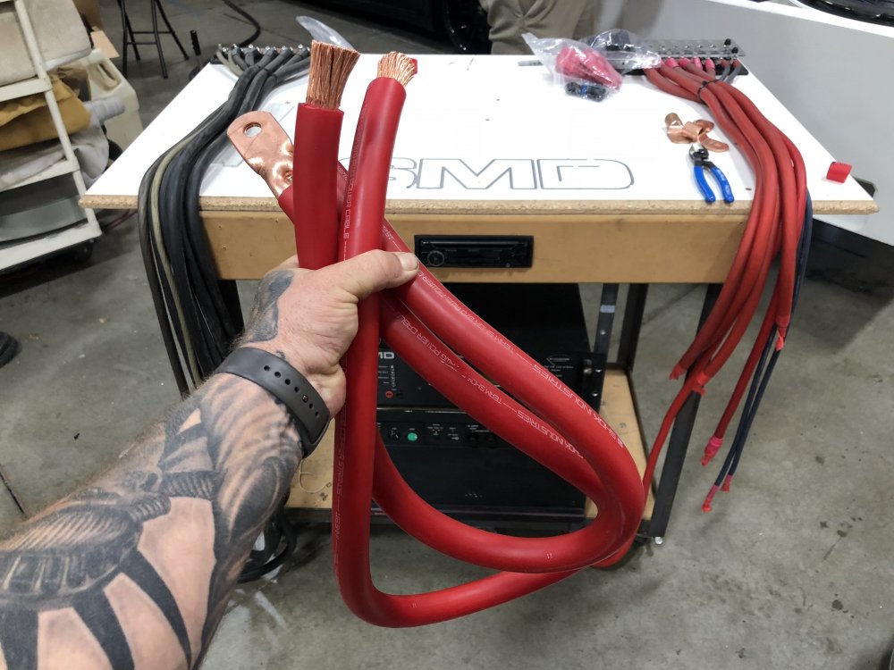

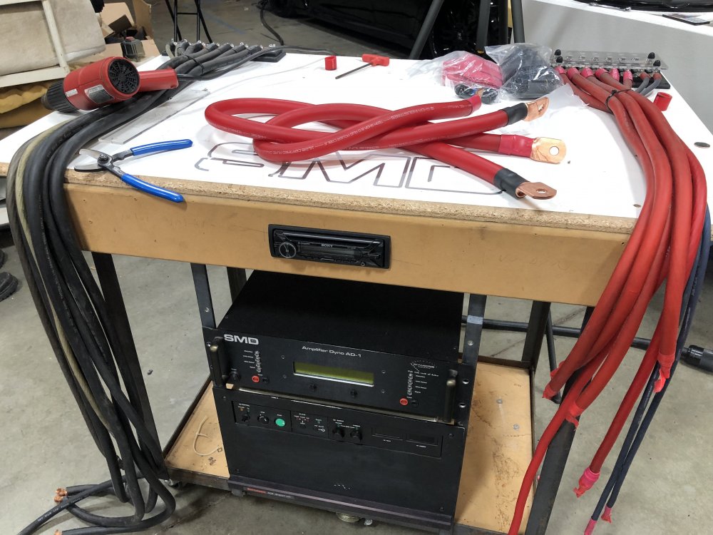

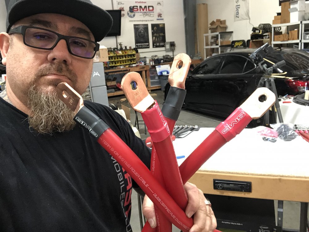

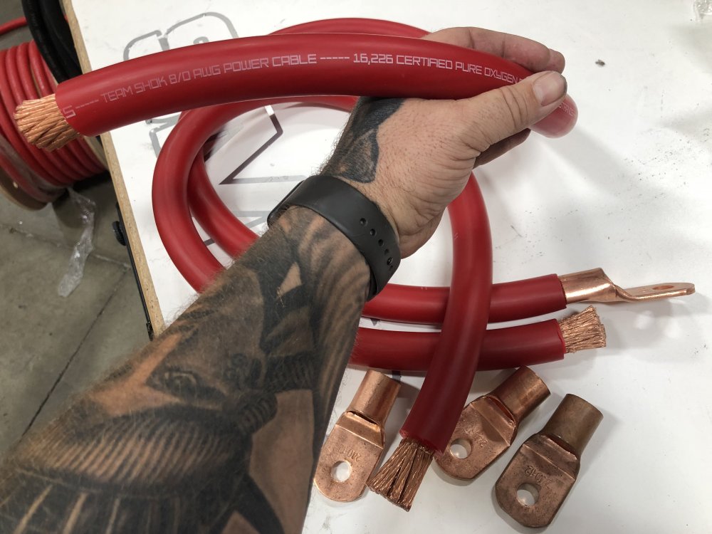

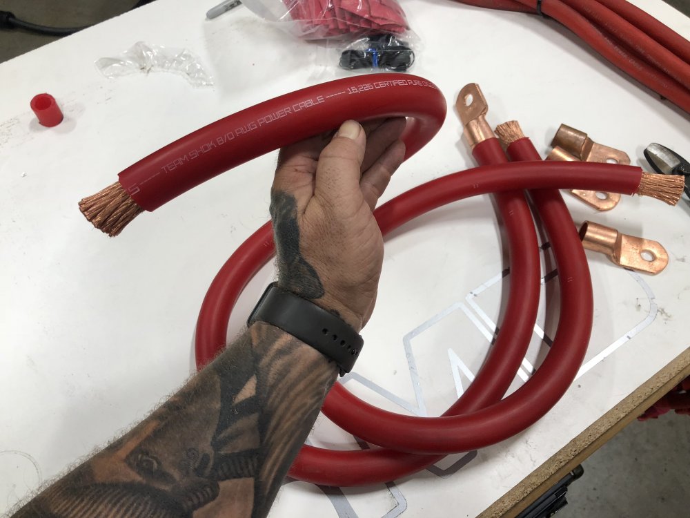

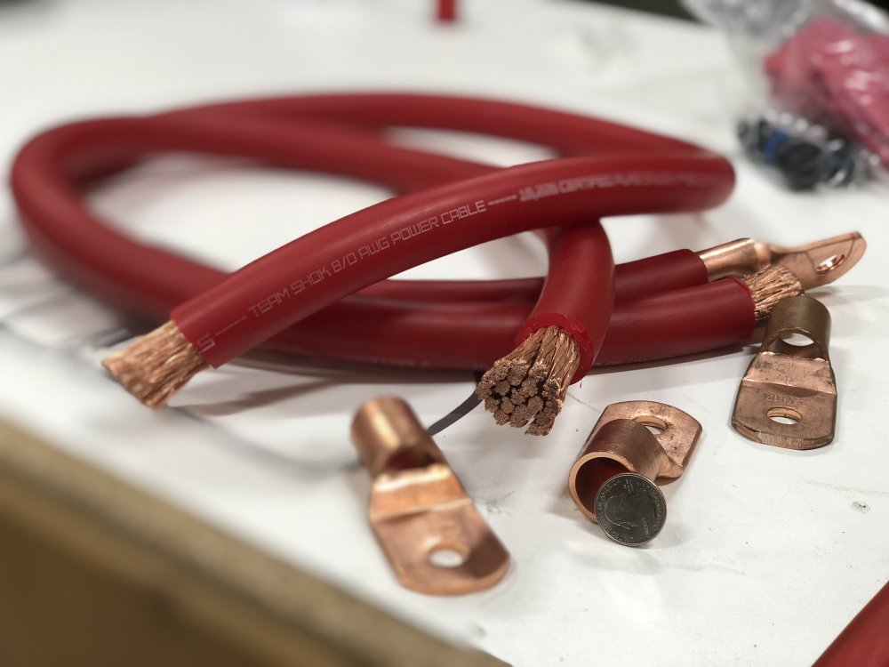

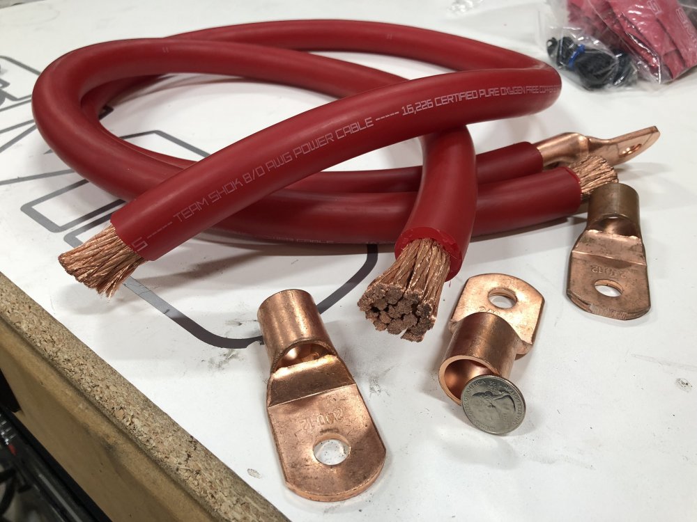

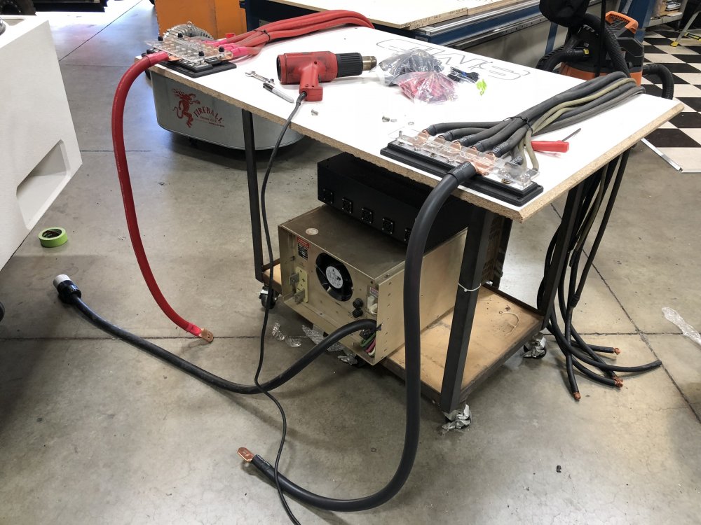

some Shok Industries 8/0 from the back of the unit to the fuse block and distro bar.

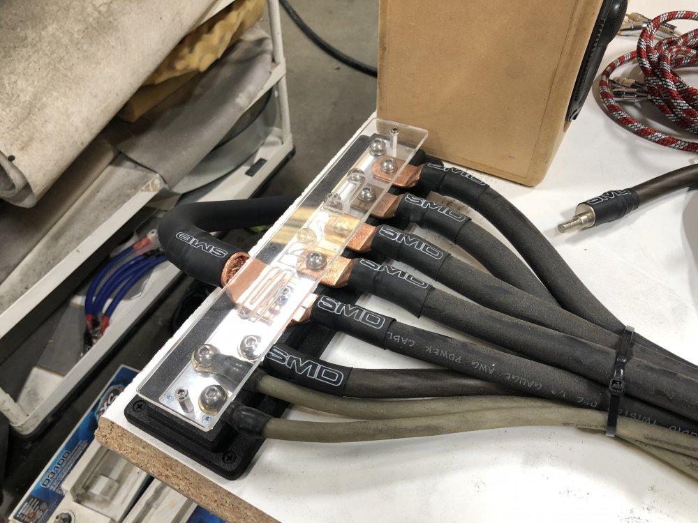

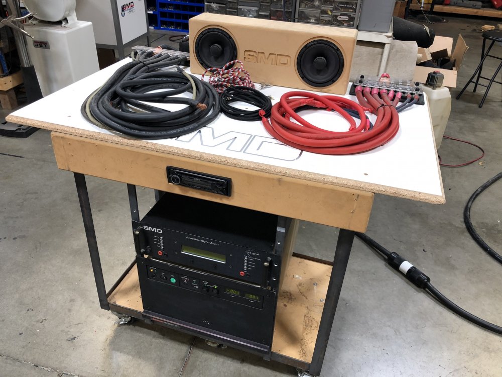

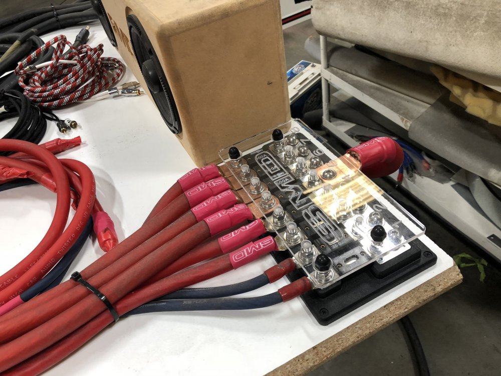

in case you don't know...that is Sky High 2/0 and some 1/0 (a few runs of 4ga for smaller amps) on the distro and ground bar.  That should show you how big that 8/0 is :D

forgot to mention...i shot the negative wire black with some SEM interior vinyl paint.  It dried quick and looks great!  It would bug the shit out of me to have a red ground wire even if it does have black heat shrink haha :D

Dat 8/0 is skraight up water hose!! Jealous of the power supply, but I gots to build up my baller status before I can afford that power bill. Enjoy :rockwoot:
