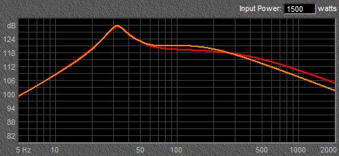

The Zv5 15 (in red) and the X15v2 on the same power model as follows:
Really similar drives it seems except for power handling. 2500W would be nothing for the Zv5, unless giving it more power maybe money not well spent.
If you were to spend on a 4000W electrical and amp, it would be much better the two X-12 on the 2500W. you would gain up to 6 dB over one on 1250W, 6 dB is really a meaningful increase of output, besides the box size is very manageable.
