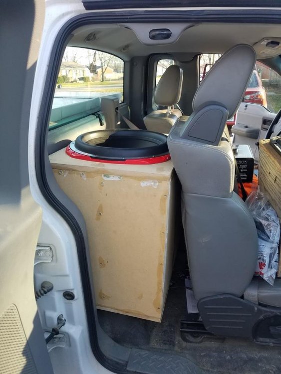

Thank you for welcoming me. I have measured the available space that I might be able to use. I wont be able to get real big, but I should be able to fit a 15" sub behind my passenger seat nicely. What sub ,amp, box combo would you recommend? I have around 500 for sub, and as much for amp. Perhaps a few hundred more if necessary. I have at least 4 ft^3 available.
No you can't.
Yes,  I can,  and I did lol.  For some resin it will not allow me to upload the pic. File is to large. I got the HCCA 152, Orion XTR 2500.1Dz amp,  0 guage wire,  3 install gear 300amp anl fuses and fuse holders, XS 3400 AGM battery, and a 300 amp alternator. I built a 3.2 cubic foot box and I stuffed 2 lbs of poly in it. It was suggested 1lb per cubic foot,  but I went with 2 because the recommended sealed enclosure was 3.65 cubic feet. I haven't broken it in yet, so I haven't cranked it. It sounds good so far tho?
