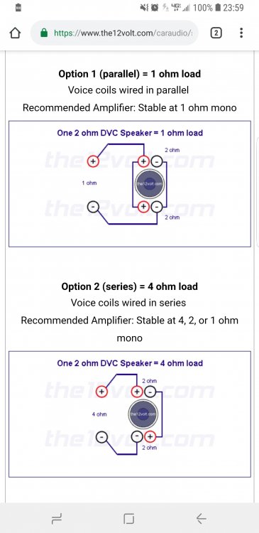

You cant' wire 2 ohm DVC sub to 2 ohms. either 1 or 4.
2 hours ago, KICKER75 said:
So now I’m confused, I thought if the sub was 2ohms that was the load it put on the amp
If the sub is 2ohm dvc, that means it is a dual voice coil sub, with coils that are 2ohm each. In order to properly use the funcionality of this subwoofer with two voice coils, you wire the voice coils so they both receive power from the amp, which in your case, is going to be one of two ways.Screenshot_20190128-235924_Chrome.thumb.jpg.ffb90b08c22ede01353804281ebf2a1e.jpg

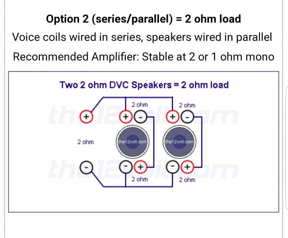

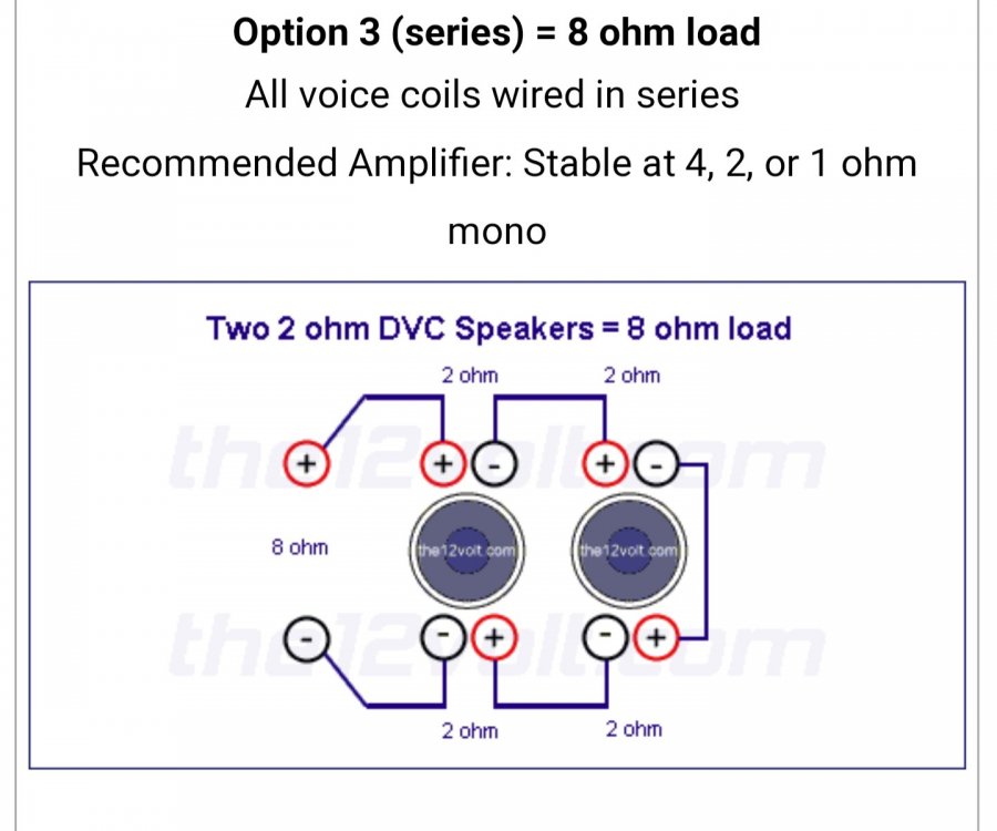

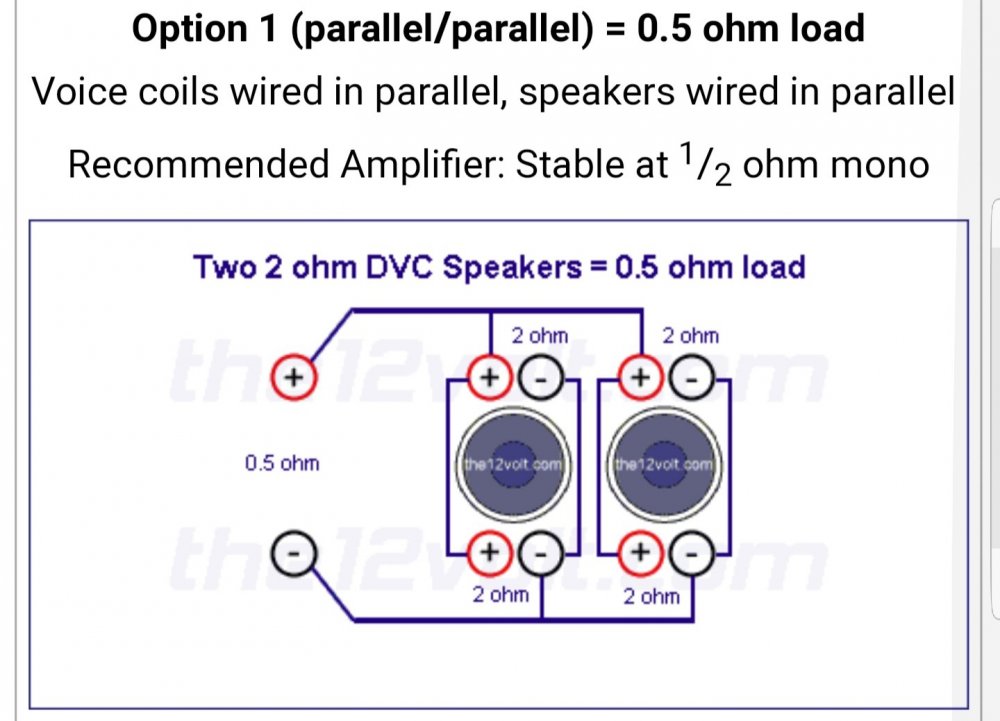

Ok thanks for clearing that up,I now realize I’m only pushing 300 watts to each sub with the mrv m-500 which sucks because I bought 2 of them.any suggestions on a correct amp? They are wired to 4 ohm load like the diagram reedal posted,and they are 450 rms
If you have two 2ohm dvc subs, then your wiring options for a single amp are 20190129_094925.thumb.jpg.5a5d1199bbfee929824f40bd1f5aae8c.jpg20190129_094943.thumb.jpg.1028d89993fa4292f5e357ae6bd221b7.jpg20190129_094952.thumb.jpg.a85d5105885a8b69601e775cb4d30d50.jpg
you could always buy a second matching amp, gain match the amps, and wire one sub to each amp.
