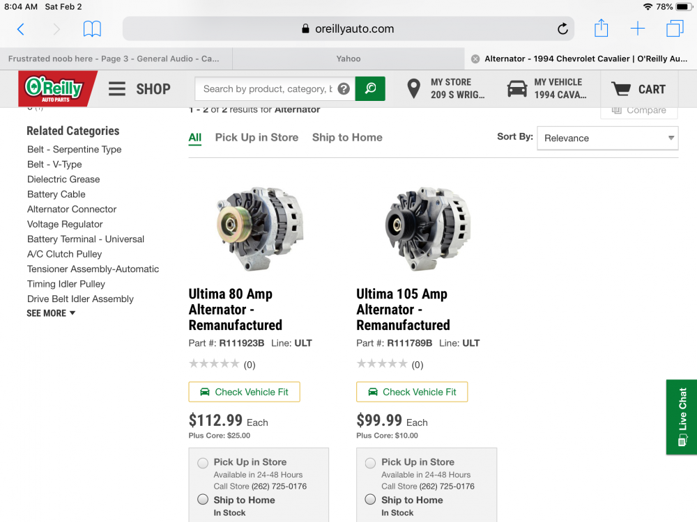

Do U have a volt meter , what’s the drop it doesn’t take much to dim lights, if that’s your only problem get some LED’s. I’m guessing that’s an 80-100 amp ALT. Probably closer to the 80 side being the year and not that many electronics back then, I bet there are a lot of options for ALT upgrade and at a good price.
I’d go bigger then that personally but that’s cheep
