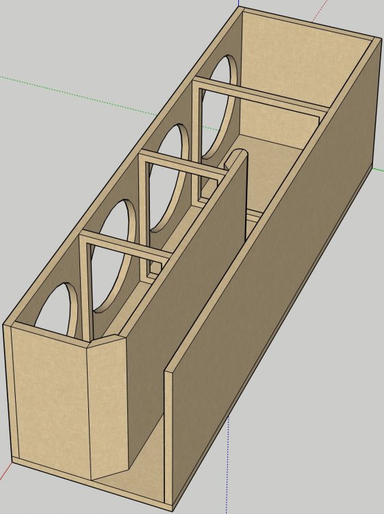

Hey fellow bassheads, I’m new here, literally just joined. I understand the fundamentals of box design, but I’m a little old school. I don’t use fancy apps, or websites to design for me. I’ve heard lots about the proper port sizes and wondered, is there a real math equation that would give me the proper port size every time? I’m 16, have four DC level 1s, and am making a box like Steve did with Bucket o’ Bass. It’s going in an 01’ Silverado. I just want to make it pound me harder than my drunken uncle on a Saturday night. Any pro tips?

I use this for port area:
That box should be tuned right around 34hz. You have plenty of port area. It should rip.
Thanks man, I wasn’t exactly where it was tuned. I’m on a school IPad so google docs doesn’t work. Ill look at it later though, thanks for the feedback!
Seth Hardin
1 hour ago, strangeduck said:
how much space are you going to have between the port opening and the inside side of the truck?
A good 4.5 inches. That plus the extra added at the end of the port. Because of the 45*. It’s been though of, but thanks!
Seth Hardin
You have close to port width distance from truck walls... Seems good to me.
