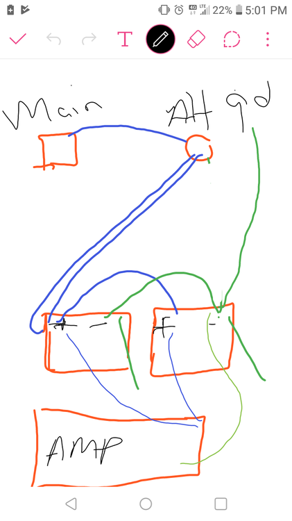

MyNameIsNoob Posted March 12, 2019 Report Posted March 12, 2019 With a 370 amp alternator, is there a need to run more than one 0g power wire connecting the alternator, 2 batteries under hood and the 2 secondary batteries in the cab of a truck? If you're using dual inputs on your amps, I'm wondering if using a second run of power wire will help get the juice from the alternator to the batteries more efficiently, or if it will be needless money spent?
Hooplah Posted March 13, 2019 Report Posted March 13, 2019 5 hours ago, MyNameIsNoob said: With a 370 amp alternator, is there a need to run more than one 0g power wire connecting the alternator, 2 batteries under hood and the 2 secondary batteries in the cab of a truck? If you're using dual inputs on your amps, I'm wondering if using a second run of power wire will help get the juice from the alternator to the batteries more efficiently, or if it will be needless money spent? 0 gauge ofc is only rated at 300 amps dont have to run battery from front to back fir ground but it helps
Joshdashef Posted March 13, 2019 Report Posted March 13, 2019 I'd say use two runs of 1/0 no need to bottle neck that beefy of an alt. SMD Tool Map (2024): https://www.stevemeadedesigns.com/board/topic/226545-smd-tool-map-2024/ Great Box Bracing Examples: https://www.stevemeadedesigns.com/board/topic/202148-best-way-to-brace-a-box/?do=findComment&comment=3055002
MyNameIsNoob Posted March 15, 2019 Author Report Posted March 15, 2019 Thanks yall, that's what I was thinking. Havent been able to find anything talking ab that, so I was curious what everyone else is doing. Makes sense to me

Wishuponasub Posted March 15, 2019 Report Posted March 15, 2019 I'm fixing to be installing a 390 and I will be doing 2 runs just to be sure. Sitting around waiting to be installed: 4 FI X 10 270 CES alt D3400/73ah lithium AA 3800.1 (2) AA 75.4
