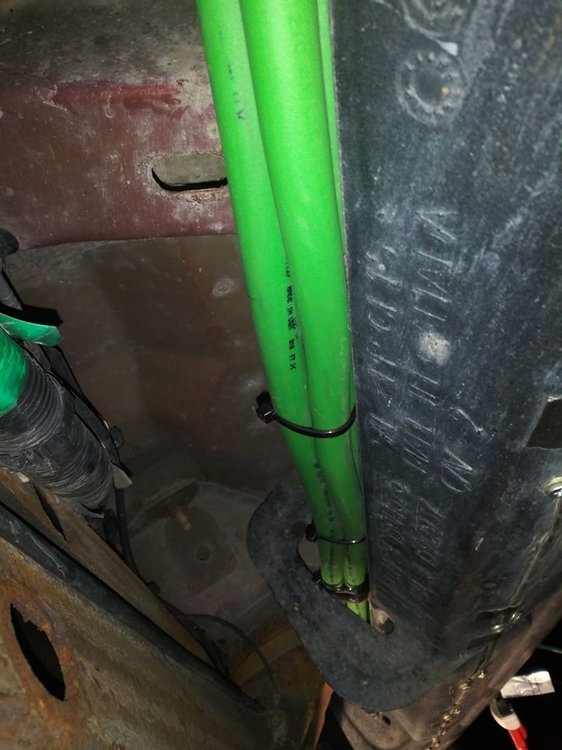

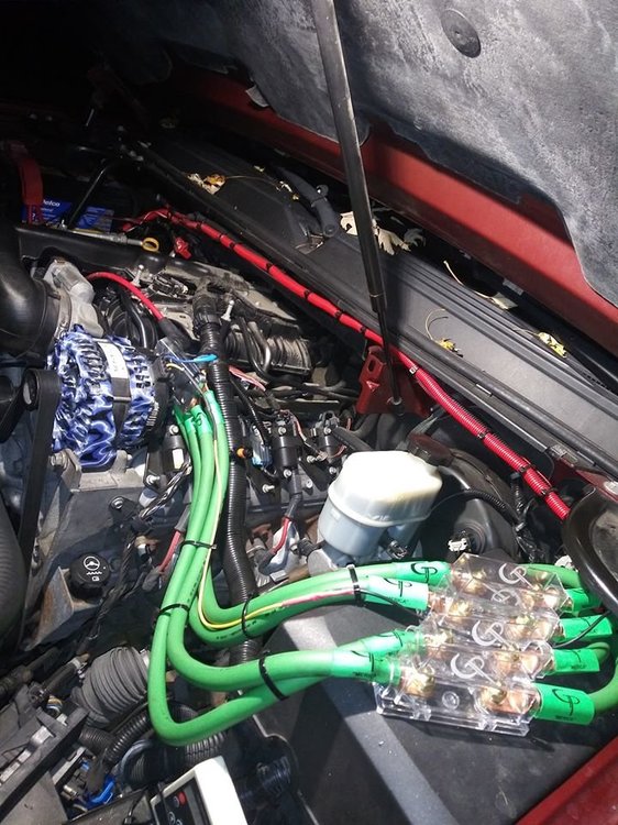

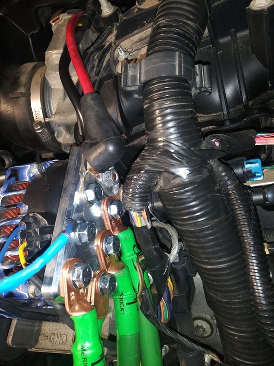

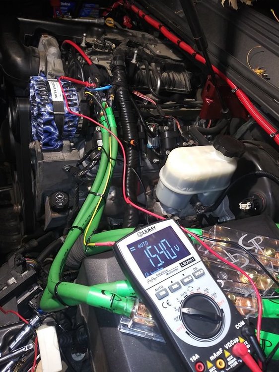

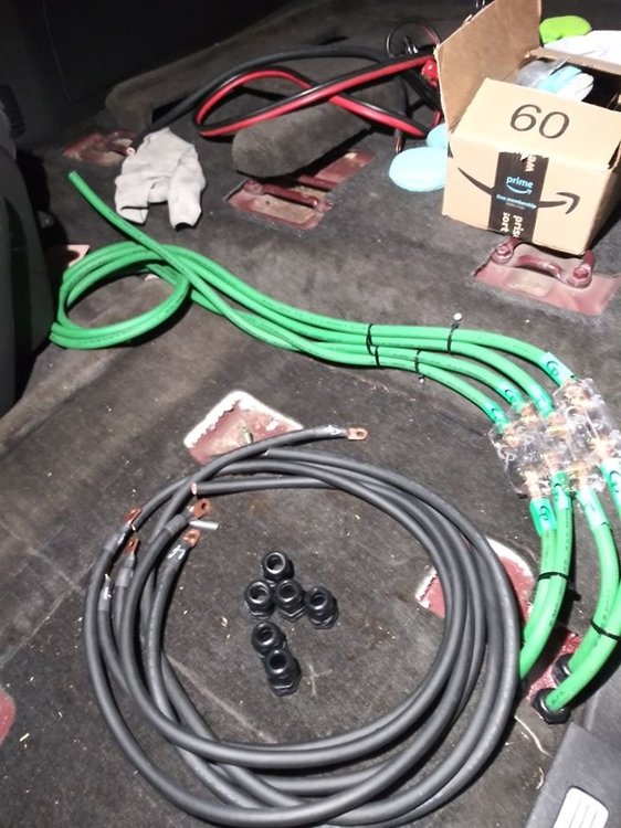

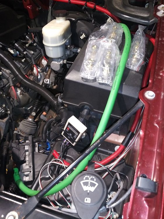

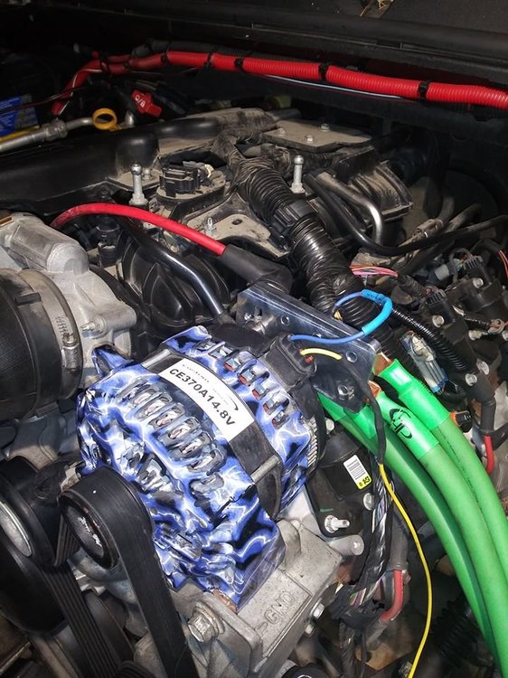

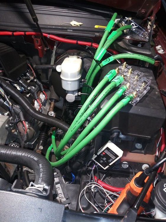

Jmainbslappn Posted February 2, 2020 Author Report Posted February 2, 2020 Went A Different Route Heres The Setup I Ran With, Electrical 1 Ces 370 @ 16.2v 2 90ah Cmax Lithium Batteries 4 Runs OF Gp 2/0 No BS Wire
Jmainbslappn Posted February 2, 2020 Author Report Posted February 2, 2020 Amps Taramps Bass 30k @1ohm Hold 15v Full Tilt

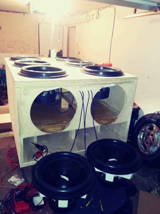

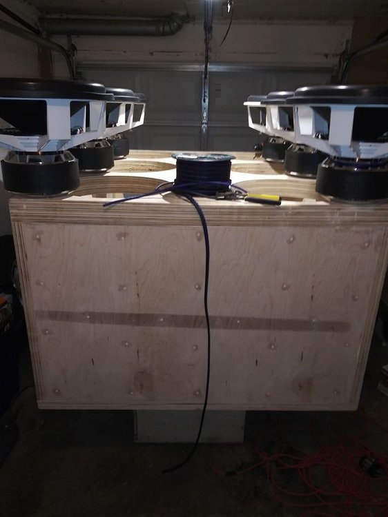

Jmainbslappn Posted February 2, 2020 Author Report Posted February 2, 2020 Subs-8 Resilient Sounds Platnuim 18s Sub Box- 43.5 cubes gross tuned to 28 hz 440sq in of port weights 700lbs

Jessica Posted February 5, 2020 Report Posted February 5, 2020 Jesus titty fuckin' christ that looks loud Rest in peace, walled 87 accord build log 03' Corolla build with AA Mayhem inside. My super random youtube channel and terrible camera work. Wiring comparison by CaptainzPlanetz Wire and fuse guide by Guest SyKo13

MichiganBumps Posted March 19, 2020 Report Posted March 19, 2020 I hope u have a meter cause im really curious what this was hitting lol did toby make ur banks? Im picking up something from him soon 15" Neo Elite 135AH Lithium Bank Taramps Bass30k 320a Brand X Purple Metallic Ho Alt 125+ Ft of oversized 1/0
AaronT Posted March 19, 2020 Report Posted March 19, 2020 What I wouldn't give for room like that under hood I'd take a shot in the mouth damn near. Lol
