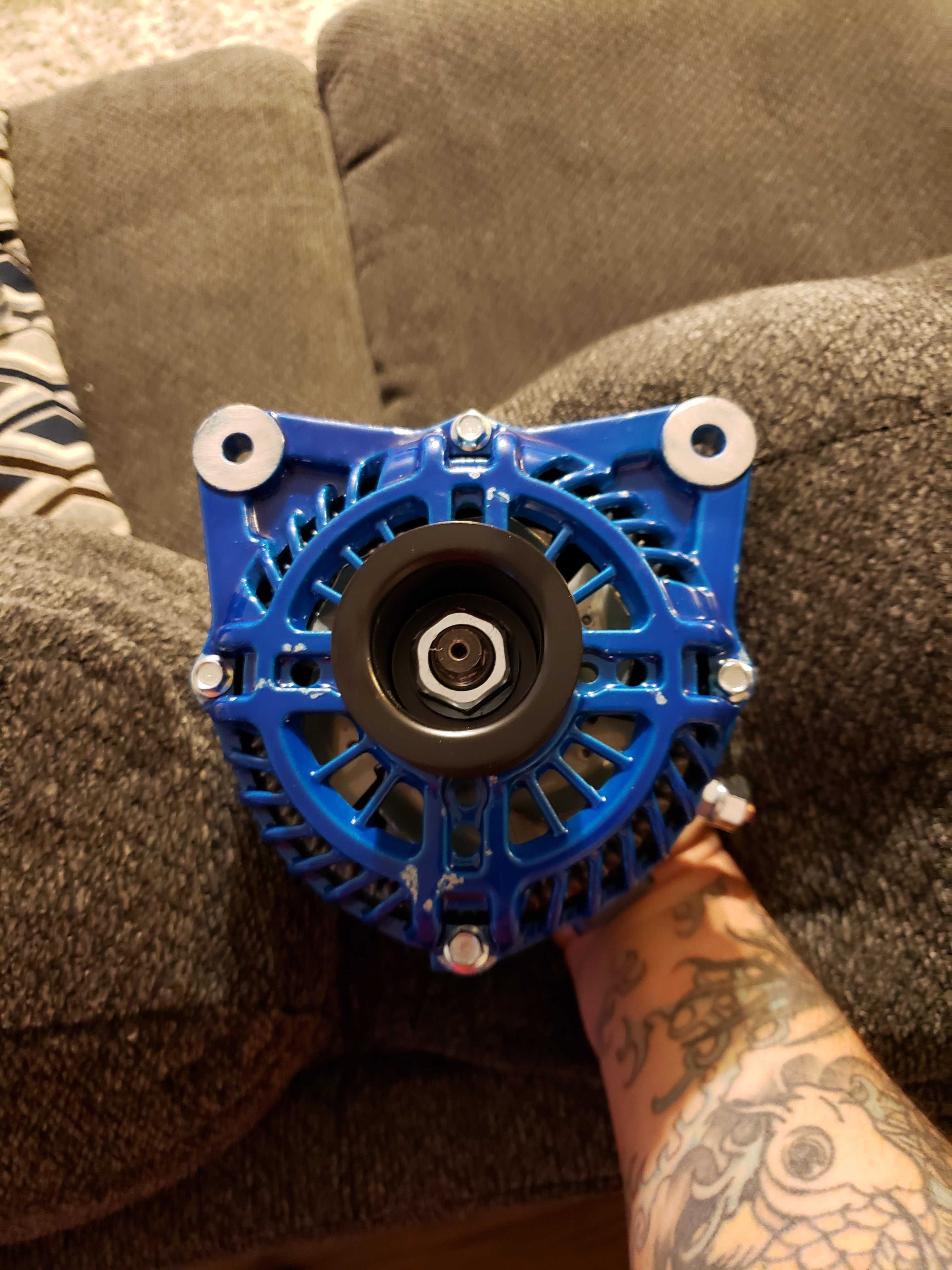

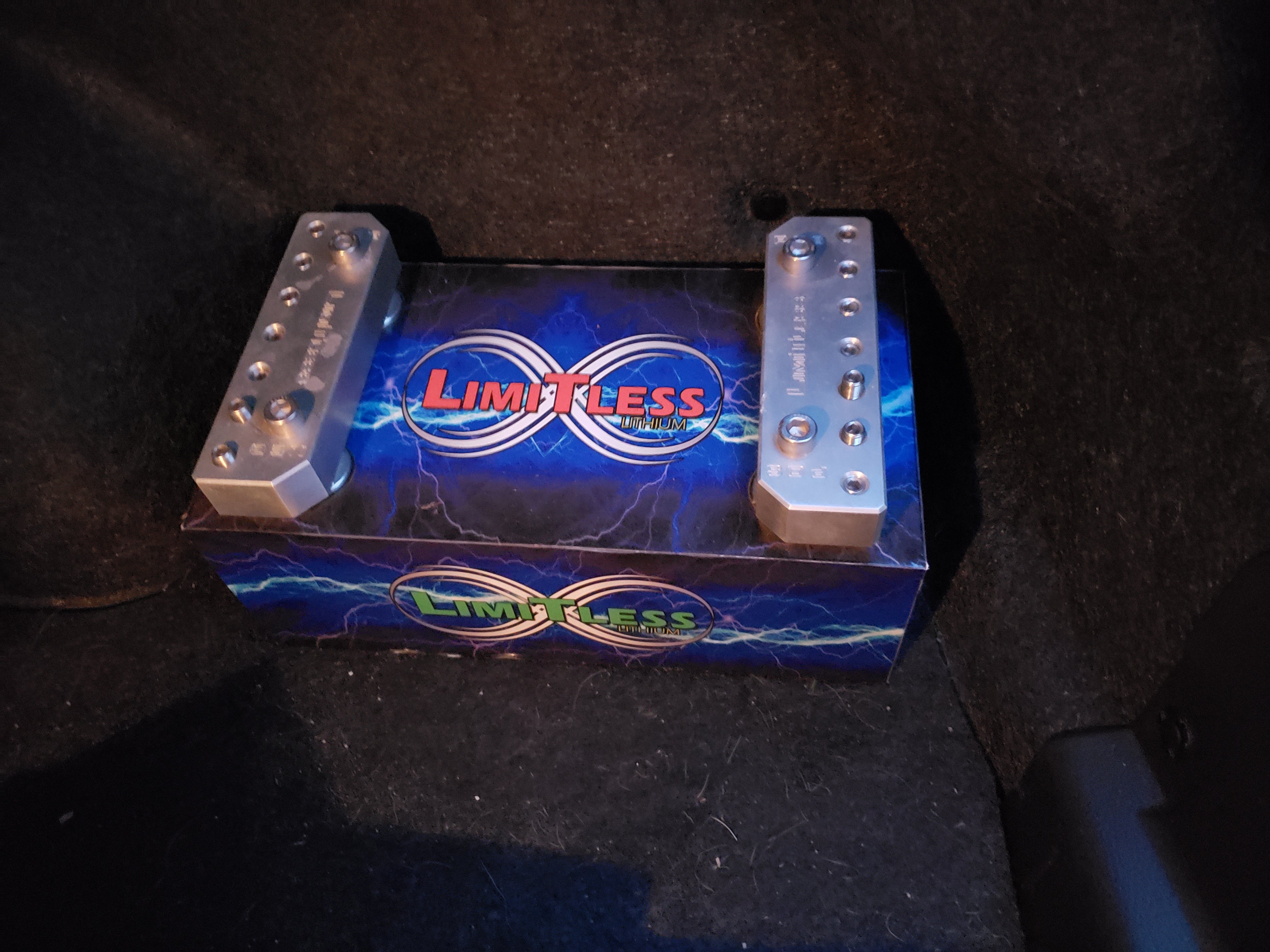

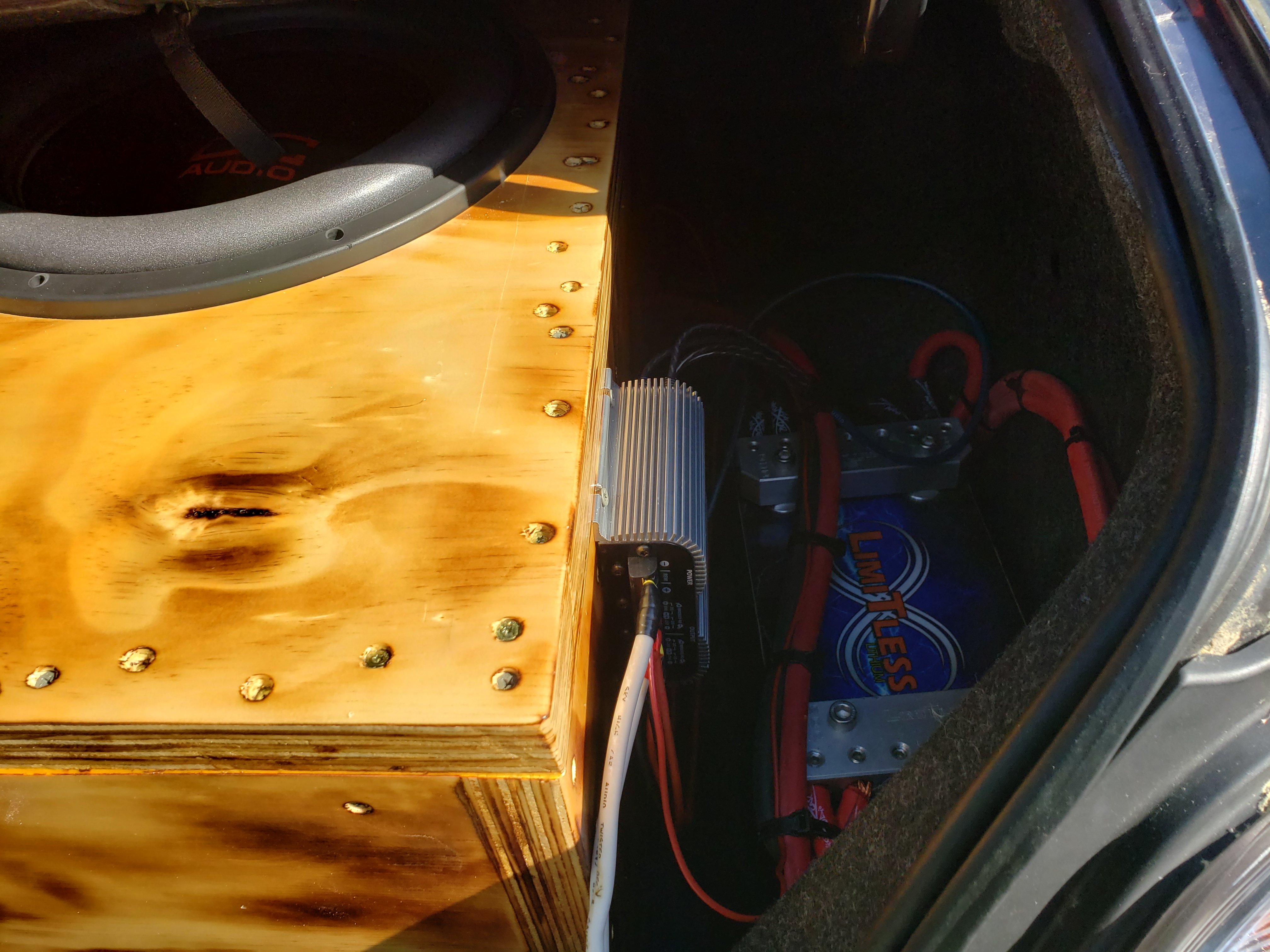

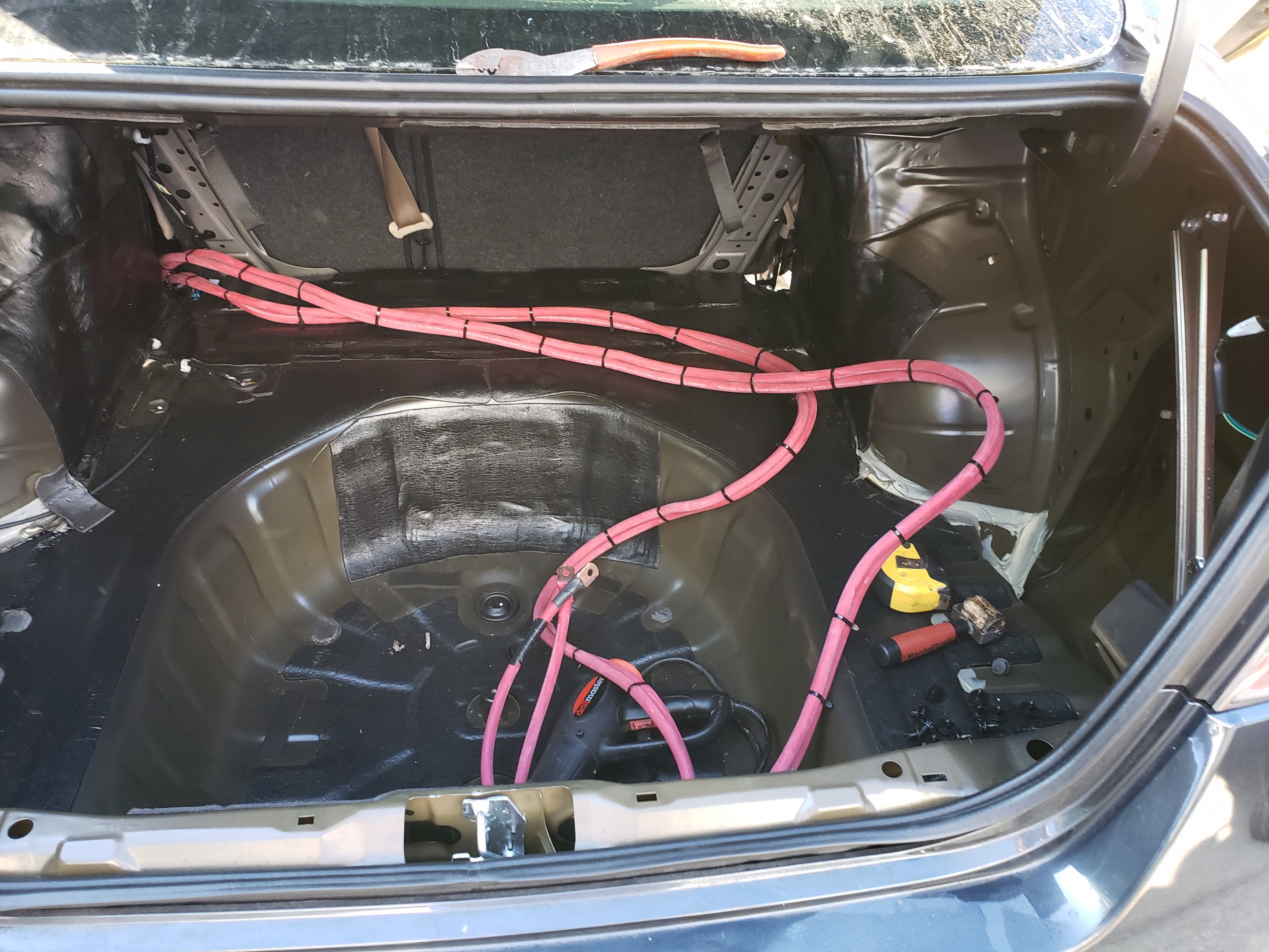

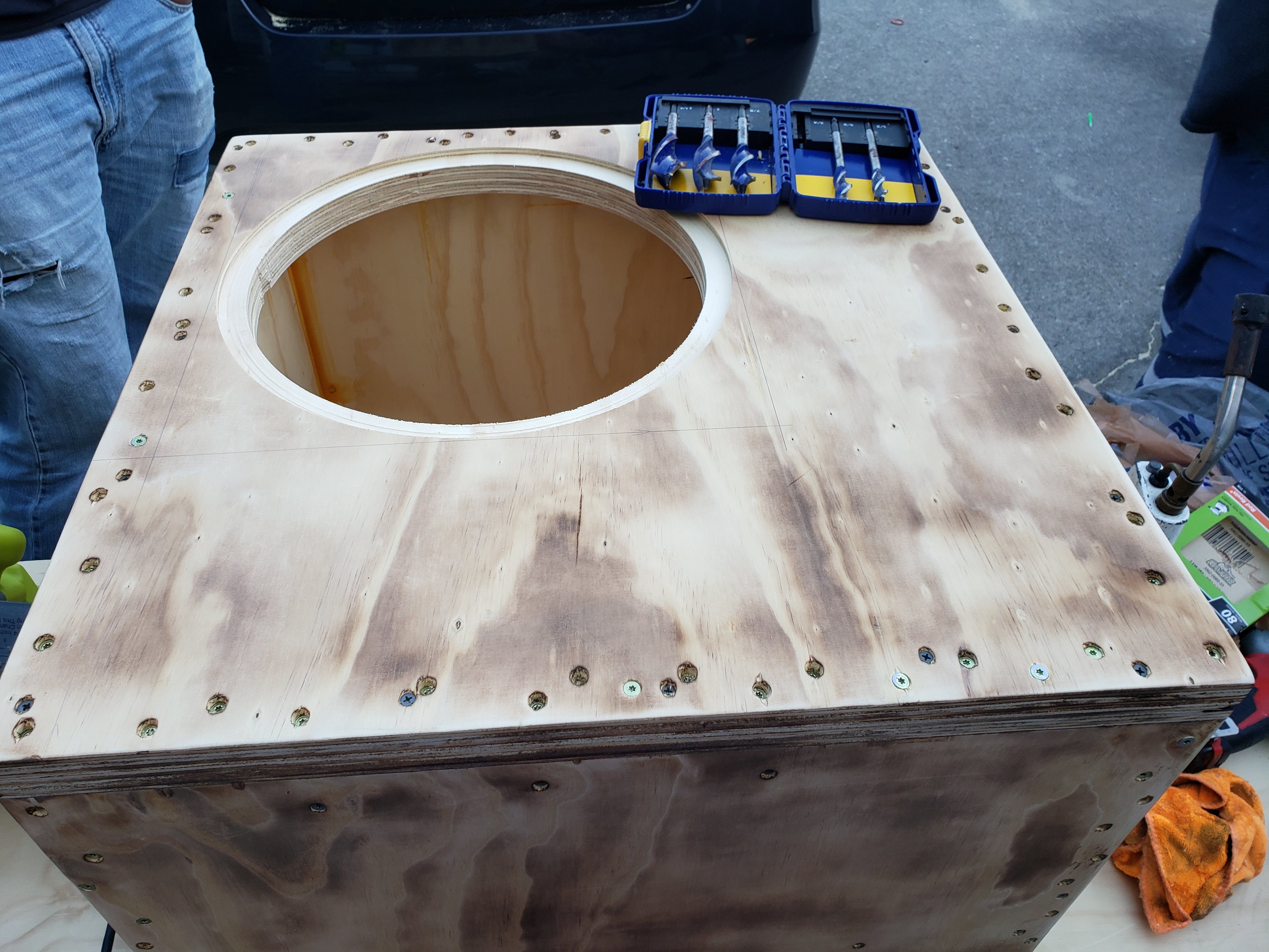

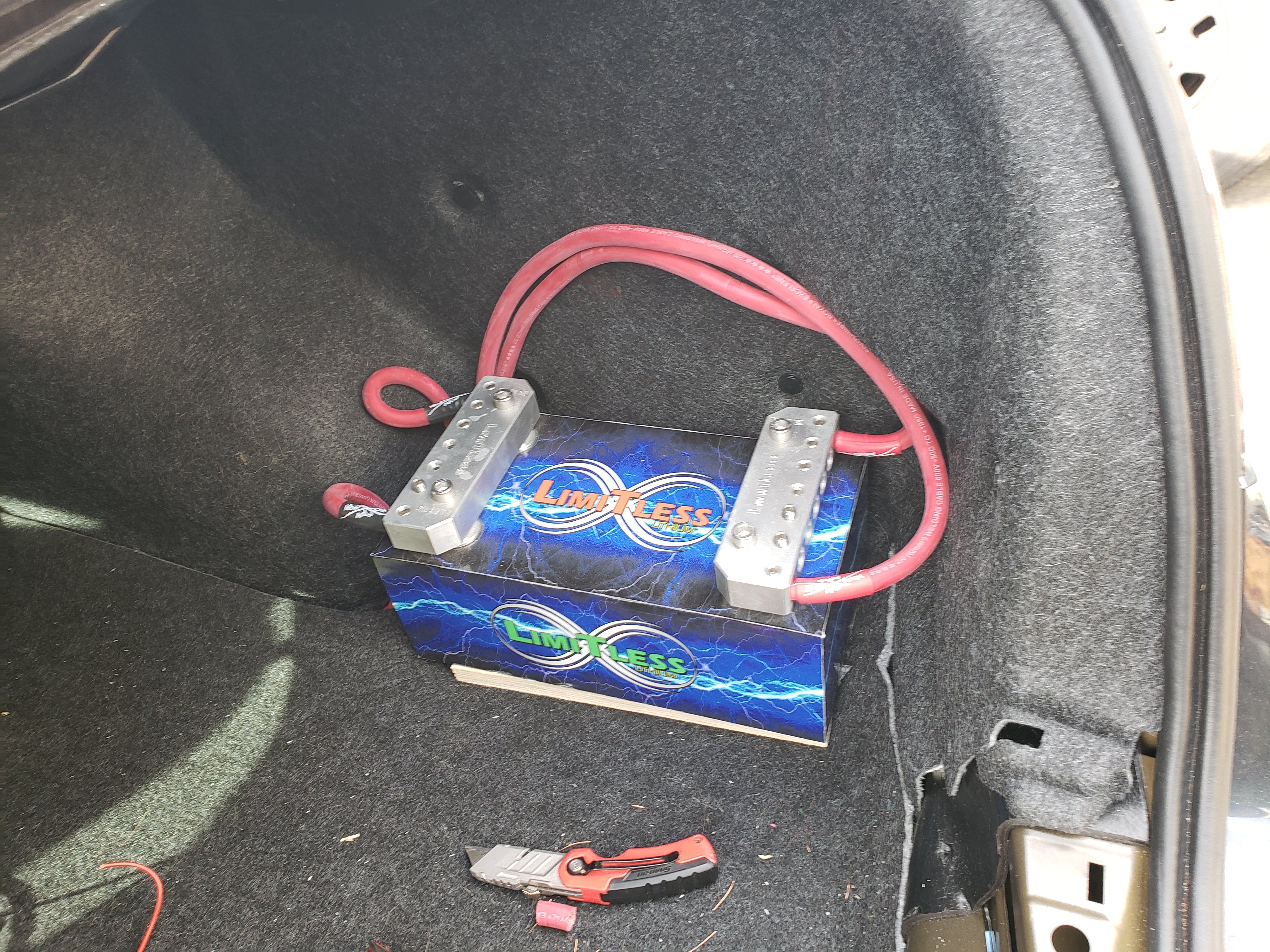

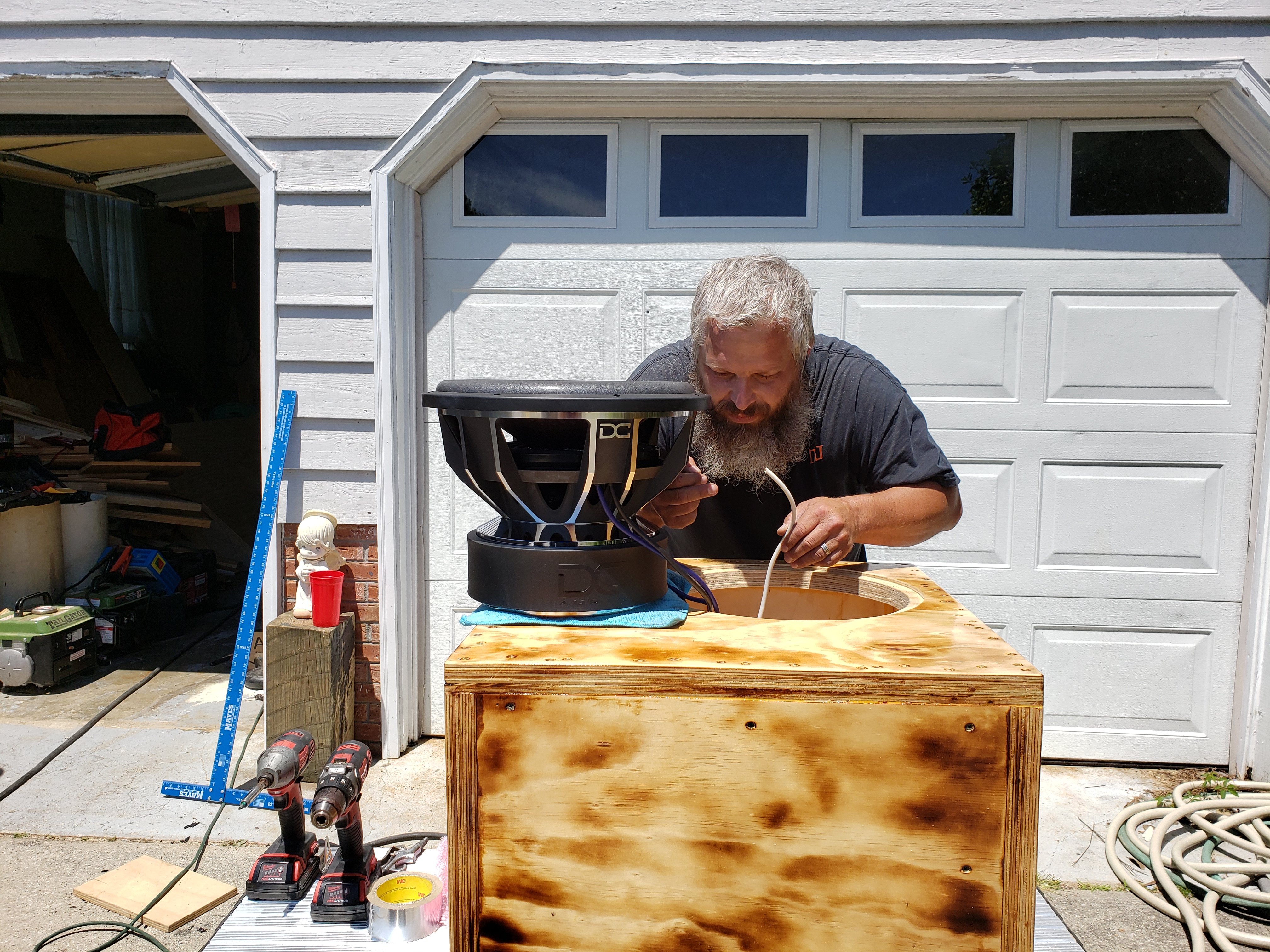

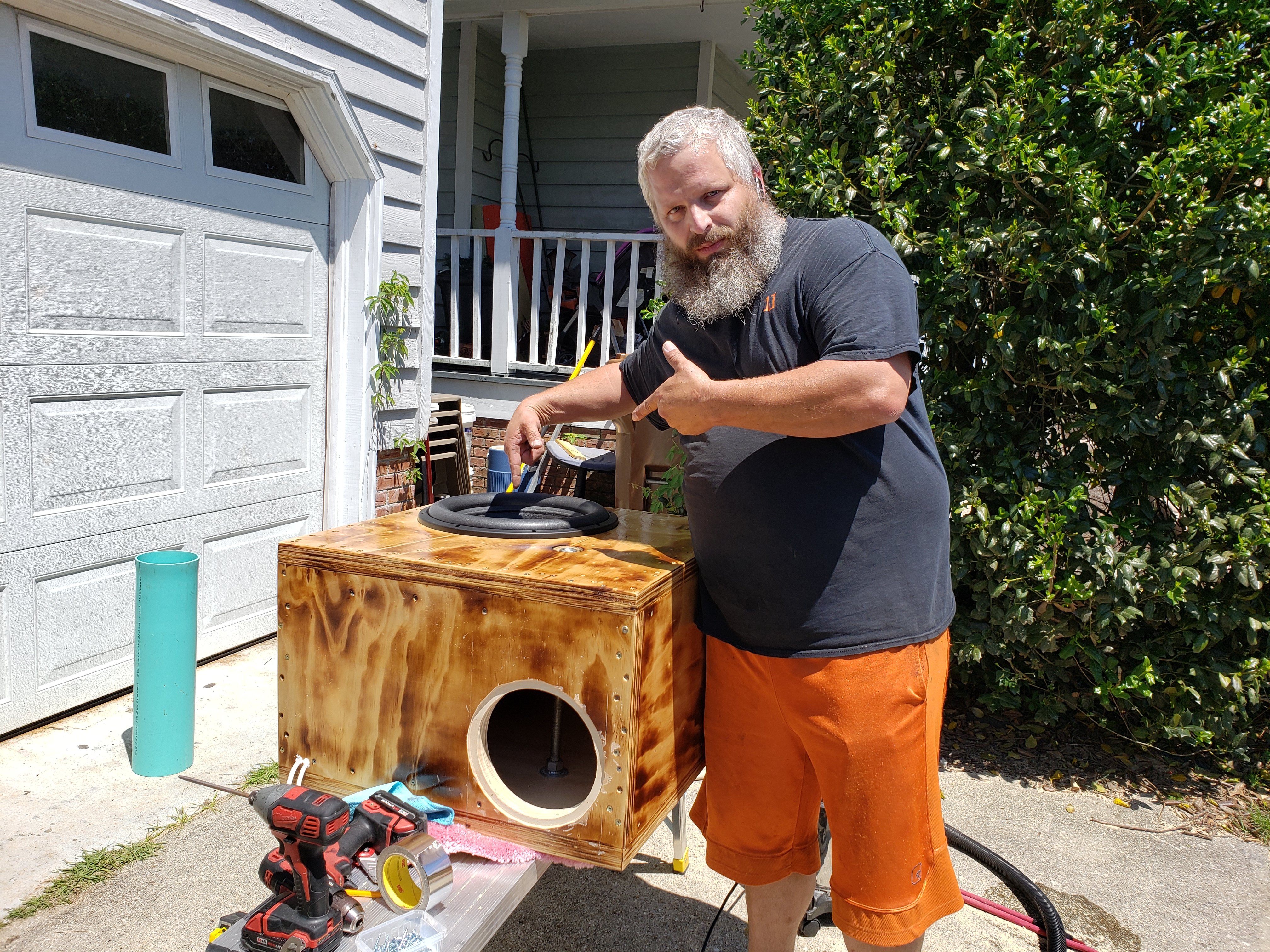

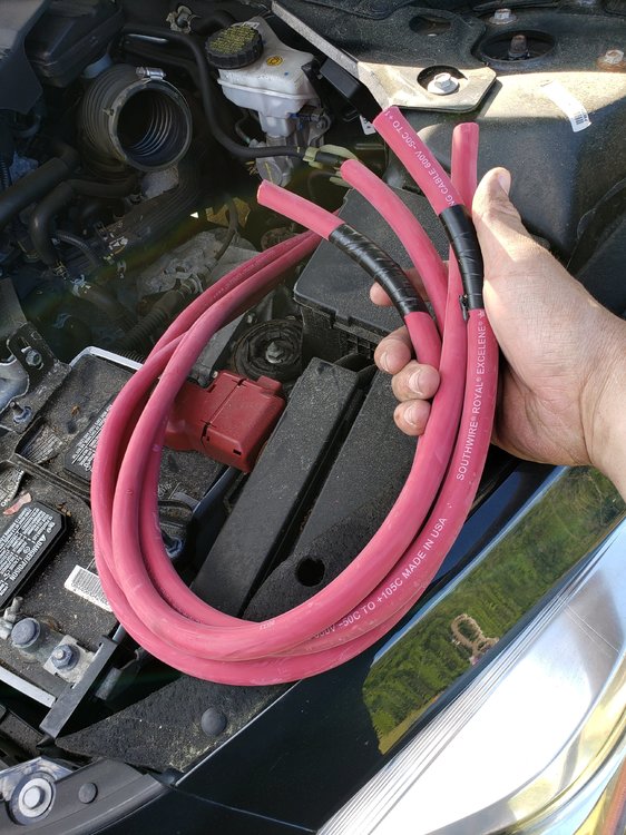

Well it's been 6 long years that I've been without audio at all and I finally was able to get myself a system again. I am beyond happy with the finished product. My team guys on Team Retribution came through and helped me get my car built in 3 days and it's playing. Still have some tuning and meter time needed to get it completely dialed in but I am super happy with the end result.

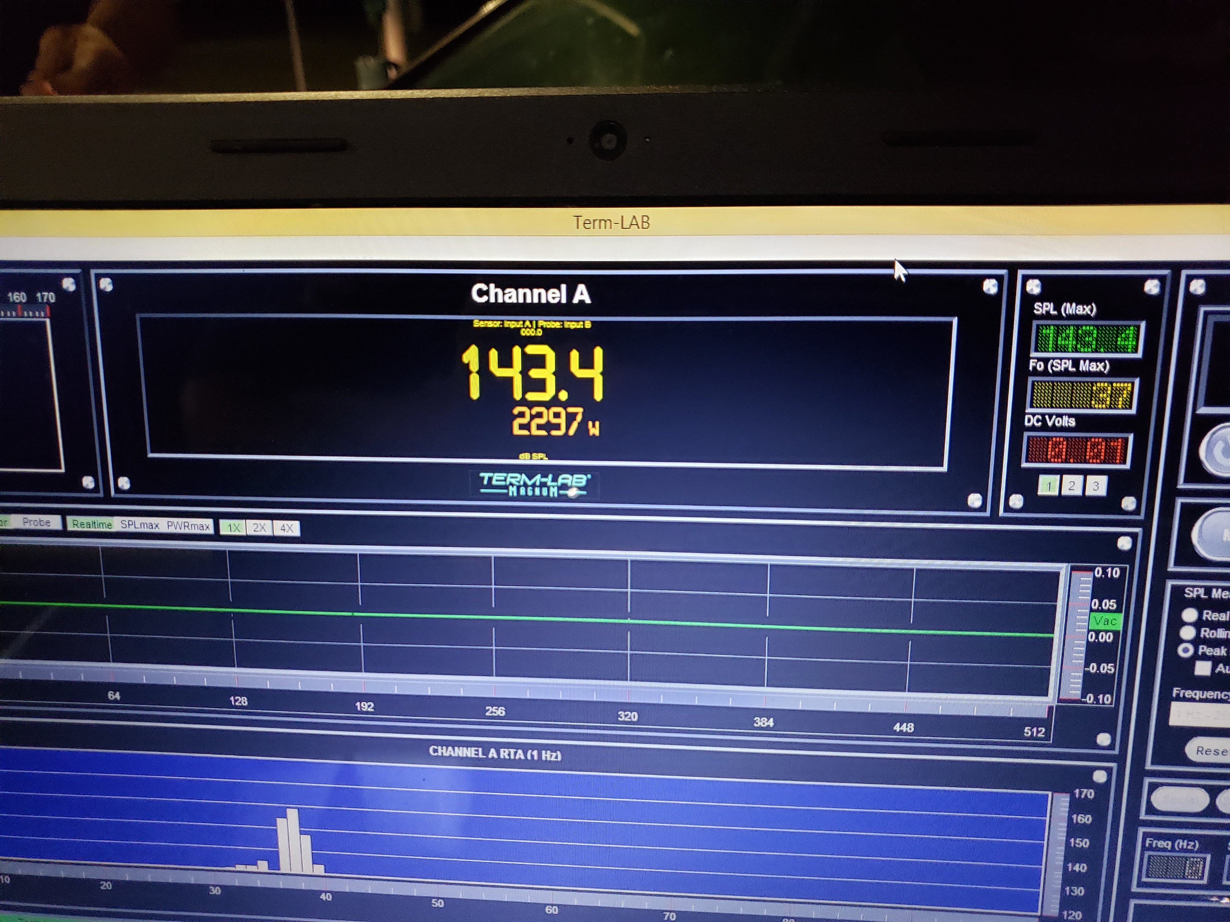

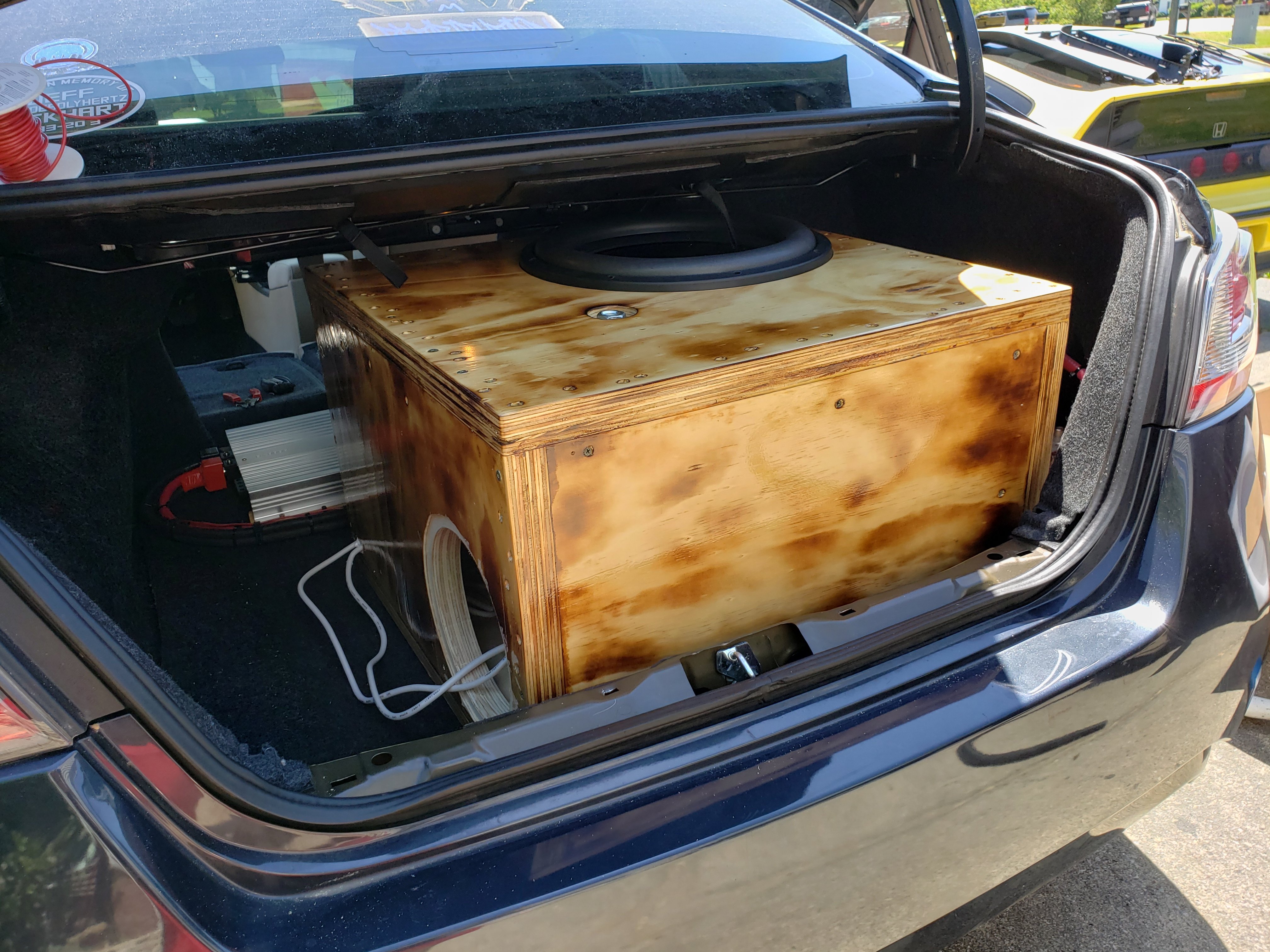

We built all day Monday-Wednesday and didn't get to tune and test until 1030pm last night but it was worth all the blood sweat and tears ...Got a quick screen shot of my peak music score sealed up in the car last night.. It has a little more in it once we get to tune it completely

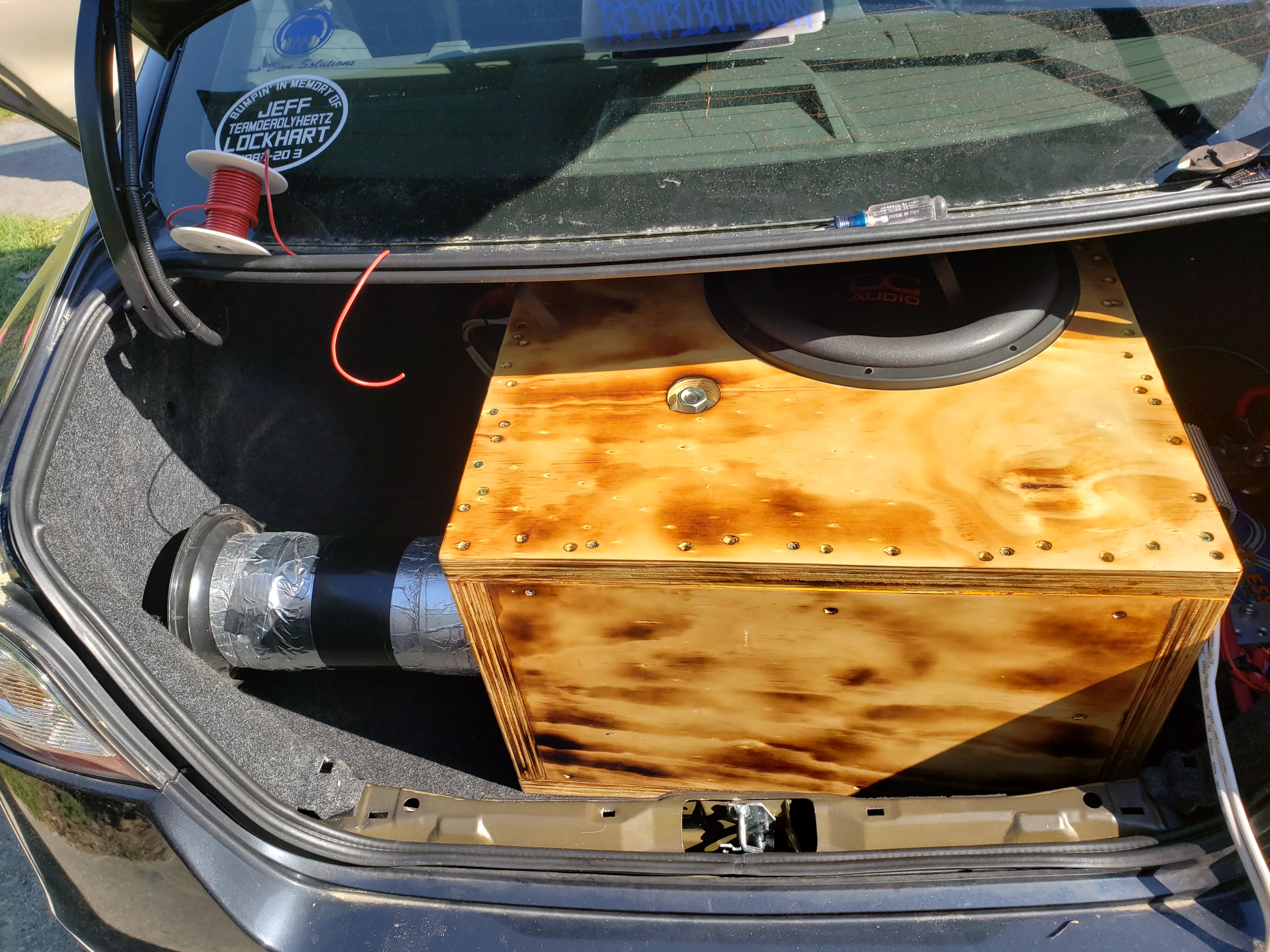

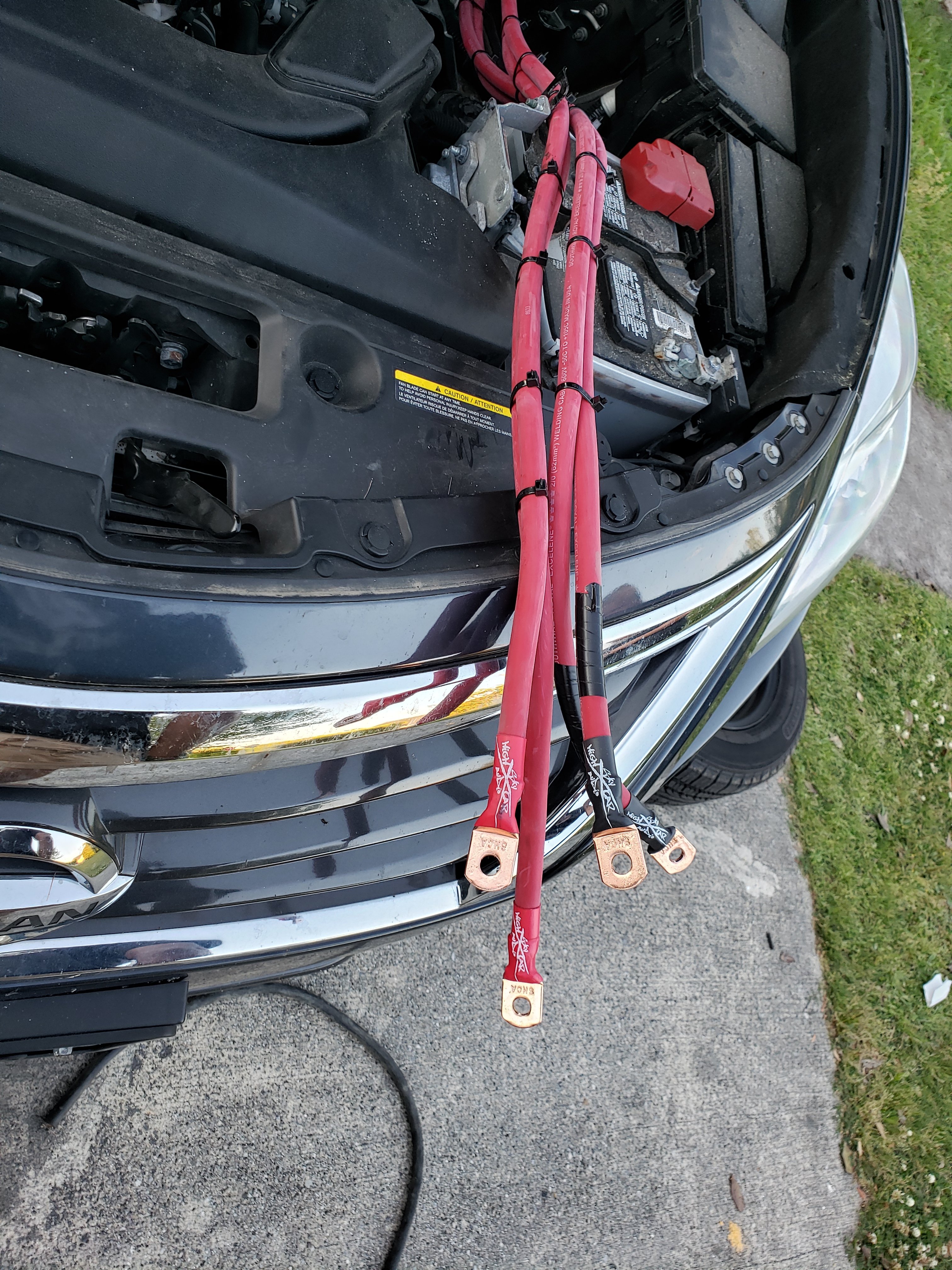

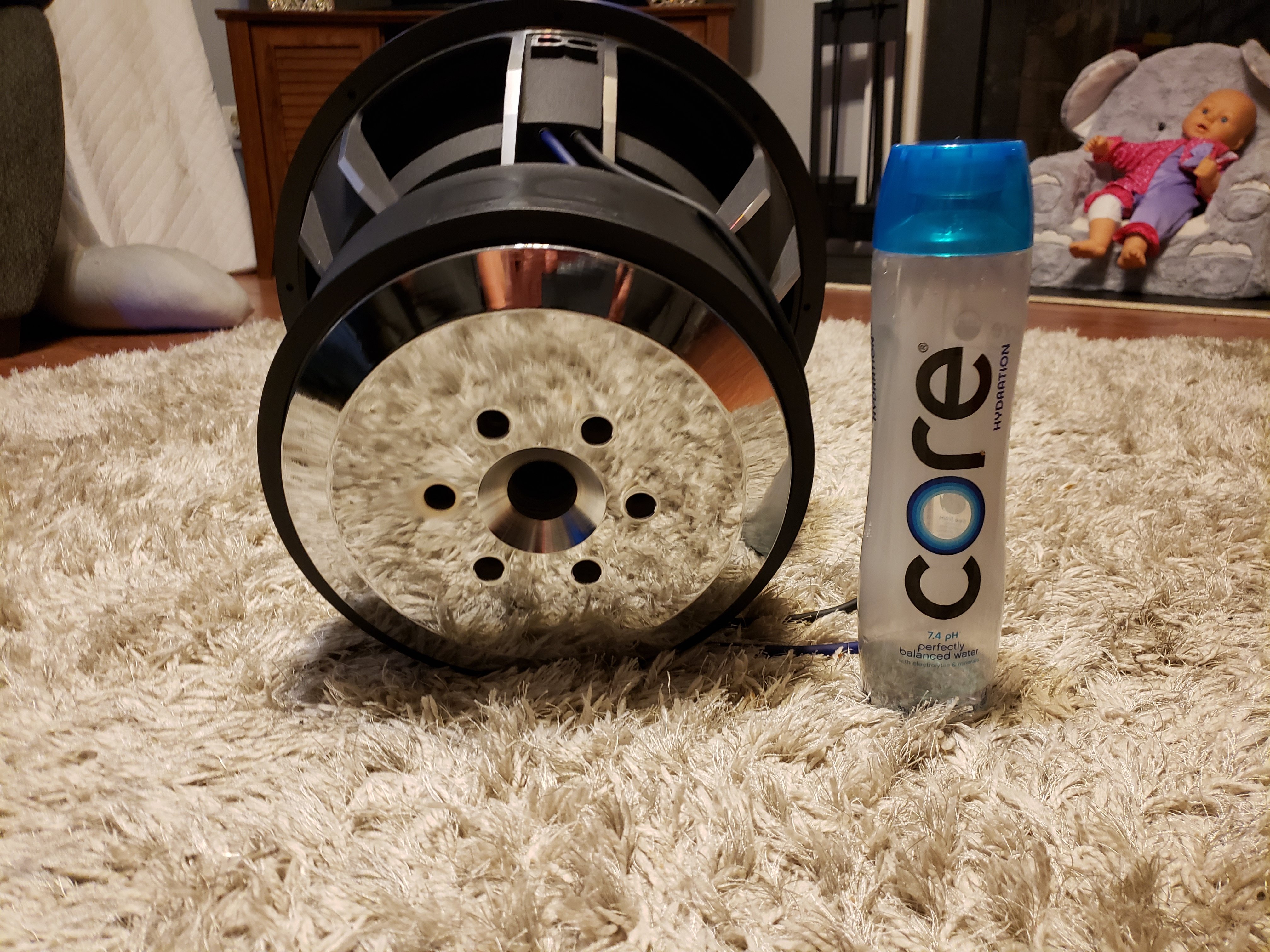

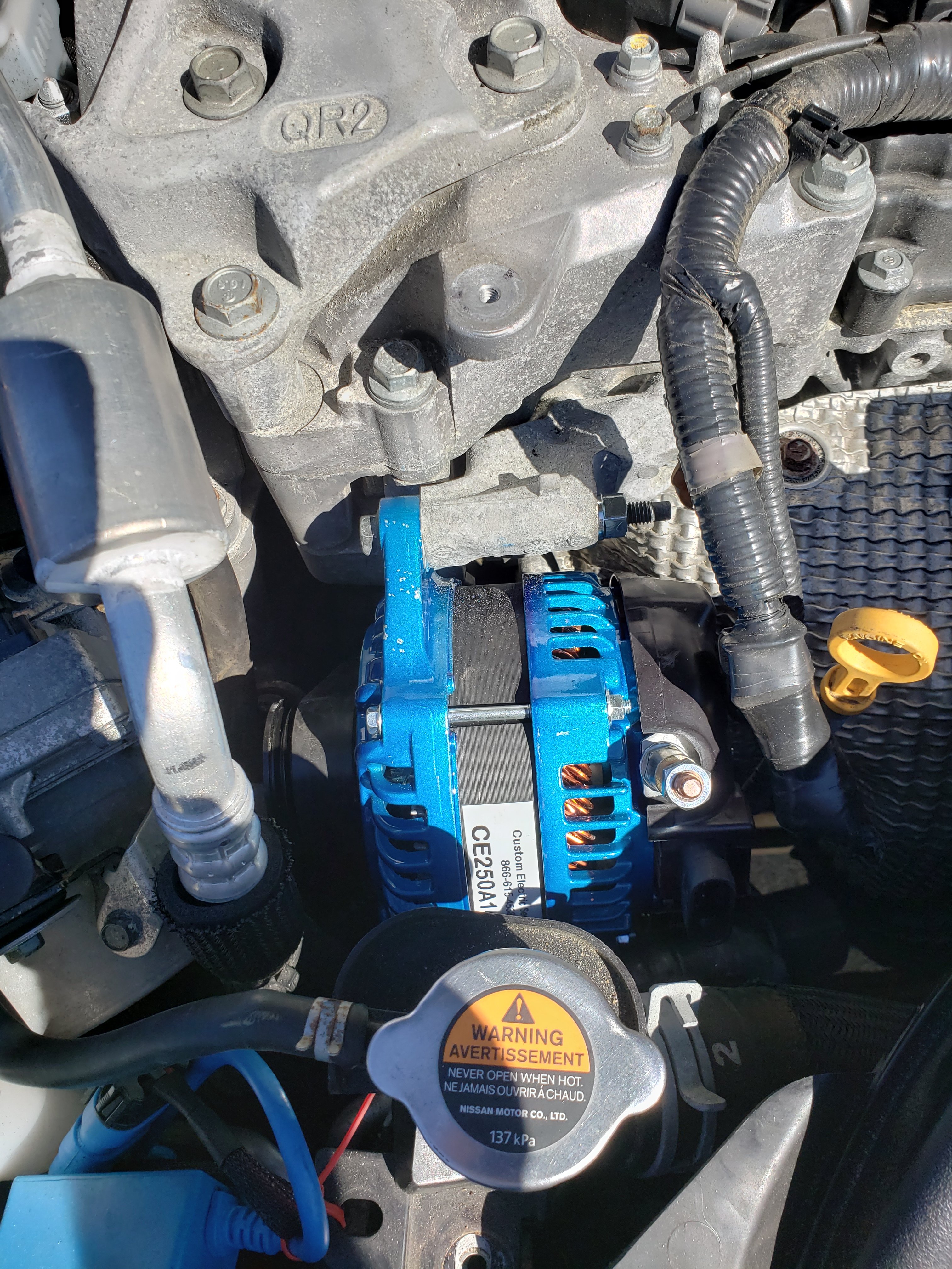

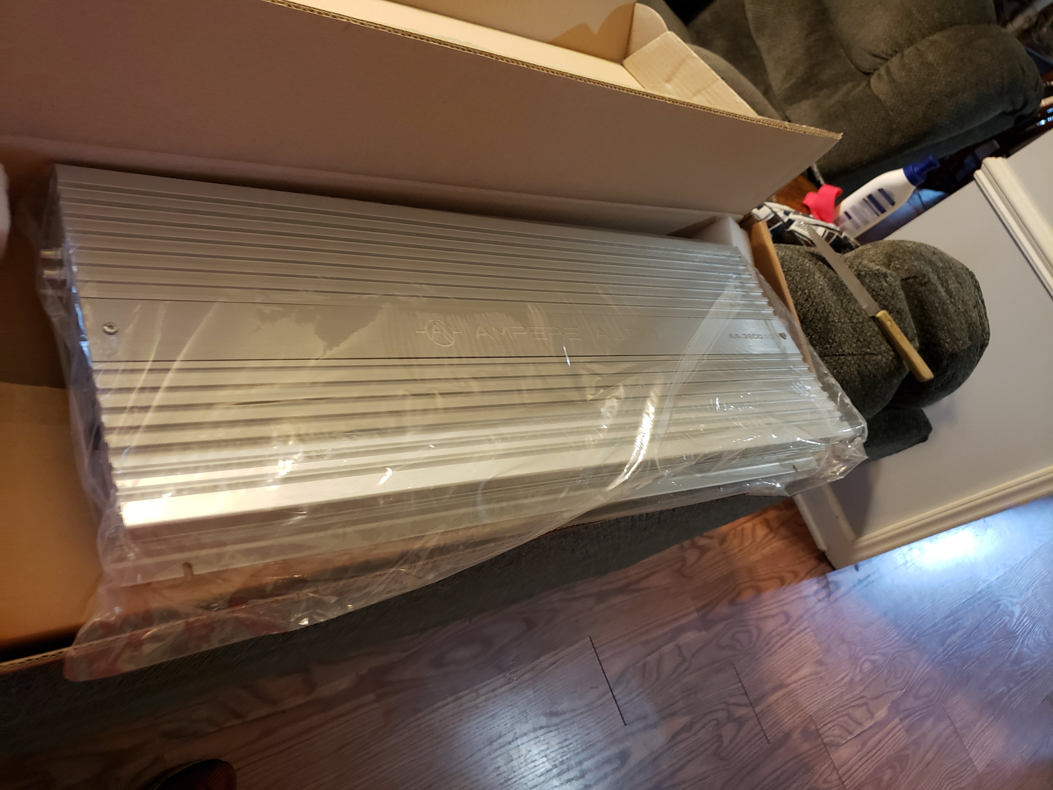

Build consists of:

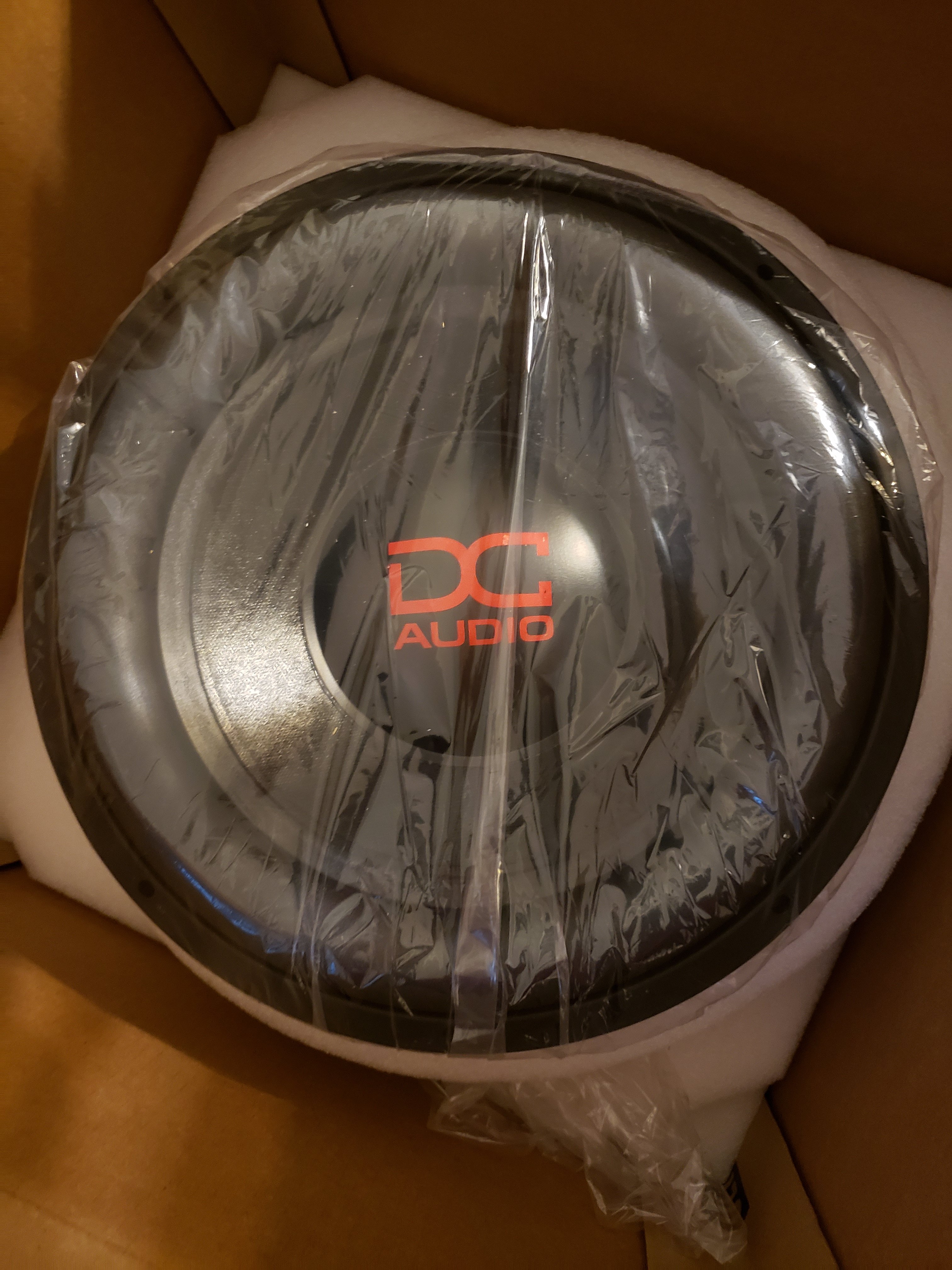

DC Level 6 15 D.7 coils

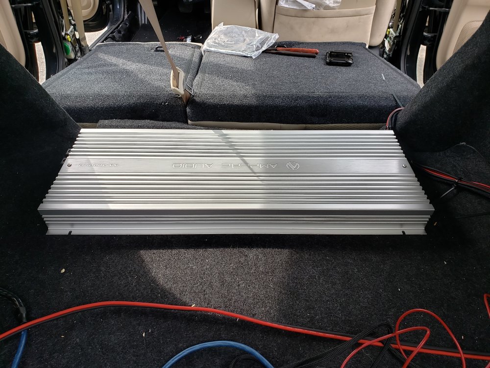

Ampere 3800 @.35 ohms

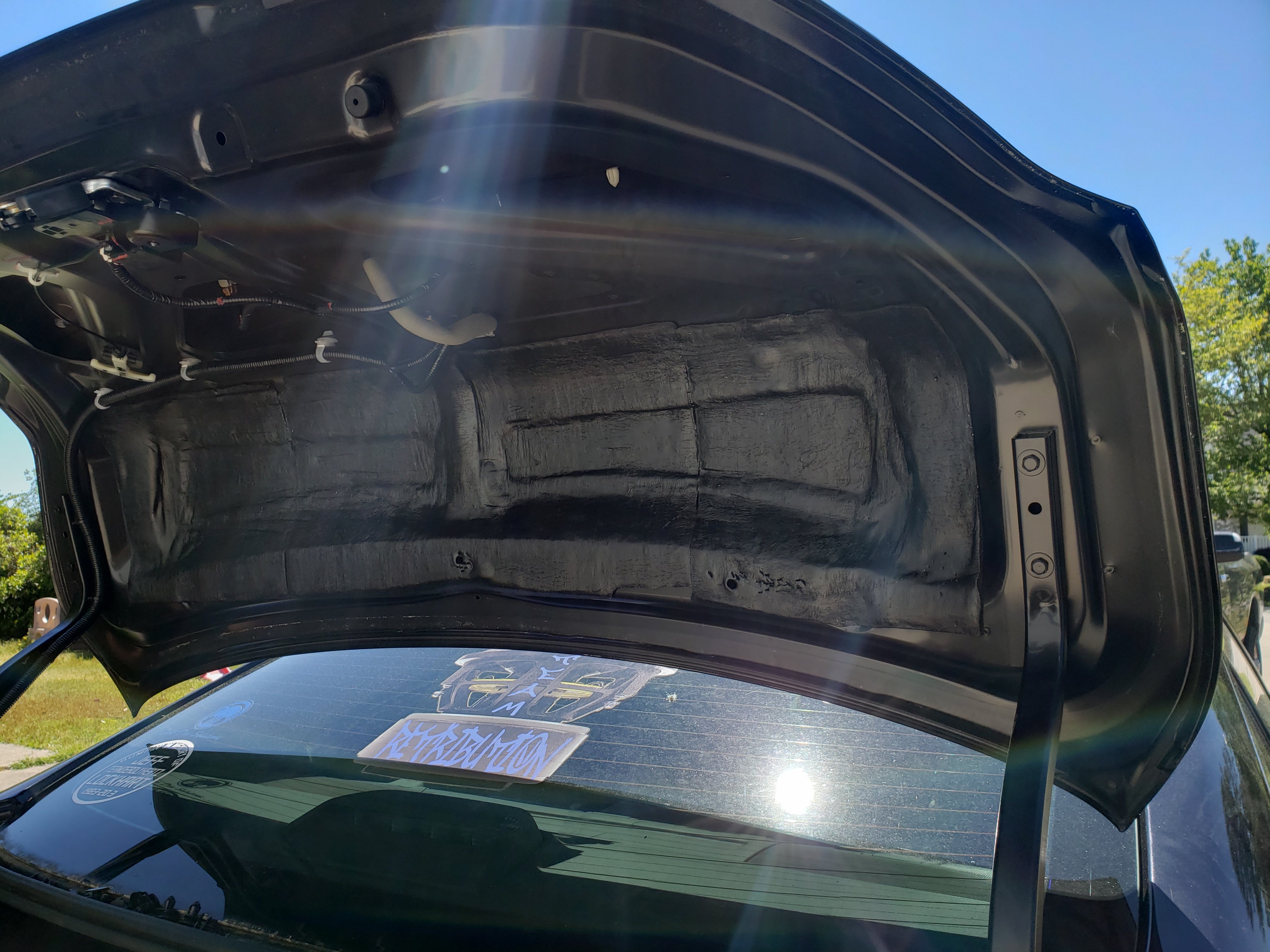

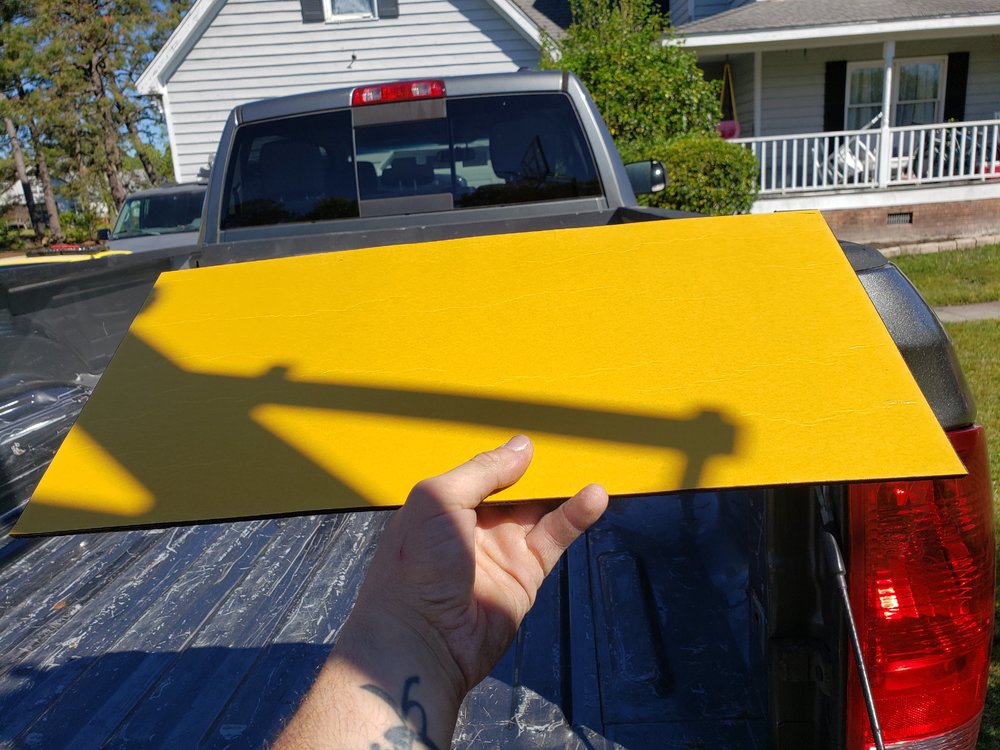

190 Mil Vibraflex

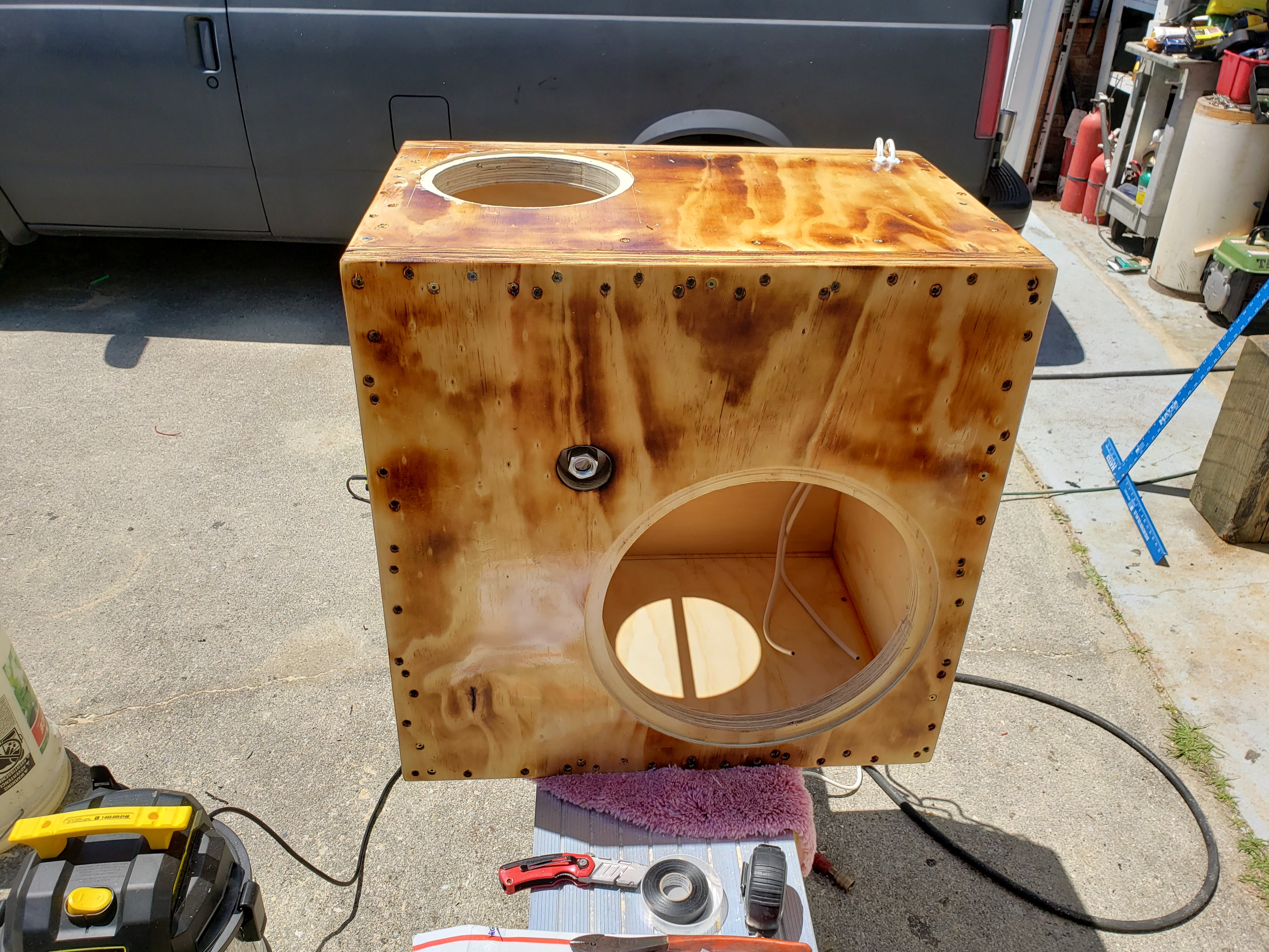

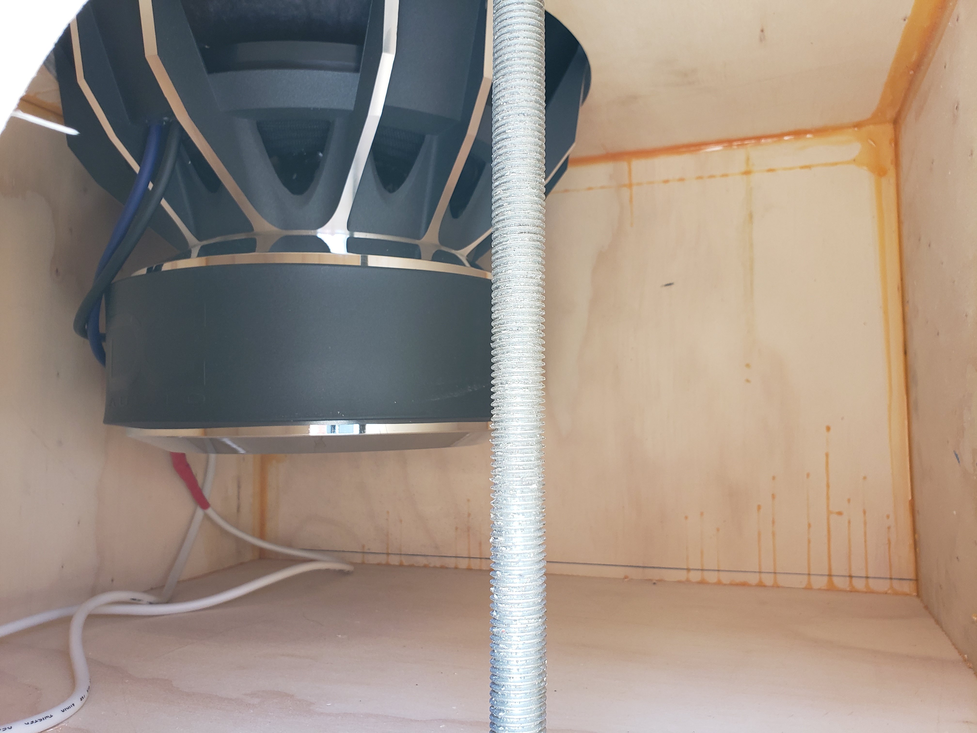

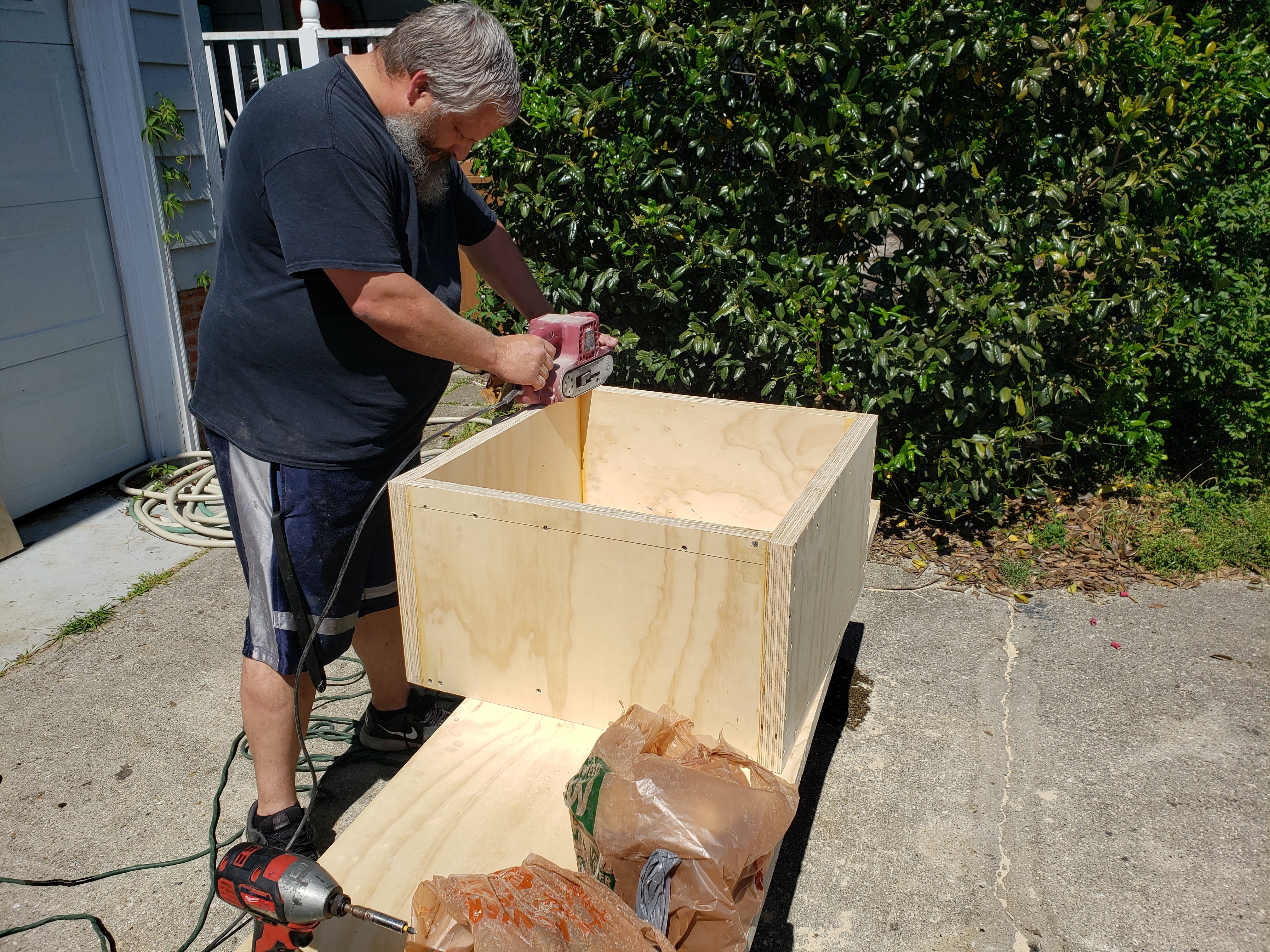

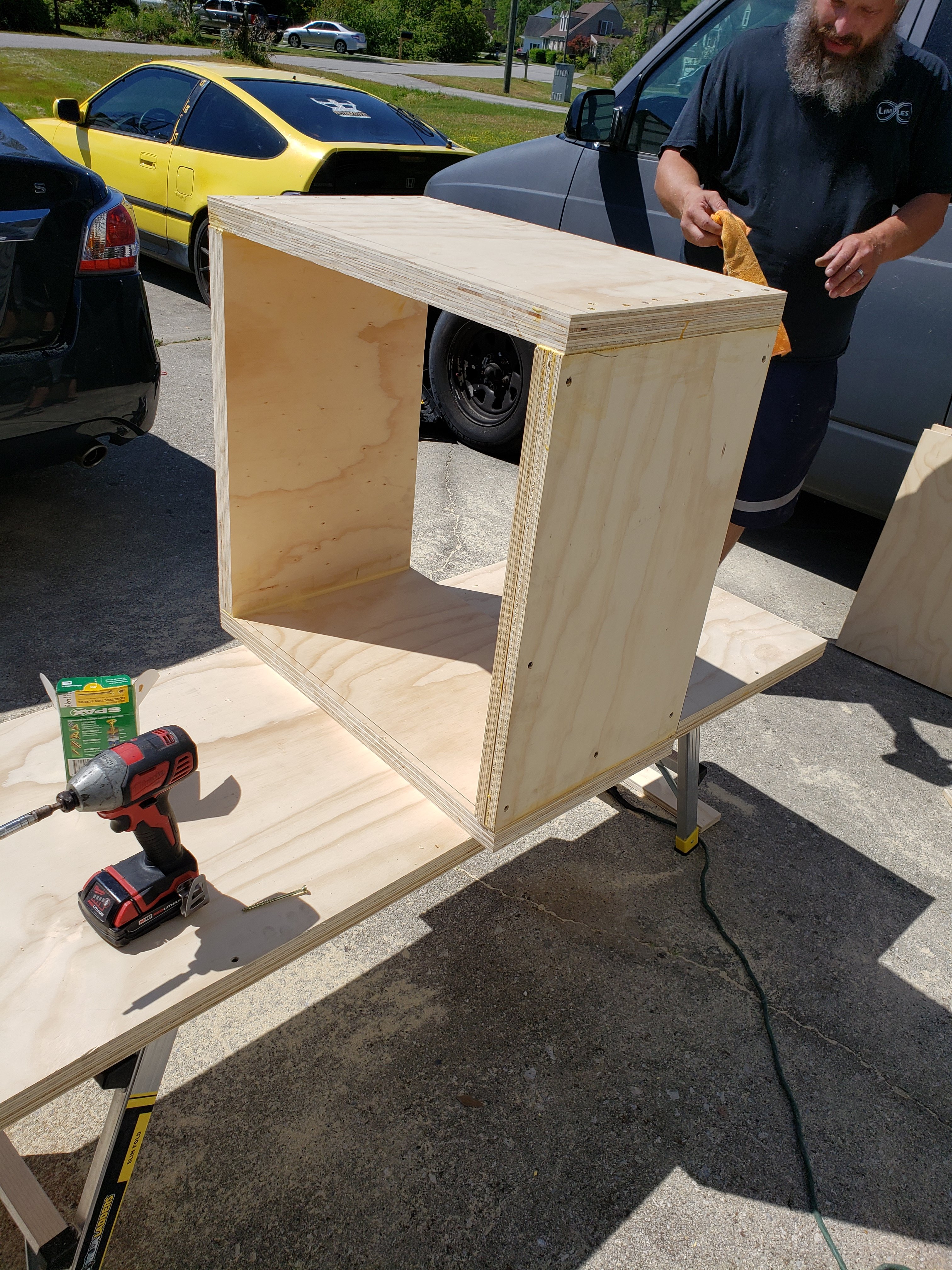

6" Aeroport 3.25CF box tuned to 33

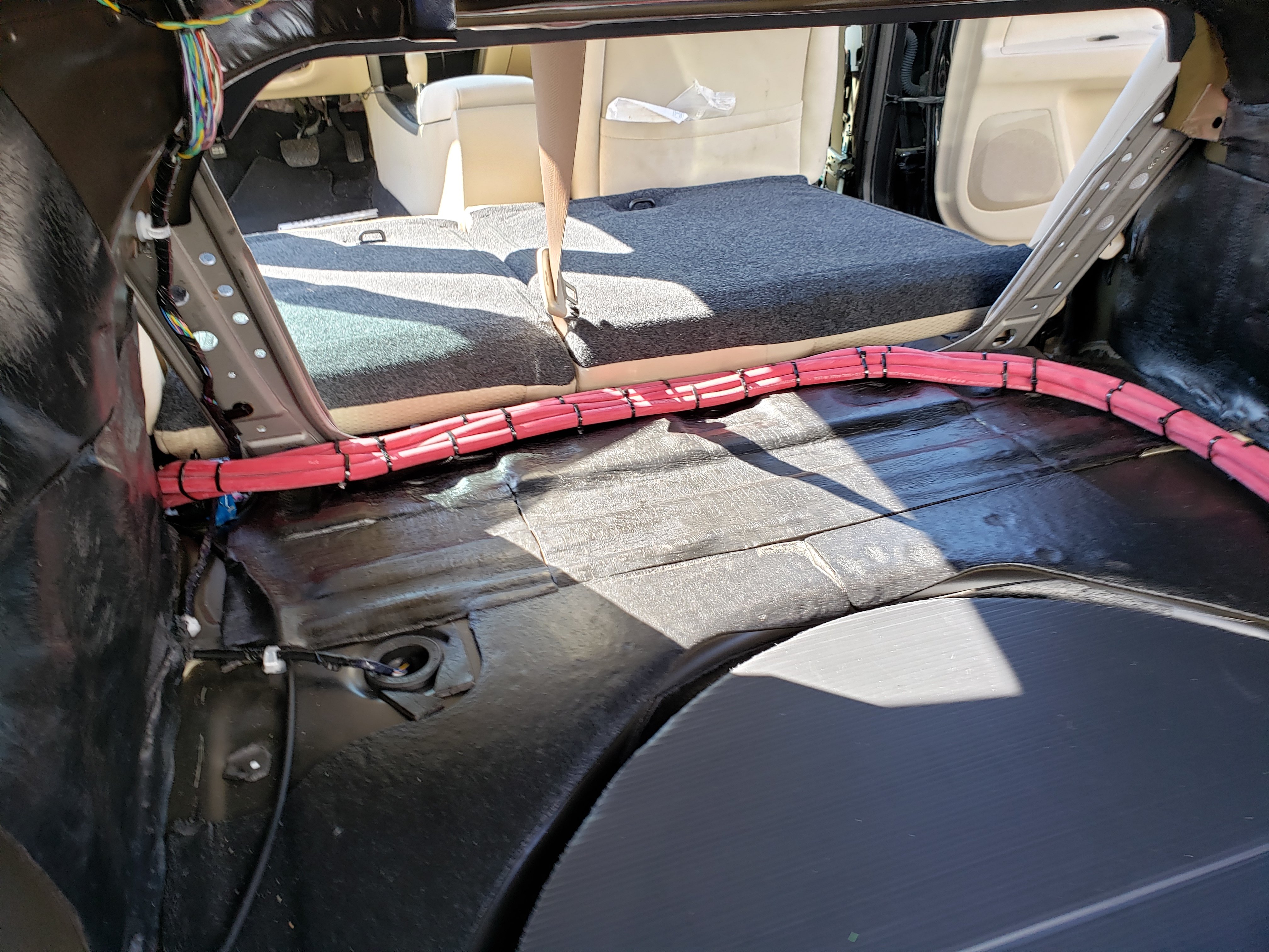

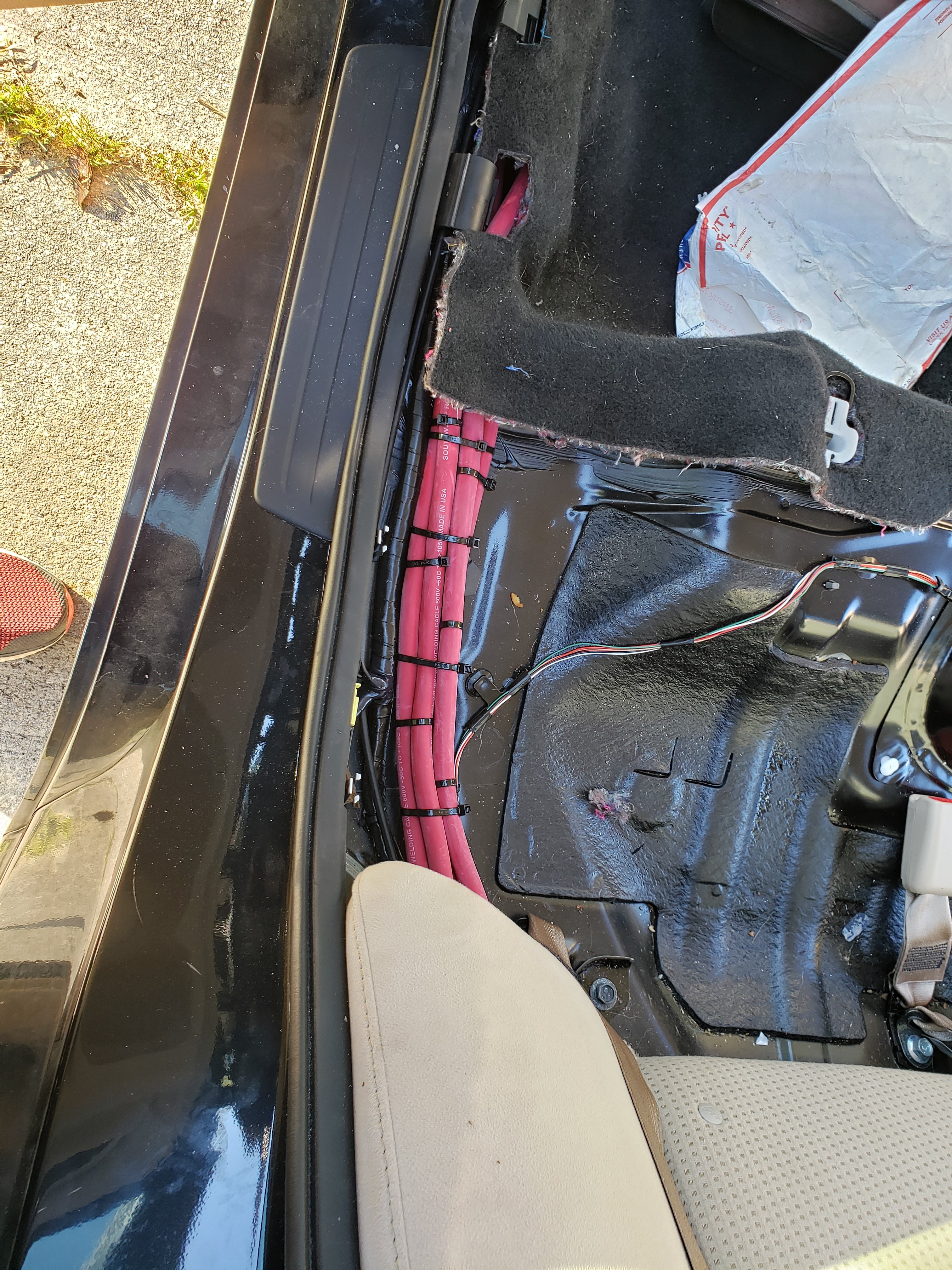

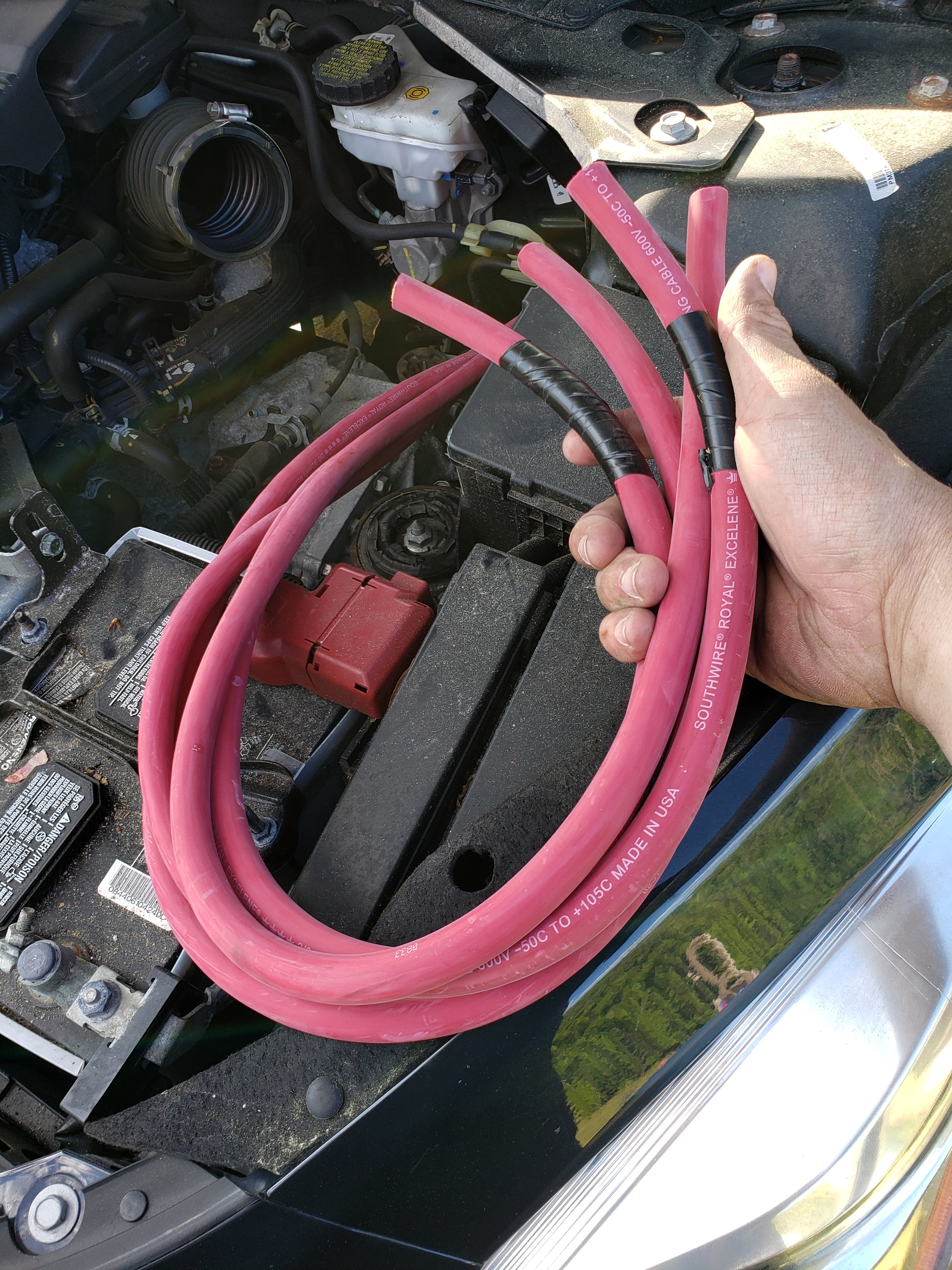

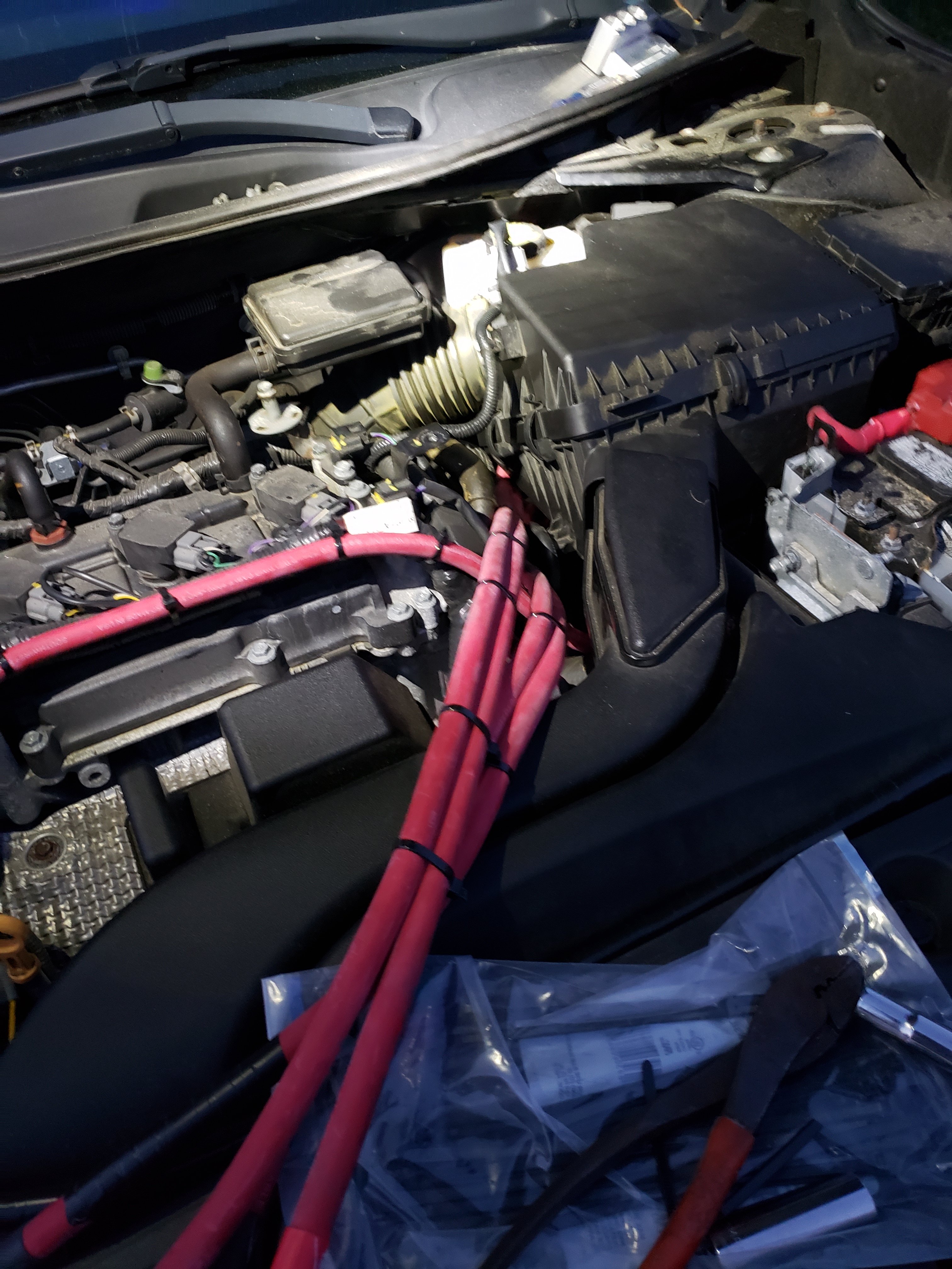

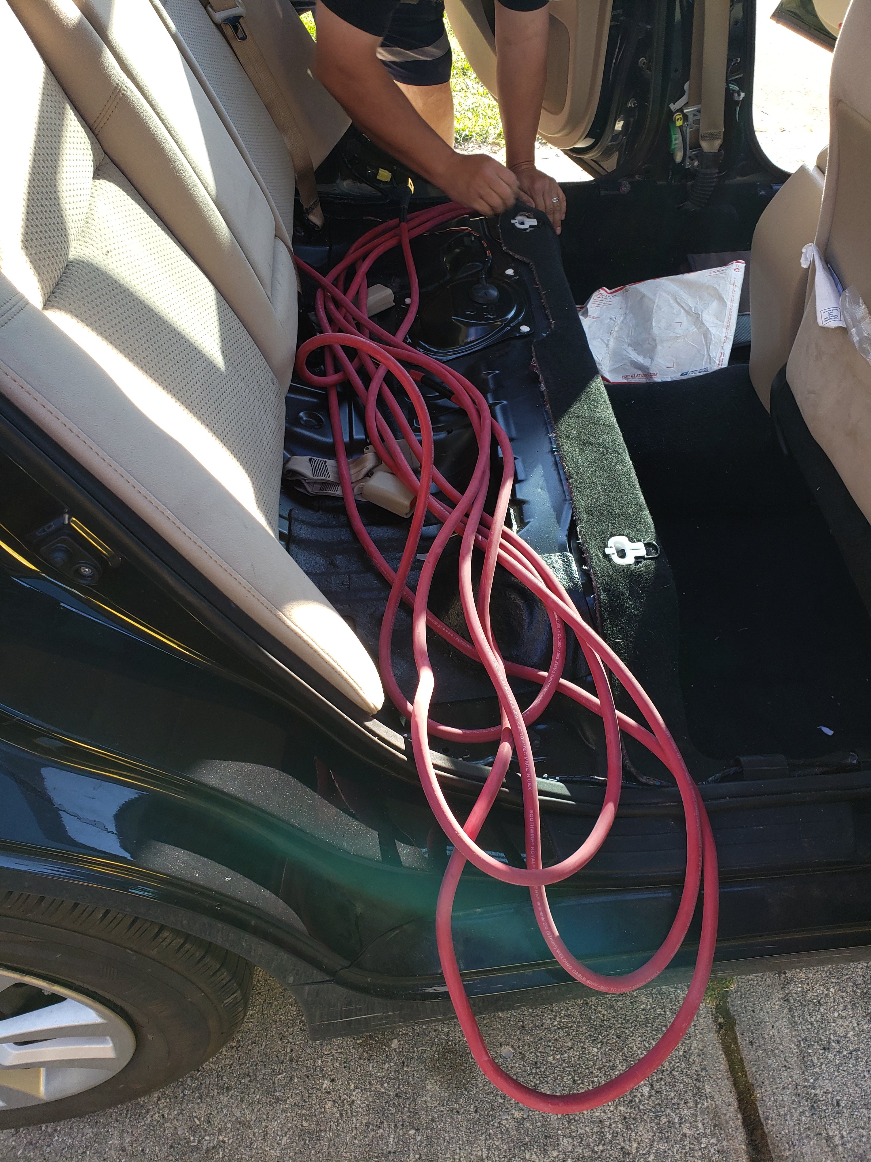

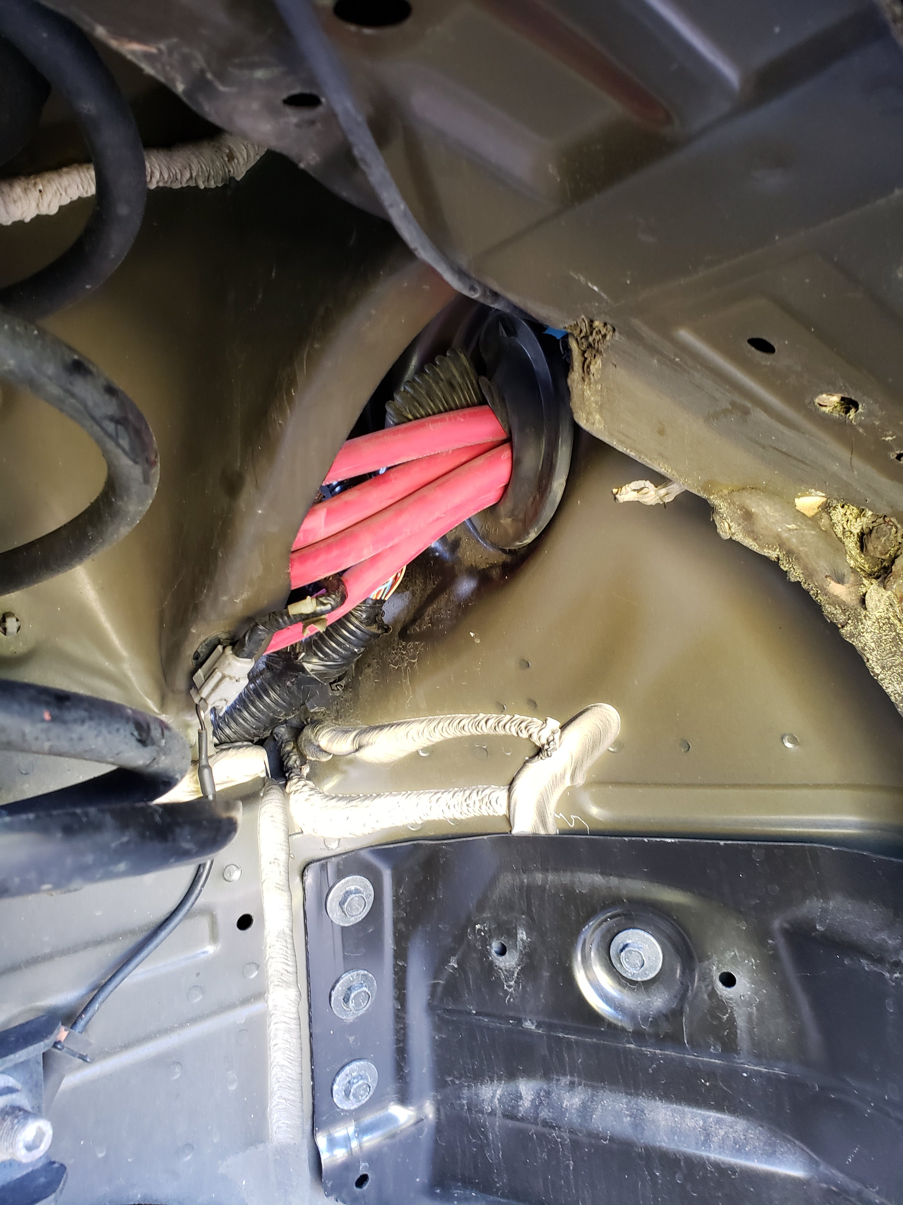

4 runs of 2/0 Royal Excelene Weld Wire

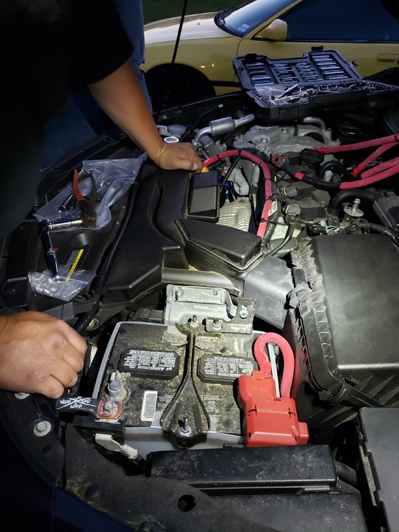

Big 3 using 2/0 weld wire
CES 250A Alt
Limitless 45AH lithium
Pioneer 80PRS
Taramps TS 400x4
McLaren 6.5" Mids in the doors
Demo Dan Solutions Dual Bass Knob with built in Voltimeter
**Pics may be out of order because my phone scrambled them all up for some damn reason and not everything was photographed due to being hands on in my build**

Best burp score sealed last night was 144.53 @ 38hz
Best overall score was 145.1 @31hz with the driver window down
**Lots of tuning left to do but it sounds great already**

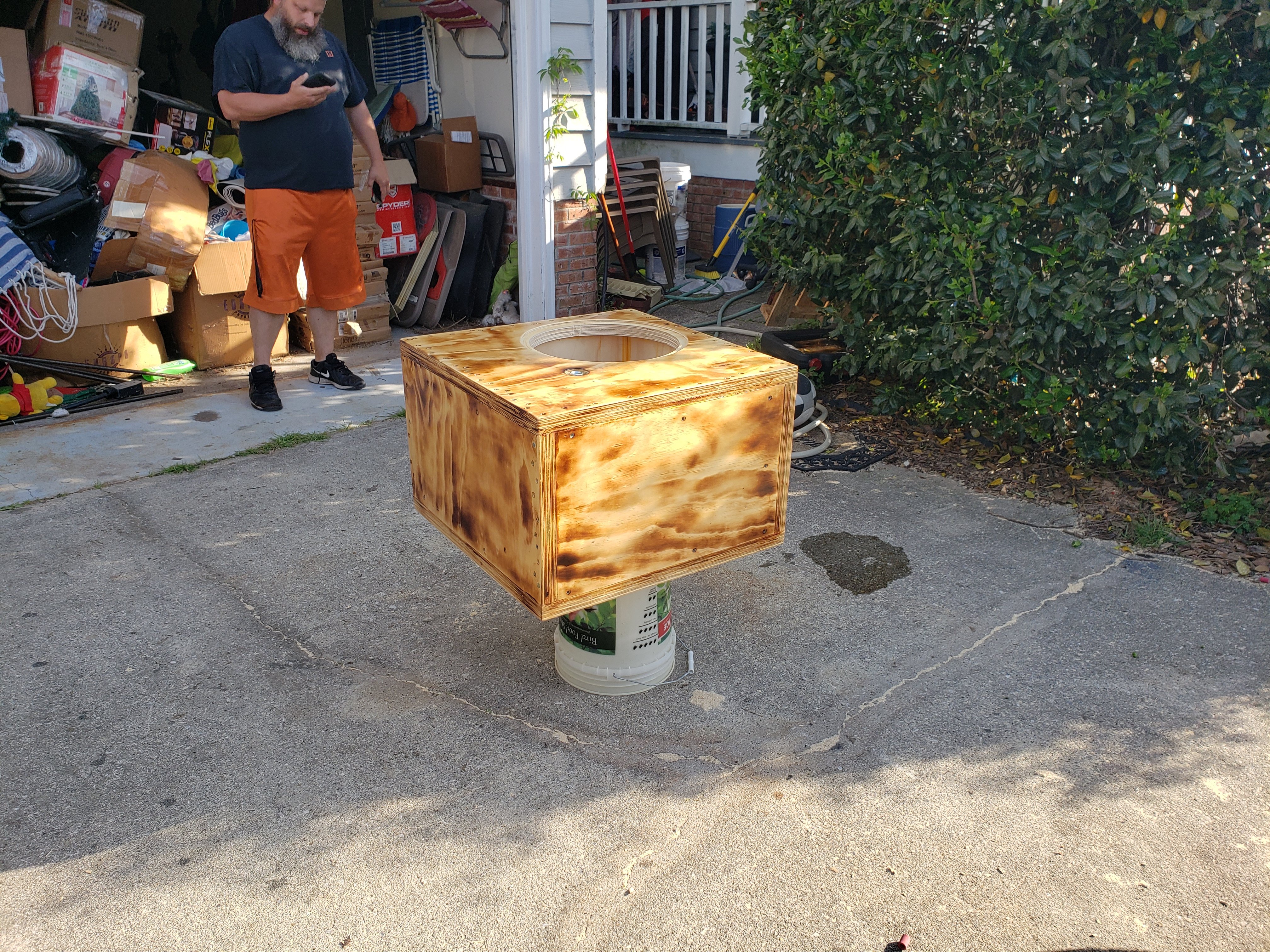

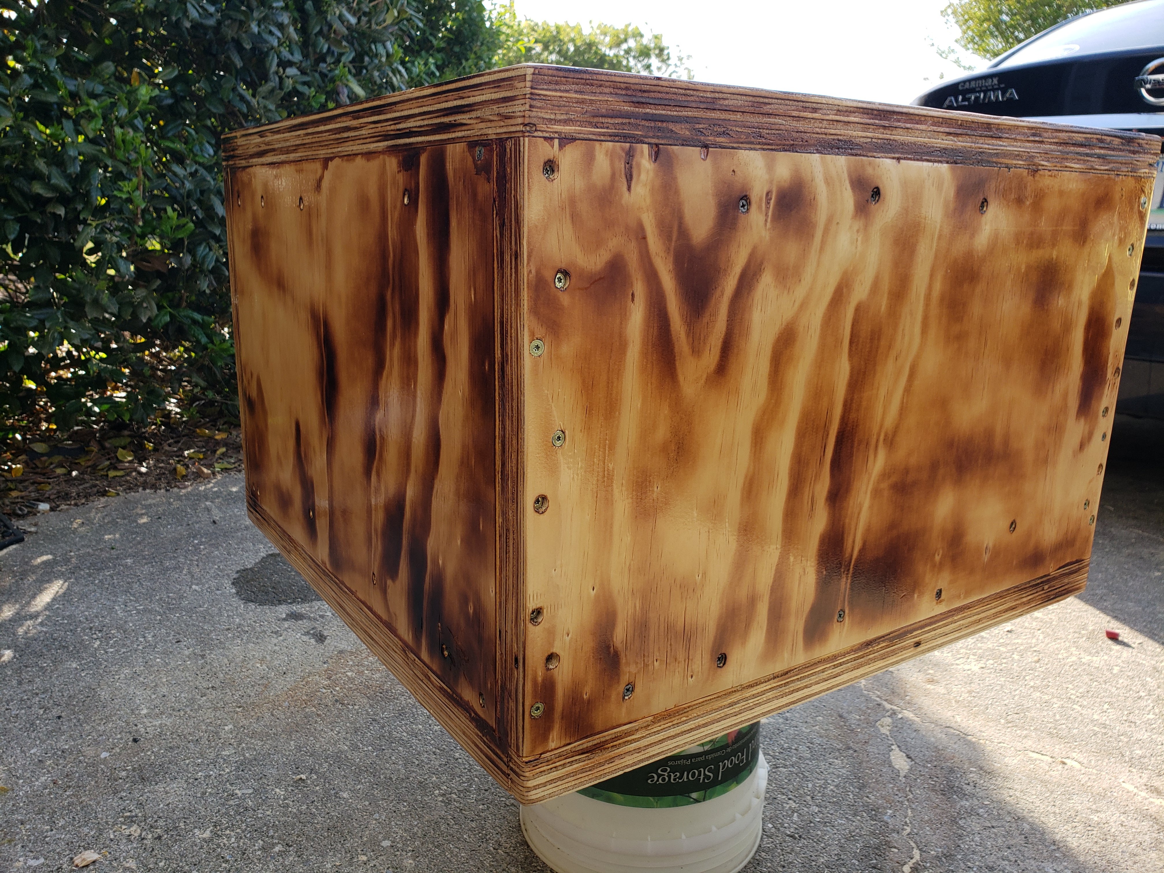

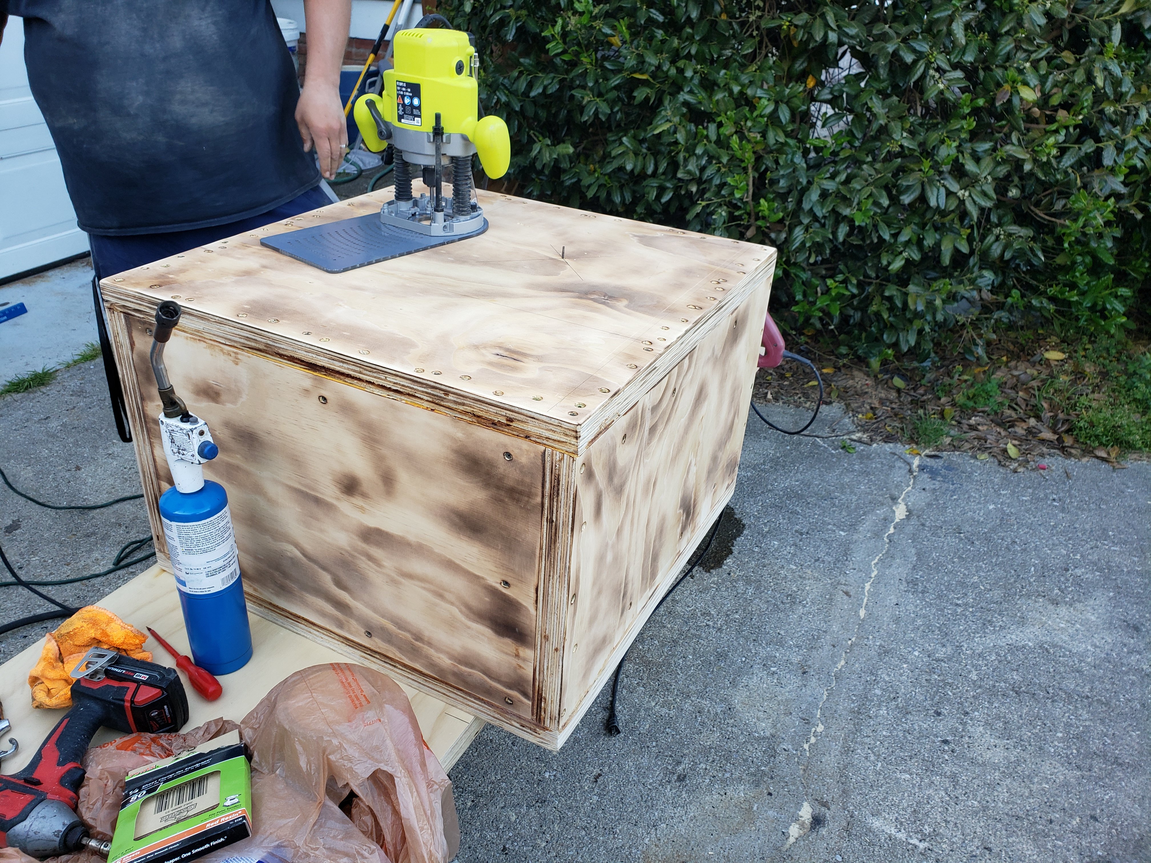

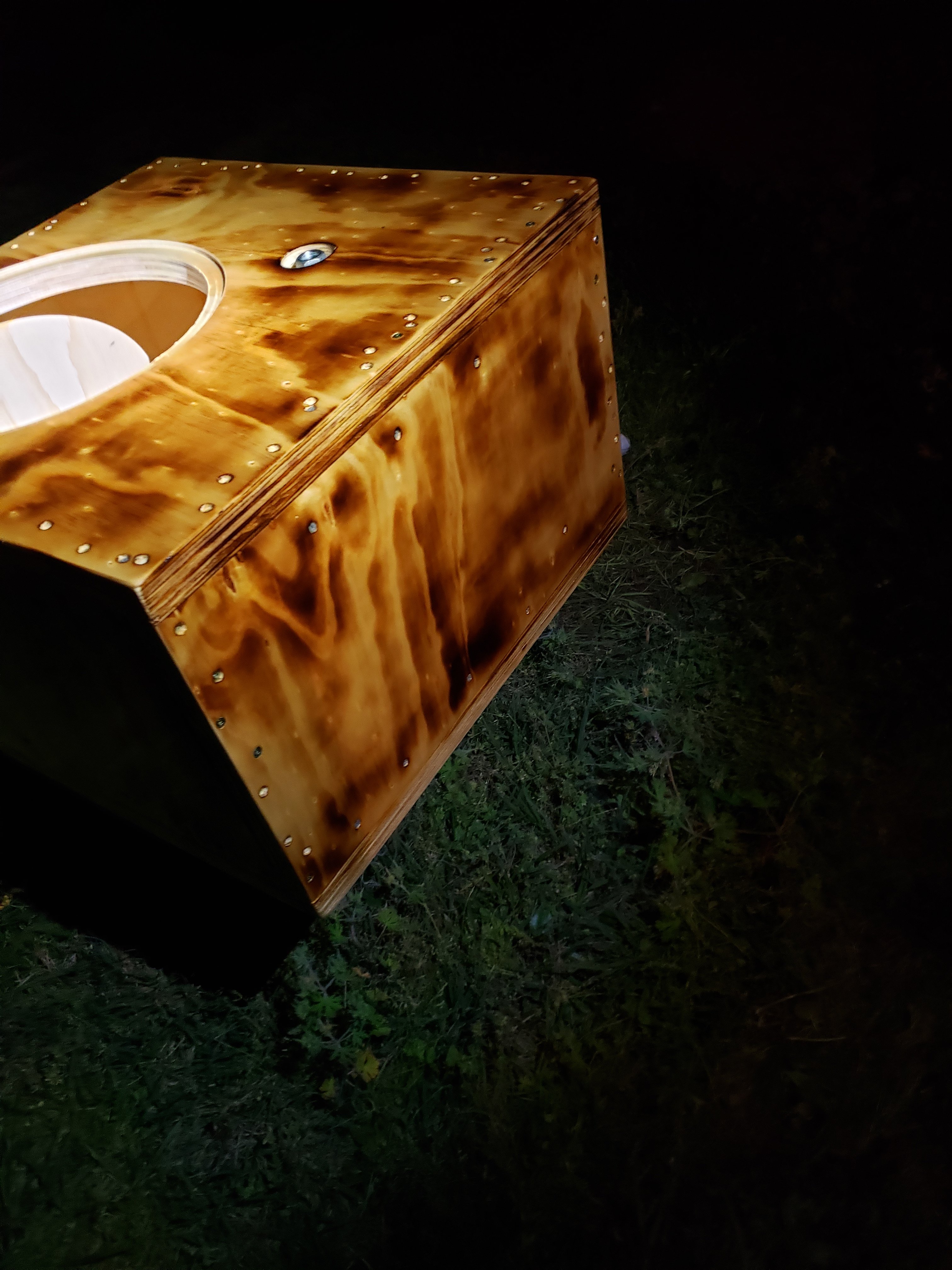

Box is cool too, I guess

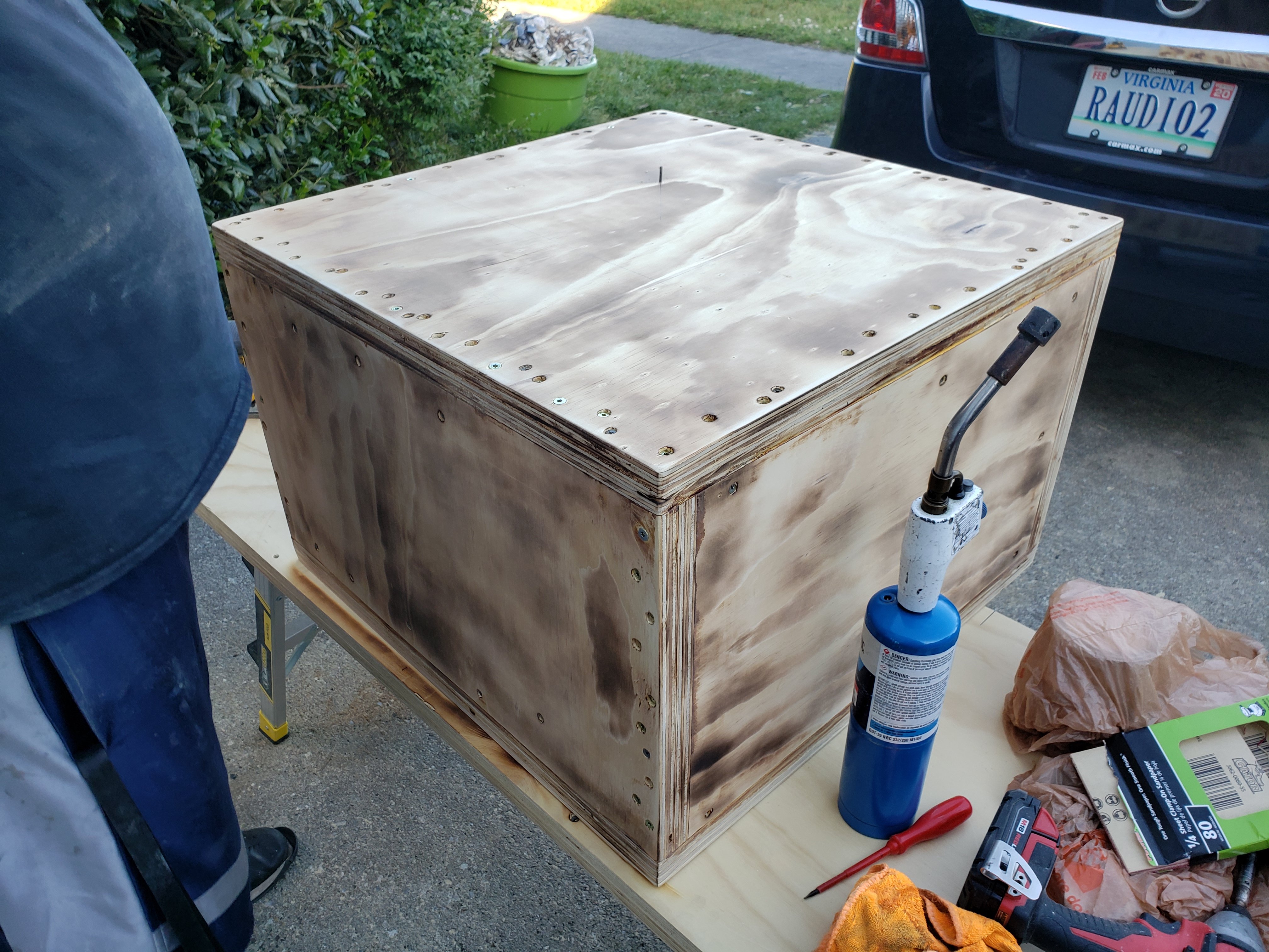

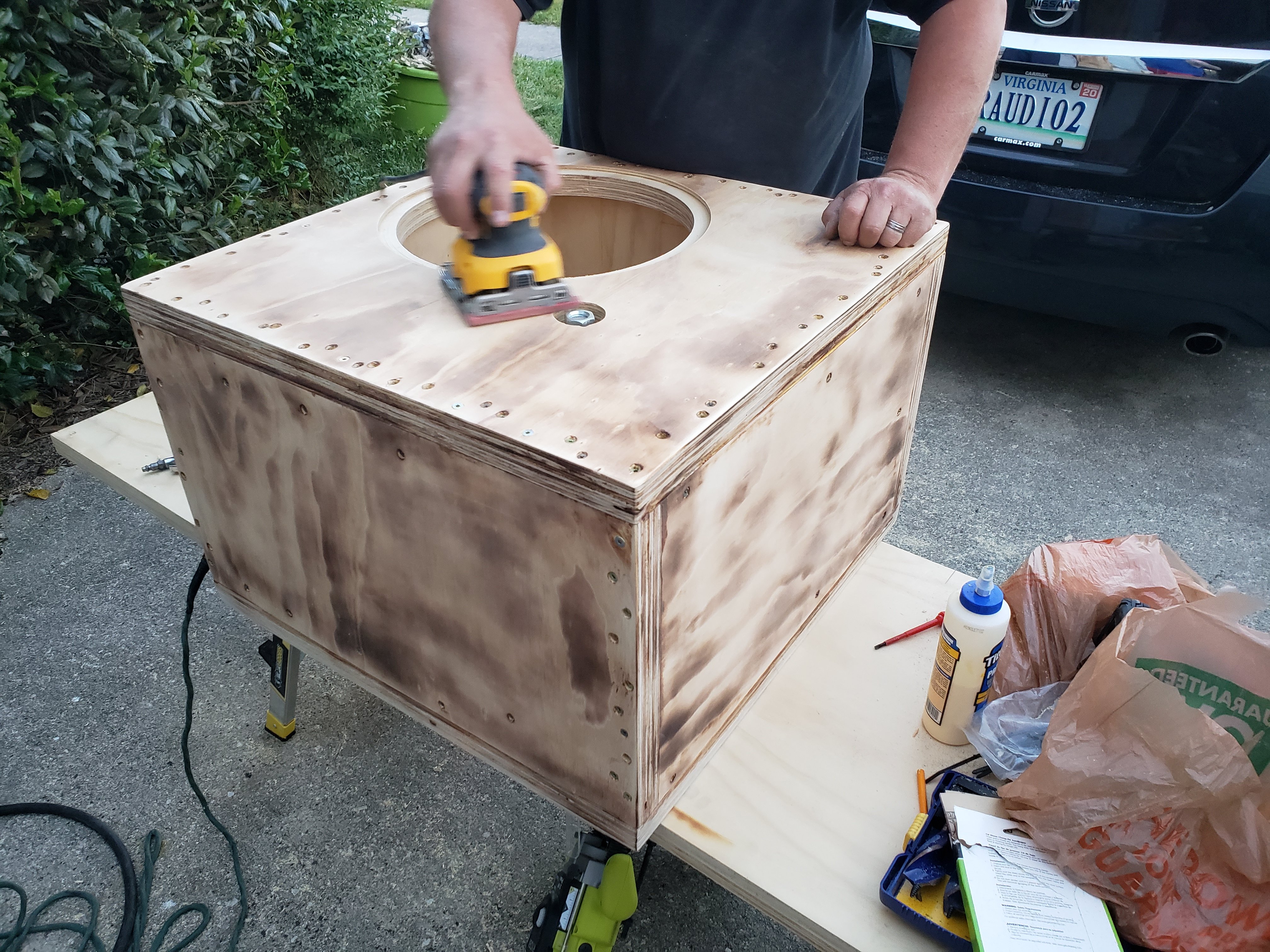

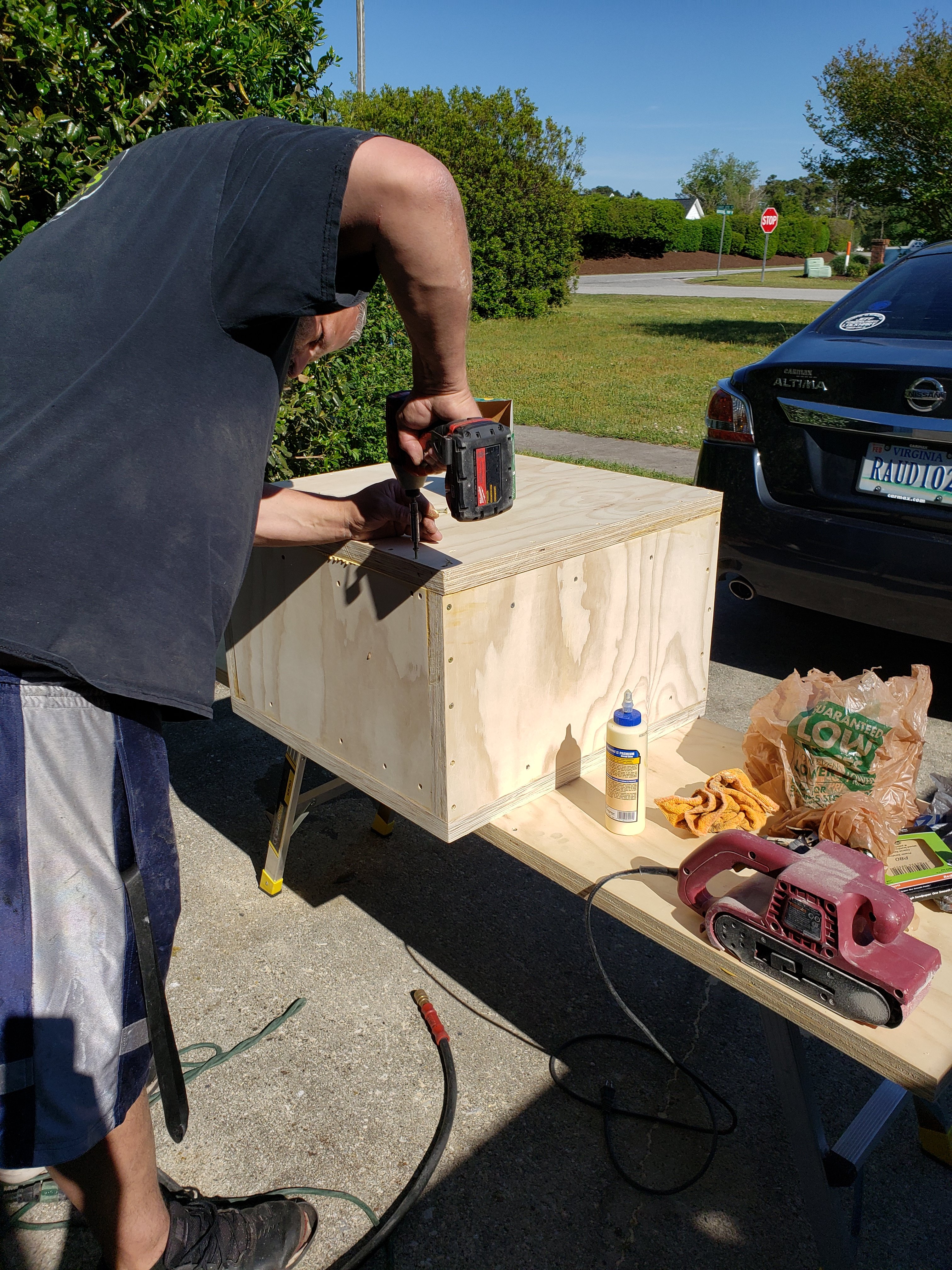

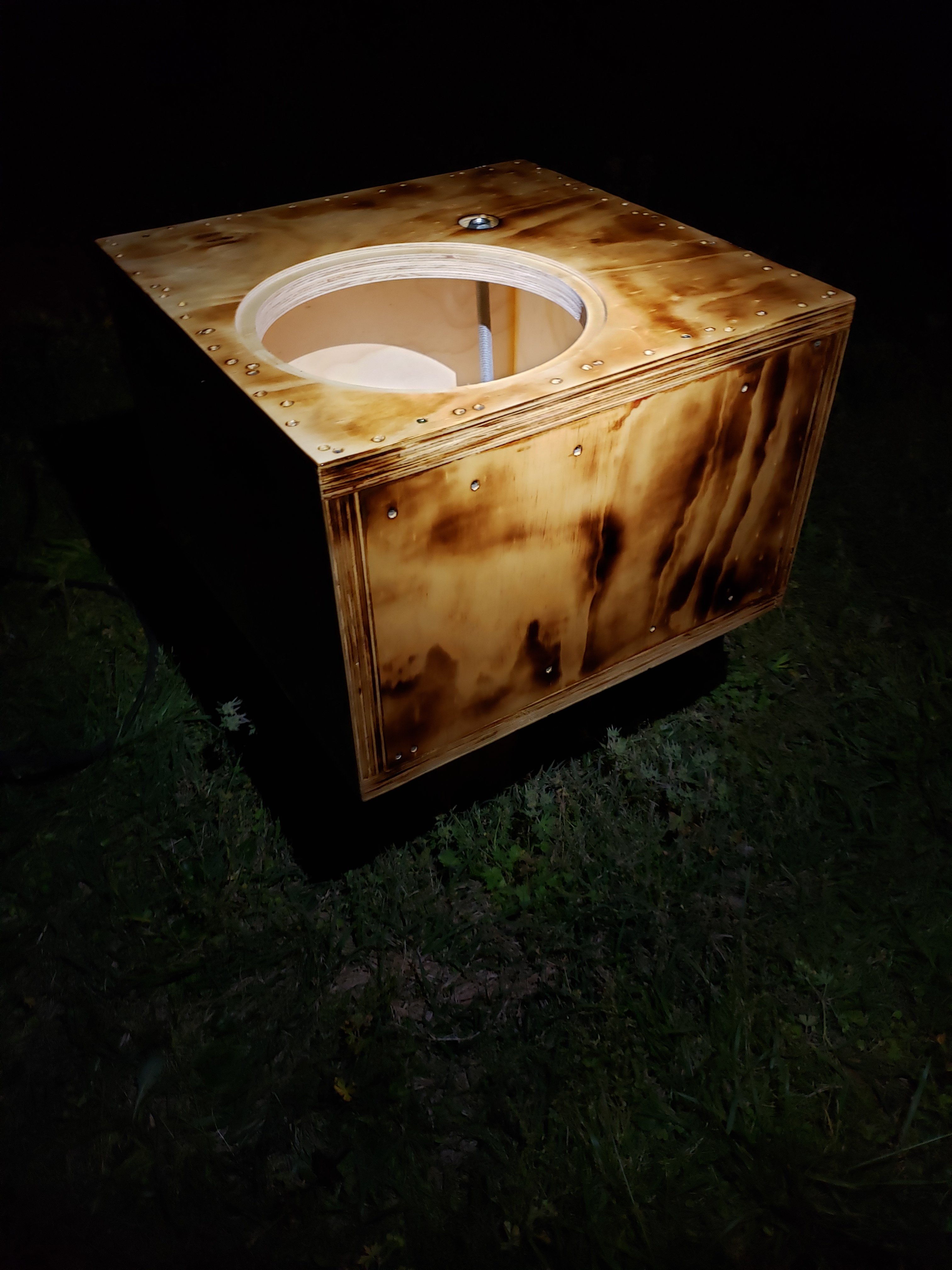

I love the box...Was crazy to see that torching, sanding then torching again followed by several coats of clear could bring out such a bad ass wood grain look :)
