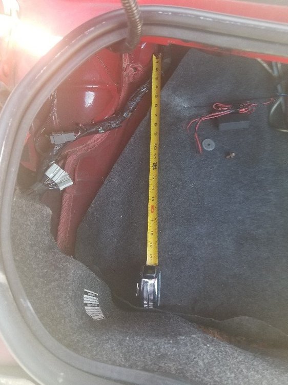

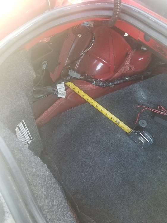

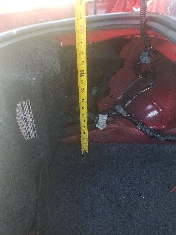

Dangeruss Posted May 13, 2019 Author Report Posted May 13, 2019 This is the area Im working with. The speaker will sit in front of the tail light aimed toward the center of the dash. The port will be up by the fender well pointed parallel to the speaker. Im going to re-do the wiring thats in the way to try and get as much space as I can.
