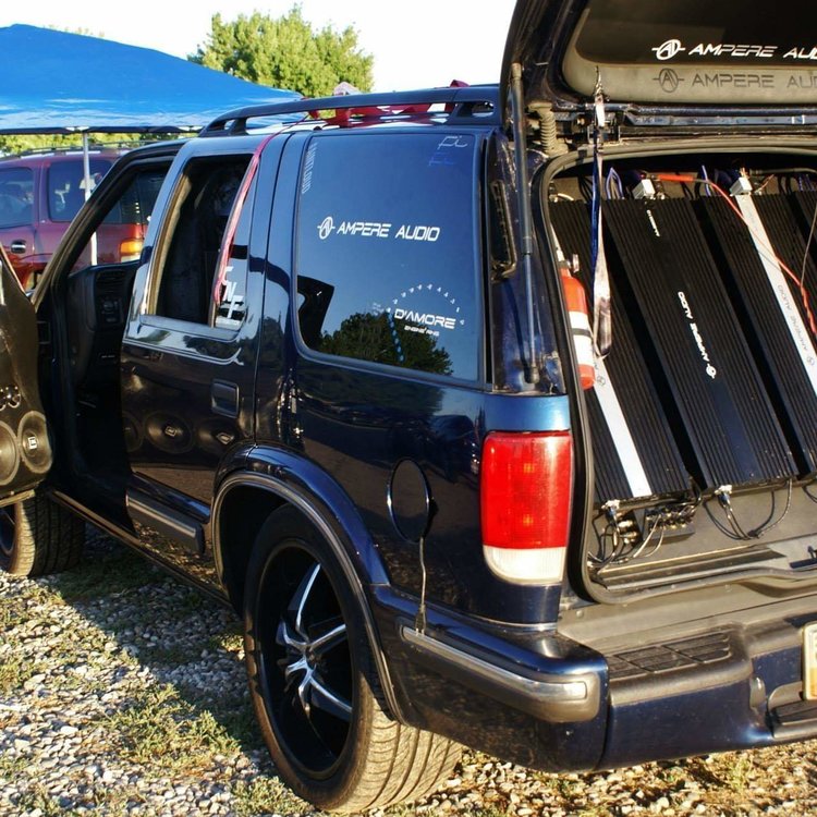

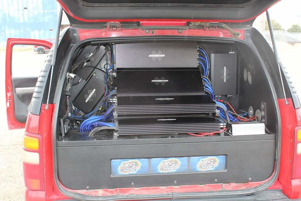

Kyblack76 Posted July 26, 2019 Report Posted July 26, 2019 One pac lc1 running 4 boards. same knob, different build with 6 boards, off one knob I, myself hate strapping boards and only gain match. Just personal preference. We used a Scott Bowman COCKBOX in both builds. Basically a one in, 4 and 6 out well made splitter. Worked great. Zero loss of any voltage across all chans. (You can see the cock box, below the first 3800, in the blazer, "top picture", below and left) SMD SUPER SELLER The Burban Build Blazer Build sold Acura trunk build sold
Ripkon Posted July 26, 2019 Author Report Posted July 26, 2019 2 hours ago, Kyblack76 said: One pac lc1 running 4 boards. same knob, different build with 6 boards, off one knob I, myself hate strapping boards and only gain match. Just personal preference. We used a Scott Bowman COCKBOX in both builds. Basically a one in, 4 and 6 out well made splitter. Worked great. Zero loss of any voltage across all chans. (You can see the cock box, below the first 3800, in the blazer, "top picture", below and left) Those Crossfires are so nice. Yea i have been talking to a couple people and ive been told to gain match. I dont mind strapping, but i feel im leaving some power. I want to try both ways and see if i can tell a difference. Yea i think ill get a Pac or i may just order the potentiometer in it "B50k" and make a unique one. Thanks for the input
