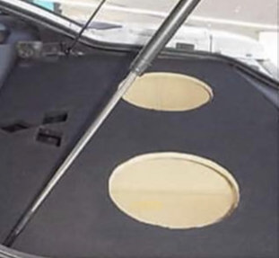

RF P3D4 12 - 600 watts rms at 2 Ohms going in this enclosure above gonna add another later on with another amp. Using all Knukonceptz ofc power ground speaker wire & rcas.

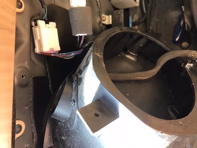

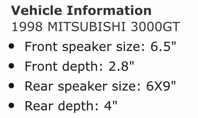

Already have these above looking at replacing the 6x9s & the 6.5s. Factory area for the 6x9 has a port never seen this BDF6B21D-E5F8-4722-8939-15476333DBC8.jpeg.b5244cd6977a5cd8d2849624e4e46fb1.jpeg

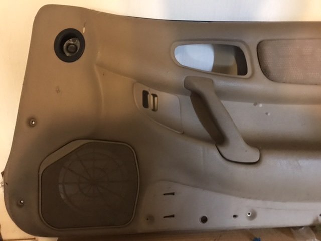

Budget is for replacing these is $300-$500491FCAB2-B2C2-483A-8894-F95514A08CBF.jpeg.db2c63cc451d99d14be8221a5c604a18.jpeg2810277E-C03E-4E6D-B0D4-73D648C3F053.jpeg.87fb282032c935dbc7ab0110ad891fcd.jpeg
Been thinking about maybe putting in 1 set of 5.25 comp or 6.5 comp upfront 6x9 or 5.25 in rear side panels. looking at
Cerwin Vega stroker pro cvmpcl6.5
RF pro pps4-6.5
Alpine R
