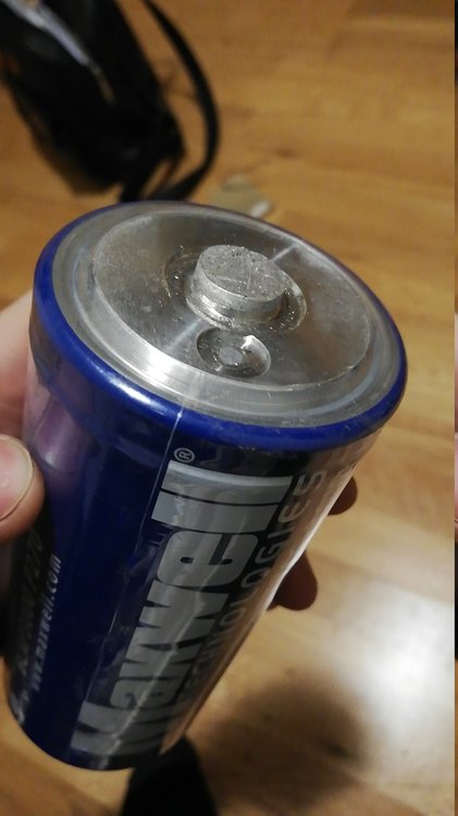

MarkInnelaur Posted February 6, 2020 Report Posted February 6, 2020 Hi. I bought some maxwelle supercaps from china and they turned out to be not with threaded terminals, any ideas how to connect them. Mark from ESTONIA.
kalilac619 Posted February 6, 2020 Report Posted February 6, 2020 Those are welded terminal style maxwells 2000 Suburban 6 runs of 2/0 12 JBL Pro audo mids ,6 timpano audio tweets and 1 Prv compression horn per door 475ah of yin long LTOs Triple 370 Amp Autotech Alts mids amps 2 Crescendo Skyway 3ks compreesion horn amp crossfire 800.4 Tweet amp Crossfire 2000.4 sub amp: 4 Crossfire XT 8ks Subs: 8 18 in Crossfires in a 4th order Best Scores at events… 163.5@38hz DBdrag sealed on the dash… 164.3 outlaw…162.9 Meca headrest

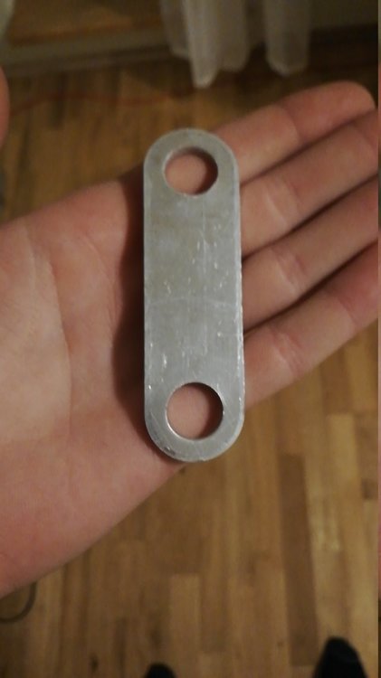

MarkInnelaur Posted February 7, 2020 Author Report Posted February 7, 2020 2 hours ago, kalilac619 said: Those are welded terminal style maxwells How do you weld them. Im afraid if i weld them with dig they blow up or get damaged by heat
Scotnemily Posted February 7, 2020 Report Posted February 7, 2020 Yeah I would think hard before attempting to weld anything on it. You might get away with drilling a hole and tapping it. Again I would be really careful unless you know how thick the material is there. The only other options I see are to try to use a super strong conductive epoxy, I have doubts if it will hold up long term. Or make some kind of clamp something you can tighten on to the cap. I have a few ideas. None are probably worth doing. It would be cheaper and easier probably to scrap the cap. I guess it depends on what you feel comfortable doing. I would probably try to work with it, but I don’t feel comfortable recommending that.

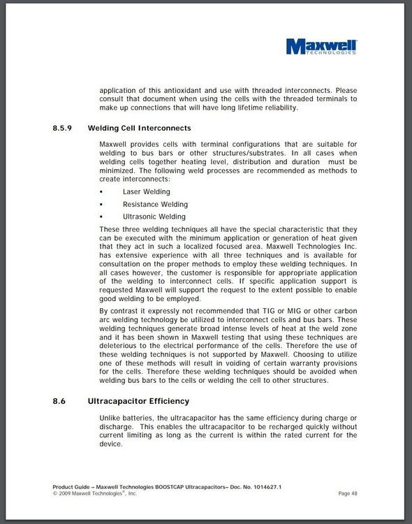

bmwking Posted February 7, 2020 Report Posted February 7, 2020 according to Maxwell the only way to weld the bussbars to the caps is via Laser, Resistance, or Ultrasonic welding. DO NOT ATTEMPT TO MIG or TIG the bussbars on as you will blow through the outer shield of the cap. best bet is to see if you can return them or sell them and reorder studded cells. sorry bud.
MarkInnelaur Posted February 11, 2020 Author Report Posted February 11, 2020 I found a firiend who has laser welding robot, well give a try. Thanks
