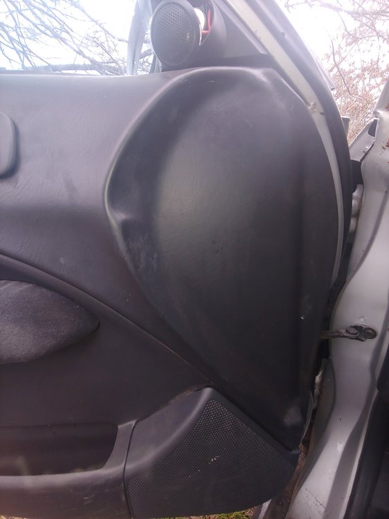

SkyrimNord Posted February 13, 2020 Report Posted February 13, 2020 2 hours ago, Second Skin said: Improve the sound quality inside the door why you are in there upgrading, throw in some Speaker Tweakers and sound deadening. Here is a snippet of the Steve doing a simple door upgrade with Second Skin accessories. What is he doing there inserting what that is inside the door? My door frame is flimsy and hollow. You can see the door in my pic in my comment above. I feel like it is making my speaker's sound lose out.
