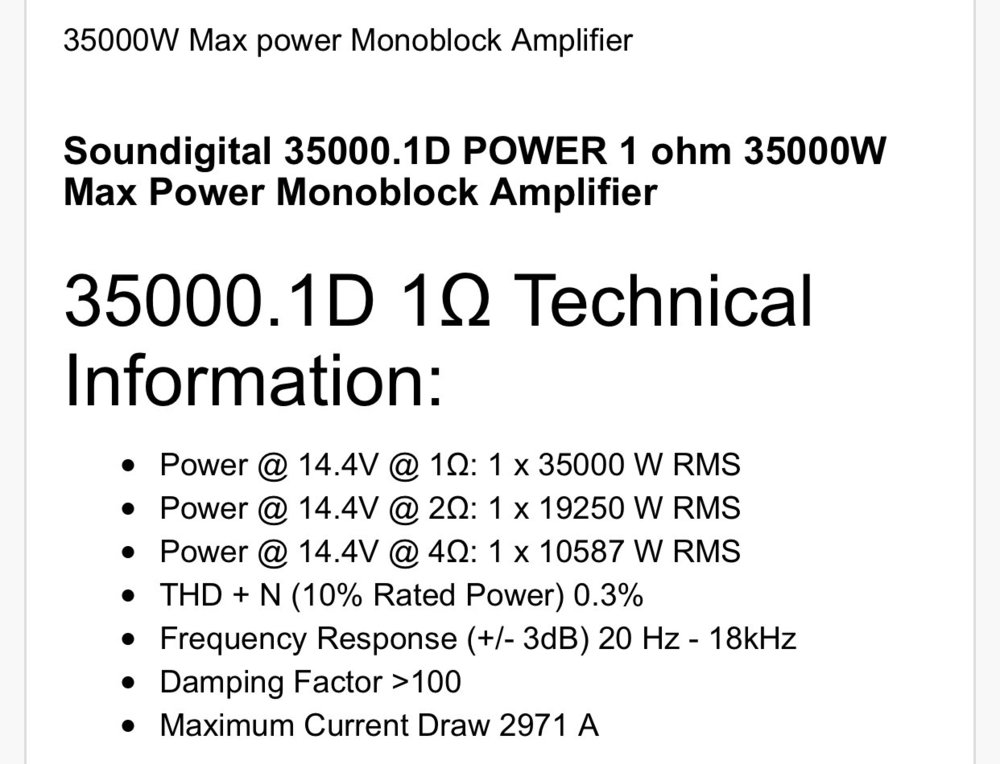

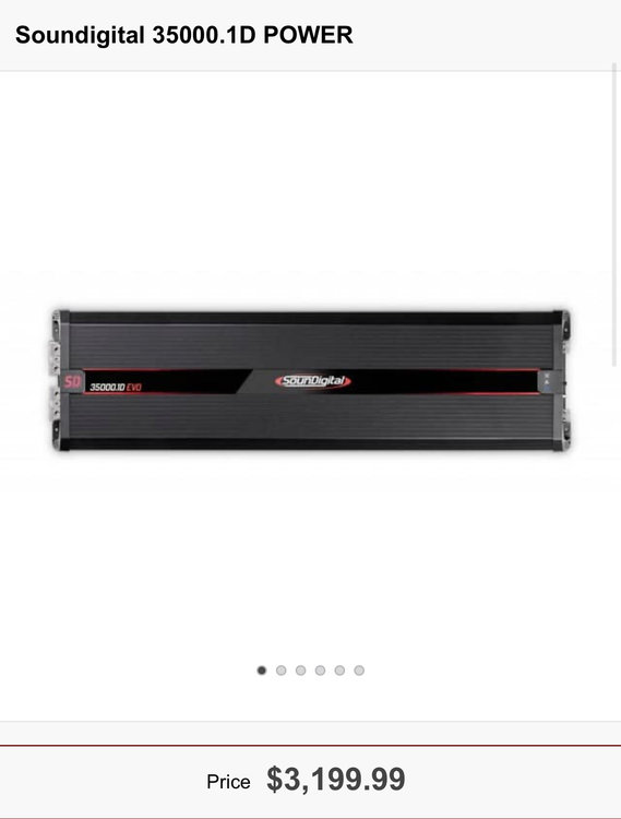

What would u need for this bad boy
With only dual power and ground inputs I’m guessing that’s 15k RMS so a couple good subs but until  I see it on an amp dyno not impressed. The new Sundown Salt 12k has 3 power and ground inputs and I bet puts out more power and can do .25ohms.

Its supposed to be quad 2/0 inputs, but yeah without a nearby buss bar/bank, its still cutting short.
I would run every input on that thing to dual input adapter so for every input on board you want an adapter that's going to give you two per single input.
I would also say lithium lots of lithium
And about three times the cost of the amp in power upgrades
thats thing is a monster, love to see it on a dyno
