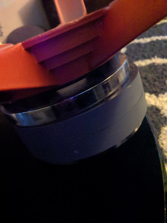

out4u Posted April 30, 2020 Report Posted April 30, 2020 Had the subs for a few years but only just recently got to using them . Did I bottom out or what? I have seen quite a few blown subs but never this. It's sounded off since I put them in, and the truck hasnt been drivable till now so I just recently got to take it for a ride , coil is not burnt and ohms out fine. Obvious scuff marks where it rubbed( which when I shut it down to further investigate I found it frozen)

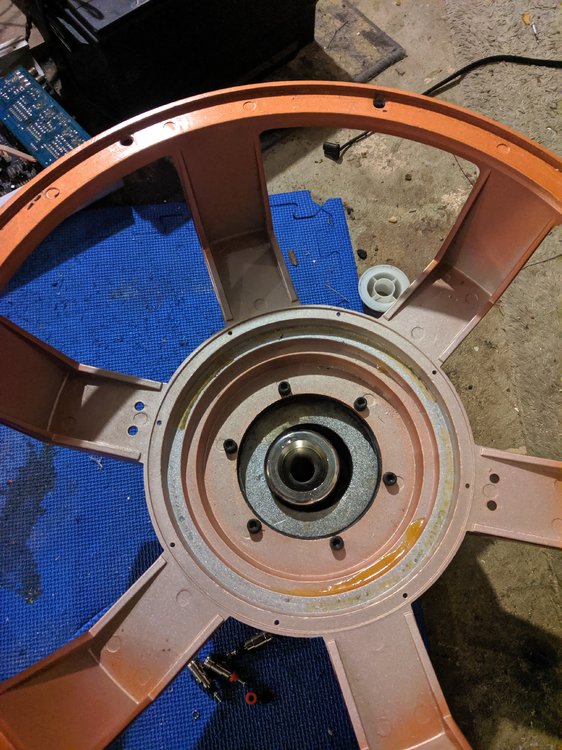

slowfkncar Posted April 30, 2020 Report Posted April 30, 2020 The glue that is supposed to hold the pole is no longer holding it together.
out4u Posted April 30, 2020 Author Report Posted April 30, 2020 Well that really sucks 😕 wasnt even running them hard gains all set properly with dd1 0db on headunit -3 db on amps. Given I have them on 2500 watts and it's a 1500 watt rms sub but I figured that would be fine especially using -3db tones. This isn't my first rodeo but godamn I figured it would take more than that to kill it or a coil would smoke before something like this.. I can't even get the thing back centered it won't budge.. Its a 18" crescendo forte wonder if I can get a compatible recone somewhere like psi so it's not just a paperweight before I get rid of the rest and go back to sundown since they have never let me down...

out4u Posted April 30, 2020 Author Report Posted April 30, 2020 Top plate shift I think I can fix it either way I feel like this was def a defect.. so done with crescendo. Never again
