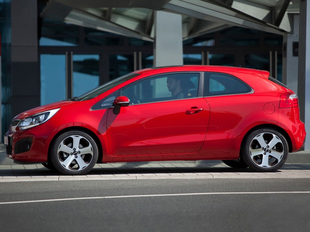

I am telling you it is pure horror to listen in this car I don;t get how in the name of Christ was this built take a look at its form from the outside how the heck side is cut here the trunk is, it's staggering for one to question himself for so many years and still not knowing wtf is going on it is pure torture

Look, in my other car I had a SPL Dynamics v300-s4 at 350W costs roughly 130$ in a prefab box it sounded awesome in that peugeot. The only big difference between this Kia and the 206 is that in Kia I have a whole inside when you open the trunk in the shape of the spare wheel, which I don't have, instead I have a some sort of flat tire kit, but the hole is there part of the vehicle, this is in Kia, as opposed to the Peugeot 206, which if you open its trunk and take the carpet off you didn't have this spare wheel hole, you would see bare metal, flat, the spare wheel is under the vehicle under the trunk on the outside. And the angle of the back window differs as well. Maybe this Kia is of poor acoustic materials composed. Doesn't the car's shape and building materials play a role too?
