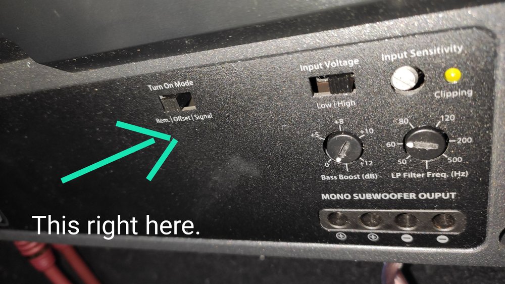

Qwiz Posted June 5, 2020 Author Report Posted June 5, 2020 Warning. You are not gonna believe this shit. It's clear now. I hope this doesn't turn out to be another illusion tomorrow. I did something today. I flipped a switch on that amp. You wouldn't guess which one. That did the magic in the end. Heard clean bass from the port. Every tune seems to sound exactly as I remember it. I now get the chest pounding upper bass and clean lower bass. All for a goddamn switch. I would presume there is something wrong with that part of the power supply section of the amp or something. Because what I did shouldn't have had such a great effect on everything. Here's what I mean. I have 2 amps and their remote wires are connected to the corresponding blue wire from the HU. The Mosconi amp just has a remote wire and no remote turn on settings. On the other hand, as you can see in the picture, the sub amp JL has 3 turn on features. I had it always set on REM according to the manual. Until today. I initially set it on Signal. No difference except when it turned off, the sub made a popping sound. Said ok, now let's set it to DC Offset. All of these settings were set while the remote turn on wire is still connected. Next thing I knew... wtf this is not real, tight bass? something must be wrong I thiught. So I began listening to dozens of my old songs and it sounds good. I will have to test it for a week straight. Every tune. It sounds this good with a flat EQ and still on the back seat. I can't even imagine how good it would sound in the trunk. Will come with a follow up tomorrow. Hmmm maybe the Radio isn't ideally wired. Found this regarding DC applied on a speaker. Could it be that the distortion I was experiencing was according to this post? " Now if you would apply a DC signal there would be a constant force working on the voice coil constantly moving it a little bit to the front or (if you reverse the polarity) a little bit to the back. If you would also apply an AC signal the loudspeaker would still work but on average it would not be in it's center "resting"position. This DC signal induces a constant force on the voice coil but it also heats it up as there is a current flowing and since the voicecoil's electrical wire has some resistance (4 or 8 ohms usually) some power will be dissipated heating up the voice coil. Another side effect is that good loudspeakers are designed such that the voice coil can move a certain distance to the front and a similar distance to the back. If you apply a DC voltage then you offset this as the distance the voice coil can travel will be asymmetric. If the voice coil can move 10 mm to the front and 10 mm to the back but you offset it with a DC signal by 5 mm to the front, the voice coil can only move 5mm to the front and 15 mm to the back. This will result in more distortion and worse sound quality." Like the sub moved unnaturally. So even though the problem may have been solved (needs intensive testing), I still want to understand why.

Qwiz Posted June 6, 2020 Author Report Posted June 6, 2020 I don't have any relay. DO I NEED ONE? Is there a specific post for this? Are the remote wires causing the sub to pip every time Radio goes on or OFF. The 2 remote wires coming from the 2 amps are both crimped and connected to the remote wire of the PRS. I initially thought maybe the switch DC Offset represented Remote, this being a factory issue, just throwin that out there. The bass is much much clearer I don't know if it's ideal, I need more time testing. The sub pops everytime I turn the Radio on and this happens to the sub only, regardless of the switch being on DC Offset or REM. Strange thing is that the Front speakers don't pop, never popped on turn on, only the sub. Do you think this is the issue? I thought about what you've said. Disconnecting the Mosconi remote wire. Yeah because in my other car there was only one amp. In this car I have always had 2. Maybe someone could explain more in depth this phenomenom. Also when you have 2 or more amps, and not having a 2 channel oscilloscope, how can you know they are in phase? I suppose when you have just one amp and the front speakers aktive they are autimatically in phase? So many things lol
CstrokerV Posted June 6, 2020 Report Posted June 6, 2020 try what i said and the pop could be a few issues.... the phase between the sub amp and mids and highs shouldnt matter that much if you want while playing slowly turn the phase dial see if it sounds better anywhere my build http://www.stevemeadedesigns.com/board/topic/142505-small-build-log-4-dc-lvl3-10s-tl-update-link-to-rebuild/ http://www.stevemeadedesigns.com/board/topic/154258-rebuild-6-lvl3-12s-update-small-video-nothing-spectacular/ new build http://www.stevemeadedesigns.com/board/topic/188181-03-trailblazer-slow-build-8-dc-lvl3-12-m1-motor-m2-parts/
Qwiz Posted June 6, 2020 Author Report Posted June 6, 2020 But if that fixes it, I would need a relay for the mosconi to be also on right?
CstrokerV Posted June 6, 2020 Report Posted June 6, 2020 if it fixes it you put the relay before both amps and run 2 wires to each amp my build http://www.stevemeadedesigns.com/board/topic/142505-small-build-log-4-dc-lvl3-10s-tl-update-link-to-rebuild/ http://www.stevemeadedesigns.com/board/topic/154258-rebuild-6-lvl3-12s-update-small-video-nothing-spectacular/ new build http://www.stevemeadedesigns.com/board/topic/188181-03-trailblazer-slow-build-8-dc-lvl3-12-m1-motor-m2-parts/
AaronT Posted June 6, 2020 Report Posted June 6, 2020 Here's the thing regarding remote turn on power if it's turning on all the amps is doing its job there's no halfway turning it on. Actually spoke with this topic at Rockford Fosgate tech support because I'm running for amplifiers off a deck. My deck puts out 400 Ma turn on. Each amp requires I believe 50 so Those are my particular amps and my particular head unit but forest from Rockford Fosgate sub if they're turning on that's tell, on is on there's enough signal there to turn the amp on it's perfectly fine
