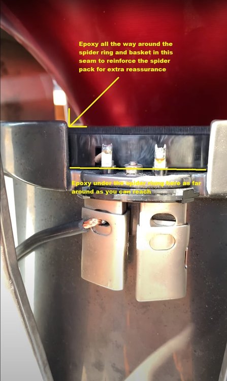

Get the self mixing tip type epoxy like Loctite 5 minute epoxy.
DO NOT try to break the rest of the spider pack loose on the other side because then the voicecoil will no longer be centered and will rub and you cant recenter it without shimming the coil.
Epoxy it, clamp it, leave sit for a full 24hours for the epoxy to fully cure (even though the set time claims 5 minutes).
Once that is dried take the epoxy and go around the top of the spider pack between the basket and spider spacer ring so glue can seep down between the plastic ring and basket. Do this all the way around if you are worried about the other side breaking loose.
Even if you cant get every little bit, the epoxy will be way stronger than the cheap glue used when it was built.

If that is the case take your chances, because the surround wont keep it centered.
The only real thing the surround does is aid in linear movement at high xmax to keep the coil square with the voice coil gap.
You have a 50/50 chance, really depends.
 If its fully separated all the way around I would try to find some way to index it to a piece of excess glue that is left behind so you know its centered for sure and clamp it without applying any glue under and only apply glue around the top gap to let it run down along the side.
Pushing on it doesn't mean much of anything because you can push on it just a little off and make a perfectly fine woofer rub. Plus you are probably not pushing or pulling on it hard enough to make the sub move like it does when its playing. Remember the cone moves out as well and not just in.
The ring is rigid and I can see tiny traces of glue and it goes right on them, on both sides. Gonna clamp it like that and try to push on the dust cap, or even power it up at lower volume and see if it’s rubbing.
