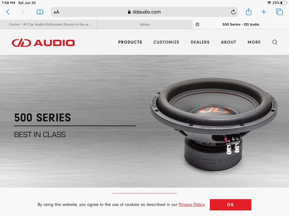

If U blow those DC’s up these are dropins for that box and can handle way more then rated. DD 500 series 10’s, sorry I’m posting so much I get drunk while watching UFC fights and start running my mouth.

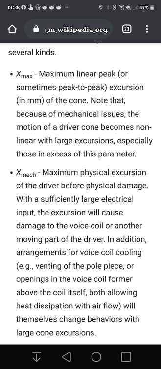

I dont make a habit of blindly listening to advise from anyone lol. I did my due diligence and am local to them so was able to listen to them. Even underpowered they sounded pretty good. But I don't own them yet.

Xmax is Maximum linear peak (or sometimes peak-to-peak) excursion of the cone.
Xmerc Maximum physical excursion of the driver before physical damage
point being they are often used interchangeably
Xmax is one direction dude. One way MAXimum voice coil eXcursion. second way voice coil retraction not included in xmax. Savard saying 40mm overall after it says 20mm of xmax confuses noobs. It says 20mm xmax in ONE DIRECTION and then has a comma and says 40mm overall. The xmax is 20mm and the overall voice coil movement is 40mm. Don’t come on this forum trying to correct one of the members when he is already correct. If you don’t believe us, then go google “what is xmax”. You really shouldn’t be chiming in when you don’t know what you are talking about. Especially saying the OP of this thread, who is knowledgeable, is wrong about xmax, which he is not. Don’t do that dude.

I'm going to assume my logical and respectful response got lost in the interwebs after hitting the submit reply button and just leave this here.... Because I sure didn't make it up and unfortunately not every manufacturer gives the one way excursion figures.
Assuming this would be the first thing a noob finds when searching T/S parameters via Google.
It says maximum linear peak excursion. Do you understand what that means? If you did then you wouldn’t be trying to prove false knowledge as truth and screenshooting Wikipedia. It’s one direction. When it says peak to peak, that still means one direction. It can move 20mm up past it’s resting point and 20mm down past it’s resting point. The xmax is 20mm, not 40mm. Linear is one stage of a straight line movement. When a subwoofer moves up on a note, that’s one stage, when it retracts, that’s another stage of movement. One stage of movement. One direction. Be it up or down. You are honestly trying to disprove the meaning of xmax to people that all we do is car audio. You originally came on this forum asking questions and seeking help. We came on this forum seeking to help people, answer questions, talk about car audio and bullshit around sometimes. If you don’t know what you are talking about and have to google it then don’t speak on it and definitely don’t give advice on it or try to teach about it.
