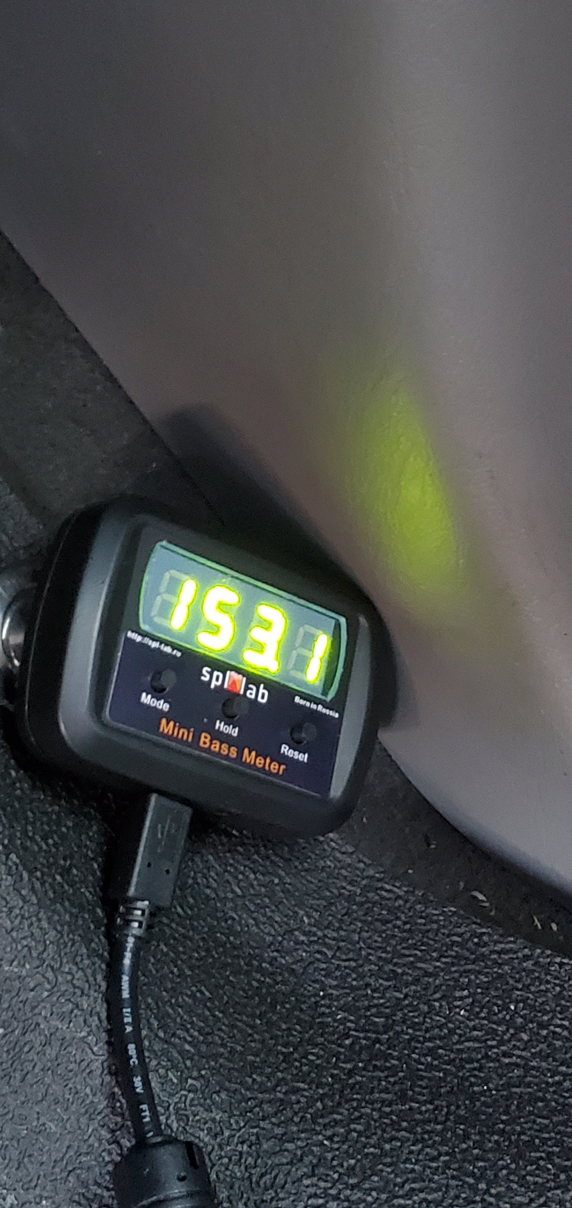

Lackheezy Posted July 24, 2020 Author Report Posted July 24, 2020 Thanks!!! Still doing work. But did a 153.1db so far. Subs have maybe an hour on them. My back window though. pffft. thats a nightmare in its own right. vibrates so bad....will have a solution soon i hope. 6 hours ago, SawDawg said: Yes sir! Loving the white inside with the lights. Very clean, props my man
