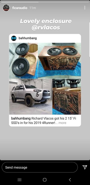

Dude, just saw your build featured in the FI Audio Instagram story thing.... whatever that thing is.... ripped from another poster. Your build is a hit my dude!

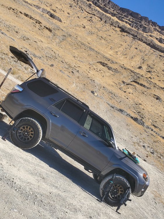

4 runner here as well, i tossed a kenwood in it, some rgb lighting, and such, and have some small audio shit lined up. 2 D'Amore amps, and some SB drivers and tweets coming, with some deadener. Mean while, ive been out and about,.. on adventures.
I'm kinda new to audio ;) been a while. Lol... if anyone knows lol.

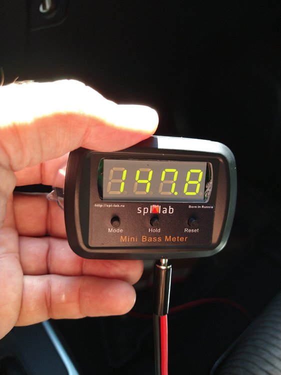

Was doing some testing and tweaking on my setup yesterday, metering it with a spl lab mini meter, plan to compete just for fun come December 13. NW2 class 30 second average. Best I'm able to maintain on MUSIC is a 147 for a first run. 146.8 on consecutive runs. This is with the vehicle fully sealed, meter on passenger side windshield. I'm dropping from 14.5 to 13.2. highest I hit was a 147.8 on a bass music track at 40hz. I'm running full tilt for 30 seconds straight each run with a constant bass line.
My amp is still turned down but after a couple runs the subs are getting pretty warm. Not sure how well they'll take the full power of this amp on full tilt runs like this... especially before the voltage drops. This amp wants beefier subs lol
Will be doing some more tests and tweaks. In this class even a 145 will be decent. This setup wasn't designed for SPL, it was designed for music and SQL... but I think it would be fun just to get in the lanes and see what happens.
Play with the positioning of your enclosure to get more spl. Move it the width of the enclosures port away from the hatch then do a bass run, then move the enclosure up a couple of inches and do another bass run and then move it a couple of inches back from the original position the same distance away from the hatch as the width of the port I told you to do, then do another bass run.
