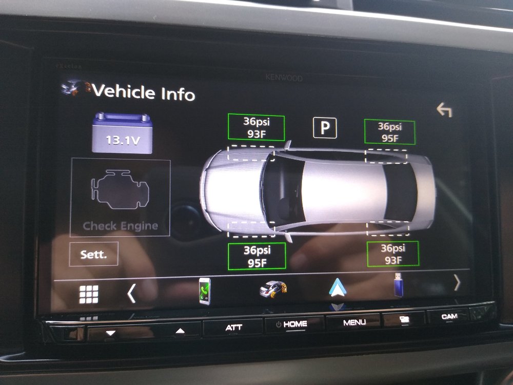

Tested the on screen voltage display with a DMM at the battery and can say it's accurate to .1 volt and updates pretty quickly... It won't read a drop that goes for a split second, but does read drops on bass notes that go for a couple seconds... Good enough for me.

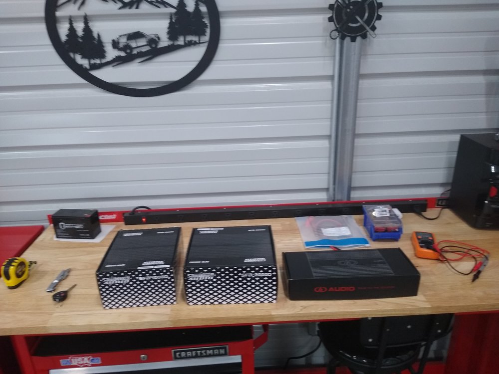

SFB2K is here. Not much bigger than the SFB1K. Which is great, it will still fit under my front passenger seat.
Wish the subs came today as well... But looks like Monday for them. I'll install the subs the day I get them, and run them a bit on the 1K... Then it will probably be another week before I hook up the 2K to them. I got July 14th free... So I'll likely do big 3, run 0 awg, and install the 2K then.

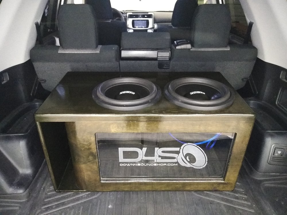

Subs arrived and I got them installed. Sounds great, but I can tell they want more power. Next week they will get it!

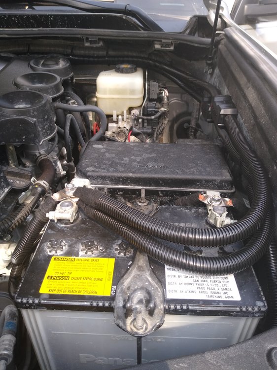

I did the big 3 today and hooked up the 2k. Glad I didn't rush into buying a 3K amp. This hits plenty hard enough for me. Ran 2 runs of power and 2 runs of ground to the amp. All 0awg OFC. Ordered dual input adapters as well.

Also got a local vinyl printing company to print me a vinyl graphic for my box to cover the window... I pick it up on the morning. I love the box, but don't care for the huge D4S logo on it.
