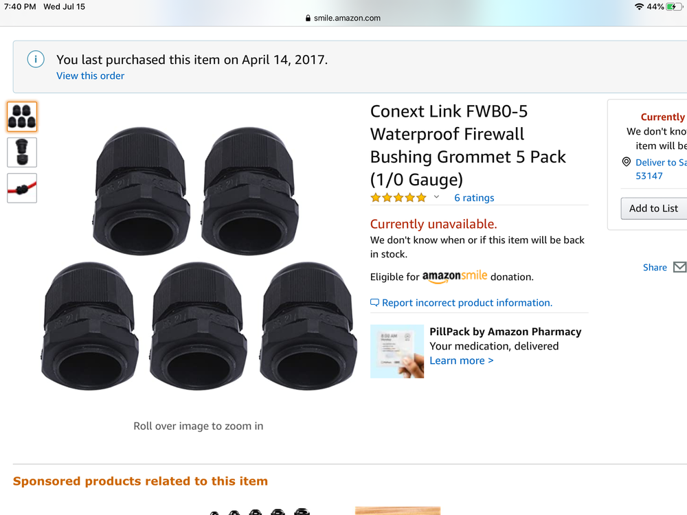

I saw your holes in your firewall , U have the wire wrapped great but I would use these to keep air and water out of your car they adjust to your wire size and are weather proof and are very cheep.
Man Those Would be great!!

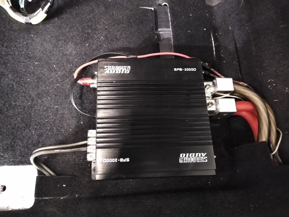

But.... It looks like i would have to pull the wires back out to use them, and i CAUGHT HELL trying to fit all that thick wire hidden neatly going to the amp.
I do offroad quite a bit, in pretty deep mud and some water occasionally, but the top of the engine bay still only gets the occasional splashes, my vehicle is lifted a few inches which helps some... HOPEFULLY i will be OK. Some hot air will enter im sure, but hopefully no water will... If it does i will have to come up with a solution, either re-run the wires of use a spray foam insulation... Which i may go ahead and do before it becomes an issue..
Dual inputs arrived and installed today... Lots of wire running into this tiny amp.

Understandable. For sure. That sounds like a good plan. You are gonna need an amp for your speakers once you upgrade to that sfb3000d.
:guido:
Oh definitely. I actually may end up doing 2 amps for mids/highs. I got 8 speakers so i will need to figure that out.
Whats weird is, before i hooked up my subwoofers and amp, the mids and highs were change out... And, especially the 6x9s, had really good mid bass, but now that the sub/amp is hooked up, even when i turn the amp down completely the mids no longer have that same mid bass sound. Not sure whats going on there. My head unit still has the crossovers set the same.... Unless just connecting the RCA to the subwoofer output on the back of the head unit sends all low freqs to the subwoofer or what. But i dont like that. When my kids are in the car i turn the bass knob all the way off for the subwoofers, and it doesnt sound great without the mid bass i was getting before the subs and amp were installed.
