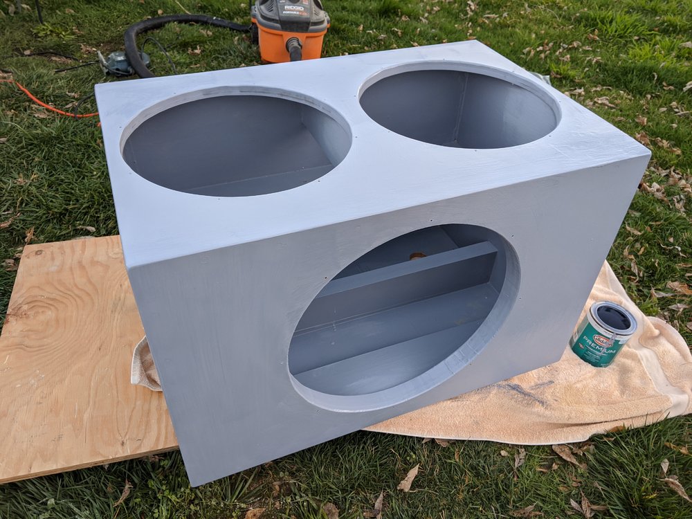

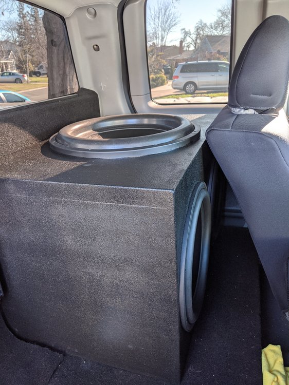

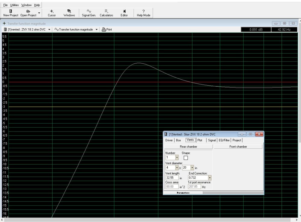

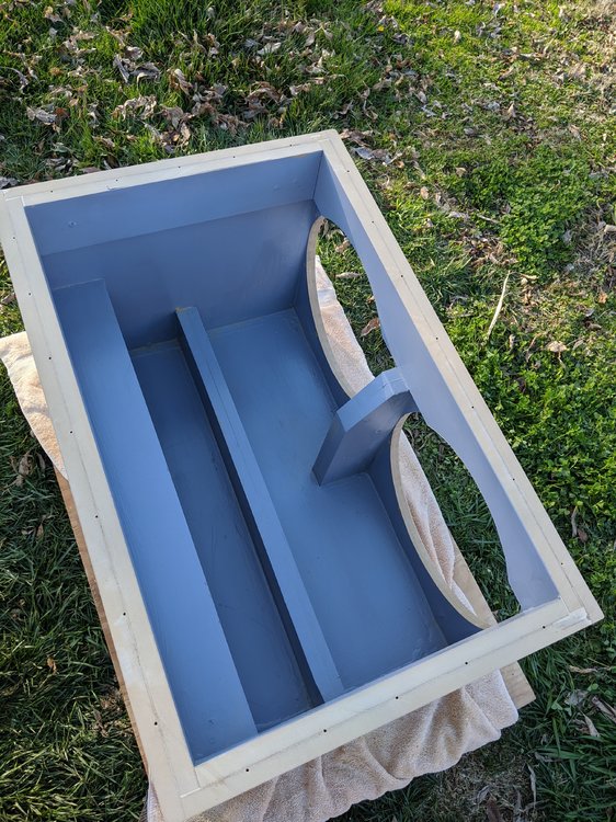

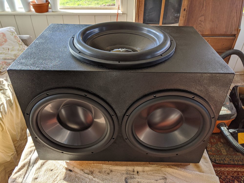

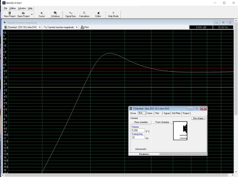

Check back tomorrow, and I'll run that as a regular ported box, and give you a solid design. I've done that before, to compare it to the box I'm running now... And yours will be a about 1 1/2 to 2 dB's louder than mine. Oh, do you lean towards louder, or deeper ?
Super happy with mine though. Best sounding sub woofer setup I've ever built, out of about 30. Those ZVX 18"s are bad ass 🙂
Btw, their is only one subwoofer in this box. Things are not as they appear 😉
Cool. I haven't seen a passive radiator setup in a long time.
First one I've ever built, and the best sounding, deepest digging I've ever created.... out of about 30 :)
So anyway, yea, just put it in 5.25 cubes, and give it a 4 x 20 x 32.5 inch vent, BAM :) Easy Peasy. And that thing will slam too ! You could make it obnoxiously loud, by increasing your tuning up to like 40 or 45 hz (shortening the port) but it would not dig quite as deep, or be very musical. OR, you can go the other direction, and tune it around 30 hz (like I did with my 18" ZVX, and you will lose a couple dB's, but it will dig crazy deep, and sound super musical. Always trade offs. You just have to deiced what matters most to you.
