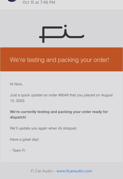

Kocyandia Posted October 16, 2020 Author Report Posted October 16, 2020 I'm in the assembled stage! Waiting on test/pack now. I'm gonna puke!
Backwoods Posted October 16, 2020 Report Posted October 16, 2020 Hell yeah man..... Just got the update that I'm in the test and pack stage... Excited! Singer 250amp Alt, Singer PCM bypass harness Titan8 Lithium Underhood safe BCI PWR-S5 Big 3 W/ dual runs of power/ground. All 1/0awg OFC SounDigital EVO 5K amp, Two 15" Fi SSD subs Next Level Fabrication @ 7 cubes net, tuned to 32HZ
