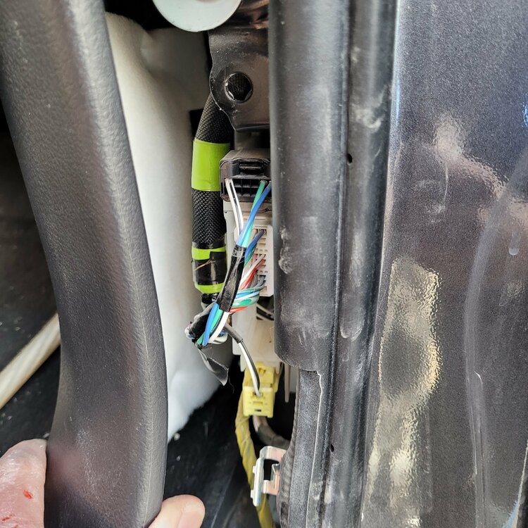

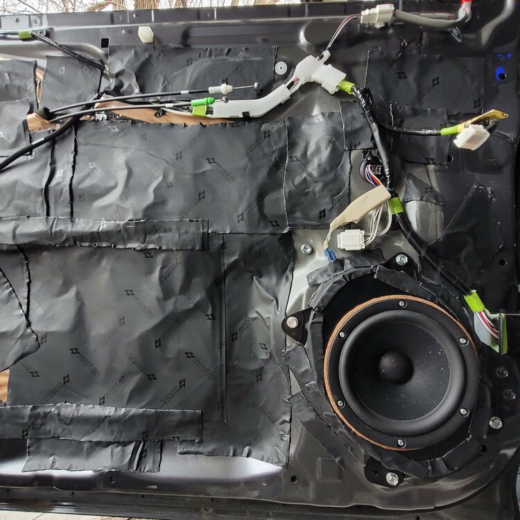

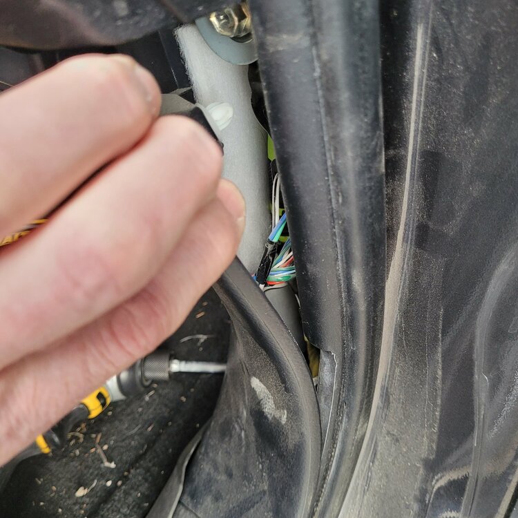

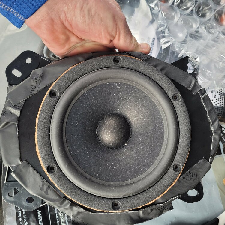

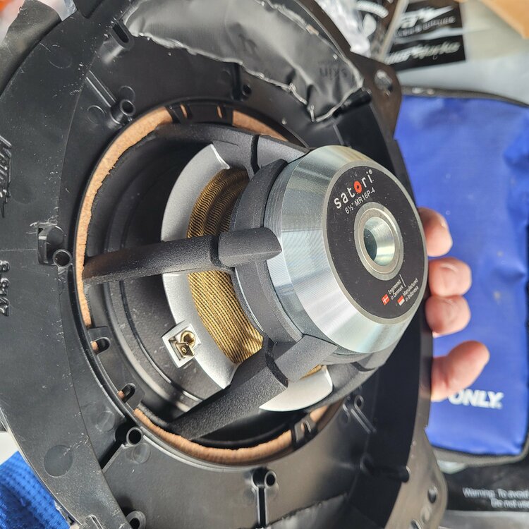

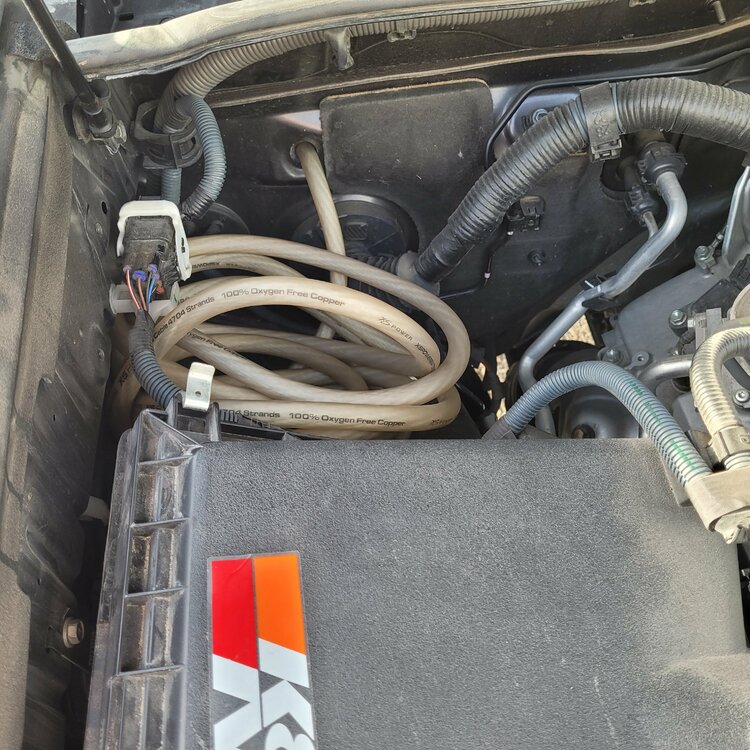

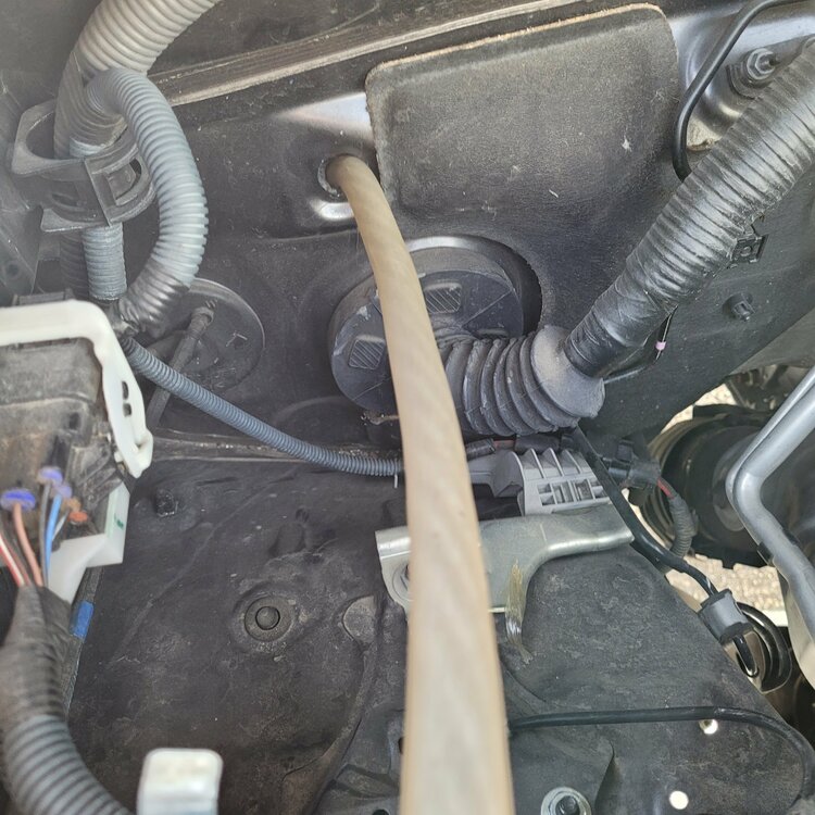

Kyblack76 Posted March 7, 2021 Author Report Posted March 7, 2021 Actually had to work, at work today. Pulled a double. But, got a bit done....where i could I absolutely adore these Satori's. Love em. Doubled on inside the panel, and out. ( dunno why this pic looks potato) Also, found where i can tap into both front doors, with out going through the molex plug. So that is easy peasy. Lime green and blue on pass side. Top, right in top connector. So, i can use those, going through the door hinge. Ill do the same on the driver side. Also, found a hole in the fire wall. Had to open it up a tick with a step bit, and, took a bit of horsing around to fish it down and through. (XS Power flex 1/0, left over in the ring winning rig, that i dig, a lot) Itll chill, until, .... my idea for a second battery (in that same void) comes through. We will see how that works out. Cheers all. SMD SUPER SELLER The Burban Build Blazer Build sold Acura trunk build sold

Dafaseles Posted March 7, 2021 Report Posted March 7, 2021 I'd almost want to reverse mount those Satori's! Beautiful speakers! 2011 Chevy Silverado under construction My build log here. Check it out!
Kyblack76 Posted March 8, 2021 Author Report Posted March 8, 2021 22 hours ago, Dafaseles said: I'd almost want to reverse mount those Satori's! Beautiful speakers! They are wicked cool. Great response, power handling, the whole 9 yards. I cant wait to get the D'Amore boards on em. Maybe tomorrow 😉. Well see. SMD SUPER SELLER The Burban Build Blazer Build sold Acura trunk build sold

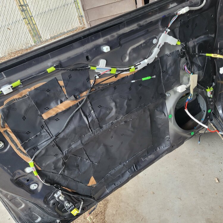

Kyblack76 Posted March 9, 2021 Author Report Posted March 9, 2021 Driver side, in, with all the secons skin damplifer,. Super nice to have windows working, as well as, being able to open the door, from the inside 😀😄 SMD SUPER SELLER The Burban Build Blazer Build sold Acura trunk build sold
