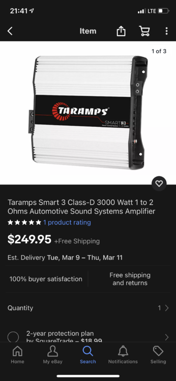

Anthony10111 Posted March 4, 2021 Author Report Posted March 4, 2021 27 minutes ago, JakeW said: Different dealers are gonna have it priced differently, just the same as you’d see other products. Do ALL of the amps come with that monitor? Could that be the reason of the price difference?It not including the monitor? You may not know, and that's okay, I'm just trying to figure it all out
JakeW Posted March 4, 2021 Report Posted March 4, 2021 1 minute ago, Anthony10111 said: Do ALL of the amps come with that monitor? Could that be the reason of the price difference?It not including the monitor? You may not know, and that's okay, I'm just trying to figure it all out All smart 3s do yes. You’re over thinking the price. A smart 3 shouldn’t be any more than 305ish. Search eBay. Look for brand new, probably 290 shipped ‘16 ram. Net Audio. Taramps. JL. DS18. Fox Acoustics. XS Power. 226.08” of DC Audio blue carbon fiber.
JakeW Posted March 4, 2021 Report Posted March 4, 2021 Ships from California! Seller has a 97% rating. ‘16 ram. Net Audio. Taramps. JL. DS18. Fox Acoustics. XS Power. 226.08” of DC Audio blue carbon fiber.
