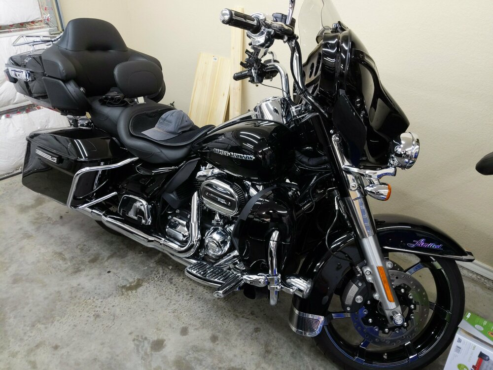

2018 Harley Davidson Ultra Custom Stereo Build
This was the last bike I've owned.  I was really happy with how the whole bike came out, but I was especially happy with how the stereo system build came out.  I sold this bike in late 2019 as the startup I was working for folded up almost over-night and putting some money back in the bank became a priority, then the Zombie Apocalypses hit and and saving / having a nice cushion kind of stayed the priority.  I really wanted to buy another bike this spring/summer but (again because of the Zombie Apocalypses) bike prices/availability are just stupid.  Maybe next year things will have leveled out some 🤞
Anyway, I spent a while day-dreaming up the build and this is what I ended up going with:

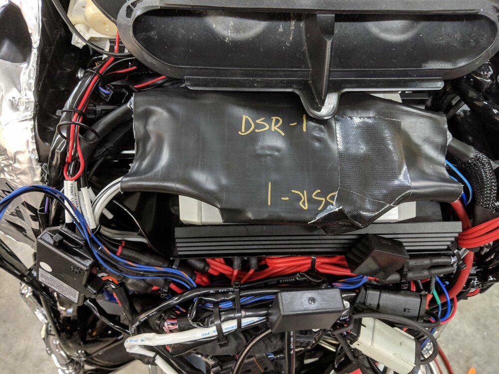

  • Rockford Fosgate DSR1.  I did a little EQ work with it, but it was mostly so I could easily run the 2-way bat-wing faring speakers active with the 6.5s setup with a bandpass filter and high-pass for the tweeters.

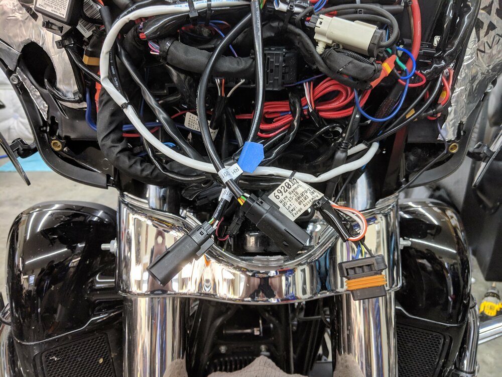

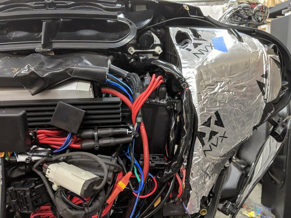

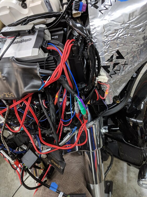

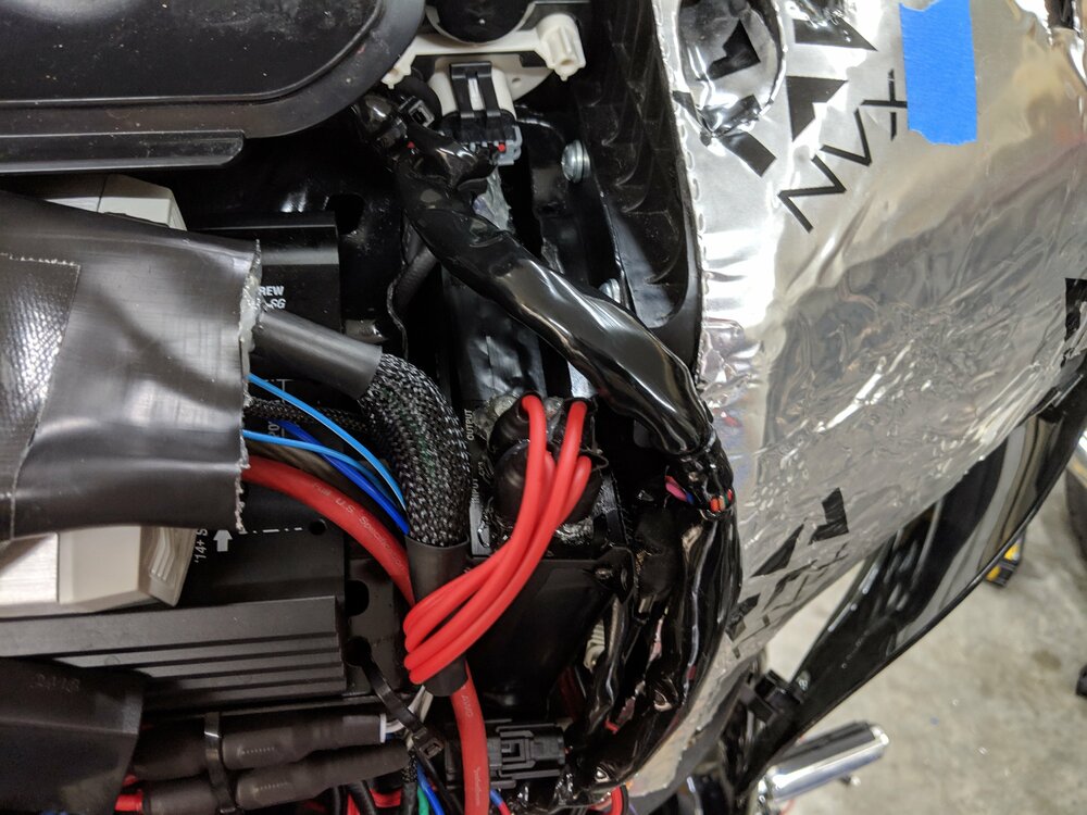

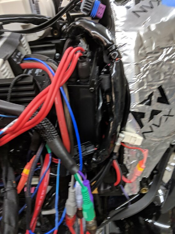

You can just BARELY make out the 4 gauge B+ line in the lower right of this picture.  Both the B+ and the ground runs went from the battery up to a distro block under the fairing:

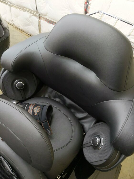

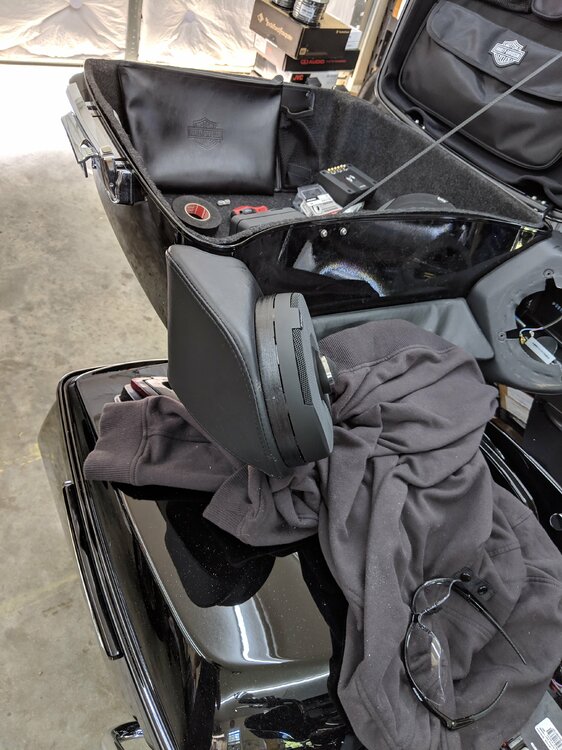

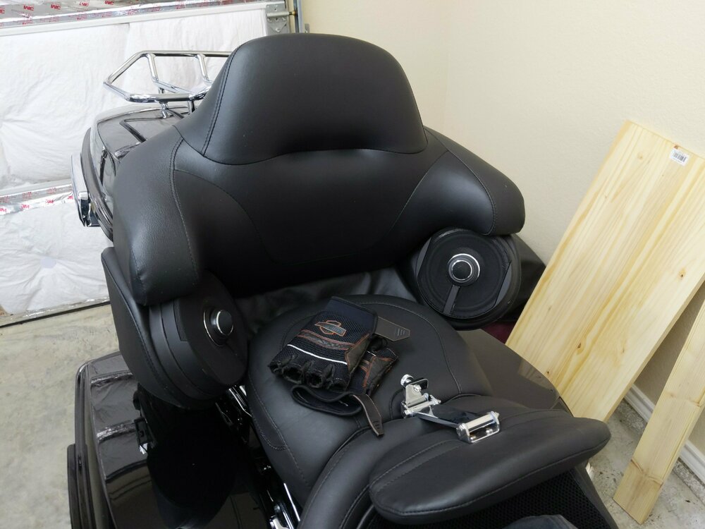

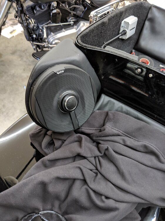

Here are a few shots of installing the detachable trunk amps/crossovers/speakers:
You can see the spacers I had to fab up to get the depth I needed for the trunk speakers.  I routed them out of expanded PVC:

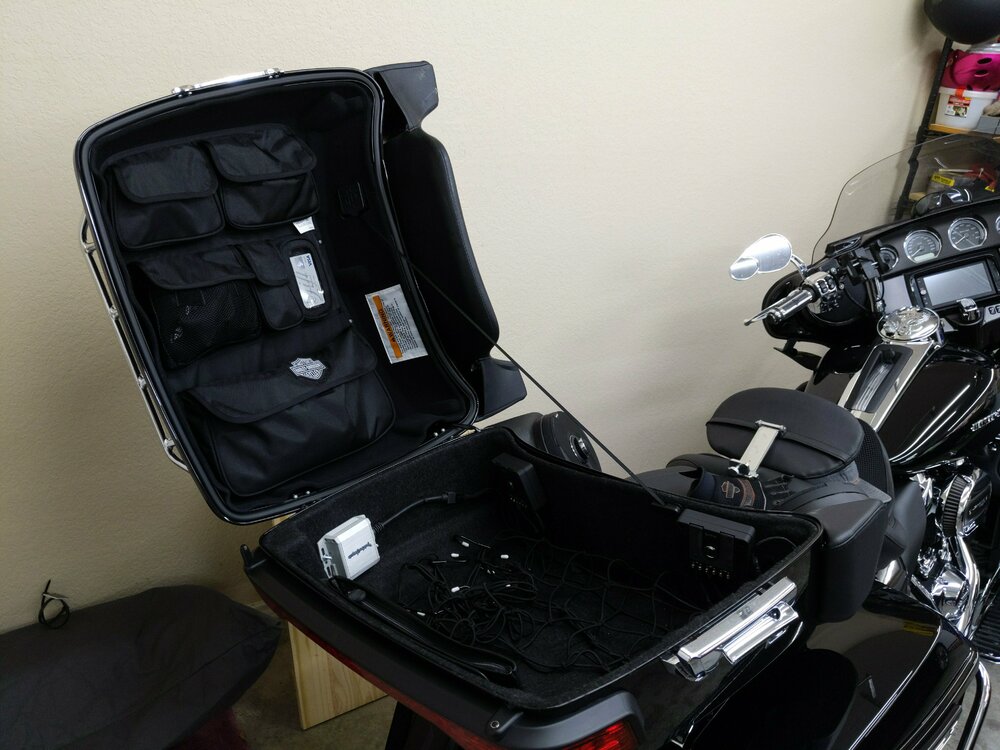

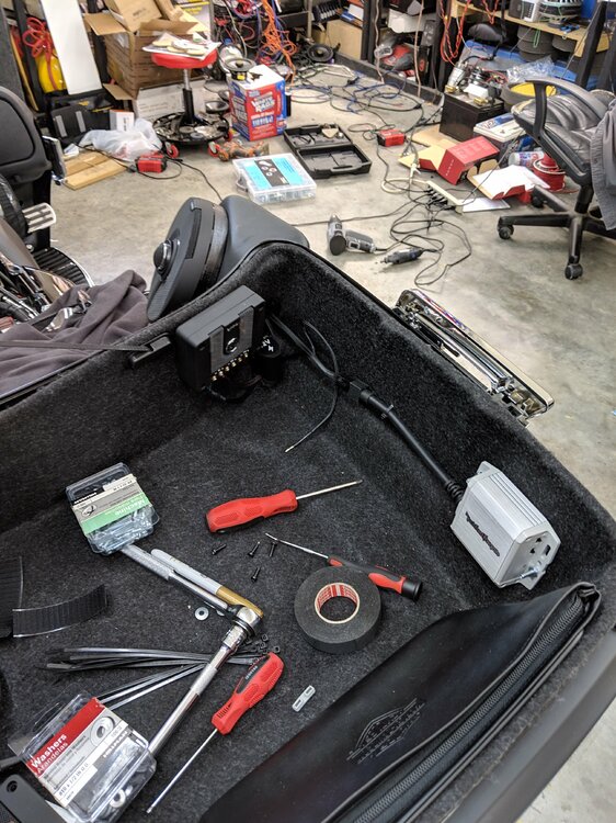

Here's what the trunk looked like once it was done:
I never had an issue with the passive Rockford amps overheating and there was a very significant difference between just HU rear channel output and with these hooked up.  I will say, they are picky about their ground.  I ended up having to run a 12-gauge (1 wire for both amps) run straight to the ground post of the battery to clean up the sound.

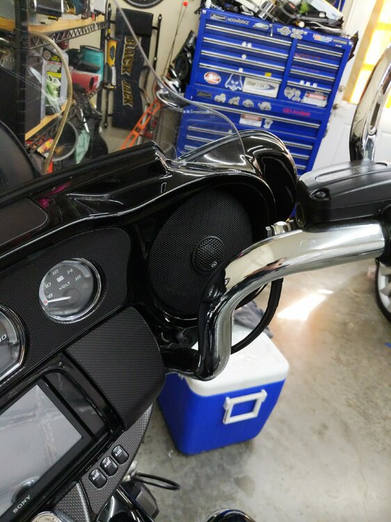

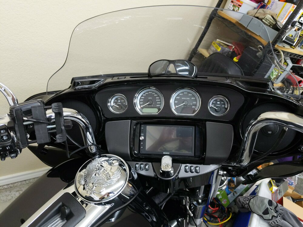

Here are a couple of shots of how the Sony HU went in along with the grills I fabricated.  I dremeled out the tweeter mounting holes out of the metal grills and then routed the tweeter leads down the inside of the grill straight down wrapped in thin black closed cell foam.  In direct sunlight if you were looking for it you could tell the wires were there, but somebody that didn't build or spend a lot of time with the bike would likely not notice.  Luckily, the way the grills are mounted on these bikes are actually decoupled from the speakers leaving enough room to not worry about about the tweeter wiring interfering with the woofer surrounds:

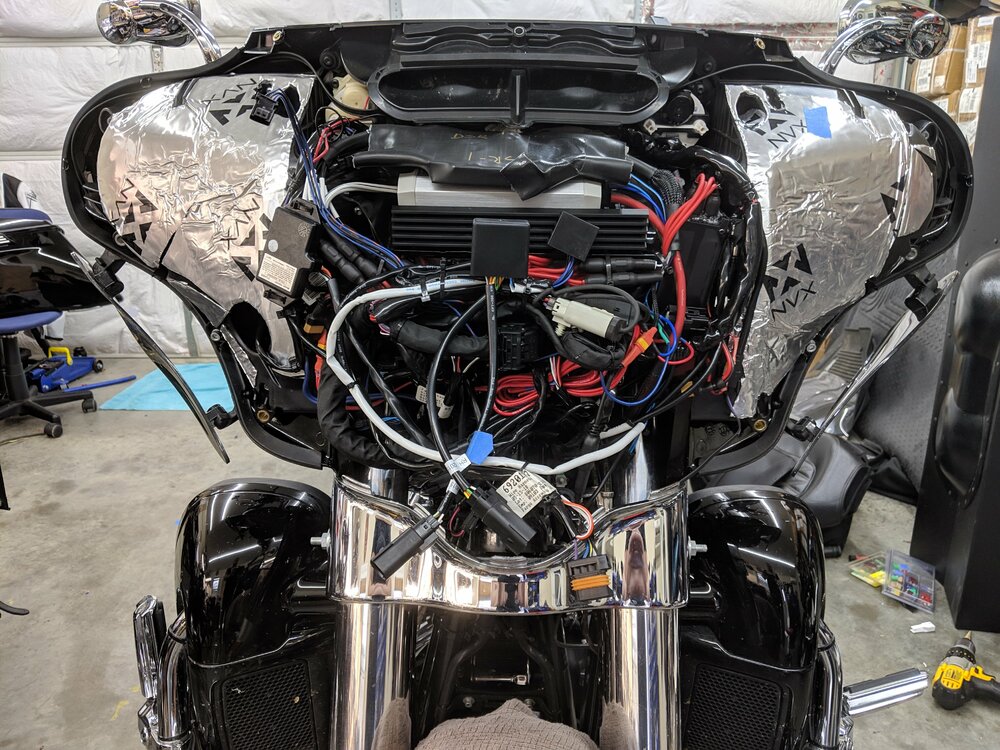

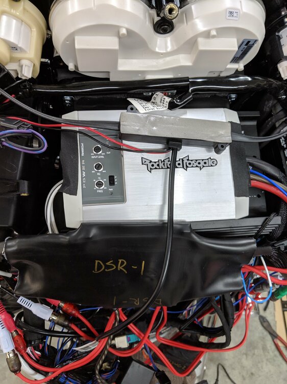

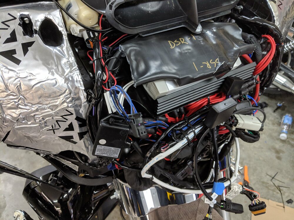

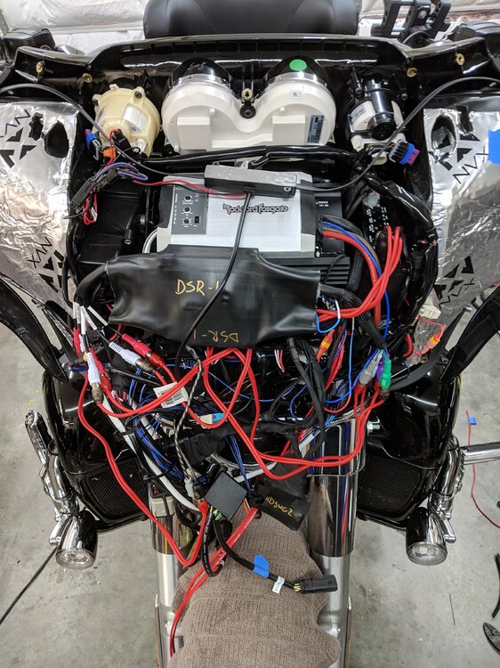

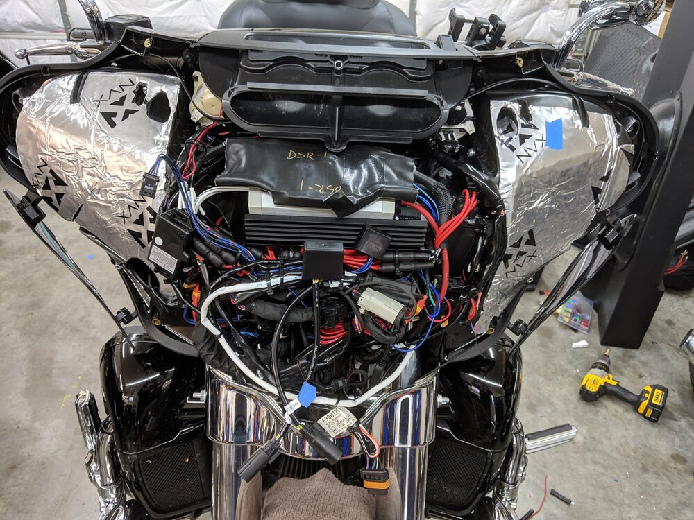

And here are the shots of all that equipment crammed into the nose of the bike:
Here's starting to button it up making sure all the RCA interconnects are sealed with heat shrink and packing possible trouble spots with hot glue:

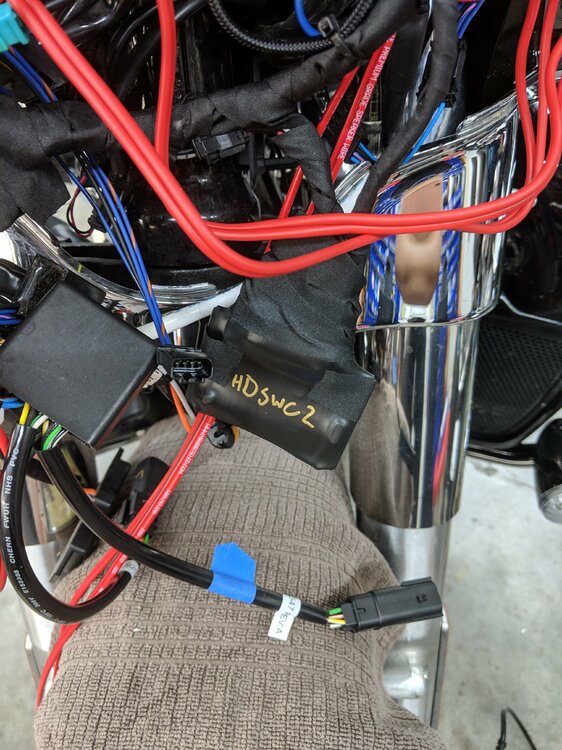

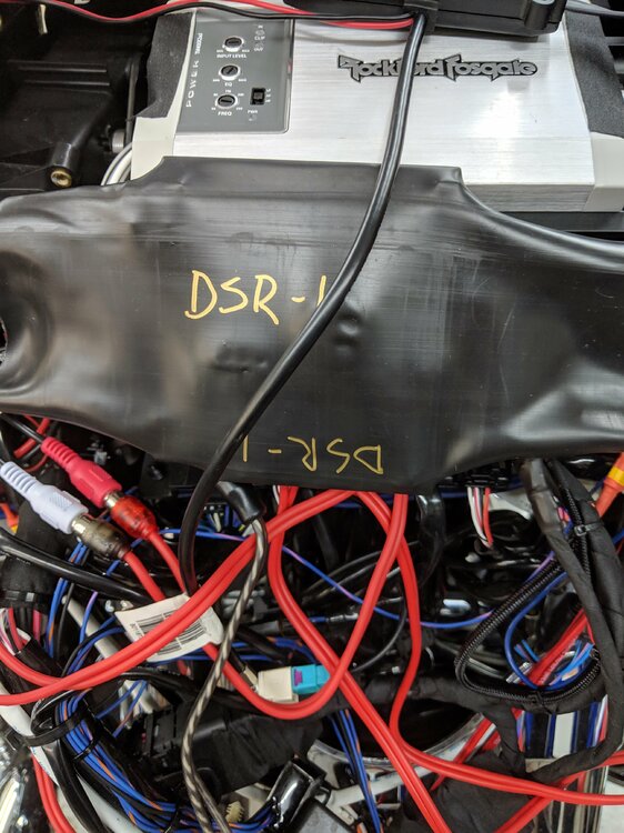

Oh, and I somehow forgot to mention - for the DSR-1 and the handlebar control module, I had to loose their ABS housings and enclosed them in some pretty big/gnarly heat-shrink filling either end of the heat shrink ends with hot glue to seal them up.  That was the only way I could get the equipment inside the fairing.  Both modules worked great the entire time I had the bike and as I understand it, the guy who ended up with the bike is still really enjoying it (I didn't pull the system when I sold the bike) 😵

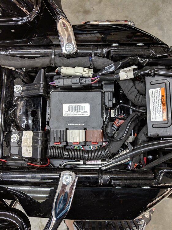

If you decide to trick out your trunk, those RF PM100X1Ks really do work.  I set the whole thing up with an XT30 connector for the ground so it wasn't too hard to pull the trunk off.  Those passive amps take an input from the head unit (which you already have in the trunk on the Ultras), have an output for the speakers and then need a solid ground connection and that's it.
