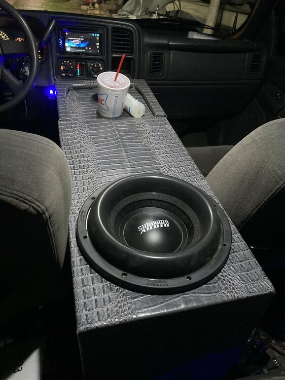

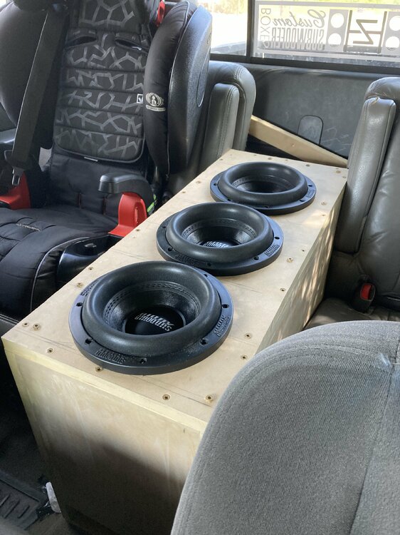

CMcLane816 Posted November 1, 2021 Author Report Posted November 1, 2021 Here are some pics of the setup currently. The phoenix gold amp will be coming out when new subs and amp go in as well as the red 4 ga wire, its just all i had left to use for the time being. The new sub box will basically fill up the majority of that platform. New amp will go on the back wall. Will be fine tuning here until box is done.
