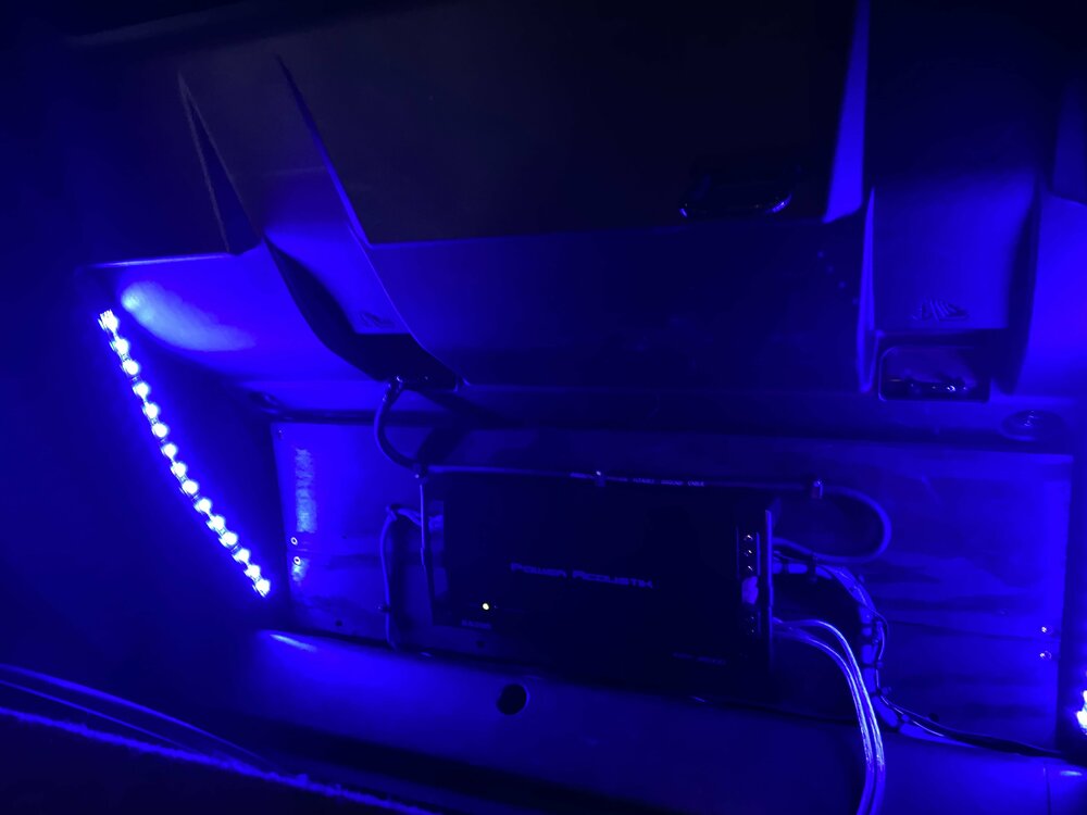

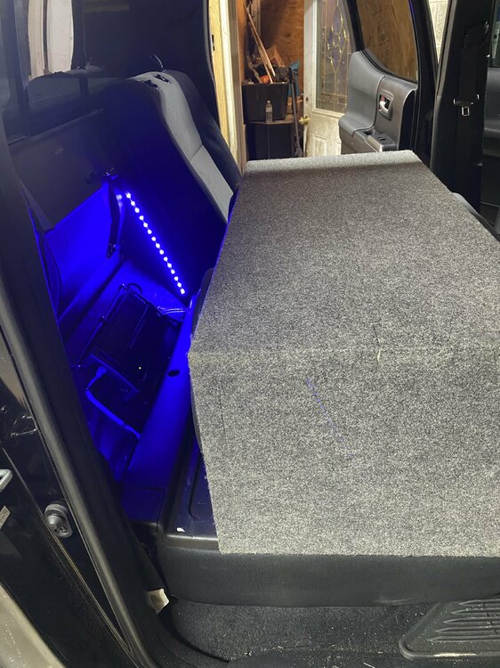

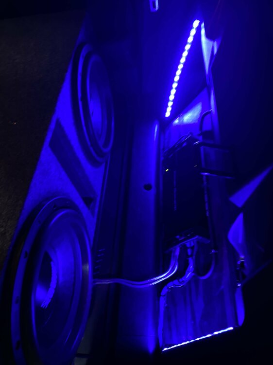

Hello. New user here. Glad to be a part of the group. I need some help with my setup. I recently purchased 2 brand new sundown SA V.2 12s from a sundown dealer. They came in a pre fab vented enclosure. I hooked to subs up. Wired to 1 ohm at the amp. And im not getting the results i expected and have heard in other peoples systems with close to the same setup. Im running a cheap power acoustic razor 2500.1D amp. I know the amp is probably only putting out 500 watts maybe. Its just a cheap amp i had running a kicker 12. The enclosure is 1.5 cubic ft per sub from what i measured and calculated. Thats not accounting for the space the sub takes up. My question is. If i buy a better amp. Thats rated for the rms that the subs need. Will this fix my issue or will i need a bigger box as well. Im getting a lot of punch it seams. A lot of tight kick at the beginning of each bass note if that makes sense. I don't like that. And the only songs that sound decent or hit descent at all are bass boosted songs on youtube. I have bass boost all the way down. Adjusted gain by ear and i have the subsonic filter set at 30hz. And the low pass filter set to play between 35( lowest it goes) to 80hz. Subs are in a 2021 tacoma double cab with stock electrical.  with the subs facing towards the back of the cab. Any input would be appreciated. Thanks!

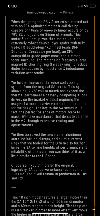

Yea they are 1000 watts rms each. They are the sa v2. Not the classic. Im not sure why they didn’t give them a whole new name because people get them confused all the time. They have a much bigger magnet and motor than the sa classic and more cooling and are built a lot beefier tensils are doubled up. A bunch of upgrades. So i know they will handle a lot more power. I think the sa classic is rated at 750rms. Im wondering how big of an amp i can run on stock electrical because I hooked up my buddies skar rp800. And the lights weren't even dimming. But the issue im running into is i had 2 kicker cvr 12s that hit almost just as hard on the same amp I can barely tell the difference. So i know something is up. Im thinking the amp is just too weak. I watched some dyno videos of the amp and they only had it making barely 500 at 1ohm. So each sub is getting like 250 watts right now Which is wayy too low. Im actually worried about clipping them.
