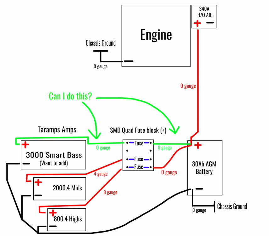

Hey guys. I'm trying to add a Taramps Smart 3K Bass to my system.  Currently, I already have 3 amps in place for bass/mids/highs, I would like to replace the bass amp. At the moment, I'm just not sure what exactly needs to be done to achieve this (another 0 gauge run, another battery, etc.) Am I able to just add another run of 0 gauge for the new bass amp from the battery? (Highlighted in green below)
Current set up:
2006 Dodge Magnum R/T
345A Autotech Alternator (Custom built/painted)
XS D3400R 80Ah AGM Battery
upgraded all power/grounds to 0 gauge
Taramps TS2000.4 for mids
Taramps DS800.4 for highs
Hifonics 1600.1 for bass
Current voltage sitting in high 13s, no significant drops I've noticed.
Feel free to share your opinions.
Thanks!

I personally would add another battery. 2 of those batteries along with that alternator should power those amps well.
As a side note, I think the input size of the power and ground in that amp take 4 awg. So a 4 awg to 1/0 amplifier adapter would probably be a good idea as well.
Just my 2 cents

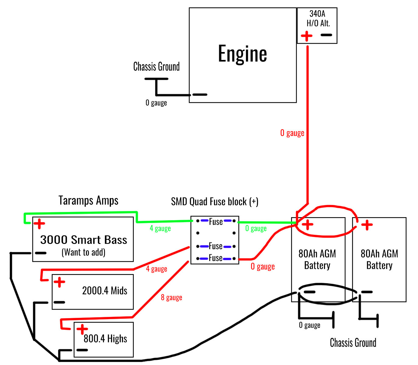

Got it, so something like this?

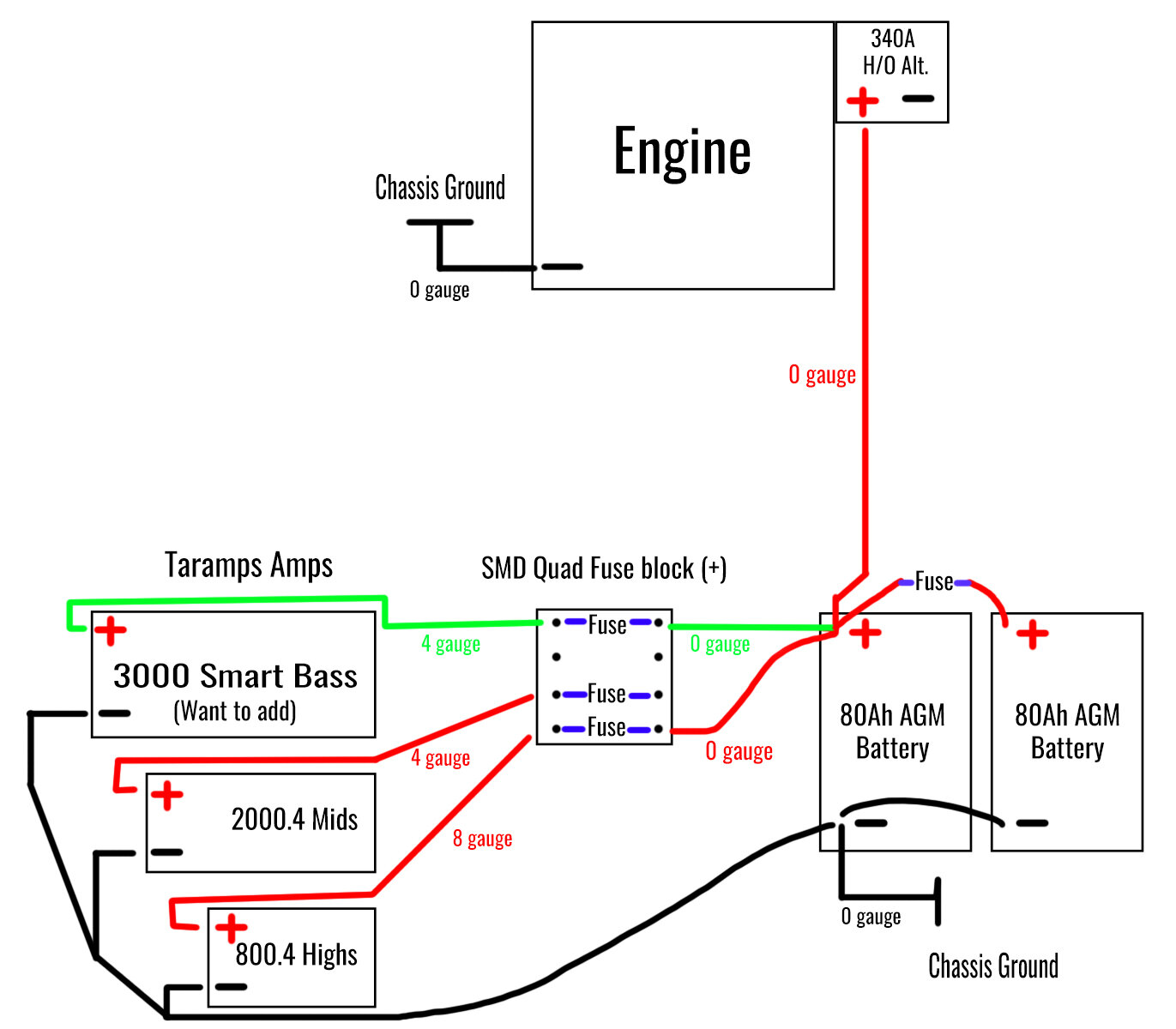

Yeah. That looks good. Though the fuse between the 2 batteries is doing nothing, so you don't really need it. For that to work, you'd need 2 fuse points. But, if you can put the batteries close together, and just get or purchase a bus bar, that would be best. No cables between the batteries to deal with.
Probably not needed, but I'm just speaking how I would do it, I would (if you can't find bus bars or don't want them) do 2 runs of 1/0 between the batteries. If also add another chassis ground for the batteries, and for the engine block. But again, that's just the way I'd do it.
Awesome. Updated image below: I think this is what I'll run for now
