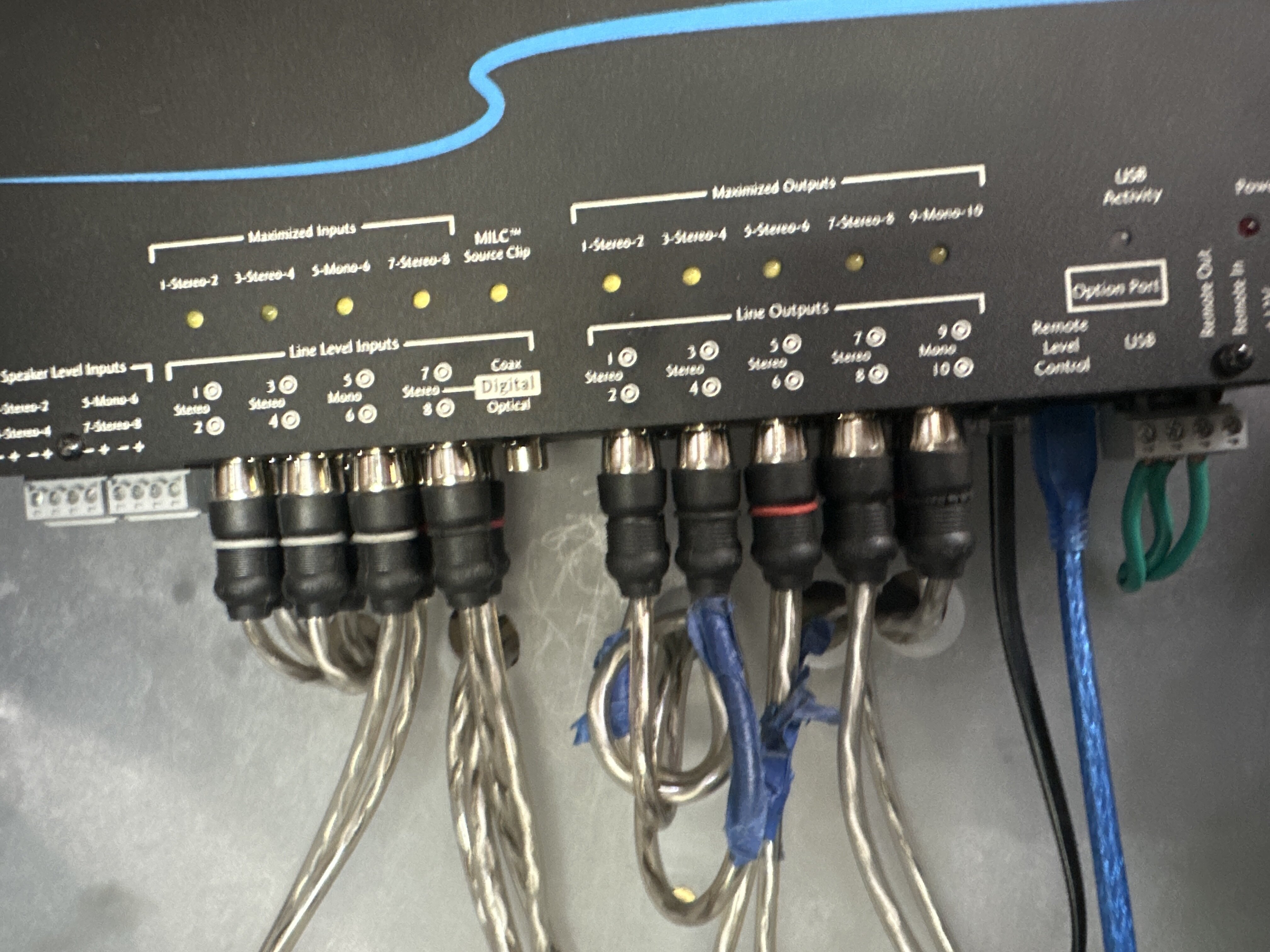

I recently installed a dm810. I have it up and running. However, I do not understand how to set gains. I've watched all the videos, and I still don't understand. I need a "dummbed down" explaination, as to how to set it up. Installed the firmware. I just can't seem to get the clipping indicator to light up. I've had my hu volume all the way up, input/output gains completely maxed, and still no clipping light. What am I doing wrong/or missing? Plz help.

1. What type of input are you using? RCA's? Speaker level inputs?
2. If you aren't clipping the unit, do you know what VAC you are getting into the unit before turning its gain up? Say at max volume if you headunit only outputs 1VAC and the internal gain of the DM810 isnt high enough to hit the output rails and "clip". Just because there is no clip light being shown doesn't inherently mean a fault.
3. If you want real real help, you have to provide some better details than what is in the original post. Its hard to start when we don't even know where the starting line is.

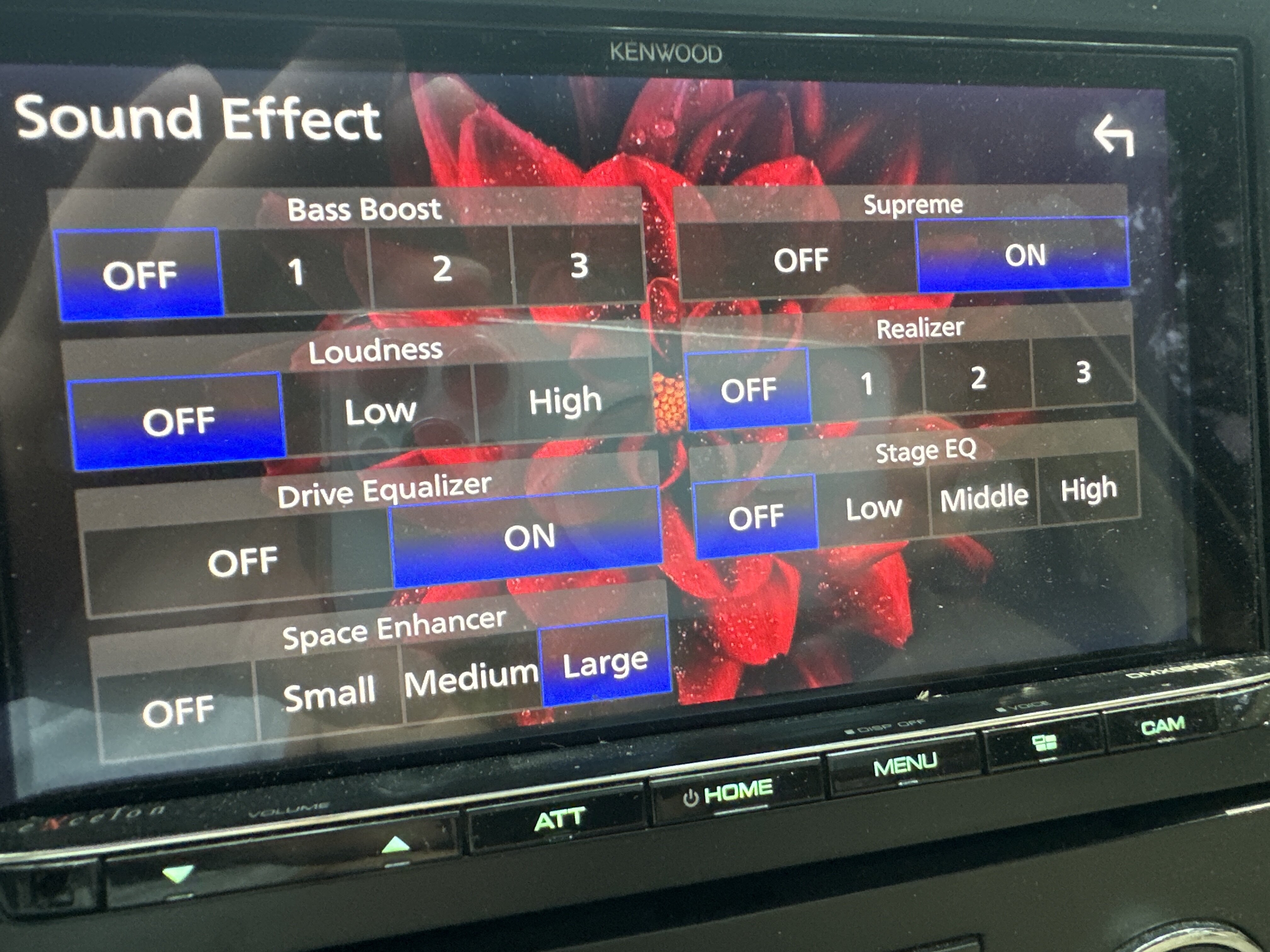

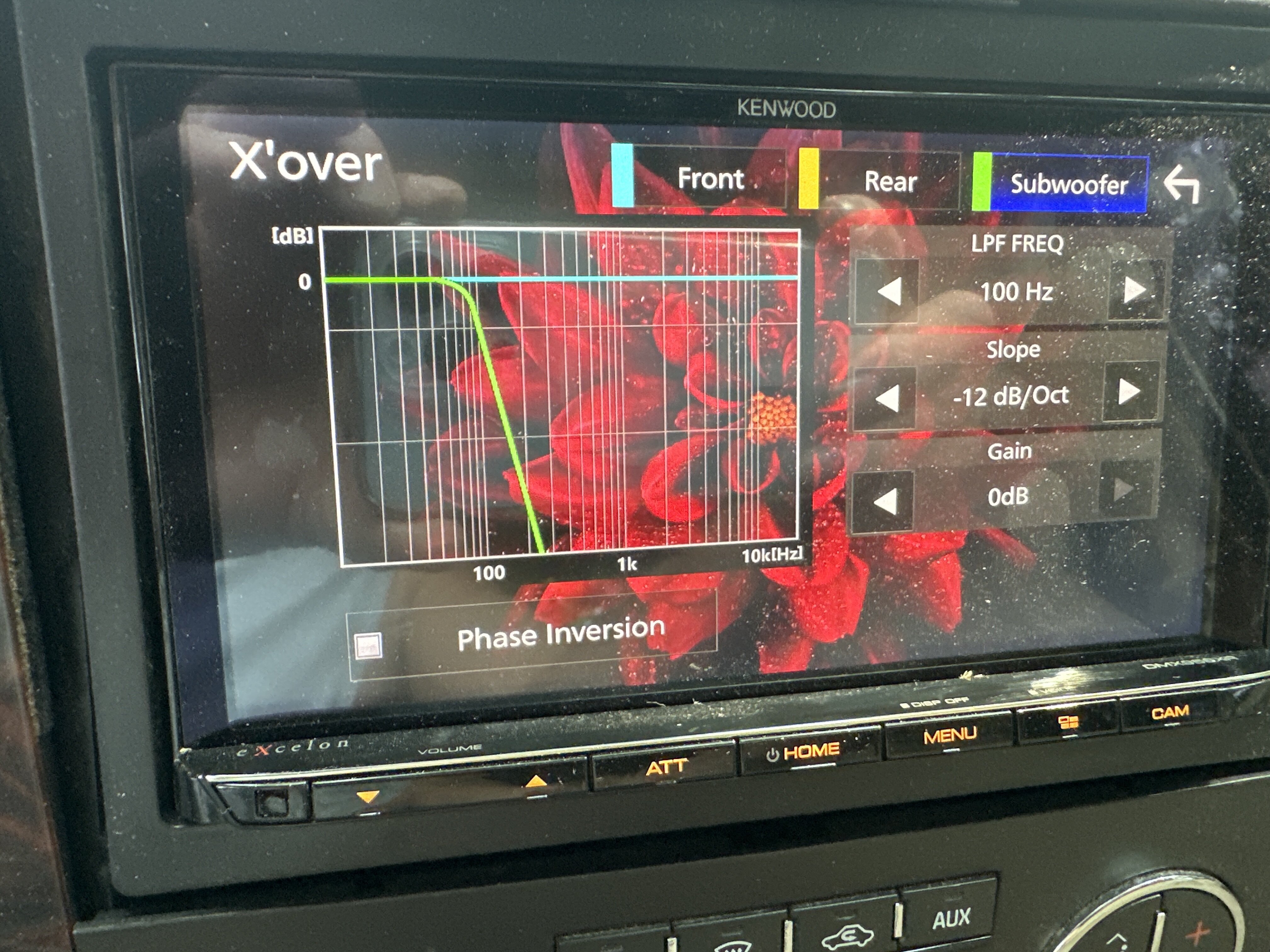

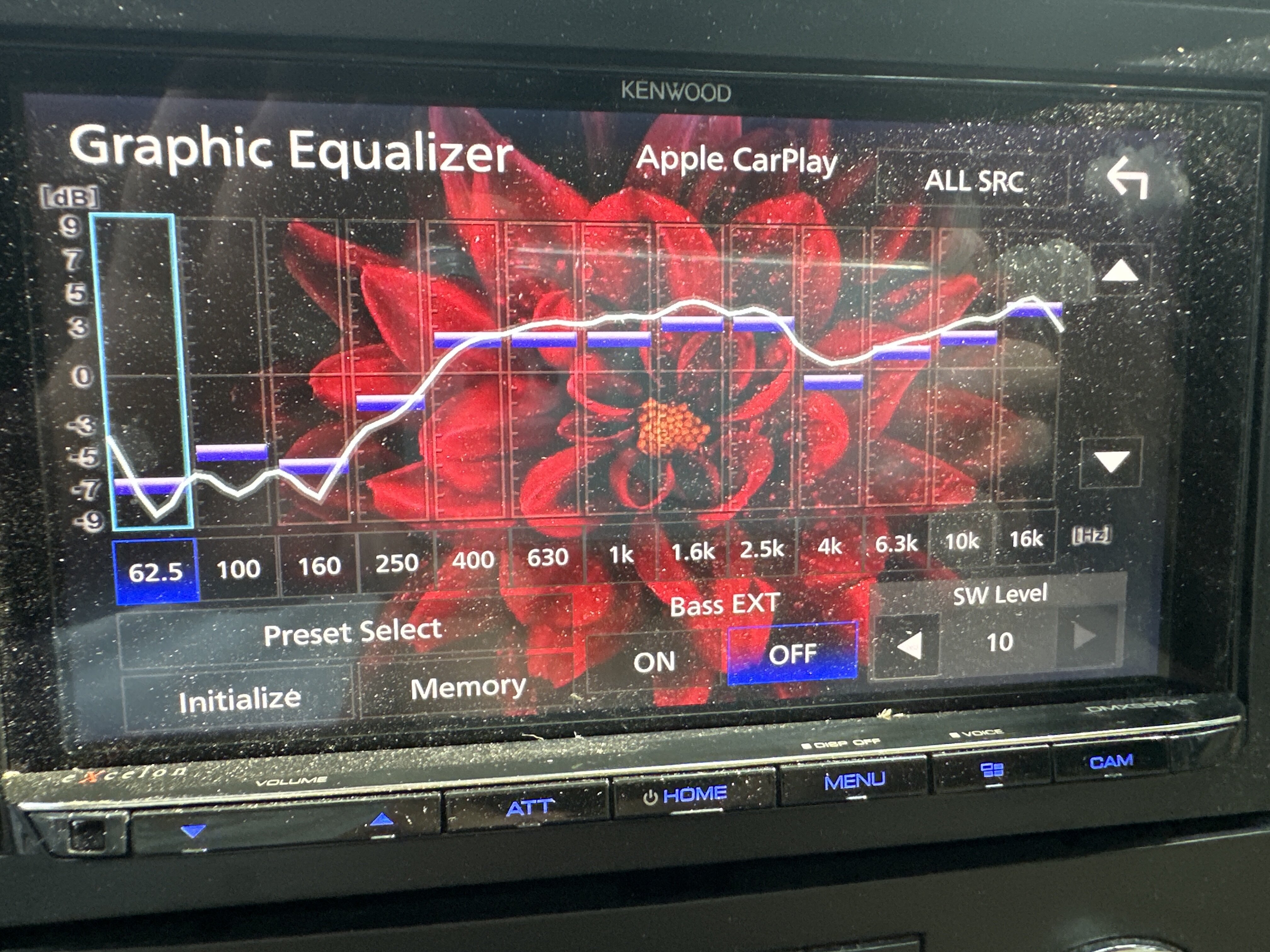

image.thumb.jpg.5c7465c85a0fc9f01ba00c76cfc83223.jpgimage.thumb.jpg.90ad1bab22060a88e96860b886b295f0.jpgimage.thumb.jpg.4f5ba8485b0724cc108b5ff2dc1a0091.jpgMan. I really appreciate your response. Because I really had no idea information like that was vital. As I said, I've never had a processor, and have no idea how they are supposed to be set up. I can provide as much information about the setup, as I possibly can. But some of your response, I don't know what it means. ie, "vac", "1vac". Not sure what that is. However, let's start with the head unit. I have a Kenwood excelon DMX 958XR. Settings on it, not sure what you mean. But EQ settings I have the bass almost all the way down, other than the subwoofer volume, and that is at 10, it's max level. Not even sure if I have the eq on the head unit to the right settings. It sounds decent. But I don't want decent. I want, "correct". Anything else, is factory settings. I am using JL audio RCA's to connect the RCA outputs from the head unit, to the processor. And as far as how I was" trying" to measure the output signal, was the dm smart app. I have the audio control RTA. Have no clue how to use it, so I haven't even gotten that far. The way I understood, was you have to set the setting within the app first, to get, I guess a base line. And then fine tune it with the RTA. The RCA's look messy right now, because I'm still trying to figure out what I'm doing.

Posted (edited)
No idea why you are setting any xover on the HU... you have a dsp. Use the dsp you paid that much money for, to cut, pass band everything. Run the HU open on everything, get in the dsp soft ware, and use the cut offs and slopes.....And turn everything on the head unit to off, and use the dsp you bought.  Why you are adjusting freq bands, on the HU when you have a decent dsp, is..... well, .... odd.   And when you are "looking for clipping" what are you playing? A song? or?  And you have the "bass" on the hu all the way down? Why are you adjusting anything on the HU, if you have a full blown dsp?
EDIT- have you even gotten into the dsp software yet? Why are you using the HU to do the job of that money brick you bought? Lets start there first. Show a pic of the DSP software, not the head unit. (and set the hu all to flat, then, use the dsp you paid for)

As I keep saying, I appreciate your guys' input. To answer your question of why I adjusted anything on the head unit, is because, as I've said before, I have no idea what I'm doing. I don't really know about adjustments I need to make, and where they should be. I set all my frequencies within the processor, to the spec frequencies of each speaker. When I got everything up and running, I noticed that when I adjusted the equalizer on the hu, it got crisper and cleaner. I thought it was odd, that I set my parameters within the DSP, and adjusting the eq, on the hu, made it sound better. Didn't understand it, but left it, because it sounded better. When I first started "trying" to adjust the DSP, I used the pink noise track, provided on the audio control website. Then I moved to actual music. Got a feeling I'm going to have to start all the way over, from the beginning.
