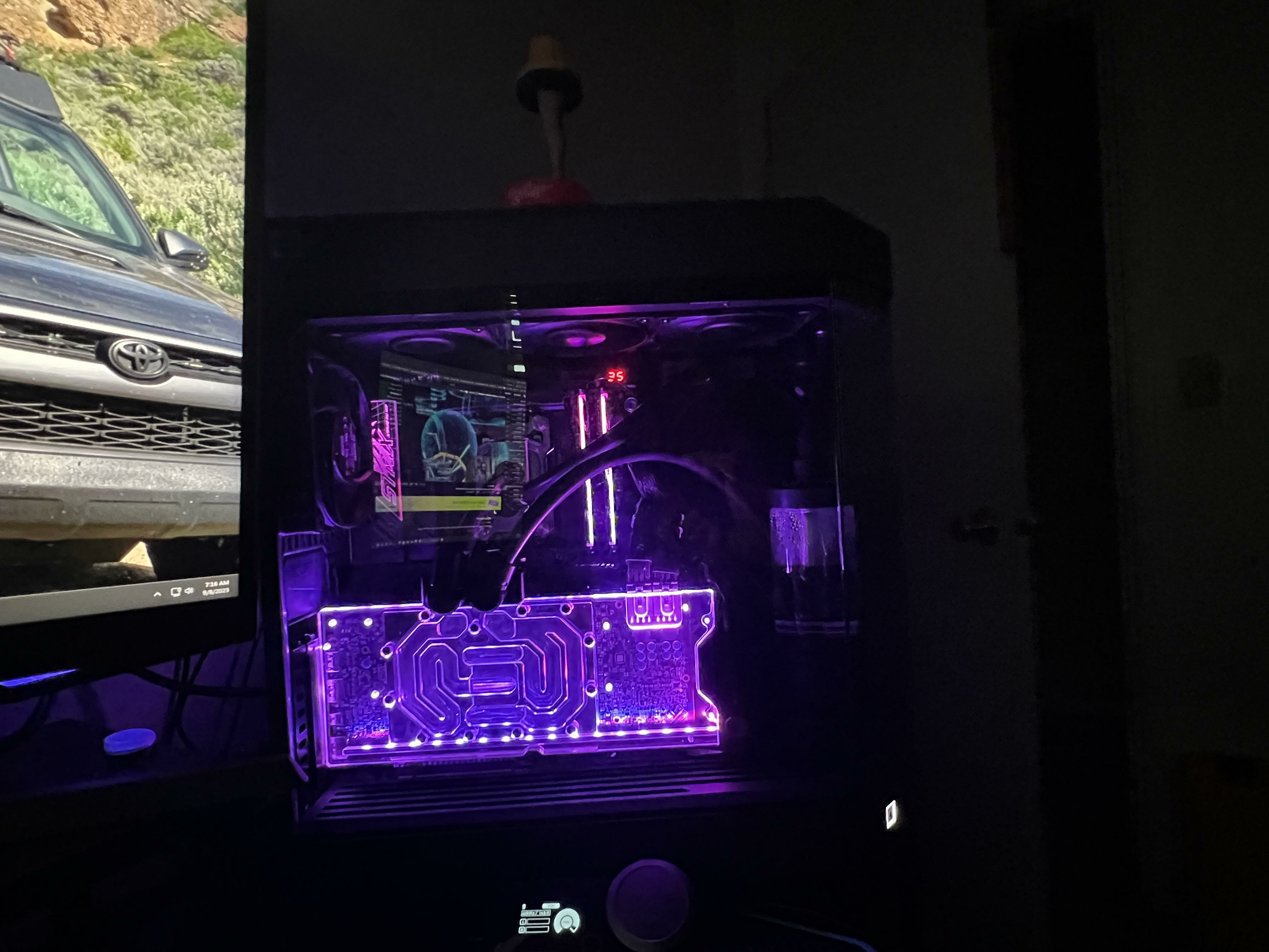

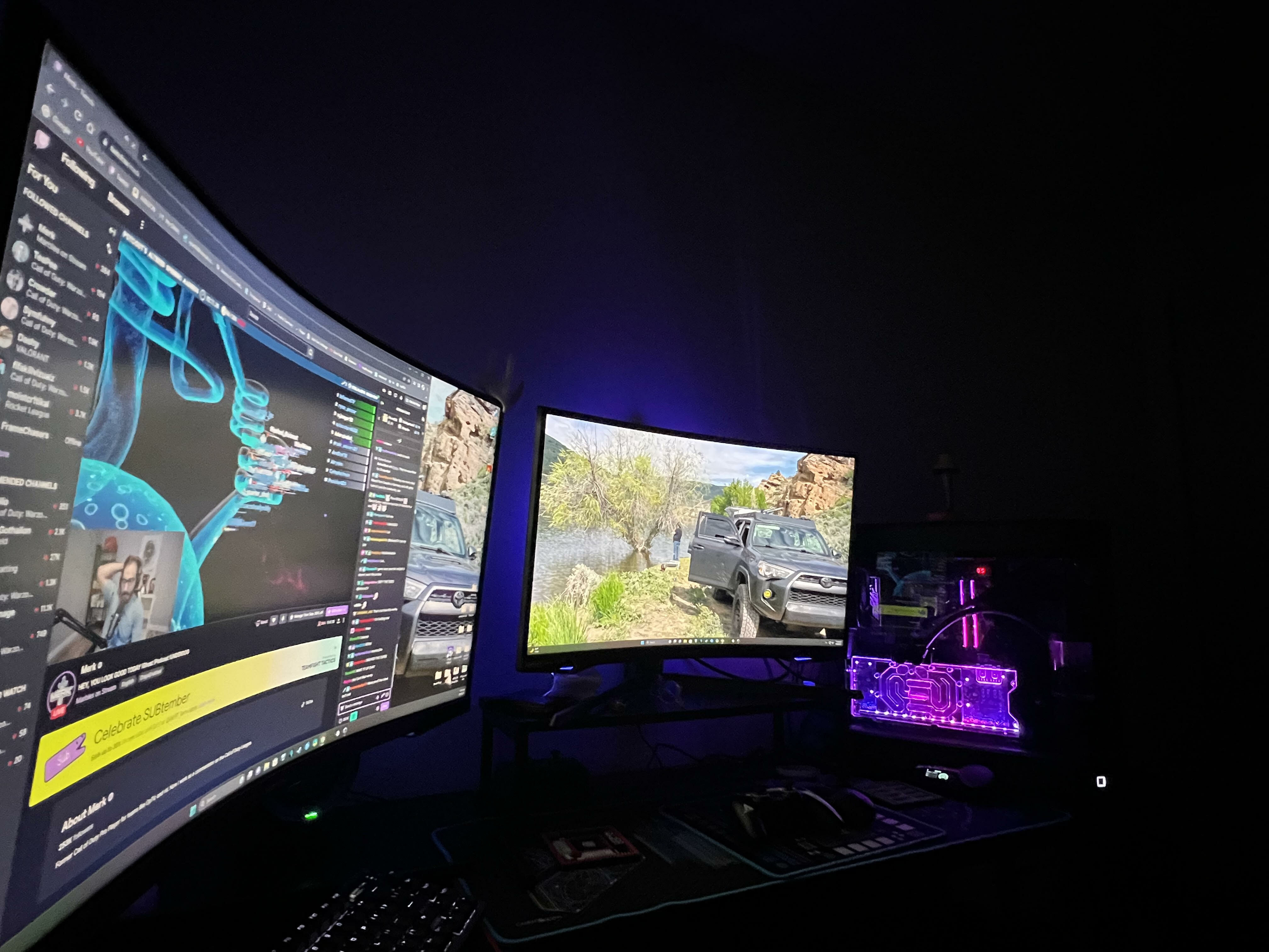

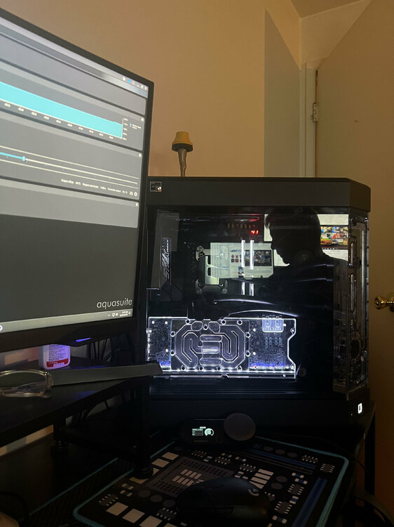

First rip at a full water loop..... be gentle, still learning.
This case blows for air flow, ... add in temps being 3 digits for 6 weeks straight here, and, why not get a pump, cpu and gpu block,.. chuck a rad or 2 in there, and shove some water through things.
Heat killer cpu block, EK gpu block, 360mm rad, 280mm rad, BEquiet silent wing pro fans, aquasuite quadro controller/software ( i dig this thing) , EK d5 pump,res, fittings,tubing.  Just a simple gaming rig, nothing serious.
HyteY60 case/7800x3d/7900xtx/DDR5-6400 CL30/Asus Strix x670e-e/Seasonic 1000 prime titanium
Samsung g7 32" 240hz/Samsung g7 27" 240hz/ROG Azoth keys
First go with a loop,... and, I think ill add a loop to my other rig.  I have a flow sensor, and some other ish, ready to go in, when I get bored enough to stick it all in. Runs like a top.

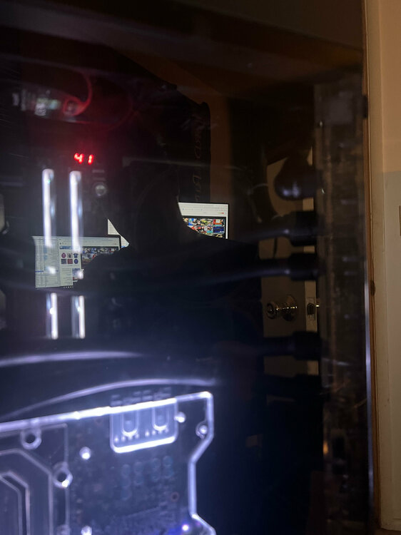

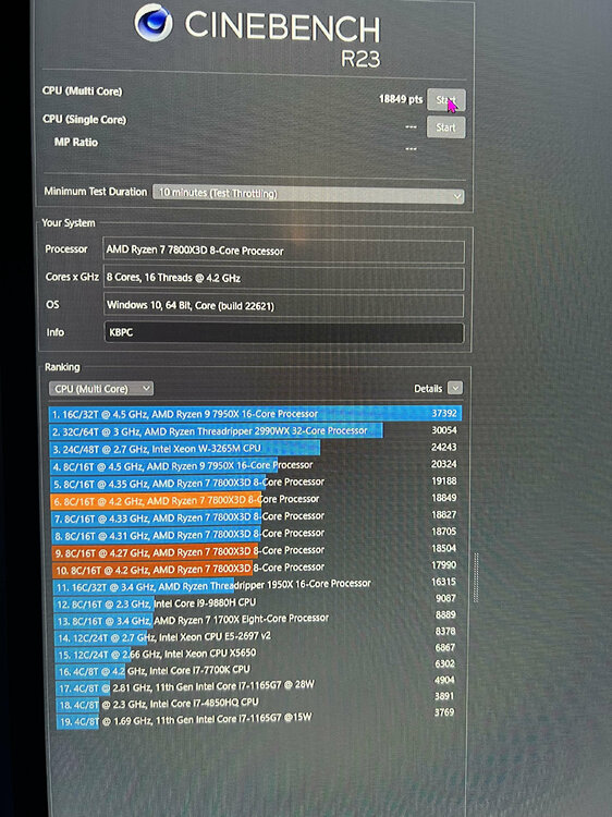

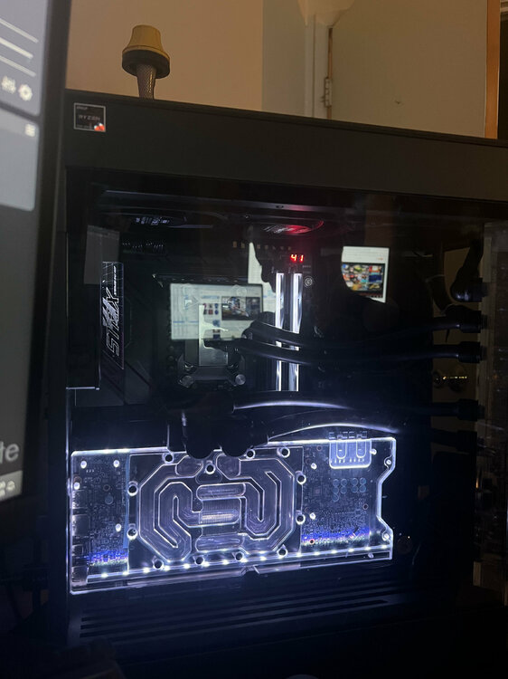

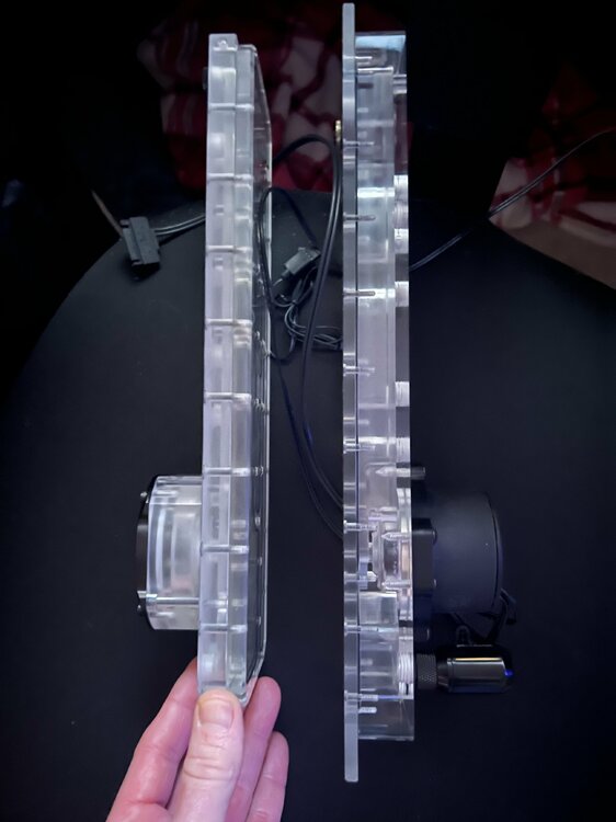

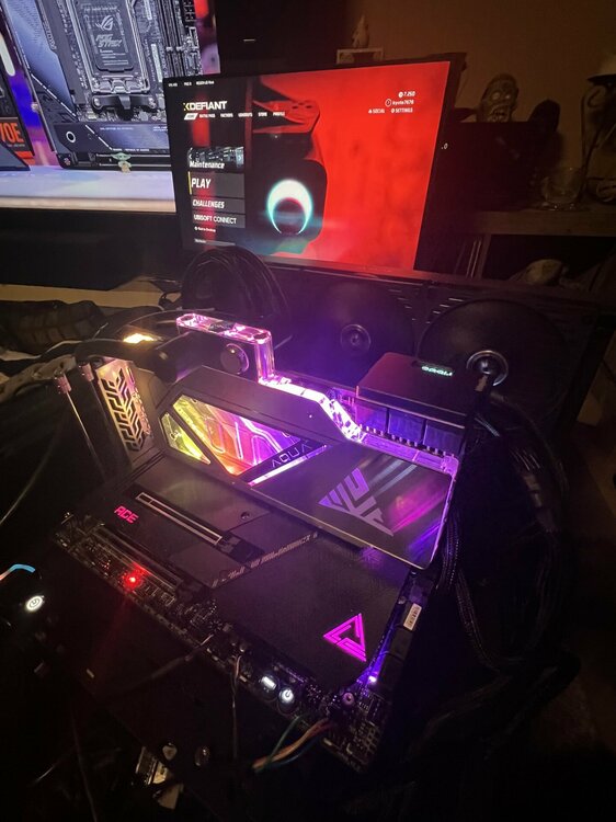

Ditched the EK revisor, and wanted to go manifold/pump combo. I originally bought the HYTE one, from HYTE. Meh,.... speaking to water peeps that know better, i found a guy. He does several manifold/pump combos for certain cases. (also, this hyte case is a turd, dont get it,.. get one from Lian Li or someone else. This case sucks for everything imho) Radikult-custom.  His holds more fluid, looks better, mounts the d5 pump better, and, is just... well better. Went for it, and had it all in,out, and done in a couple hours. Also, i LOVE everything ive gotten from aquacomputer. Using their "hub" and software to control everything from the pumps, fans, and rgb. Great great shit. Temps down further, scores/benchmarks up. Pretty legit and fun to fuck with. Cheers all, and happy gaming.
