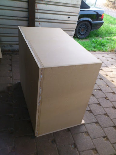

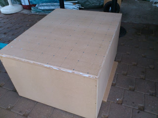

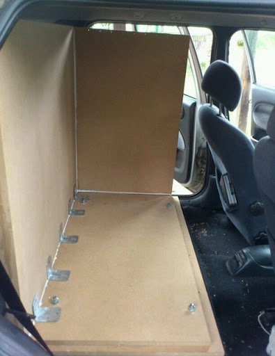

Hi all :)
Here is my build in my new ride ;)
The Pics aren't in the right order sorry ;D
Components:
Headunit: Kenwood KDC-BT8044U
Frontsystem: At the moment original =/
Subwoofer: 2 x DC Level 4 18" with Level 5 coils
Amp: Caliber CA4020D Pro at the moment
Power: Exide Maxxima 900 DC
The Box got 14,5 cubic feet with a 217square inches big Port and a length of 14 inches :)
This Port is my SPL Port. I will build a new smaller Port for show ;)
Bass race brothers - DyXe
Germany

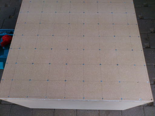

I like how you used a grid to get those screws perfect!
