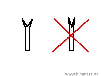

Ok, cool. So you understand my question.
I was cutting 3/8's at work today. Using a jig saw, and a standard bit. Hell, i could barely move without it getting hot, and "gumming up".
Know what i mean?
I dont get how clean your doing it, and AT THAT THICKNESS!!!...
Made a quick drawing of how your jigsaw blade should look like.
This is seen from above, you can se the teeth cutting more on the side on the one at the left.
This means that there will be more space for rest of the blade. Then you have less friction and less heat. :)
Know what i mean?
