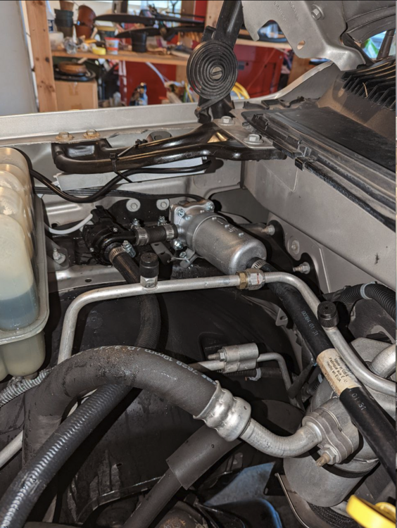

Got that engine heater  wired up. Put a battery charger in there too.
Pretty nice having it in the 20s, but coolant temp is in the 160s before I turn the key. Realistically, the heater should be mounted in a vertical orientation to make it easier to bleed the air out of the system. But the pump is decently powerful, doesn't seem to cause any issue for what it's worth
Parts list if anyone wants to do the same:
Heater: https://www.amazon.com/gp/product/B002UNGL44/
Pump: https://www.amazon.com/gp/product/B00BHKW92Y/ (note that there's a 2kw version if you have 20 amp service)
-- 12v power: https://www.amazon.com/gp/product/B07H23JGS6/
-- Plug: https://www.newark.com/amp-te-connectivity/1-967412-2/receptacle-housing-2pos-black/dp/55W5049
-- Blades: https://www.newark.com/amp-te-connectivity/929938-1/contact-crimp-socket-15-13awg/dp/35M2440
-- Seal: https://www.newark.com/amp-te-connectivity/828904-1/sealing/dp/12P8371
(2) T-fittings: https://www.amazon.com/gp/product/B000COBB52/
'Bout 5ft of bulk 5/8 heater hose
Charger: https://www.amazon.com/NOCO-GEN5X1-Fully-Automatic-Temperature-Compensation/dp/B08G3NVR1N/
