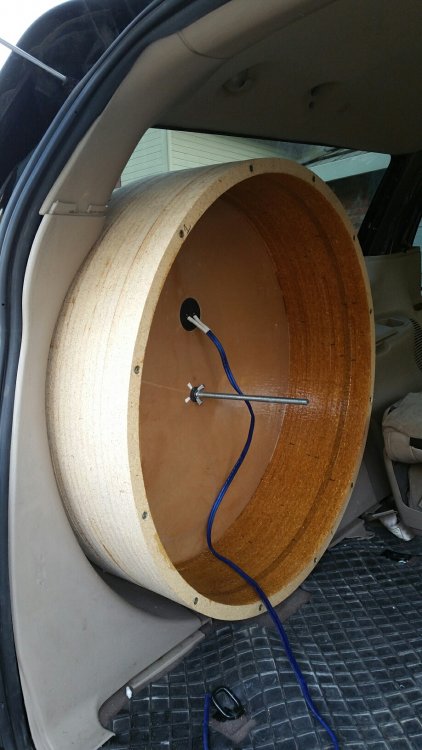

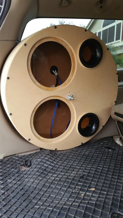

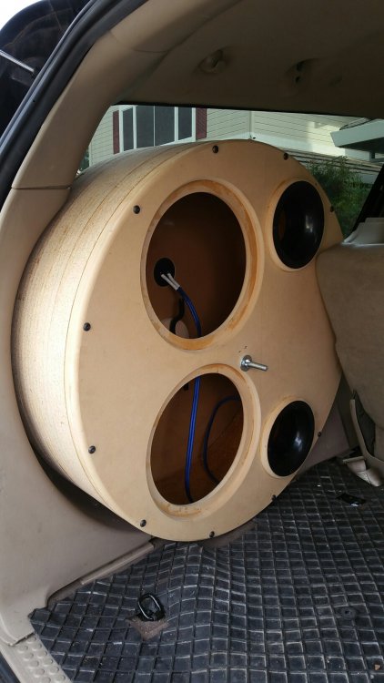

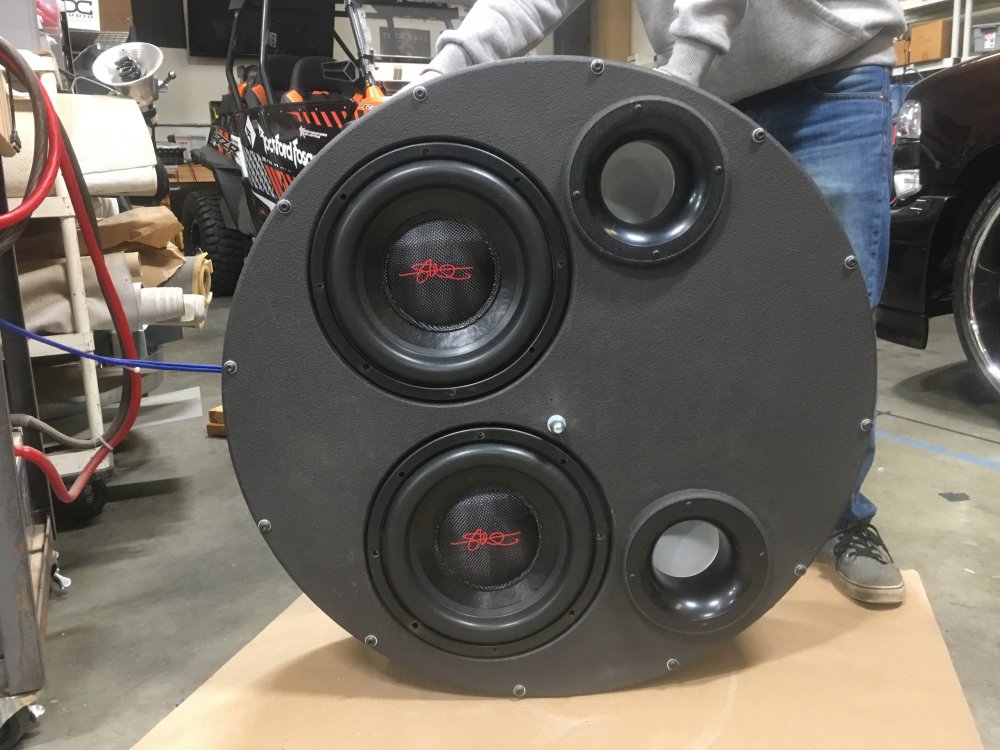

Anyhow, like most people our age, he wants great bass but not take up too much space in the back.  So he decided to build a side mounted spare tire box.  Now before you say "well what about the spare"...know this.  He has a decent sized lift kit (i don't know the exact amount) and some large off road tires.  His off road spare doesn't fit in the stock spot and the stock spare does him no good. So this side mount is perfect!

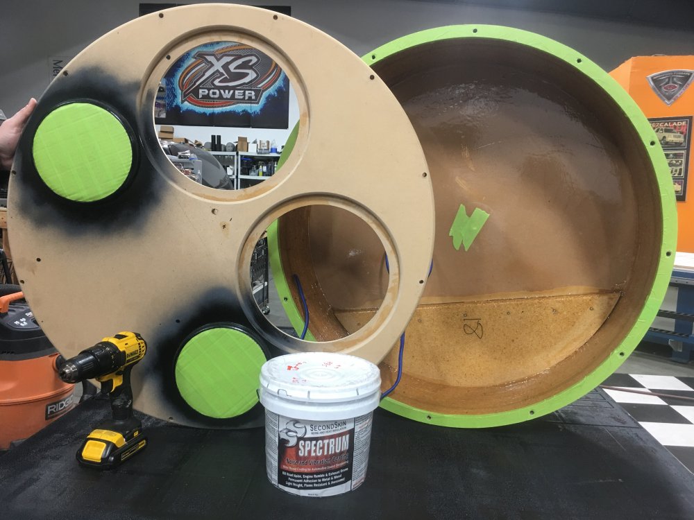

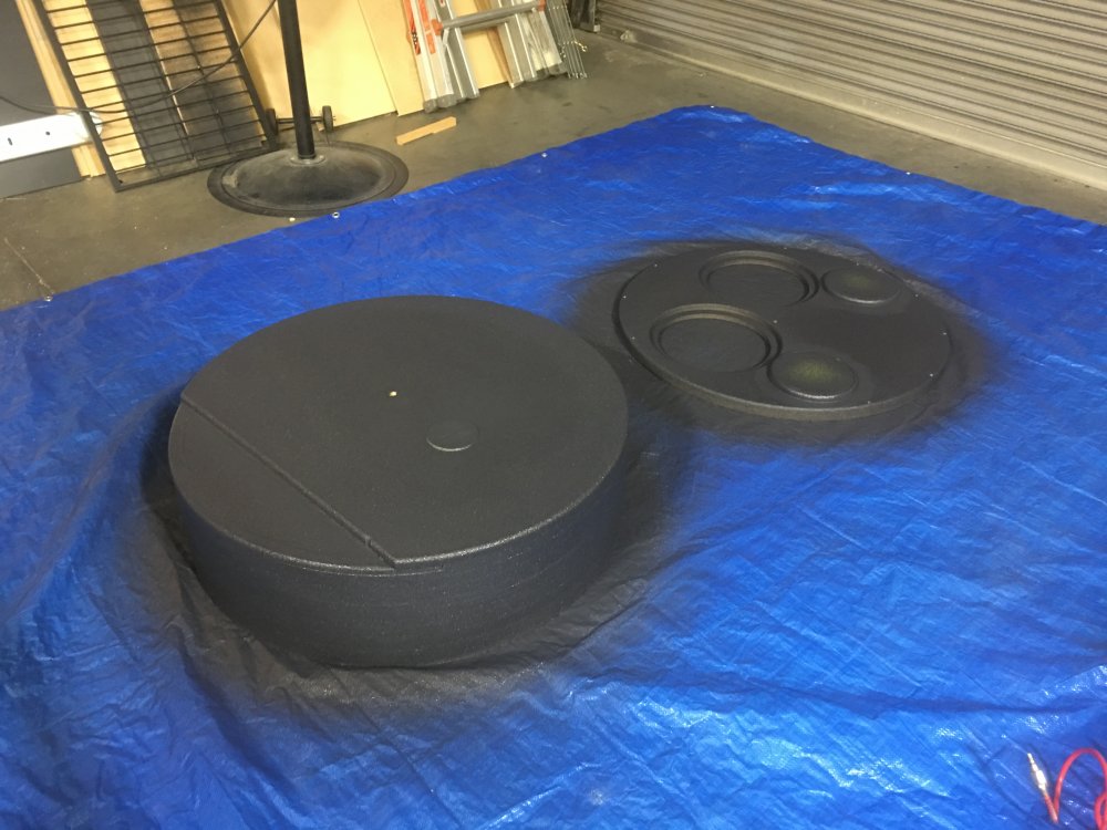

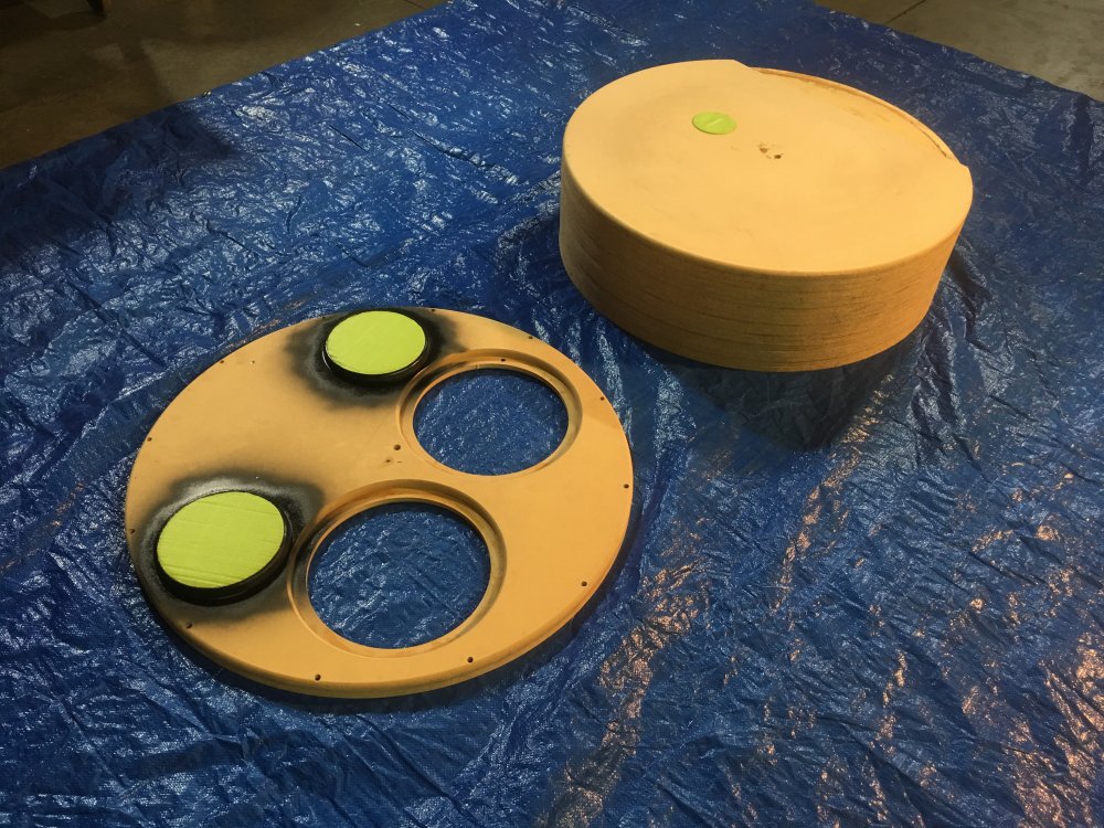

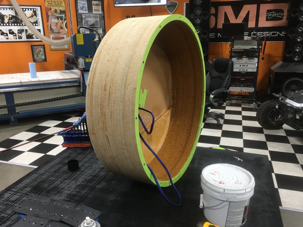

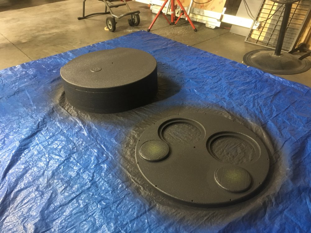

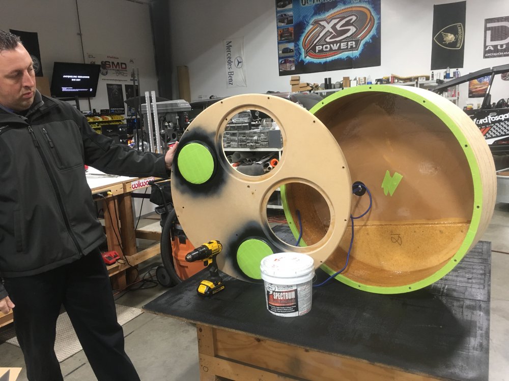

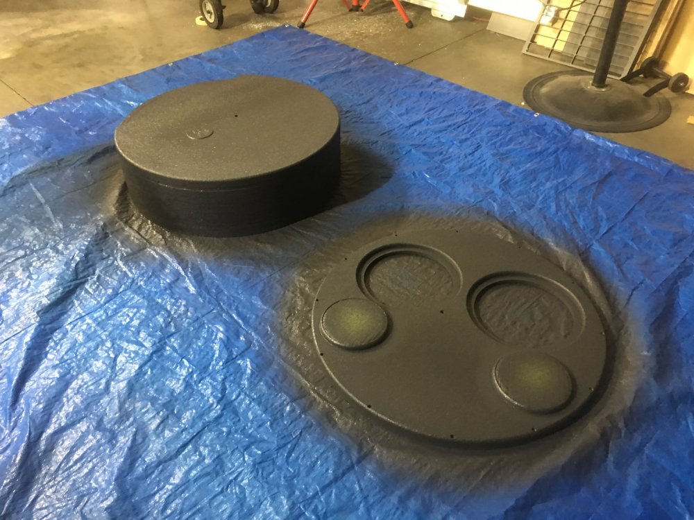

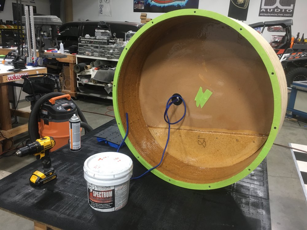

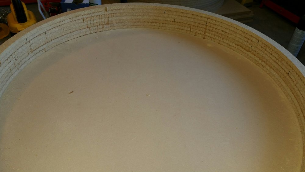

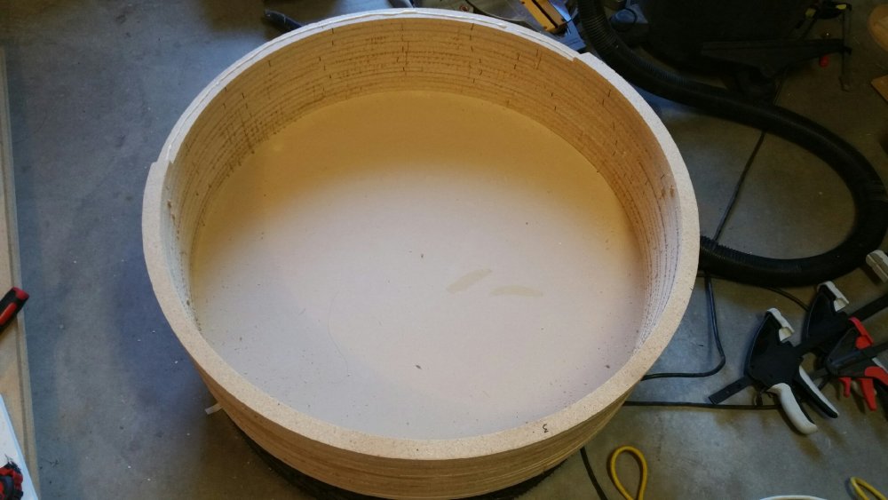

This thing was done in 20 layers.  It was NOT done on a CNC.  It was done with by hand, with a jig saw. I believe he used a router and circle jig for the speaker and port cut-outs. The actual rings that make up the body of the box were cut in half-circles to utilize material much better and not have so much waste.  The rings are made of 1/2" Particle board and then soaked in SMD sunflash to seal the porous wood. The top, bottom and countersunk baffle are 3/4" MDF.  There will be all-thread running through the box for a brace and it will also serve as a mount for the box.

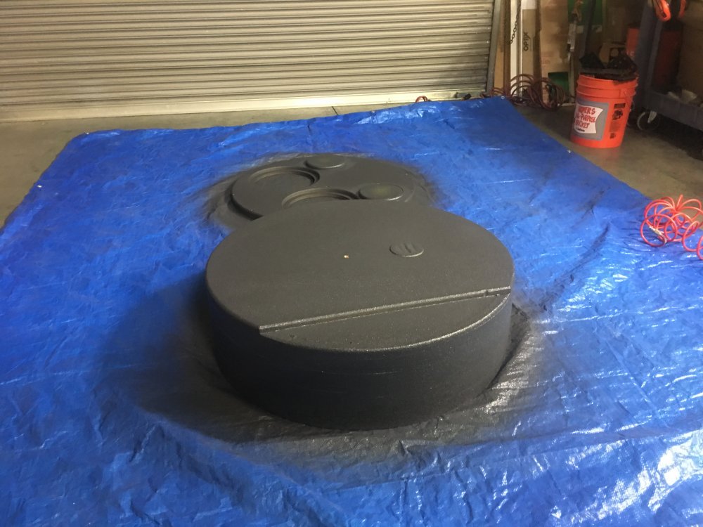

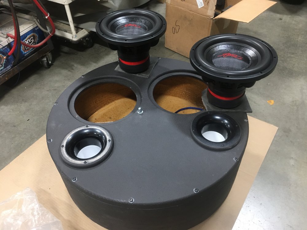

Time to cover it in @Second Skin Spectrum! (video coming later today)

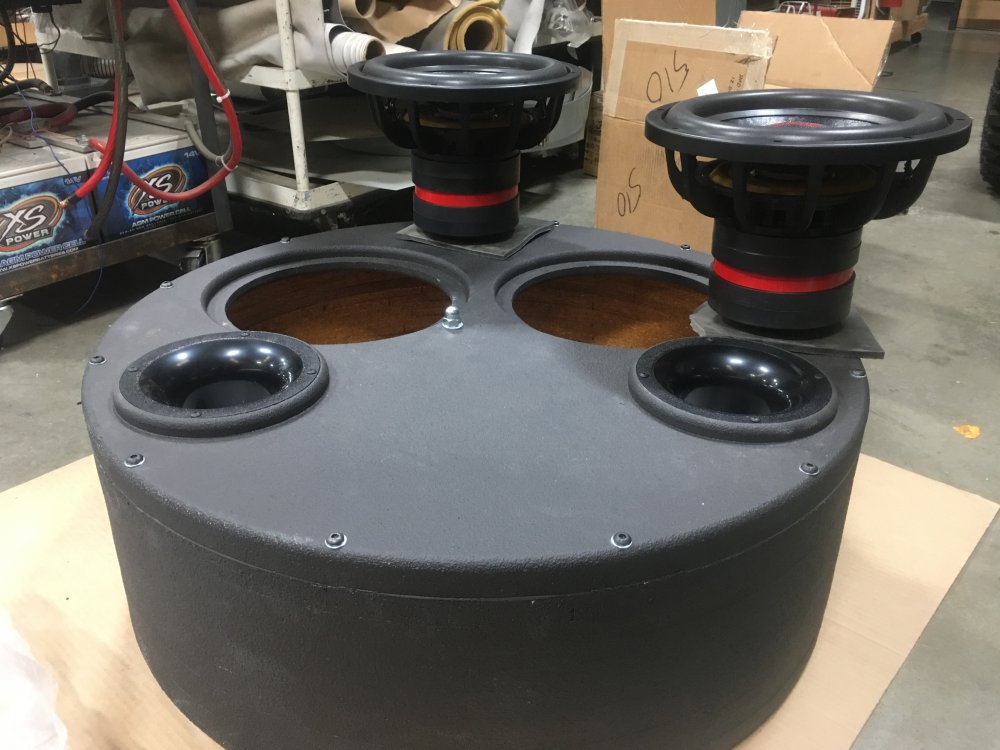

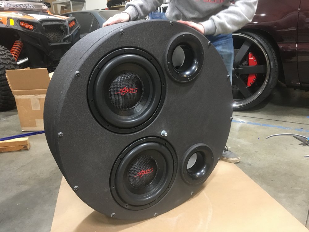

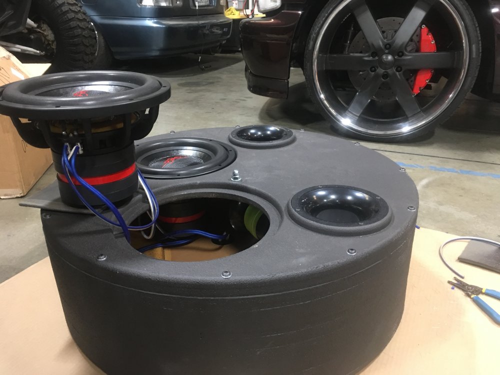

Time to drop some SMD Mini's in it and see how it sounds
  • Like (+1 Rep) 2
Follow my Tweet (Twitter)

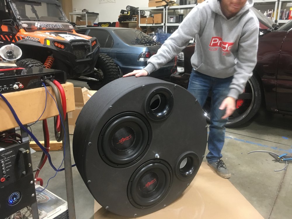

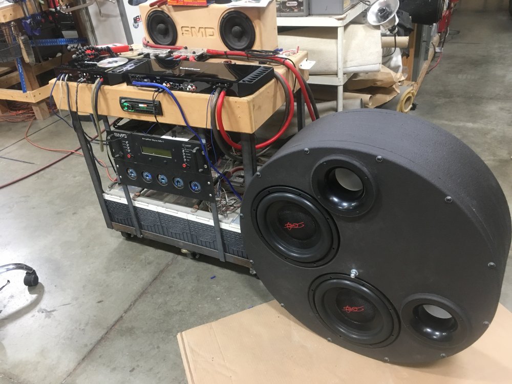

the box slams! but the baffle flexes a little too much.  The all-thread doesn't go in until it is mounted in the vehicle. That should slow it down if not stop the vibration. He might even need more after the test i just did. Had Brandon scooting around the shop just from woofer power :D
ill be working on the video today. I will also update this post when he gets the box mounted and the amps in the vehicle. Stay tuned!
