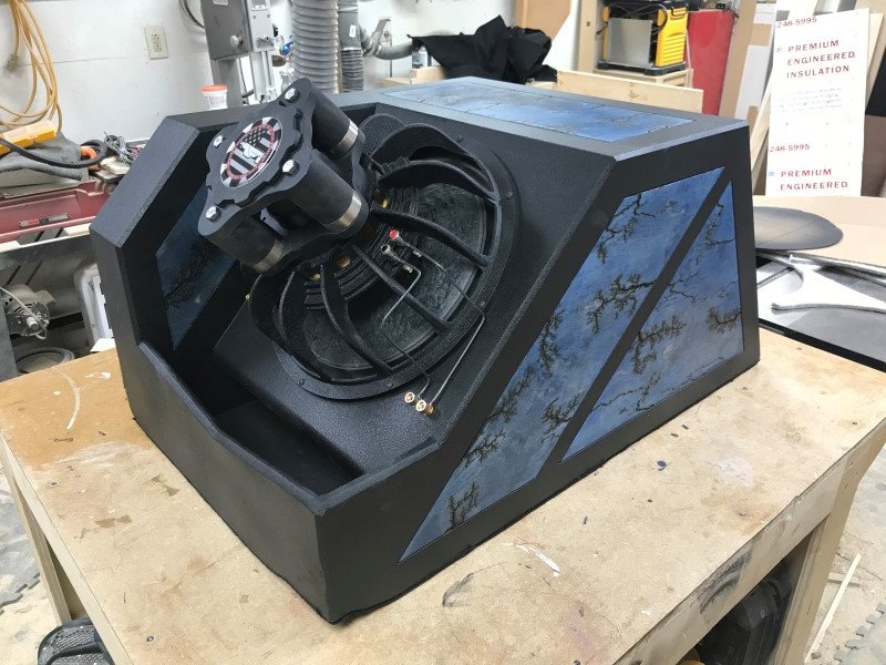

2 hours ago, bcbrassard said:
That turned out good. Hard to see what you in visioned until the end and it works nicely.
Thanks man!  I had a picture in my mind how I wanted it to look, it came out pretty close.
Builds:
Here it is with the sub in and everything wired up.
Builds:
Never seen anything like this. Hats off for originality as well as rock-solid execution. Looks like something you'd see in a Japanese home entertainment center or something ?. Basehead fengshui.
Edit... Feng shui is Chinese not Japanese. Didn't want to come off like an idiot. Lol
A true work of art, sir. Original as heck. Very cool!
IG @walledsonic
6 hours ago, 06RTCharger said:
Is that solid copper rods???? As ur speaker wire.
Yup, its just some 12 gauge romex.
Builds:
Nice install! SQ wise, how does it sound compared to the 12" 40hz TH? That enclosure reminds me of JL Audio's TH ish enclosure.
Well they are very different enclosures.  The 12" TH was very efficient, and had flat response up to around 150 hz (much higher than I need), but its output began to roll off below 50 hz.  The Fi 15" is tuned to 30 Hz so it plays much lower.
I need to measure my frequency response with the new sub and adjust my DSP according.  I get a pretty big peak in output between 40-50 Hz from cabin gain, so that needs to be smoothed out a bit more.
